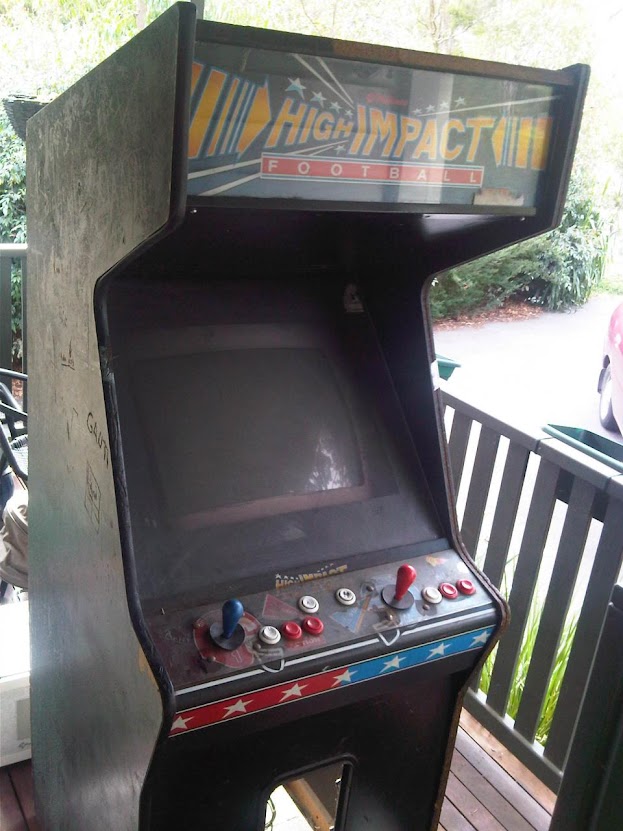

I had been searching for a very long time for an arcade cabinet as they are becoming
harder and harder to find. Whilst driving I came across an old bike shop that was
closing down.
By chance out the back they had an old arcade machine that was not functioning.
I offered to buy the machine and to my surprise the owner was happy to part with it.
The next day the machine arrived at my door, it was in very poor shape, the game
board was missing the coin door has been stolen and the back of the machine was
missing.
None of this really bothered me to much as I wanted to restore the cabinet and was
just happy to finally have a starting point.

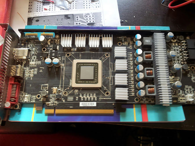

Since the machine features two graphics cards, one for native bios support the other is software controlled using hacked drivers the monitor would normally have to be switched off during boot.
So I created an Automatic KVM switch, this device allows the Arcade machine to be booted with once graphics card and once Windows has loaded the device will then trigger and switch to the second internal graphics card.
This device is not on a timer, it has a custom driver that will talk to the KVM and let it know when it is ready to switch. You can see it in action here in a video I created for you.

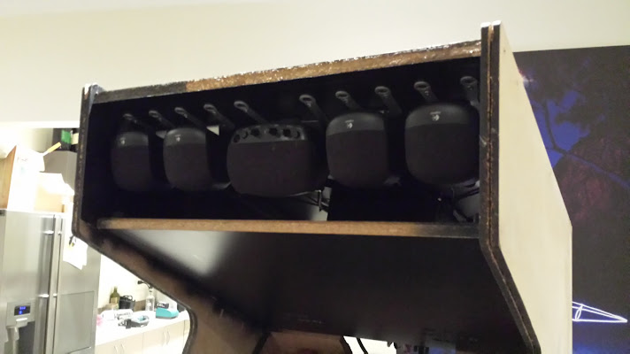

When building the cabinet I wanted to be able to play gun games, not just for arcade games but console and computer games.
Playing Duck hunt or Wild-Gunman with a Namco recoil gun has to be the most fun I have done in a long time. Forget the ZAPPER - this is the way the game should have been!
The ability to play all the classics on all the consoles gives the user a wide variety.
The machine also features Steam support, and 8000 of my favourite dos games.
However the issue I had when I first installed the gun circuitry was the recoil would only fire when the trigger was pressed. This was perfectly fine for majority of the arcade games and consoles. But modern games when using a machine gun the one recoil just was not enough.
This prompted me to create a rapid fire mode and build it into the guns, there is a push button switch that will allow you to be able to switch between full Automatic and the regular Semi-Automatic.
Here is a video of the Gun in action on House of the Dead.
The Guns themselves are fitted with an Aimtrack module, it emulates a mouse and its accuracy is amazing, I tested its competitors and they all fell well short.
The guns are original Namco Guns, and the kickback (Recoil) is very strong.

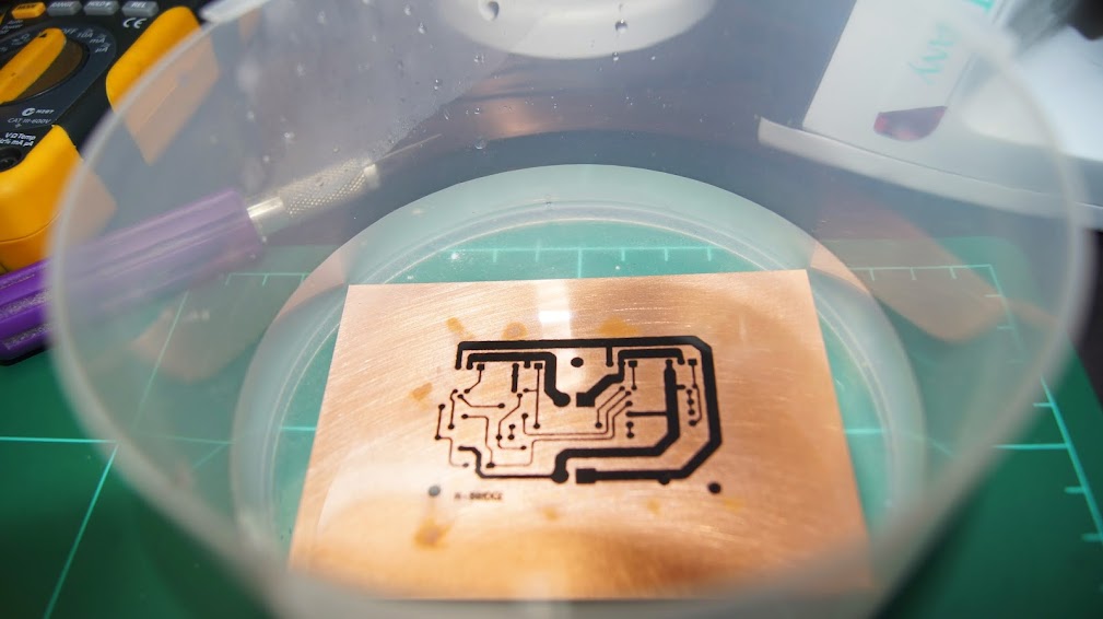

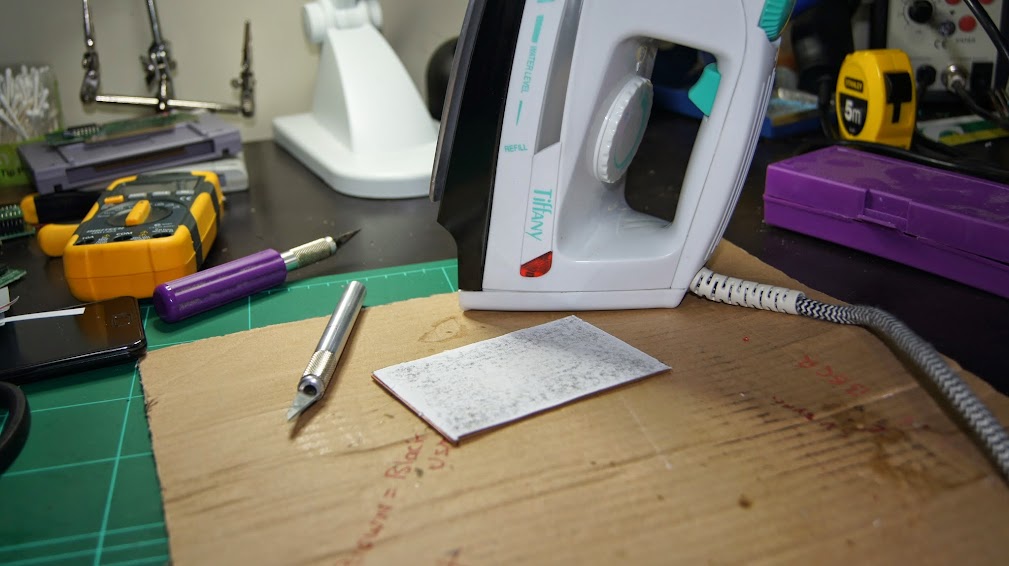

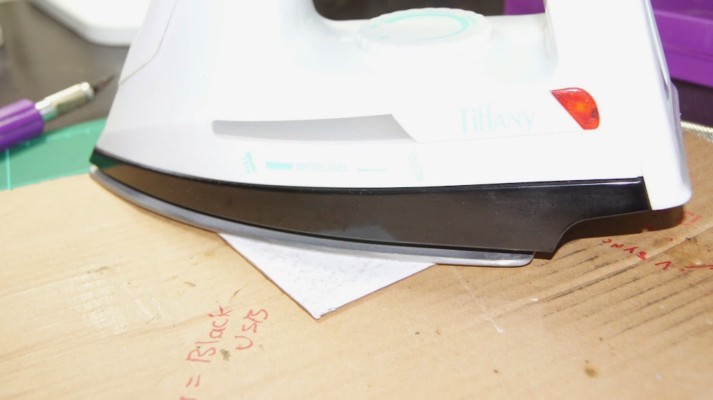

And the moment alot of you have been waiting for.
Its a very simple circuit, this is just for rapid fire,
When the SPDT switch is on rapid fire will be active, the recoil will act as normal.
« Last Edit: March 13, 2013, 09:28:17 pm by epicfatigue »

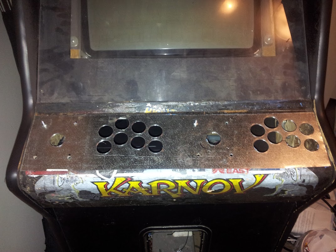

« Reply #17 on: March 13, 2013, 06:44:08 pm »
So this is the largest hurdle i have to get over, the control panel....
From the first picture before i touched it it looked pretty good, well i was in for a surprise when i lifted the plexi and the sticker!
most of the CP metal is gone, i am either left with the options of cutting it right out and getting a new part welded in, or getting a whole new one made.
So as a temp solution i created a back plate
This goes underneath the panel as there is still structurally enough to give the panel  overall support.
As a temp solution i have used Black Plexi until my artwork is done so it doesn't look like a complete mess!
A Part of me wants to make the control larger but i want to keep the outside as original as possible

So i have never been happy with the temps on the factory Overclocked HD4890 and it has always generated alot of noise.
The fact i want this machine to keep on ticking over for at least 8 years (the pc)  i needed to address this issue.
The main issue i was having was the VRM temps, after pulling it apart i quickly discovered why.
For some silly reason this model either didnt come with cooling and relied on airflow... or some nub took them of at some point in the cards life.
This was quickly addressed like so
One
Two
And Three :)
I am currently running in the thermal compounds i will put it to the test shortly and see how it goes
« Last Edit: March 14, 2013, 07:54:18 am by epicfatigue »

I bench marked the cards, the top temperature set is with the Original HSF and the below is with passive cooling.
Note i have not added a fan yet this should decrease the temps by at least 10-18 deg!
I am still not happy with my VRM temps they are good but i want perfect, the glue that came with the chips is nasty as all hell.
I Will Glue them on with a special Epoxy when i install it into its final resting place :)

For all the people out there that wanted this.
All in one pcb has recoil and rapid fire.
Very small will mount under the soliniod just wire in

Did you change your design?  I'm just comparing the png to the hand drawn schematic and T2 changed.  Is T1 still the same?
http://yaksplat.wordpress.com
epicfatigue
  • Posts: 360
  • Last login:May 15, 2016, 08:16:08 pm
    • http://www.retromods.com.au
Re: My first Arcade Build 5ghz Watercooled
« Reply #35 on: April 14, 2013, 10:49:47 pm »
same design the they just didnt have the same transistor i used in the program i etched it with

Hey everyone, so while i am waiting to get back to work on my machine (its killing me waiting) i am looking for some advice.
My current control panel has 8 buttons per player, i will be dropping 2 per player as i am unaware of any games where i would need this many.
I find it feels to tight while playing two player, and i am tossing up about maybe removing the original and creating my own CP to slide in so i can have a little more room and maybe even add a track ball.
I am worried if i do this i will detract from the original arcade feel.
What are your thoughts?
Why is it so cramped, have i gotten fat in my old age?
Are there many good games out there that would make use of a track ball?
Will i need more then 6 buttons for games?
Should i extend the cp?
Thanks all?

« Reply #54 on: May 10, 2013, 10:16:30 am »
Thanks all?
- The CP has not much space to rest your hand palms.
- 6 buttons is enough but for NeoGeo games you could want 4 in a row (therefore I use 7 buttons myself)
- I guess you could use some admin buttons (Exit, Pause, ...)
epicfatigue
  • Posts: 360
« Reply #55 on: May 10, 2013, 10:55:01 am »
Hey i think thats exactly my problem i get a sore wrist when playing.
As for console buttons, i am using a Ipac so i can hold Player 1 button and that gives me more the enough extras.
I Hate the fact i have to put the start buttons down the bottom.
However i am finding it hard to in-vision making a new CP how it would sit etc.

So i have been playing around setting up the pic with HID, i have worked out the driver set i will be using and boot loader, works with linux xp 32 64 and windows 7 32 and 64.
USB is fully working time to start writing my program.
Took alittle tweaking to get the caps in the right range, seemed to vary across systems, the newer systems seem to require more smoothing then the older ones ODD!!!.
Here is a little sneak peak not much to see just the device loaded with an on and off button and a reset button,

So today i have a very special announcement,
I would like to send a big shout out to Corsair for sponsoring this arcade build.
I will be uploading the plans soon however i am away this weekend, the inside of the machine will be featuring a wind tunnel with a Corsair theme i know its hard to picture but i can assure you it is going to be amazing.
Here is what arrived in the mail today just as i was walking out the door for a family trip, i quickly ran back inside to take a photo but!!!
16 x 120 SP120 Performance Fans
1 x corsair H110i
The Wind Tunnel should be able to move 1000 + Cubic feet per minute of air, it will be using a custom as always fan controller system allowing the system to gain maximum airflow.

So its come to that fun time now, CHEMICALS!!!
Not a fan of buying etchent so i make my own, makes a board in about 20 seconds!
Its time to get ready to make my HV bridge once it is completed i will then build the PIC master control PCB.
The HV bridge is what will allow the PIC to drive the motor using a series of transistors.
This allows me to provide the motor with its own voltage and control its direction by a separate lower voltage.

can you point me to a good home board etch tutorial?
Man I love overkill, but 1000cfm is total overkill for cab cooling.  :applaud:  interested to see what a wind tunnel in a cab is going to look like though.
Hey mate, thanks its a work in progress feels like its taking for ever if i had full days to work on it, i would have it done in no time.
i learnt the method many moons ago in school, quick google however here is how i do it,
http://www.abiscus.com/projects/TonerTransfer/TonerTransfer.htm
Thing to note, dont use a boubler, dont bloody do it inside either hence no photos.
Now i go alittle overkill with my etchent, and use 50% Hydrogen Peroxide from a Hydroponics shop and  Hydrochloric (muriatic acid, "pool acid"),
Hydrochloric first then Peroxide and cover your mouth, i use a ratio of 1:1 so i just drop it in 10 seconds and pull it out, but thats me experiment and most of all saftey first and have fun.
When your finished dilute it to 50L of water and its safe to go in the garden
« Last Edit: July 15, 2013, 08:44:05 pm by epicfatigue »

I use this http://www.lvl1.org/2011/05/03/toner-transfer-and-muriatic-acid-etchant-making-pcbs-at-lvl1/
Important parts are use a good glossy photo paper, and a good laser printer....The rest is easy....
You can also use liquid tin, its pretty cool and it protects your traces.
I actually use a bubbler for the muratic acid approach, its the oxygen that promotes the etching.  I just do it outside.

Also, I would use a 2:1 ratio 1/2 cup muratic to 1 cup of peroxide.
Also epic, look really close at your board you have a broken trace, in your drilling photos, look directly down you will see it.
When etching try to use fairly wide traces, those really thin ones can get eaten by the acid or easily broken during the drilling phase...
similar to this guy....also give yourself nice gaps in between the traces, (not illustrated well here as this not the finished board) this will ensure that your toner doesnt bleed over into another trace....

A wind tunnel concerns me in how you're going to incorporate the fans.  Fans inside of fans can be very dangerous.  Often times you see or hear wood shop guys stringing multiple dust collectors together for a more powerful system.  This results in the second fan running faster than the first thus pulling more AMP/Watt than it was originally speced to pull.  This then results in electrical fires.  Mind you these fans are smaller grade than wood shop dust collectors but the same principle applies.  If you're planning to use fans inline of one another I would be very very careful to watch their pull.
Otherwise the electrical stuff is BA for sure.  Keep up the good work dude.

Yes thanks for pointing the trace out rablack97, was more for a trail run, i decided to make the traces much bigger because i dont know what the motor requirements might be like in the future and i dont like going back and redoing things.
Hey Topjimmycooks the cfm is just going to be a tunnel, however there will be 3 fan controllers that i designed that i am sure will get a work out on the forums and the internet for that matter. Will post that next week when i test it.
Hey My friend i have not seen you pop your head in for awhile, yes i am aware of this, alot of calculations went into the tunnel the fans are not back to back. A custom circuit has been made (you know me by now guys i have to make everything) this actually will make a strip of fans act as one fan and will make 3wire fans PWM and allow them to be controlled from a 4 wire computer fan header, it will also monitor RPM etc. Hard to explain but i will post everything about it so other people can use what i have created .

If you dont want or have a MB to get a PWM signal you can make a simple one using a 555 timer and a pot to create the adjustable signal pic etc etc)
This makes management nice and easy so you can control those noisy fans have them quiet as and ramp on when needed via temperature control.
It also has two pots that will allow you to change the amplification of the signal.
This is my secret weapon for the wind tunnel, as I will have the fans installed in blocks of 5, they will represent one fan on the MB and I will be able to adjust each block accordingly to gain maximum airflow when needed as well as minimal noise when it’s not needed!
The printable version is posted for download enjoy!

I plan to have this machine set up in my pool room. I want it to be able to play music while i am having a game if its not in use.

Got a question for you though. That speaker setup....it looks like alot getting pumped out of one area. Why didn't you put the sub and the 2 "surround" channels at the bottom of the cab? Put 2 speaker holes close to the bottom aimed up or something.
Just curious.
epicfatigue
  • Posts: 360
Re: My first Arcade Build Rotating CRT & More
« Reply #134 on: May 05, 2014, 02:10:30 am »
Lookin really good so far.
Just curious.
Hey I tried this, it echoed the sound.
The odd thing is, having it configured like this        LF LR CENTER RR RF
It actually sounds like surround up close and from a distance so thats what i went with :)

Lined up all the holes to where i wanted them and drilled away.
Man yellow tongue flooring is bloody hard to drill, least i know the additional parts i made for the cabinet should last just as long as the rest of the machine.
Tomorrow night i hope to rout out the joysticks what fun that will be!

Well routed out the joysticks and tested out the layout.
Felt awesome!

The idea is the bottom is its broken into two sections, 2 fans as intake to cool power supply's and transformer circuits that control a number of things in the arcade machine, all with fuses accessible from the front panel, at the other end is PVC pipe wich directs the air up to the top level.
The next Level has a slide out draw that hols the computer system, this is so if it needs to be replaced repaired or god knows what it comes out with one connector and slides out :).
Above this (not shown) Is a glass panel, one of these will also be in the back of the door so the system will be visible from the back.
Like the lower level there are two pipes that divert this air to the top of the machine.
At the top of the machine there is a angled bit of wood which diverts the air to the exhaust, here there will be a filter that is removable and accessible from the front for easy cleaning, the whole unit is air tight no leaks so the air flow is well its strong trust me!
All fans are powered by the controller located in the coin box, so you can either have positive or negative air flow as the design is symmetrical!

I am at the stage of creating all custom PCBs which will act as connectors for all the wringing to make everything neat and modular for servicing because i would like this thing to be easy to work on and last a life time.
Once i finish this i will install the motor control unit and 1 other little surprise i have stored away :)

This layer has 2 corsair fans intake for cooling.
Then we have layer one the PC Wind tunnel, this layer has 4 corsair fans
and the pc All cables are hidden through holes, the corsair water cooler is not installed just yet, as i am working out mounting for HDD and cooler.
