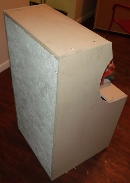

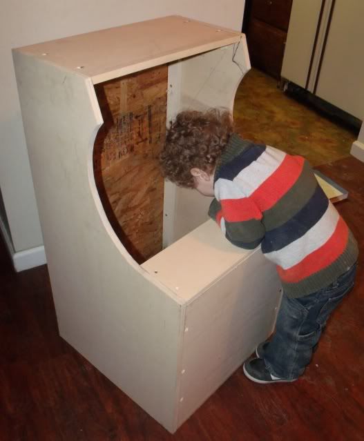

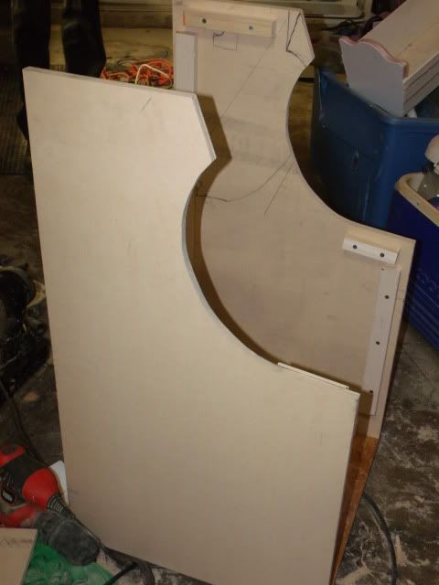

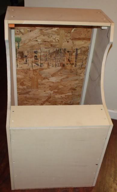

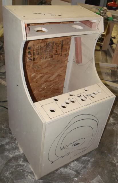

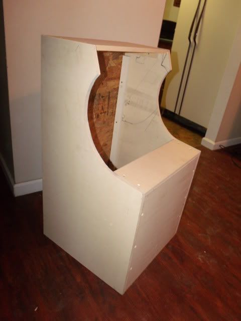

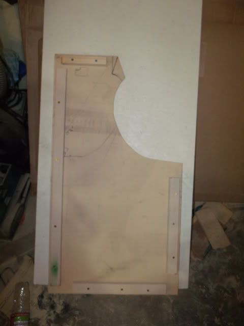

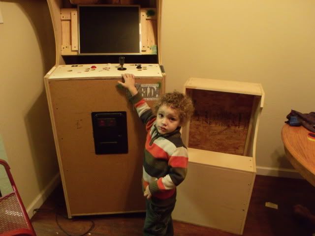

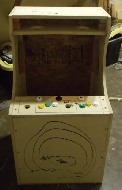

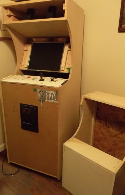

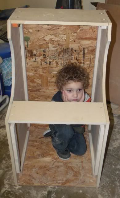

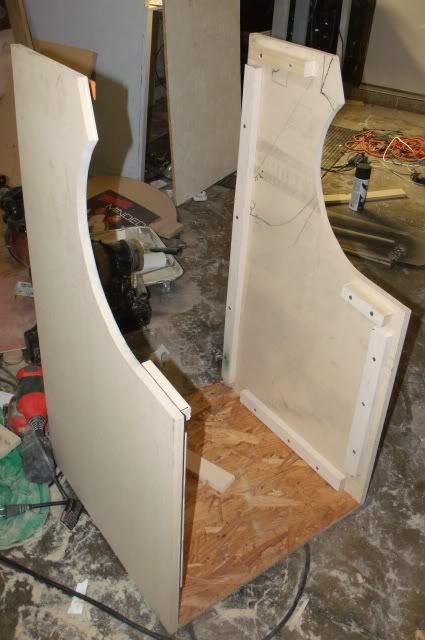

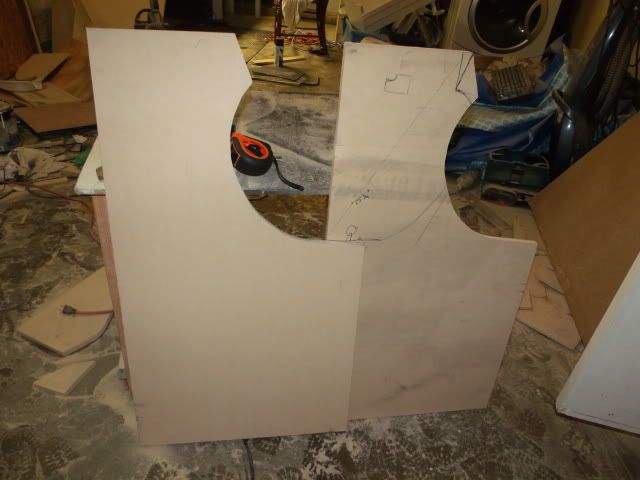

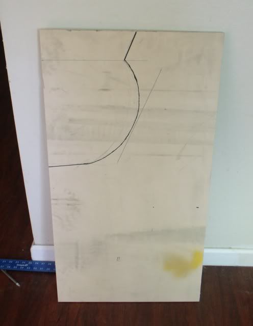

Nephew's birthday in a week and a half, turning 3. My brother and I (mostly me) are building his kid a mini arcade for his game room. It will stand about 37" tall and is going to have a Two-Player control panel with three main buttons each, a Pl1 & Pl2 button and a black button for exiting functions.
 He doesn't have a lot of money to throw at it in time for his birthday, luckily for him I have a bunch of MDF scrap pieces from Home Depot. All in all the wood cost so far is about 5 buckaroonies (if that).
Here is what we got done this evening.
(Don't mind the dirty, scrap wood remember)
He thought we were building him a house  :laugh:
Nephew putting some work in
Sitting next to the very unfinished "Clyde's Corner" for size comparison.
Edit: He is turning 3 not 4.......brother had me fix that

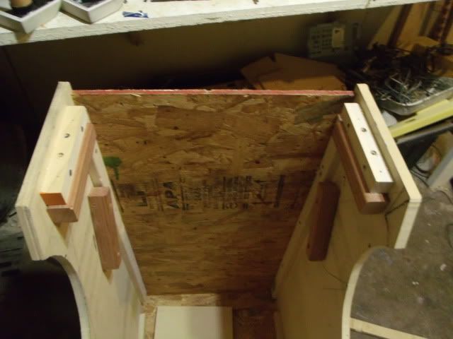

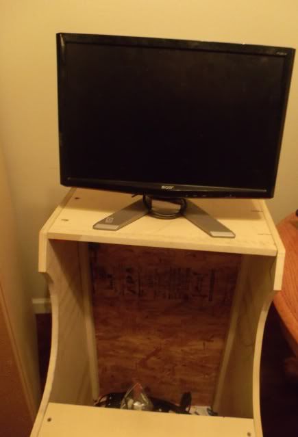

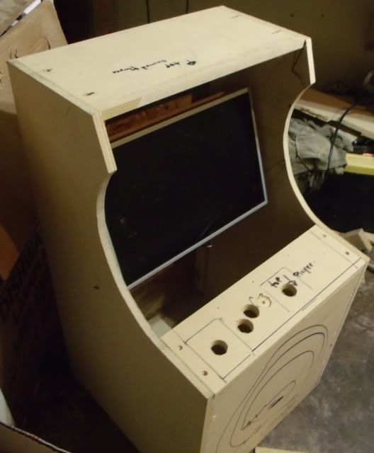

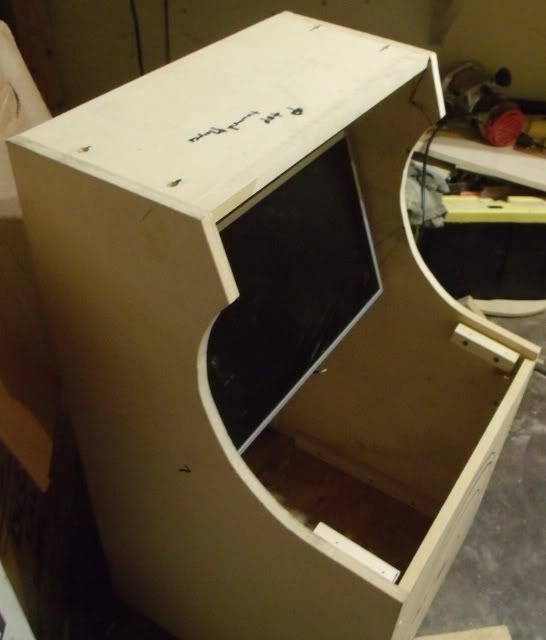

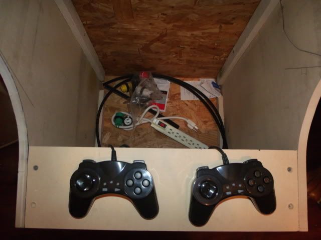

Monitor secured, he got it for free from a fellow churchian. Gamepads came in this morning as well, next up is the buttons and joysticks to arrive for install.
« Last Edit: November 18, 2012, 01:53:19 am by CoryDee »
CoryBee
  • Posts: 2093
  • Bopity Boopy
Re: Nephew's Birthday Present - Mini
« Reply #7 on: November 18, 2012, 02:41:51 am »

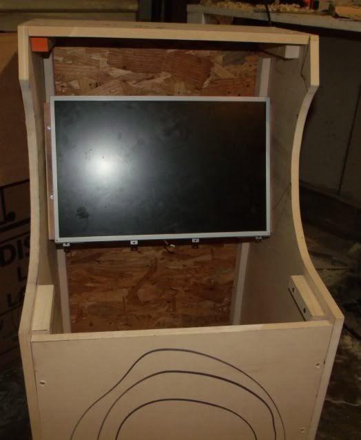

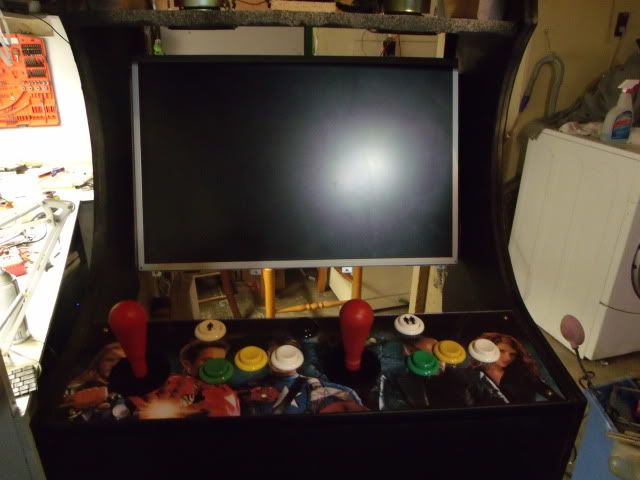

Screen installed, started drilling CP holes and kick plate art started by nephew  :laugh:

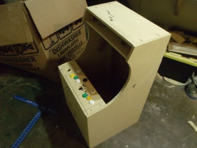

« Reply #10 on: November 19, 2012, 12:25:58 am »

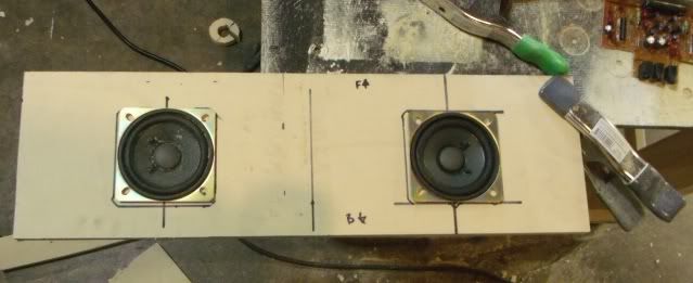

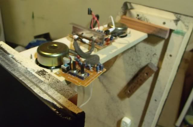

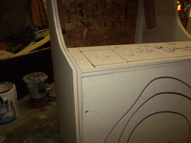

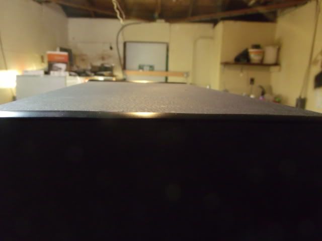

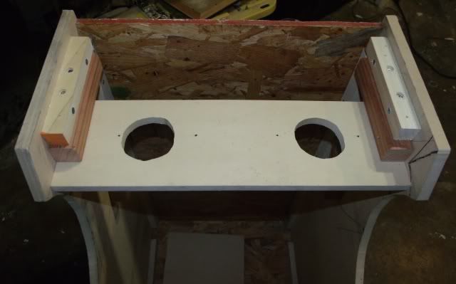

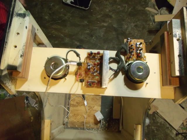

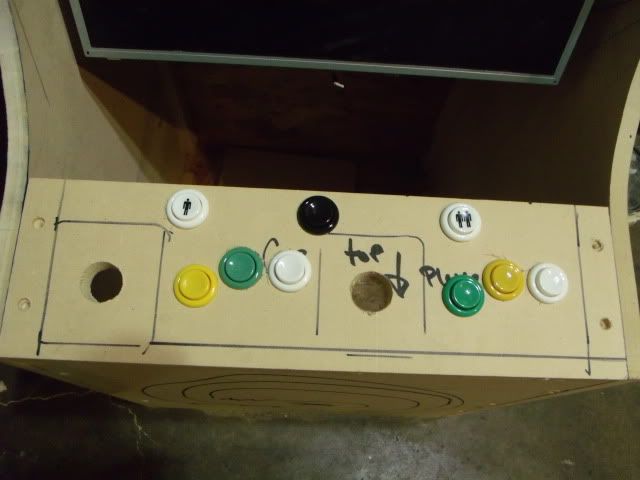

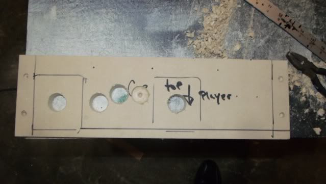

Speaker Piece

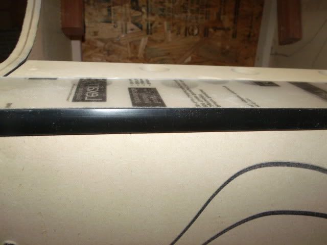

Routed for T-Molding

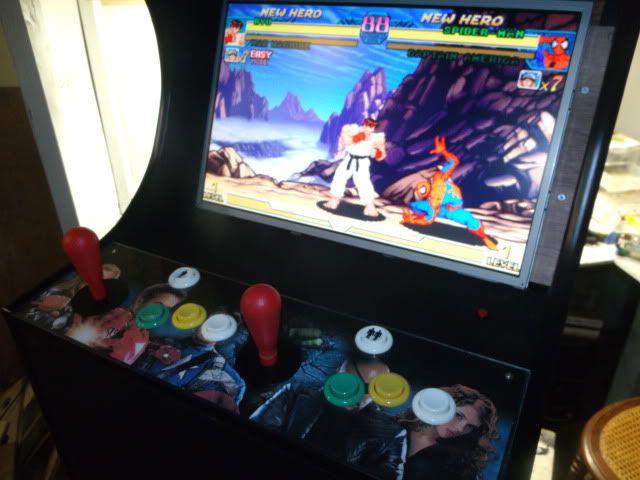

Didn't want to find another way to fit the Control Panel and the lexan in the space of the of the t-molding so I did the same thing as on the 2-player bartop and just routed out a lexan sized layer off the top of the CP.
Filled some of the holes with wood glue puddy stuffs and waiting for it to dry before putting the primer on it. Will be posting more updates soon.  :cheers:

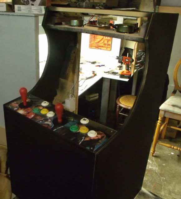

Got a ton of work done on it with the help of the Brother. Many o pictures to be looked at
Paint it

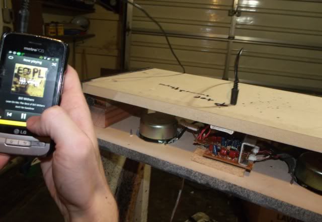

Got a cheap PC amp at a thrift store for $3 bucks. Turns out it was a Yamaha and sounded amazing (and very clear even when turned up loud)
Came up with an idea to use a 3.5mm Audio Jack to use as an input for a smart phone or mp3 player to make use of the awesome sound. So you just plug an mp3 device into the jack on top and the PC audio dims to allow for crisp music enjoyment  :applaud: Just lay your phone or whatever on top. This will get more use from the father than the nephew but whatever, makes for an awesome little boombox.
Acrylic cut to size and routed, holes drilled
Made up the CP art real fast like because it needs to be done on thanksgiving (also his birthday) Didn't account for where their heads would be  :laugh2: But he loves it and recognizes it either way (will make more of an effort later)
T-molding a flat black paint
Just need a few more things done and he can jam on it - Screen Bezel, Software, and Marquee Printed -
Extra shots - Absolutely a blast to play on it despite it's size (on a table)

I'd strongly suggest redoing the CP art. You can actually only see one face out of all the charactes there.  >:D
Yeah only one face but that's the best one    ;)

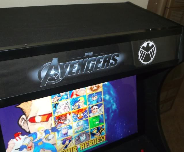

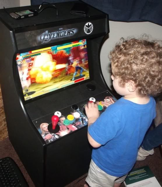

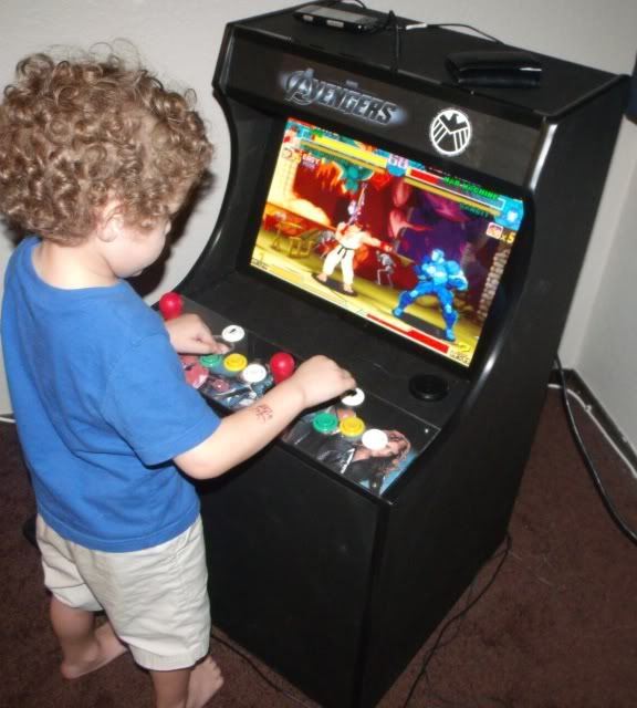

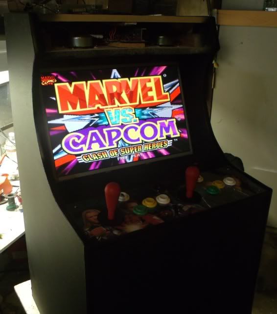

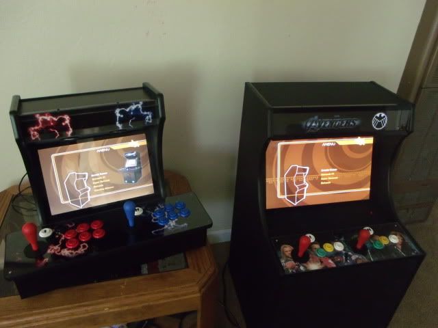

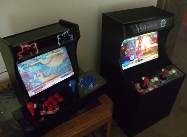

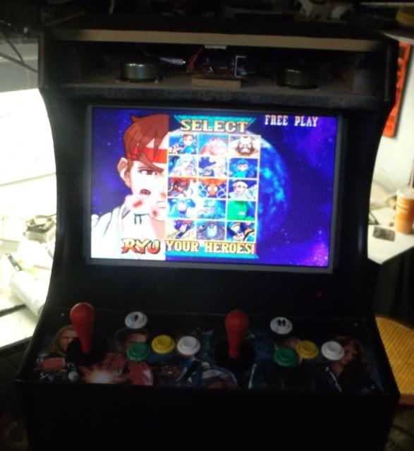

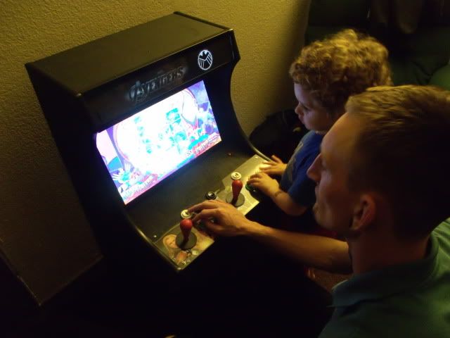

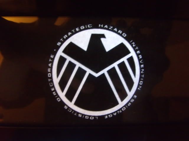

Finished it the morning of his birthday (thanksgiving) - Lots of pics  :P

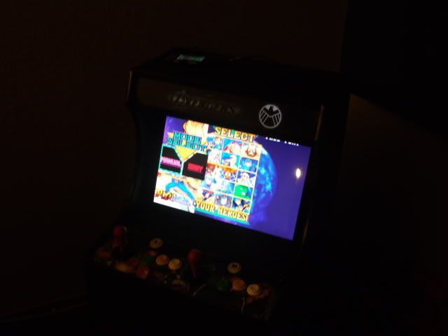

Put together a marquee for it and it turned out beautifully with the "Shield" logo and the white leds behind it.
The image on the screen is the custom boot screen I edited together.

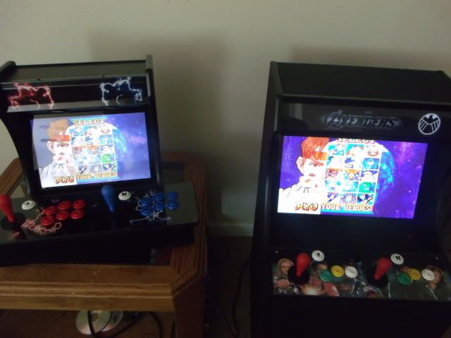

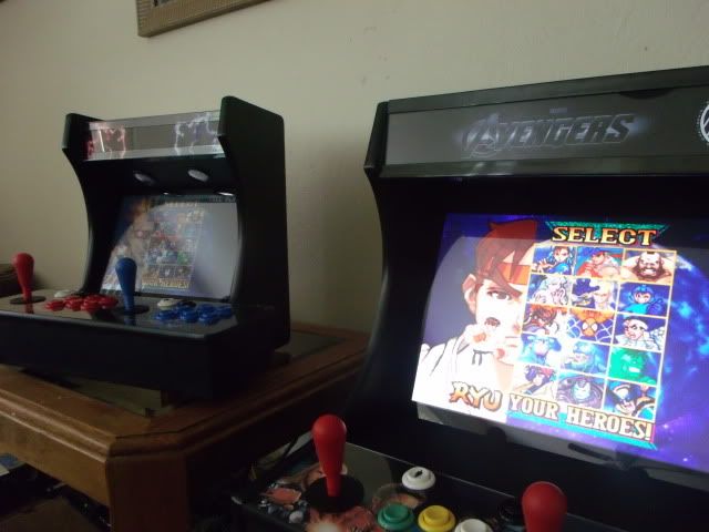

Next to the Lightning Bartop
To get the scope of the size of the arcade, here is my younger brother - about 6' 1" tall - next to it

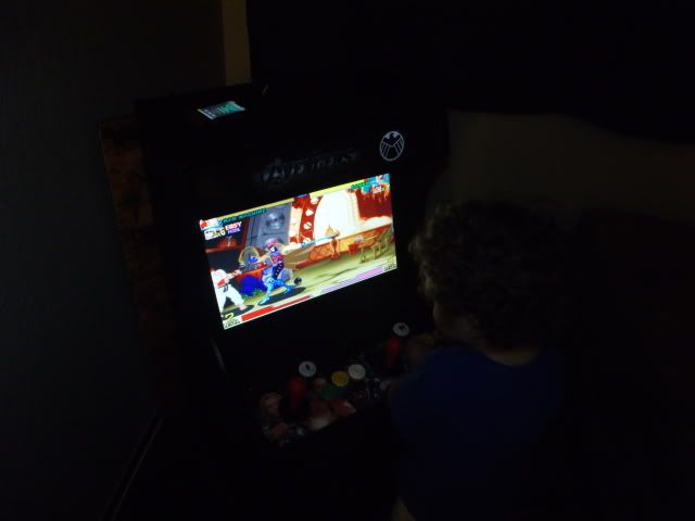

Older brother and I playing some "hat trick" - also bumping bill withers through the top -
Some shots of the birthday kid
Without the flash
Quick Video of the Startup Image
So I built in time and am quite sad to see it leave....  :cheers: Let me know what you guys think.

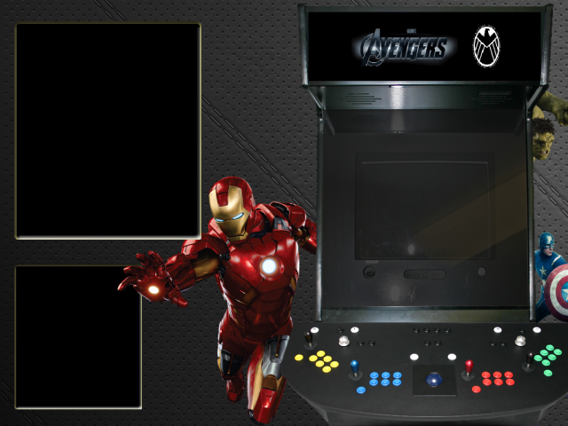

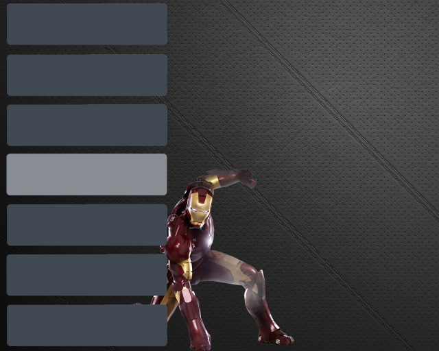

I am working on a mala layout right now to go with his cab this is where I got playing around last night
Arcade Games - Marquee only shows when the selected game doesn't have one on file
Main Menu
Not much but will help spruce up the cab until he springs for better art for the CP and Sides  :cheers:
« Reply #27 on: November 25, 2012, 11:18:35 am »
This really looks great.  I love to see the kiddos playing.  :applaud:
Too cute right. It is no American Ace, but I love it!
Being 3 years old and having his own room he tries to sneak downstairs and play it the past few nights when he is supposed to be sleeping. He also likes to press the power button too many times, so to rectify this I ordered one of these
It will keep him from pressing the power button more than once and only allow the dad to turn it off and on at will. He greatly appreciated this order  :laugh: - will situate it right next to the power button on the left side

Nice little cabie  :applaud:
Wish I got such a great B'day present when I was a kid !
I would have loved to have gotten one now for my birthday  :laugh2: let alone have one when I am 3. Spoiled little man

Will update when I get the key installed and see how well it works. Other than that this build is done.

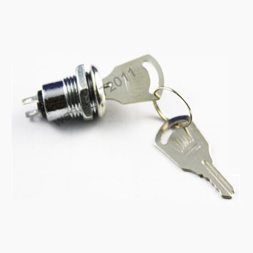

Got the key lock installed the other day (Christmas) - he has used it a ton of times now. He says it is a godsend, little guy can't go down stairs in the middle of the night and play it as he has been doing lately.
It was a hit with the adults on New Years as well, a lot of "Hat Trick" hate being spread around.
Anyways, you can't turn the arcade on without the key switch in the on position. As demonstrated in the quick video.

Thanks again BobA & yotusa! I would like to quickly mention that he can't turn the computer off either (video shows this) which was a big issue with him as he likes to press buttons in general. He realizes that is the power button and will shut it off but his button pushing instincts kick in from time to time and ruin his game.
The keylock was a no brainer once I found one at $1.50 - Price rose to $2.00 from the Chinese.
Links
1x - $2.00
5x for $4.00
I am going to purchase the 5x set right now, not sure what to use them with but I feel like I finally found a reason to make a useless Military control panel switch box thingy. Already have a few of these and a ton of LEDs:
