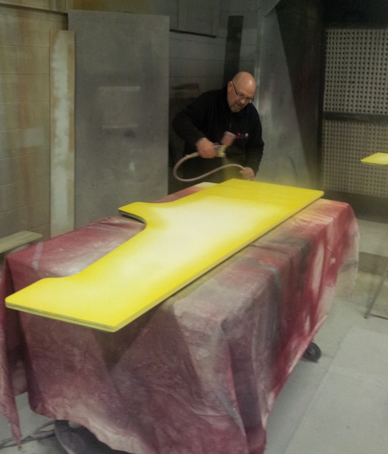

After making the first cut I traced it onto the second bit of wood, ensured the lines/curves were true and cut the shape out. I Discovered a 'feature' of jigsaws in that when you go round curves, no matter how slowly, the blade tends to flex (or maybe it's the hand) and you end up with a slight camber. Anyway using a straight edge (my set square - picture below) I was able to straighten the profile nicely with just a tiny use of the sander.
Here's both bits of wood, I was a bit shocked that they matched perfectly bar sub-millimetre differences in one or two places.

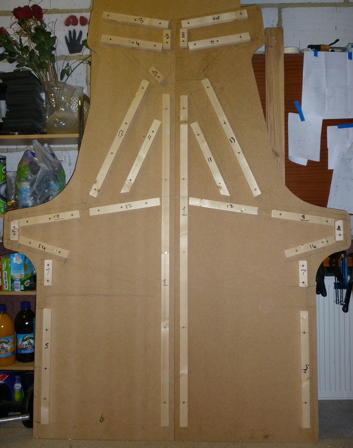

Yesterday I got started with the next step and attached all the batons ready to 'simply' attach the rest of the MDF to form the cabinet. After meticulous measuring everything seems perfect (alignment of the batons on both sides), just need a little sanding on some batons on one side to get rid of half a millimetre or so.
I've been trying to figure out the mounting of my control panel (it's flush mounted inside the cabinet, so allowing for hinging is proving difficult). This is my first stab at a solution:

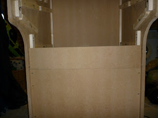

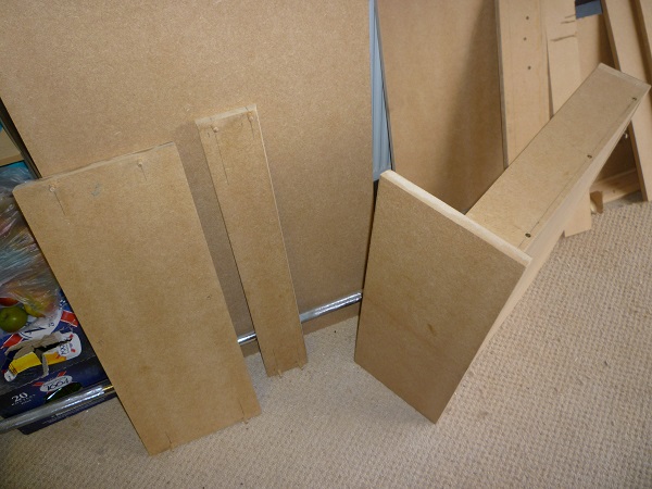

I did a tiny bit of work last night and made the base (as that'll be the first thing to attach). The wheels will be 5mm below the bottom of the cabinet so it'll wheel around nicely but won't be obviously visible.
'Top' facing the inside of the cabinet.
'Bottom' touching the ground.
Realised a minor issue last night in that I can't easily get in to drill/screw as the batons are only 18mm wide.

Tonight I attached the base to one side, squared it all up then added the kick-plate, top half of the rear and the other side. There weren't any real issues other than it took a bit to get it all square, but that was probably due to having nothing spanning the width (other than the base) to stop it from twisting (and my lack of tools such as decent clamps - I had to make do with bits of wood screwed in temporarily at various places  :D). Pictures attached/below. I'm quite pleased so far and I think the wheels are just the right height off the floor to make it look like it's not raised.
« Last Edit: October 03, 2012, 07:02:01 pm by chucklepie »

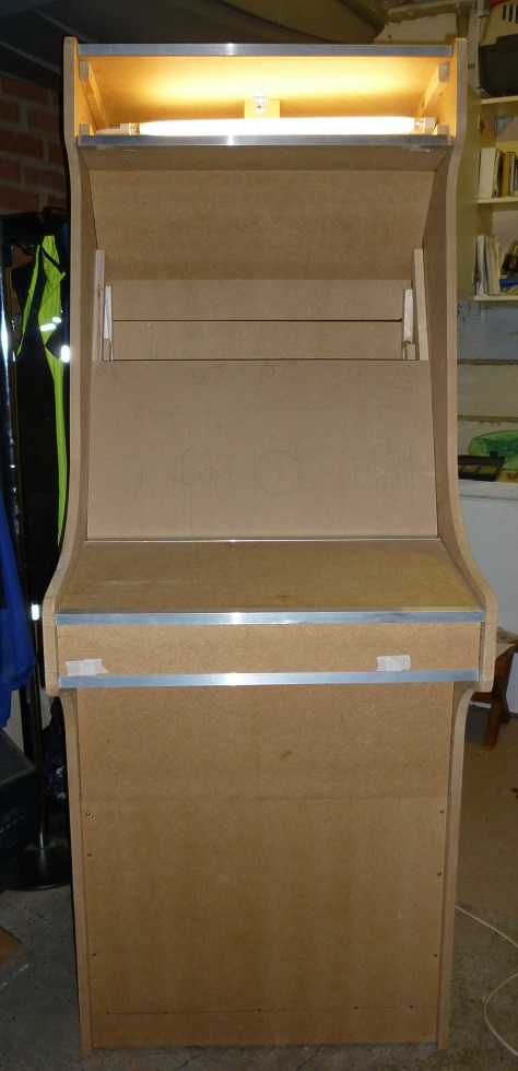

I should really wait until I do a lot before posting rather than by the day , so I'll update next when it's all assembled ready for the control panel/painting.

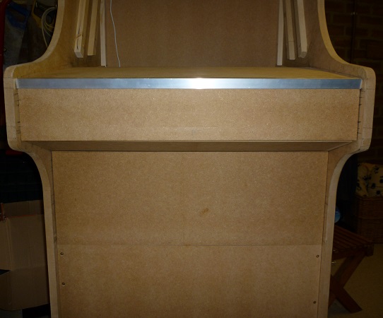

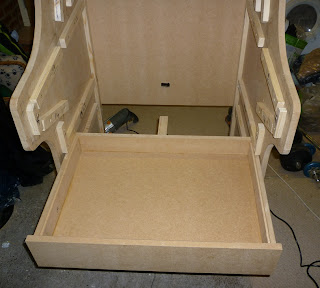

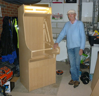

I created the drawer today. I toyed with the idea of creating little handles (coving type router bits) but I didn't like it. I really wanted it concealed and to be simple - and to only use the wood I had (i.e. the 18mm MDF and batons.)
Here's the drawer closed and about as flush as I can get as it's from the original wood cut for the kick-plate (the batons holding the sides/front together form natural stops for the drawer front. The sides/back are screwed/glued and the front is dowelled and glued.
Here it's open
About as simple as you can get really, especially the runners :)
But I figured the drawers for the keyboard/mouse will hardly ever be used so as concealed as possible the better.
The daft looking bit of wood shows about 3 inches from the back, so to open the draw I push the cabinet back an inch and the draw opens. It also serves as a handy spacer so the venting from the back is sufficient.

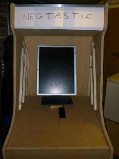

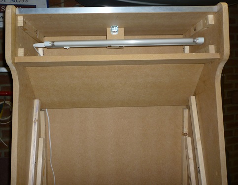

Sunday I added the marquee and lighting and mocked out the control panel just to see about fitting. I'm undecided whether to mount the monitor with the stand to allow manual rotation.
That isn't me in the picture, it's Harry my chief technical consultant (he's a builder) who dropped off a junction box as I forgot to buy one.

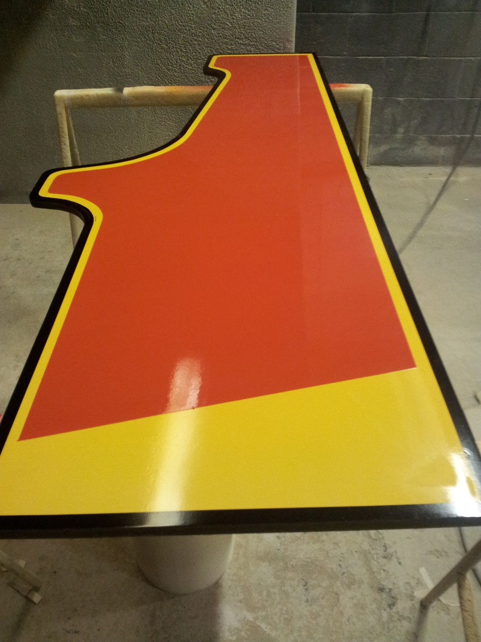

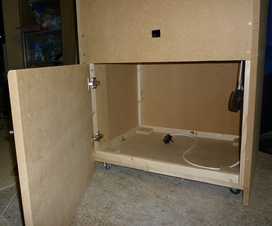

I've now finished the woodworking (bar holes for speakers/vents). If I went back in time I'd give the front of the control panel a bit more height, extrude the marquee slightly more to allow more speakers (I've boxed in the marquee separate from the speaker housing to avoid light-bleed). Overall I'm happy though. The control panel is not hinged, what I've done instead is the two panels below the CP are in with dowels. So to remove the CP you pull out the draw and unclip the panels. If more space is required or the CP needs to be removed completely you unscrew the angle brackets.
I have a question though, the cabinet is going to be red, black, chrome. For the marquee clips and to surround the control panel I'm using aluminium strips rather than t-molding and marquee retainer clips. In the pictures below do you think I should remove or keep the very bottom aluminium strip as it makes the panel look very small.
Here are some more of the build process.

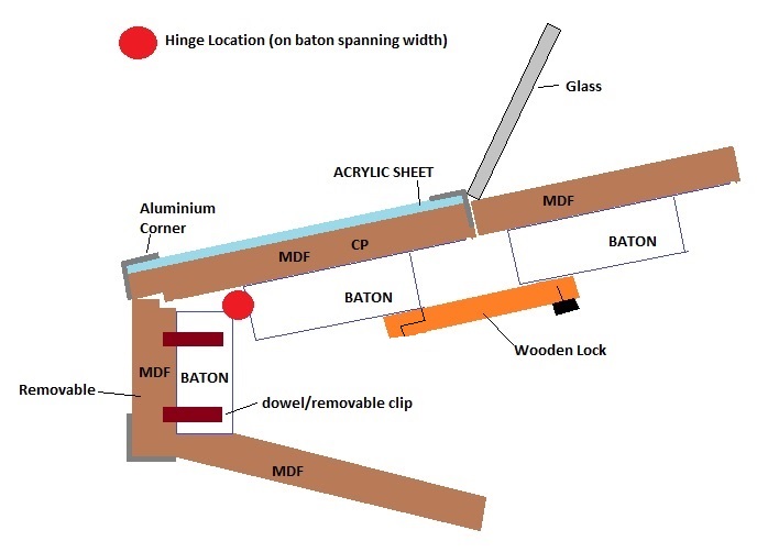

It looks as though I'm a little late to comment on the hinge idea for the control panel. Many of the people here do that, or make the control panel removable. I went a different route and put a large door on the back of my cab, and just reach up inside. This could also be accomplished with the lower panel being a door. My CP is removable but locked down tight and the access I have is enough to get in and out.
I'm also glad you fit your controls in between the sides of your cab - it just looks proper to me.

Yes, that's what I wanted (not an oversized CP), but I've been playing with various 6 button CP layouts (from slagcoin) trying to figure out how far is comfortable from the left/right edges for the controls and more importantly whether I can fit a trackball in the middle (CP is 26" x 13"). I'm torn as to whether to get one or not and I think I need to buy the buttons/joystick to get a feel - though that'll mean paying postage twice....
Here's some mockups attached, the left edge is about 8cm/3" and the right 5cm/2" I think it's a case of I don't want hands touching the edges of the cabinet or the trackball. I think I like the trackball lower down but it means the controls have to be much higher up and/or may be annoying if the hand/wrist is over it.

This is the cabinet getting the yellow sprayed on:
The black stripe and red/orange is now painted too. I'll get photos later.
« Last Edit: November 30, 2012, 05:31:37 am by chucklepie »

Hello,
The main spray job is finished, just need to touch it up:
My artist also superimposed the vector graphic he did of metal slug onto my paint job using photoshop (i.e. only the side is real at the minute):
« Last Edit: November 30, 2012, 11:04:15 am by chucklepie »
