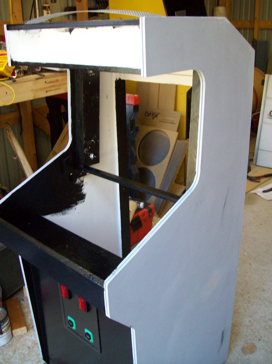

Ok.. I know you guys think this project has fallen off the edge of the world or something, and I admit this project is going very sloooww... even for me.
Anyway, here is a little update:
Here is the front of the cabinet thus far.
Excuse the picture, for some reason the cab looks skewed. It is the camera or most likely the photographer.
Here is the CP thus far. I decided to put a curve on the front edge. Still need to drill the control holes, but you can see my scribbles on how Im trying to decide how to place the controls.
Got to decide if I want it to hinge out towards the front of not. Hmmmm.
I have the marquee box finished, and have a seperator to mount the light source to. (havent decided yet what kind of light source, maybe a 40 watt flourescent twisty bulb.)
I also plan to use two aluminum angle pieces to make the marquee retainer. I have the pieces cut, but need to drill and tap the mounting bolt holes.
Here's a shot of the speaker box. (Needs a good dusting)
Here is another shot of the marquee area, with top cover removed.
And a shot of the back door, partially open.
And lastly, but not leastly. a hinge.
Now I need to mount the monitor mounting method, decide how Im going to mount the CP, Cut out the CP, then I think I will be ready to paint this little beast.

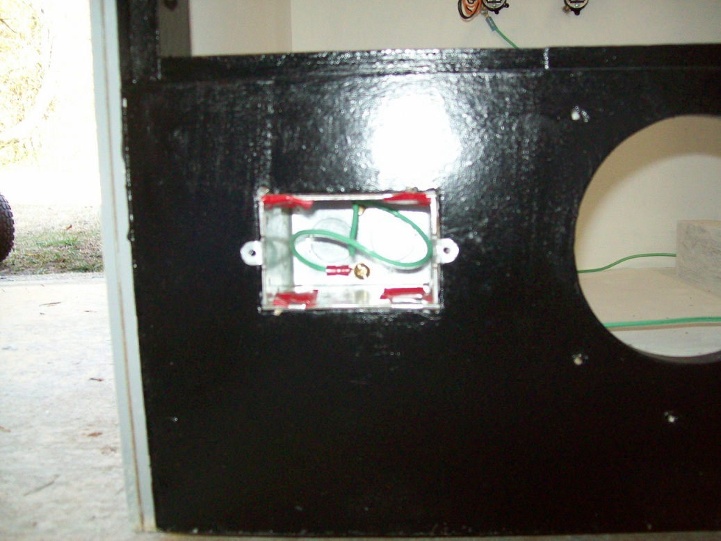

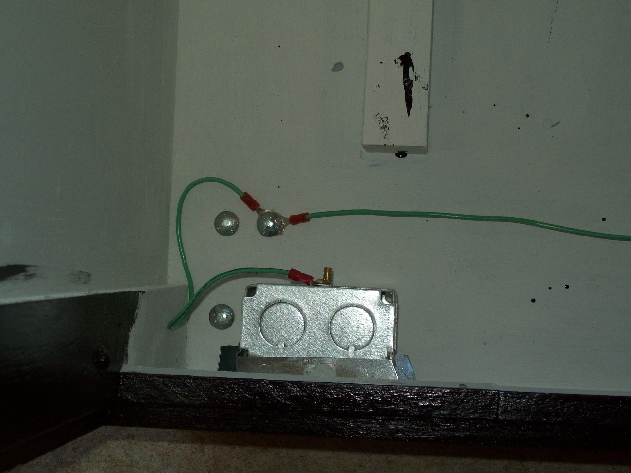

Here is the modified LAN connector that will mount on the back side of the cab.
I cut out a hole for a panel mount USB 2.0 plug. (Not real happy with the repaint job.)
And here is the backside with the ethernet cable connected to the lan plug. The scotch tape is to seal the plugs in hopes of keeping dust out (I promise the tape is not holding the plugs in LOL, but Im not above doing something like  that).
Stay tuned, maybe this job will be finished before my grand daughter gets to old to play it. LOL

Ok, just a quick catch up.
I have the cabinet primed inside and out.
I had some left over white primer so I used it on the inside, but it wasnt enough to do the outside so I had to buy some more. They were out of white so I picked up grey.
So far I have painted the middle part of the outside black.
This pic also shows the coin door mounted. (Perhaps a better name for that would be credit panel, since it doesnt take coins and its not a door.)
I pained parts of the inside black, just in case any cracks show up between the panels.
In this pic you can also see the grey primer on the side. I got a few drops of black on there which I rubbed down before it dried. I have since sanded these places down and re-primed.
Here is the power entry box mounted (glare from the flash is crazy). The green wire inside attaches to the box with a fork connector and a screw, and it will be soldered to the power entry plug.
Here is an inside view of the same box. A green wire is attached to a screw. This will ground all the casters and the credit panel. This screw on the box will be my central connection point for all earth grounds.
The green ground wire loops to all casters, and ends up grounding the credit panel.
