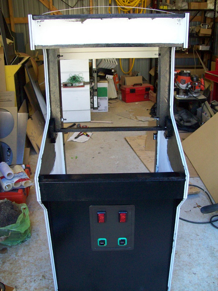

Ok, here's a slight update:
Got 4 coats of black hammered paint on the coin door:
Here is test mounted in the front of the cab:
Here it is from a little far back:
And here is the back view. (I dont have the bolts installed in the usb ports yet.):
Im pretty happy with the coin door.
Here is a pic of the boards I mounted to the bottom, the PC motherboard will fasten to these, and they should allow the air from the back fan to blow under the motherboard, and come up onto the hard drive:
Here is a pic of how I mounted the LCD monitor, using 1/2" EMT conduit and hanger straps:
Close up of the monitor mounting method:
Im pretty happy with the monitor mount too.

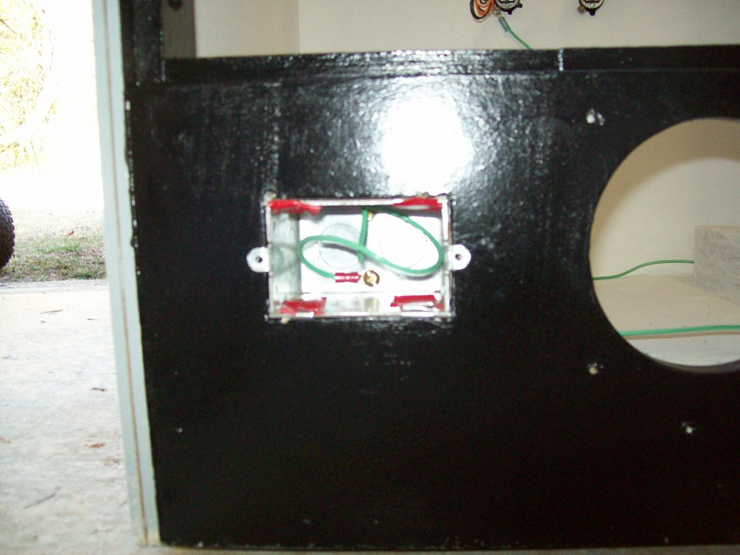

I had to hook up the lighted coin buttons to get a quick preview:
The camera does not do them justice, but they are a little bright. Im thinking of putting in a pot insid eteh cab so the brightness can be adjusted.

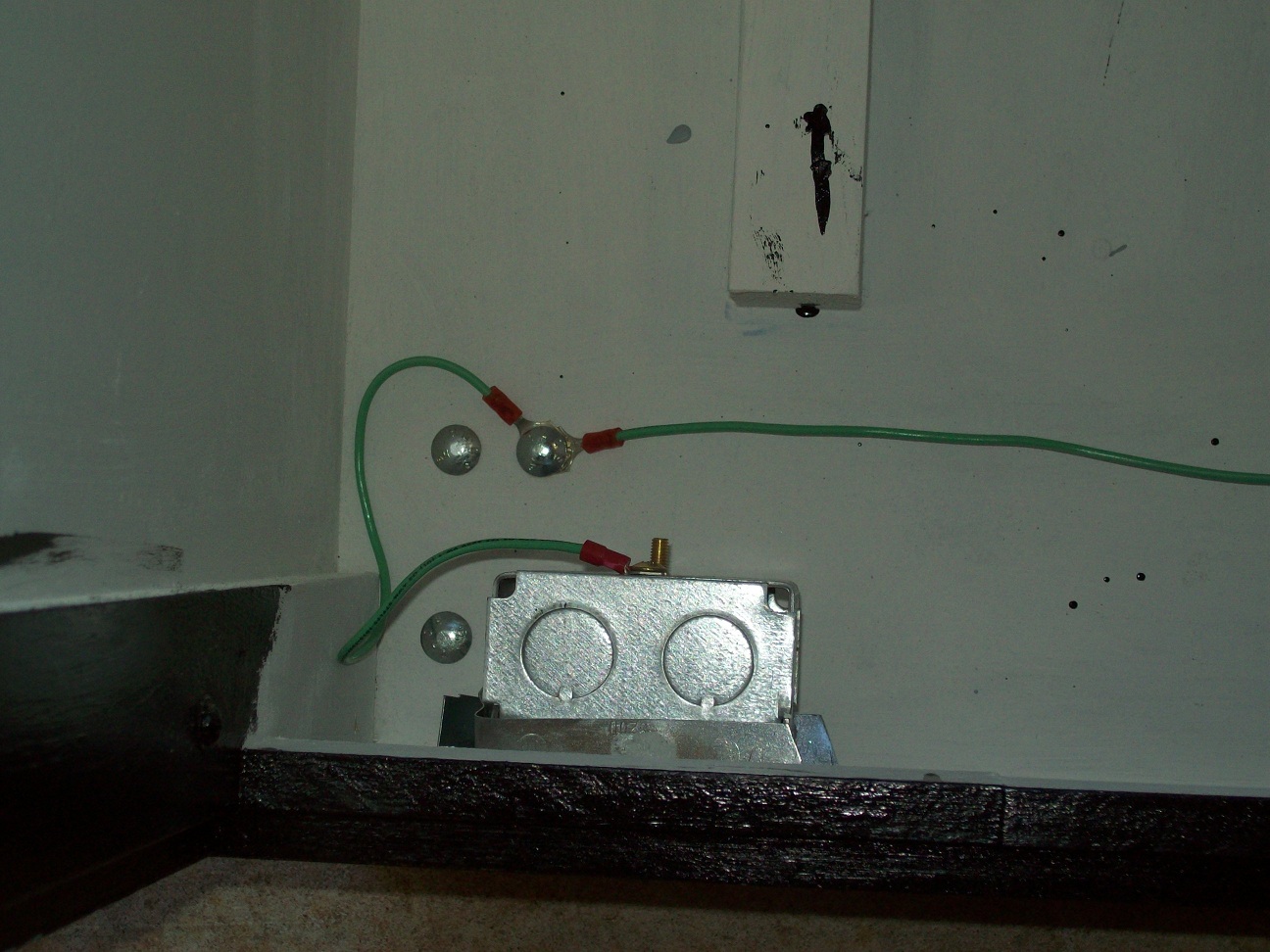

On the usb ports, I taped the holes in the coin door for 4/40 bolts.
The bolts fasten the usb port to the metal plate, then go through the mdf. On the backside, I will attach 4/40 nuts to hold the coin door to the front of the cab. The reason I tapped the metal plate is that I plan to ground the plate through one of the bolts, so tapping the plate should  give an electrically sound connection.
The USB ports have a removable grounding tab that grounds the usb shield to the usb port metal case. Im thinking I should remove this tab, since I will be grounding the metal plate with the above method.
Anyone have any thoughts on this?
Here is a close up of the 4/40 allen bolts Im using. (In my Slingblade voice: "Some folks call them cap bolts, I call them allen bolts. Hmmm")

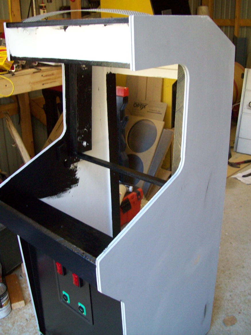

This little lady is just about ready to prime, just need to concentrate on the marquee now.

Ok, just a quick catch up.
I have the cabinet primed inside and out.
I had some left over white primer so I used it on the inside, but it wasnt enough to do the outside so I had to buy some more. They were out of white so I picked up grey.
So far I have painted the middle part of the outside black.
This pic also shows the coin door mounted. (Perhaps a better name for that would be credit panel, since it doesnt take coins and its not a door.)
I pained parts of the inside black, just in case any cracks show up between the panels.
In this pic you can also see the grey primer on the side. I got a few drops of black on there which I rubbed down before it dried. I have since sanded these places down and re-primed.
Here is the power entry box mounted (glare from the flash is crazy). The green wire inside attaches to the box with a fork connector and a screw, and it will be soldered to the power entry plug.
Here is an inside view of the same box. A green wire is attached to a screw. This will ground all the casters and the credit panel. This screw on the box will be my central connection point for all earth grounds.
The green ground wire loops to all casters, and ends up grounding the credit panel.
