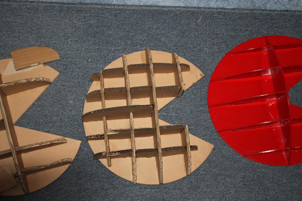

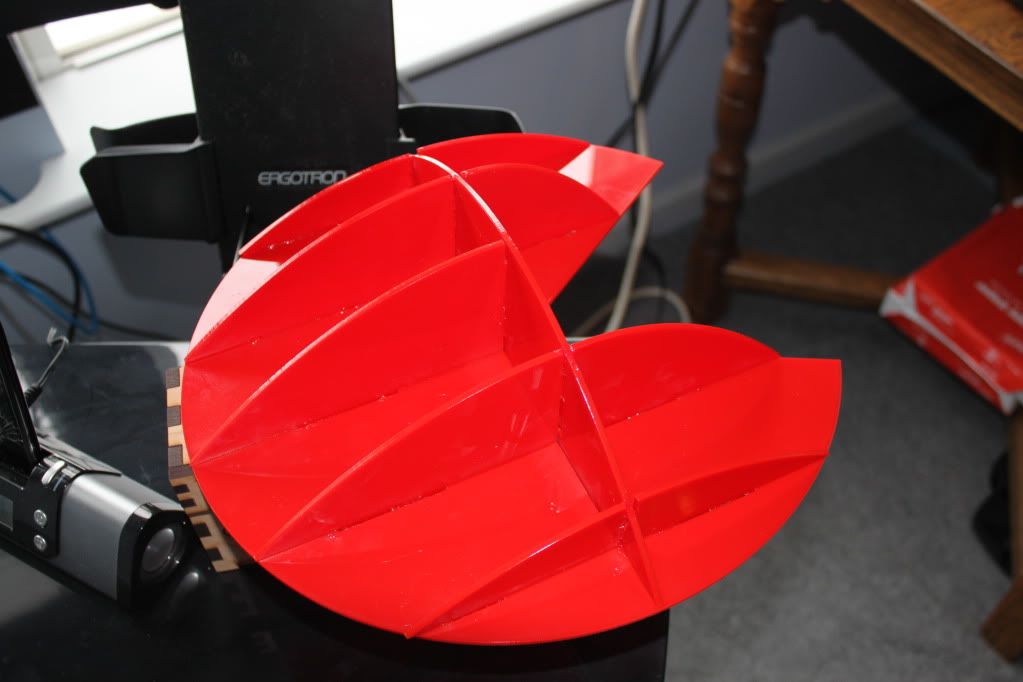

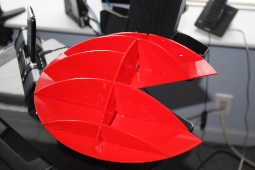

Its a 12in 4:1 scale model ...
I could then use my corel draw file in the laser machine to create these protypes ..
I used cardboard as i have no confidence in my math and it was ofcourse free ..
Then as I grew more confident with my file I used acrylic ..
http://i234.photobucket.com/albums/ee35/Jasonmm92/IMG_5195.jpg
http://i234.photobucket.com/albums/ee35/Jasonmm92/IMG_5196.jpg
http://i234.photobucket.com/albums/ee35/Jasonmm92/IMG_5198.jpg
http://i234.photobucket.com/albums/ee35/Jasonmm92/IMG_5197.jpg

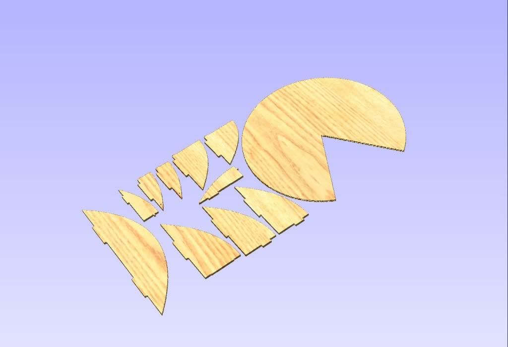

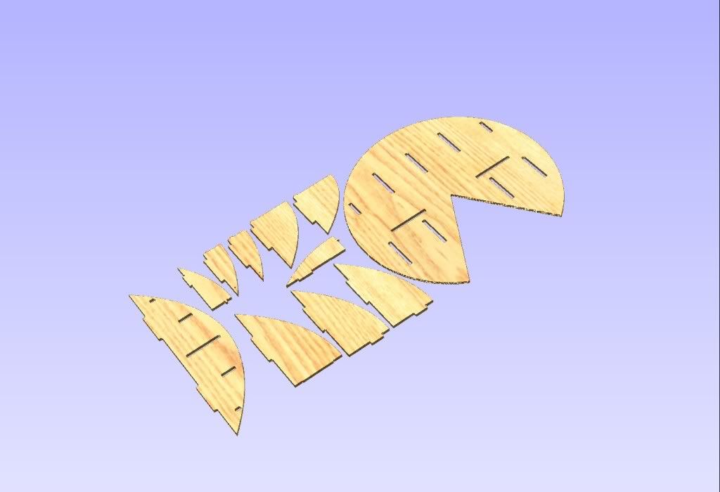

I was then able to create import the coreldraw file into the vcarve program and scale to 4ft by 4ft and set my tool paths ...
(note this file is still currently under construction )
http://i234.photobucket.com/albums/ee35/Jasonmm92/pacmancnc.jpg
I am going to finish this file , order my tmolding and cut the wood later this week ... to be continued ...

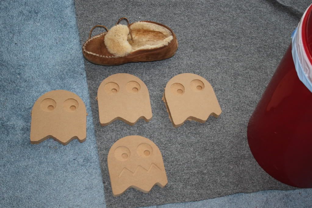

« Reply #4 on: February 22, 2012, 09:38:46 am »
We got ghosts !!
lol

I cut them out on the shopbot CnC machine ...
using a coreldraw file ...

profile and pocket cuts ...
cutting this tommorrow !!!
woohooo !!

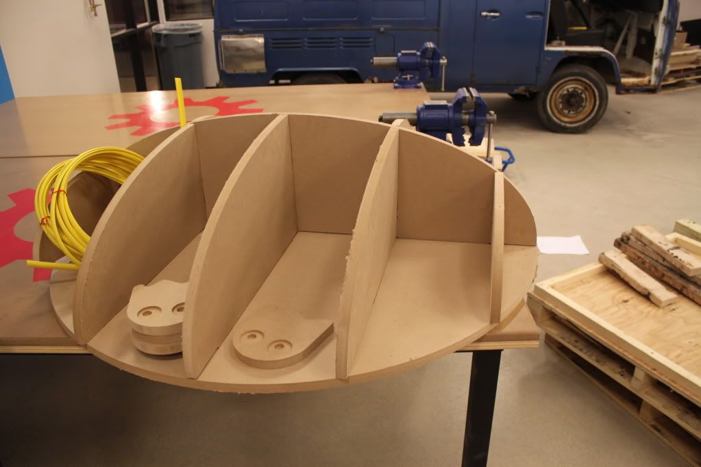

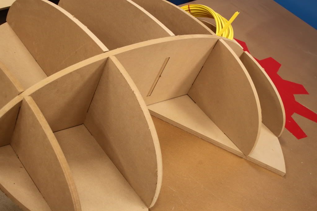

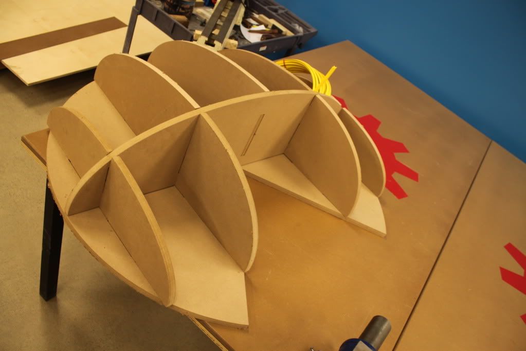

Update
Well I cut this out of MDF the other day and I learned a few things ... apperently the laser cutter can cut a perfect corner and the CnC machine cant ...
So the word of the day is ... FILLETS and the number of the day is 0.135
Back to the war !!
Jason

I guess it can make a perfect corner , had I created a better drawing , I am adding "Fillets" now ...
Mike, I am now using Vcarve Pro instead of CorelDraw for the Shopbot , do you use Vcarve ?
thanks Jason

Update
I wasnt happy with my 1st cut and I redesigned the whole file today in VCarve pro like a man !!!  ??? ...
 ( who knew mdf board from Lowes actually callibrates out at .76 !! geeesh , thus my slots werent perfect )
TMolding came today ... cutting this in a few days !!
Wish me luck again BobA !!
Jason

NO you can't cut a perfect corner. with a CNC or any tool using a round cutting tool. this is half true, it depends on the side of the corner cut you want to perform.
external corner : Perfect
internal corner : Impossible, you will always have the radius of the cutting tool used.
just remember you cut using a rotating tool that follows the tangent of your cut. just draw a schematic of a square and try to fit the round tool  in the corner, you will see
in order to have a perfect Straight corner, you woould have to use a tool of a zero dimension (impossible) that's why laser can cut quite perfect internal corners. it's much more thinner than any other tool

I see what you were saying now Jason. It's really only a problem when joining two pieces of wood, usually in a pocket or locking feature. I use what some call dog bone fillets. On a 90 degree angle, the tool needs to travel its radius past the angle. Here is a good example in some parts I cut recently.
Sounds like you have it figured out. Vcarve lets you choose this type of fillet. Good luck cutting.

« Reply #27 on: March 07, 2012, 11:06:56 pm »
Here it is , in all its glory , it wasnt perfect , but it was good enough for me ...
cutting tmolding slots tommorrow ...
thanks for looking Jason

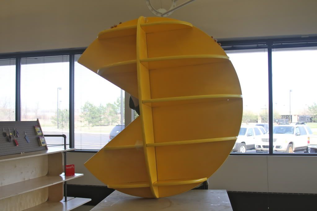

Saturday , I will be sanding those edges , slotting in the tmolding , and painting ...

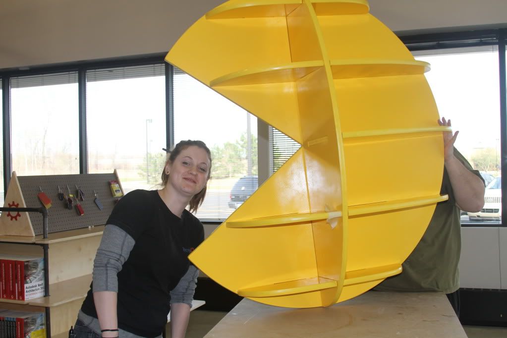

« Reply #33 on: March 11, 2012, 11:52:54 am »
Does anyone know how to fix those cornors ? I dont ... I butchered them ... ugggghhh !! recut the shelfs ??? ffs ...
I tried the bandsaw , the horizontal bandsaw , 5 different grinding wheels , a jig saw and the throw on the floor trick .... tripple ffs ...

I JUST FOUND OUT ... All the fancy equipment in the world , sanding is still sanding , and painting is still painting , and both sux ...
but here is it ...
its not perfect but its good enough for me ...
Jason
