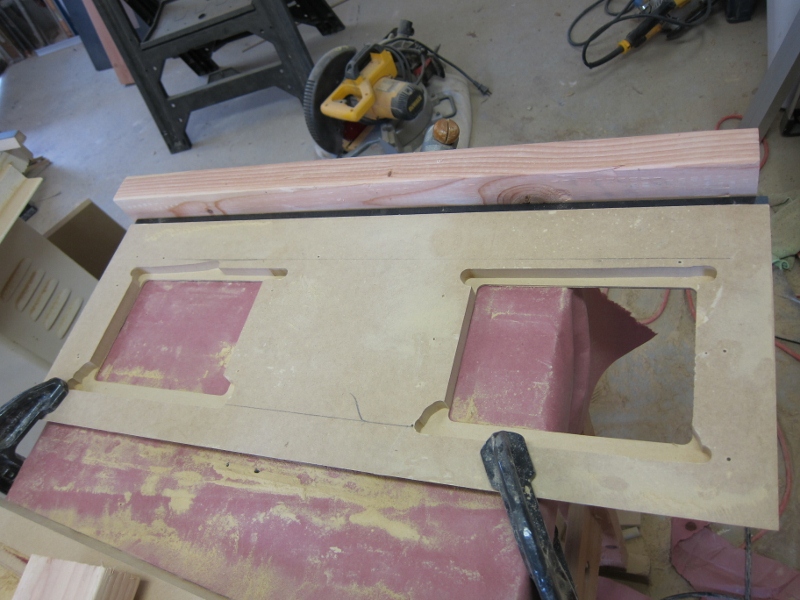

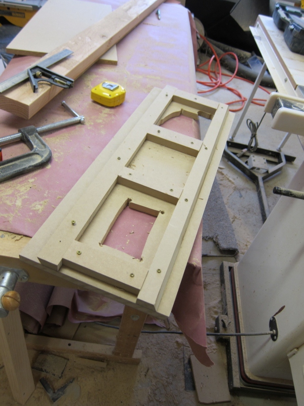

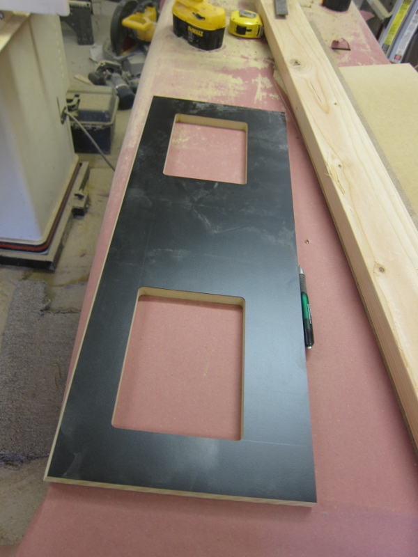

For some reason the speaker grill has been one of the most tedious parts of this project.  I won't say frustrating because working on it has been a lot of fun but it is taking much longer than I anticipated.
I tried using an old 5x7 picture frame as a jig but that ended up being a major fail.  I decided to make a jig using strips left over from cutting the cabinet.

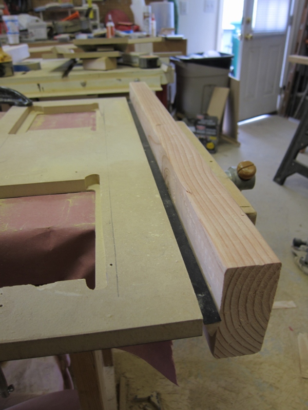

I want a 1/8" or so reveal so I had to plunge route around my opening to make room for the black mesh.
A 2x4 worked real well as an edge-guide.
I was a little worried about this part since the work piece was already laminated but it went very well.
My wife used this handy acrylic paint pen to paint the revealed edge black.   :cheers:
I'm going to use this to touch up other areas of the cabinet if/when required.
