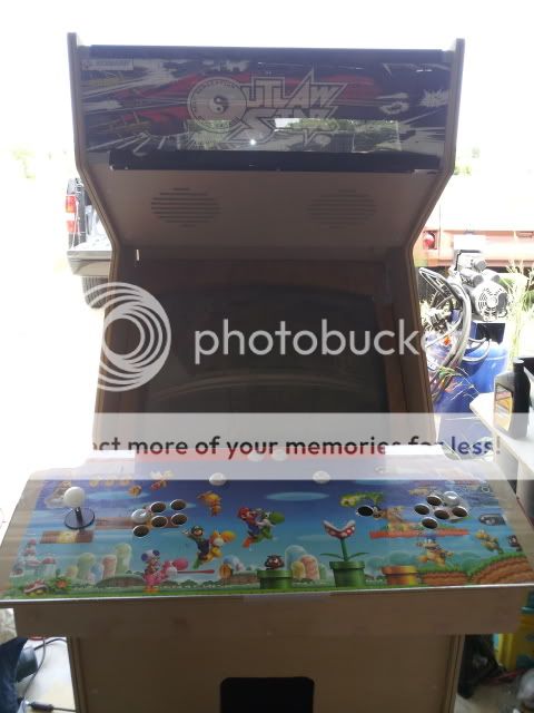

Ok.  Well here I go again posting a project announcement thread.  This time it will actually go somewhere.  (I made this one basically because I went in a completly different direction.  Hope that's OK.  Please delete the other if you want).
But after many, many months of thinking about I am finally about to get off the ground with my cab.  I have 4 days off this week (mon-thur) so I plan on spending as much time as I can on it.  Tommorrow my plans are to go to Lowes (cheaper then the Home Depot by me) and get a router, 3 sheets of 3/4" MDF, and some 2x2 for framing.  As well as stock up on some things I'm low on like wood screws and blades for the circular and jig saw.  Then come home set everything up and get the sides cut out at a minimum.  Basically I'm wanting to possibly get a cab that can stand on it's own at least in the next four days.  We shall see as I don't want to rush things.
And as far as the name, Fun Evil Jester.  That's an anagram of my first and last name.  Thought it would be kinda cool for an arcade name.  I was thinking Fun Arcade could be kinda like the brand name and Evil Jester could be kinda like the model.  Does that make sense.  Either way when it comes that time I'm going to have to enlist someone's help on here for the graphics design.
Here's a sketchup model of the cab.  It's designed after the Konami TMNT, Simpsons, Bucky O'Hare cabs.  The marquee in this model is just an idea for now and the side art is almost what I want but just needs moved around some.  Planning on 2 switchable 8 way joysticks, 7 buttons per player.  The basic 6 layout with a 7th button for the occasional 4 button game.  A trackball and possibly a spinner.  Will post more tommorrow with my progress.

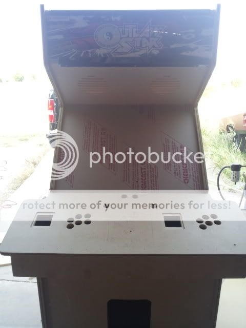

My pictures were too large so I get to type this again.   :banghead:  O-well.

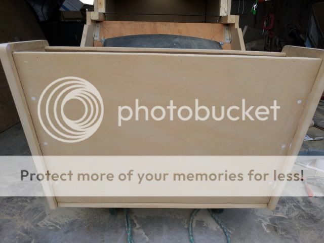

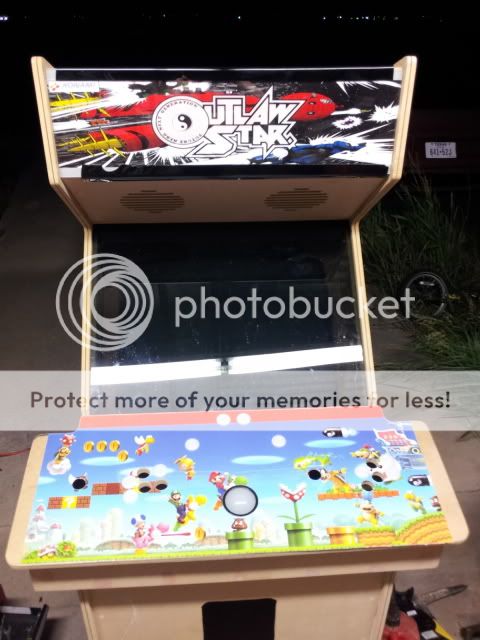

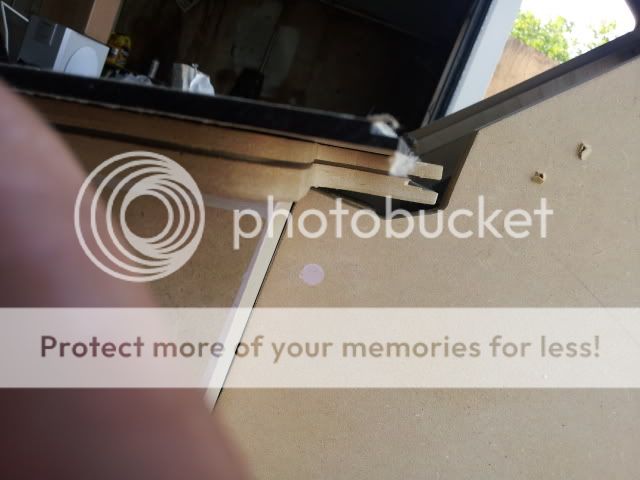

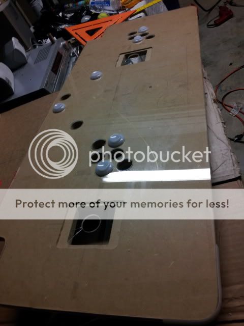

Since I don't feel like typing everything again.  I took the wife to Lowes around 2PM.  Picked up a bunch of stuff. (Wood, tools,etc).  Started work on the cab about 4PM.  Took me until 5:30PM to finish drawing out the 1st side.  Cut it out.  Sanded the edges straight, etc.  Used it as a pattern for the second side.  Made a small error in the top of the second side.  Not sure how but I put a small "dent" in it with the router.  I also made a quick and dirty mockup control panel box out of some left over 3/4" ply I had in the garage to use as a mockup for my controls and I can possibly use the top as a pattern.
On to the pics.
1st is the 1st side.
2nd is both sides together.
3rd is the "dent"
4th and 5th are the quick and dirty control panel.
emb

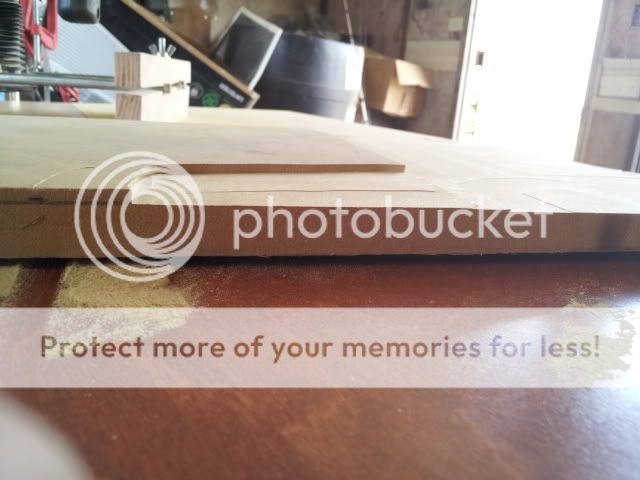

Got some more work done today.  I fixed my small mistake on the one side with a little bondo and sanding.  Fixed it right up.  Got a base built.  Got the panel for the coon door area and top cut out.  Then drilled and countersunk the sides so I could install them on the base as well as install the coin door panel and top.  The top is just held on with a couple screws as I still need to do some sanding on it.  Pretty much all that's left looks wise (sans control panel of course) is the speaker panel and the door(s) for the rear.  Then it's all inside stuff.  Thinking about decasing my tv because of the angle it will have to sit at.  Really don't want to but can't figure out how to safely secure the tv inside the cab because of it.  Tommorrow will cut out the speaker panel and build a good control panel for it.  Then work on the tv issue.  Need to add a little bit of bracing inside but it's suprisingly sturdy at the moment.  Won't get much done after that until I can get a slot cutter.

1 - how she looked before I got the top put on.
2 - The inside.  Bare but roomy.
3 - A small miscalculation when I made my base.  Gonna use some wood filler to fix the small gap.
4 - The quarter image my wife drew on the coin door panel for laughs.

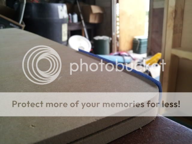

« Reply #8 on: June 23, 2011, 01:13:32 am »
As I haven't worked with MDF before this project.  My top piece got a small split in an edge when I screwed it into place.  Will this become a problem later on?  Should I replace the whole piece?  Or will it be OK.  It will be covered by the marquee retainer when completed.

It's basically a small hair line split.  About an inch and a quarter long.  I am predrilling my holes.  I think when I screwed it together the screw went in a little crooked.  That or I need to go up to the next size drill bit.  It's the only piece that's split on me so far though.
Will have a picture of the split up in a few hours when I get access to my other computer with the SD card reader on it.

Here's a picture of the split.

If you glued that joint... then it should be fine.  If you didn't glue it... then it should probably still be fine once the rest of the cab is put together.  If you get a split every time you put a screw in, then that would be different.

It's only held on with 4 screws so far.  2 each side.  I needed to see how my measurements lined up and clamps didn't want to hold it.  I'll keep an eye on it though.  If it splits anymore I'll just replace it and use this cut for something else.

If thats the only crack, you're probably fine. but like Woodshopflunky said, it is best to use hardwood strips inside (Like how factory arcade machines are made).
you can put alittle wood glue in the crack to step it from spreading.
otherwise your marquee retainer will hide the crack

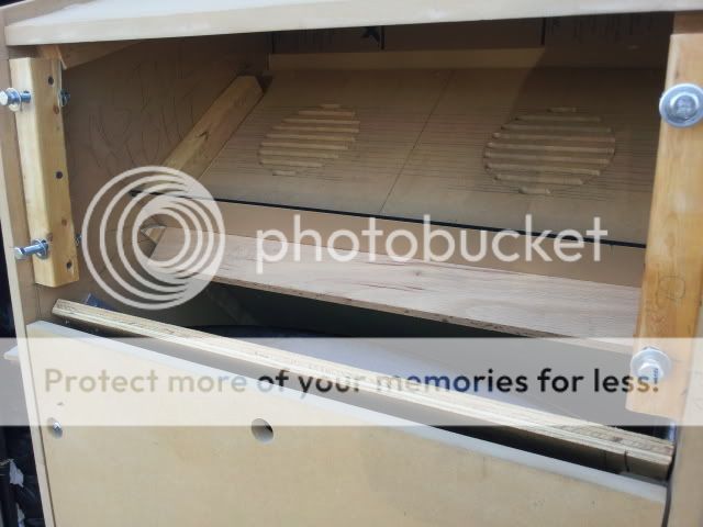

Can someone clarify this hardwood strips thing?  I've only seen the inside of an arcade machine once or twice and at that time I was more interested in playing the games.
Lengthy explanations, pictures.  I'm better with pictures.  Isn't everybody?   ;D
Take a look at my project - I use MDF strips to screw into
http://forum.arcadecontrols.com/index.php?topic=112442.0
The best photo is the back view once together, see how i used 100mm pieces of off cuts to screw the center pieces into. Makes the join 10 times stronger. (most people use a thin pine piece of wood. But i had plenty of MDF so used that

Heres another example of the wood strips used to hold cross panels.
Its not mine btw. just a pic I found online.

Hey WoLLiEnZ,
Thanks for the link.  Nice cab by the way.
Thanks mgb for the pic.
I have some 2x2 laying around.  Maybe a little overkill in spots but it wouldn't hurt anything to go ahead and glue and screw them into the existing corners would it?  Figure it will give strength and all I'll have to do is fill in some extra screw holes.

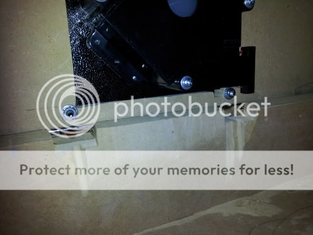

Re: Fun Evil Jester Arcade
« Reply #29 on: June 30, 2011, 10:44:26 am »
Got the coin door stripped earlier today.  Stayed up late priming it because I was having fun.  Need to get some sleep now but here is some pics of the stripped door.  Also got the hole cut for it and new locks.  Will paint it tommorrow and maybe get it put back together.

« Reply #30 on: June 30, 2011, 12:16:14 pm »
Looks good. Did you put anything on the door (paint stripper) before you used the wheel? I have a door I want to strip and was going to go the wire wheel route as well.
At first I just used the wheel.  It worked but had to keep the wheel in the same spot for awhile to get it down to metal.  I ended up using paint stripper in the end.  It took 99% of it off.  Then I hit it with the wheel again to get the other 1% and to clean it up a bit.  I would suggest just trying the wheel by itself because they both ended up taking roughly the same amount of time.  Also I have a thorough hatred for paint stripper now.

« Reply #33 on: June 30, 2011, 09:30:15 pm »
Got the coin door painted, reassembled, and installed.  I think it looks pretty good.
On the locks.  Does the locking bar on the back of the lock supposed to be up against the wood part of the cab or just against the door frame?

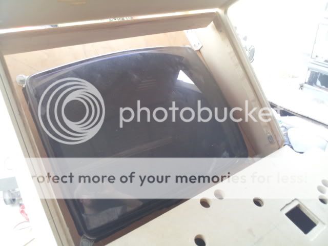

Got my TV decased and installed in the cab today.  Haven't got it exactly bolted down where I want her.  She sits alittle low on the right side.  Other then that she's working good.  O-yeah.  It's plugged in through Svideo.
Also found an old pair of PC speakers that originally came with this computer.  Sony Vaio from way back in the day.  I lost the 12 volt wall wart though so going to see if I can't hardwire them to a spare connector on the power supply.
Wouldn't mind getting a sub for that little extra bass kick but IMO just playing the games it shouldn't matter too much.  I guess I'll see when I get them working.
On to pics.  Crappy pics.   :-[

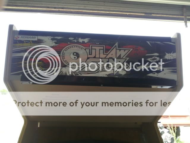

Also did some work on a possible theme idea and made a marquee.  I used images from the Outlaw Star Manga.  What do ya'll think?
The first is the original image slightly stretched horizontally.
Second is after some coloring and logo adding (WIP).
« Last Edit: July 26, 2011, 04:49:34 am by AlienInferno »

I'm not 100% sure on the logo.  I want the marquee to have the logo on it but I feel bad about covering up that artwork at the same time.  I'll work on it a bit and post an updated image in the next few days.
Checked my tracking number for my items from Ultimarc last night and it said they were still over in the UK.  Today DHL knocks on my door with those items.  They must have air dropped the DHL van right in my driveway.  Very fast shipping.  Expecially from the UK IMO.
« Last Edit: July 26, 2011, 01:18:21 pm by AlienInferno »
AlienInferno
  • Posts: 516
Got the rest of the ships colored in.  Also changed up the logo a bit.  Made it a little less transparent.
I like the way it look snow but am wondering if:
I should leave it as is?
I should color in the flames (missile launcher/engines)?
I should color the stars?
I should color both flames and stars.

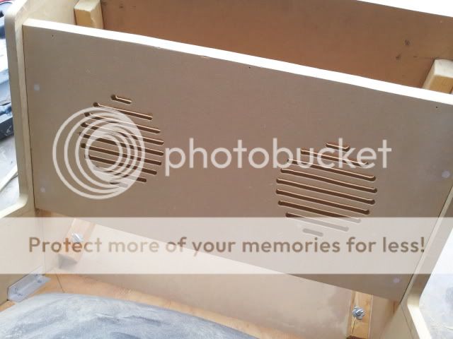

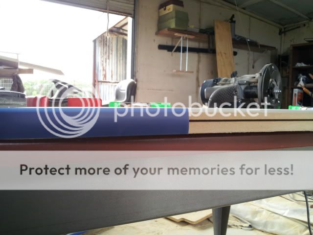

Worked on the cab for a few hours today.  Got the slots cut out for my speaker panel.  Need to get some sand paper and a dremel with a drum sander on it after them to smooth them out a little more but overall I'm happy with the way they turned out.  The slots are 3/8" slots spaced 3/8" apart filling a 6" circle.  9 slots total.
Also went to the local Lowes and got some plastic corner guards to use as my marquee retainer.  The bottom piece works great.  The top piece will work but needs some trimming.  It currently covers a bit too much of my marquee at the top.  Not sure if these guards are going to work or not.  Only time will really tell.  If they don't work I think I'm going to just make my own out of some clear plexi (black if it bends ok with heat) and bend it myself to the shape I'm looking for.
Anyway here are 3 pictures.  Took them to showcase the slots but the marquee is in them as well.  Nevermind the mess of pencil marks I made trying to figure out what size slots and circle I wanted the first time.

Hmm...  Now you have me thinking.  I like the slotted look for your speakers.  I was toying with doing drilled holes for mine, or use speaker cloth, or even a grilled look, but the slotted look does look pretty sweet.  Damn, man.  Good work there!

Thanks man.  I just did them for looks mainly.  The speakers I'm using are just some regular PC speakers.  Just going to cover the inside with some black cloth to deal with light seepage and keep people from seeing the puny speakers.  Now get back to the STTP!

« Reply #67 on: October 22, 2011, 11:41:40 pm »

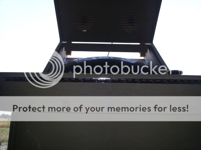

Finally got off my big fat bottom earlier today and cut out the panels for the permanent control panel box.  Was getting slightly flustered and made a couple bad cuts but managed to finish and clean up for the day.  Wasn't planning on doing anymore work on it but since the Rangers aren't doing to hot I went ahead and screwed it together.  The 45* angle cuts in the front lined up well but the back one's were all kinds of off.  Tommorrow all I'm planning on doing is adding some bracing for the corners on the inside as well as some sanding of the top edges to line them up better and add some bondo to fill/straighten out the gaps.

Been working on my cab the last couple of days while it was still warm.  Nothing really picture worthy.  Got some bondo work done on the control panel box.  Still have some left to do before it's ready for paint but gonna have to wait until we have another warm/dry day.  Hopefully will be able to finish it in the next week or so.
Also did some work on the back panels.  Broke it down into three sections.  A top panel to access the marquee/speaker area, the middle (main) panel for the tv/pc section, and the bottom section will be permanent with a vga out port and a IEC power jack.  The two removable panels will be held on with four 3/8" bolts each with the heads flush mounted into the panel.

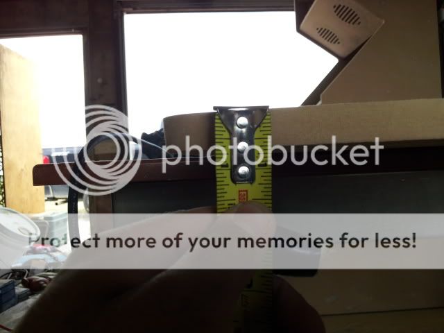

Not yet.  I do all my work outside.  The temps haven't been too bad upper 70's for a high most of the time but I find that a bit cold for bondo work.  Plus it's been rainy the last two days.  I did do some a few days ago but the bondo has a slight sticky feeling to it still.  My guess is since it's colder (upper 70's or below is my idea of cold) it's taking a L-O-N-G time to dry.
I need to find a way to trim an eighth of an inch or so off my base in the back to get the lowest panel to fit.  I might be able to use the router but need to pick up some things including bits.  Also decided to add a couple cooling fans into the top of my cab.
Besides figuring out how I'm going to attach the plexi it's all basically small things before I can paint.

Finally had an off day where it wasn't trying to rain so I got some work done.  Actually rain wouldn't have mattered as I forked out the cash and purchased 200 feet of extension cords today to run power from a small shed to my garage.  But here we go....
First thing I did today was slice my finger open on a brand new straight router bit.  That was great.  Then I proceeded to make a tool for my tool.  A router planer jig.  Got the idea from this webpage on WoodZone.com.  (I have more pics of this if anyone might need a how-to written up but I think the webpage I linked too does a pretty good job of explaining things)
Testing the jig by practicing shaving 1/8" off some scrap MDF.
After a couple tests I got it setup about right.
Then I proceeded to shave 1/8" off the bottom side of my control panel.  Made a couple mistakes as can be seen.  Just managed to dig the bit in a little too far somehow.
After some light sanding to get rid of some ridges I was pretty happy with how the rest of the panel turned out, bondo'd my mistakes, and sanded them down.
Here's a pic of me checking the measurements of the MDF.  And my taped up finger.  It didn't really bleed any but I wanted to keep MDF dust out of the cut.  The 3/4" MDF is now 5/8" MDF.
Also cut the T-molding slot for the control panel top.  It left a perfect 1/8" overhang.  Once I get the plexi for the top the T-molding should cover the entire side of the plexi and the mdf.

Air vents (think I'm going to router some air vents in the top of the cab and the bottom back door as well)
Here's the rest of the pics.

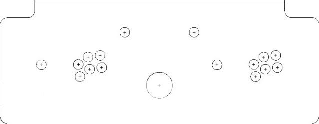

But during my off time and a little bit today I've been trying to figure out my button layout.  I've gotten my joystick locations, trackball location, and player buttons input into illustrator but for the life of me I can not figure out a layout for the two admin buttons (Exit and Pause).  I've tried putting them in the middle but that didn't look right so I'll move them around a bit and see what I can come up with.  I'll take input though.  Also going to try and finish all the cab except for paint this week but depends on when I get off work and how long it takes a few parts to get here.  So we'll see.
Here's the layout minus the two admin buttons.

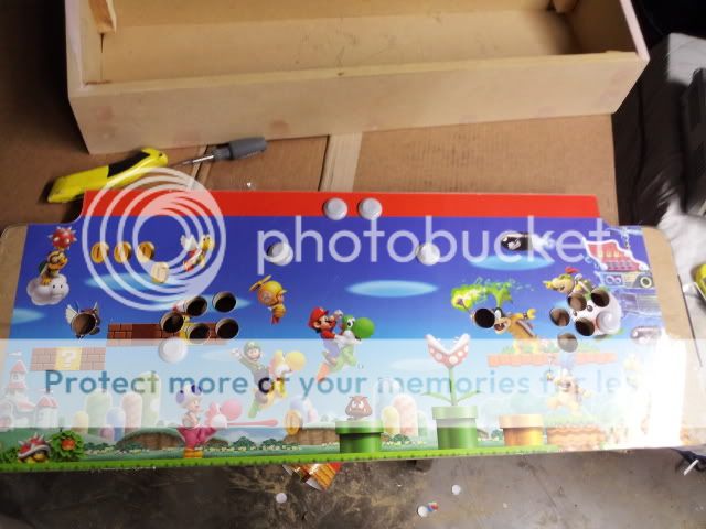

Friday night after work I finalized the layout of my control panel and printed out a full size template to aid in marking my drill points.

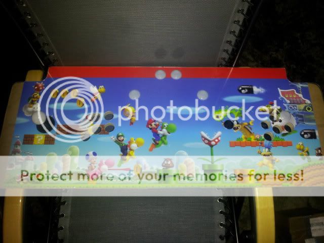

Saturday I marked the locations for the buttons, joysticks, and trackball and proceeded to drill/cut/route out the locations for the buttons and the joysticks.  After this I used the router to trim the plexi flush with the control panel and route out the circles for the buttons, etc.  Here's where the "two steps back" comes into play.  I used a drill bit for the two joystick holes in the plexi.  The first one went like butter.  The second (and last hole), it hung and cracked the plexi.   :badmood:  It sucked but it happens.  Ordered another piece of plexi and called it a night.  NOTE: I have not done the trackball yet just because I decided (for ease of install) to use the trackball mounting plate sold by GGG.
Here's a shot of the plexi installed and you can see the crack in player 1's joystick location.
Closeup of crack.

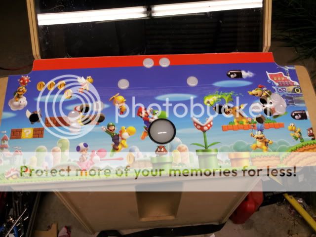

Temporary Artwork installed (Super Mario Wii poster)
Here is that same artwork with one of the joysticks installed. The dustwasher covers most of the cracking so for now this will work.  A new piece will be cut using the cracked plexi as a template.

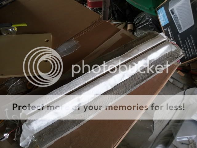

Sunday I proceeded to work on the rest of the plexiglass items for my cab.  Starting with the marquee retainer.
I made a quick line bender using a heating element strip I purchased from tapplastics.com using the element strip, a 2x4 with a 1/4" deep, 3/4" wide channel routed out down the middle, and a couple screws/nails, and some fiberglass tape.  I need to add some foil underneath the tape to help protect the wood underneath the element.
After this was made I cut the piece of 1/16" black plexi I had in half.  AND again to the "two steps back" thing.  It snapped in half about two inches two short while cutting.  Was a bit p/o'd at this one.   :banghead:   :angry:   :censored:  Again I ordered another piece of plexi and proceeded to bend the broken pieces with my line bender.  Found out it works well for 1/16", 1/8", and 3/16" plexi.  Got the pieces bend and used them to hold the marquee in place.  Other then the cracked POS's I think it will look good with the final product on the machine.
Here's the line bender thingy I made.
AND the busted up marquee retainers.

And finally on Monday I worked on the monitor plexi.  It's 3/16" solar gray plexi from TapPlastics.  This time I had zero problems with the plexi.  Used a straight edge and a router to trim it to the correct size as well as shave a small lip into the bottom to fit into a groove I made in the back of the control panel.  It took several tries to line everything up and work like I wanted but finally everything fell into place and it works great.
After that I took apart my eensy-weensy computer speakers and mounted them over the GIGANTIC speaker slots I cut out.  It looks funny right now but will eventually be covered with either black speaker cloth or just plain black cloth.
Plexi with protective film still on.
A brace I put along the top to keep it from sagging in the center.
A view of the bracing/rails/whatever from the front.
Trying to show the slot in the back of the control panel as well as the lip I shaved in the plexi.
The speakers.  LOL.
A view of the speakers slots from down low (looks like eyes to me)

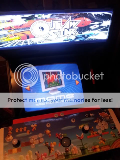

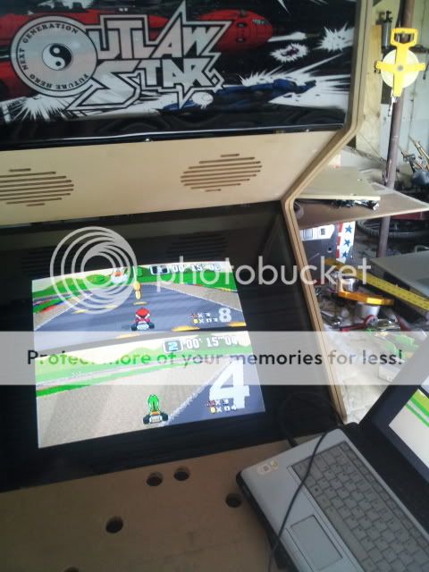

I braved the heat and dripping sweat to pull the protective film of the monitor plexi, hook up my laptop to everything, run power, and see what it looked like.  I must admit I like it quite a lot.  I will need to paint the area around the monitor either flat black or the same color I'm painting the outside in (semi-gloss) to help hide the inside of the cab but overall with the lights low you really can't see anything unless you actually look for it.
Still need to fill in a few holes I made while installing the monitor plexi, install the volume control, and the back admin panel but should be able to move onto paint within the next two weeks.   :)
Here's a shot of the cab with it running Super Mario Kart from the SNES.

After a couple days in the garage messing around in 100* + heat I dragged the arcade machine into the house and started painting. Got the first layer of prime on. Tommorrow I sand and throw another layer of prime on. But I will admit it looks good in white.
Sent from my SAMSUNG-SGH-I997 using Tapatalk 2

+1.  Marquee are is nice.  You should try a couple difference colors of light behind it.  4 in CCFLs are really cheap and use less power.  Plus, you can wire them at 12V.  I'm using blue in mine.  Big difference:
18" white florescent:
Blue CCFLs:
AJ
AlienInferno
  • Posts: 516
Re: Outlaw Star Arcade - Started Painting - 6/25/12
« Reply #105 on: July 16, 2012, 01:22:09 pm »
AJ
Right now my marquee lights are three 72cm white LED strips wired to the PC's 12 volt line.  It looks good to me.

Hey guys,
I've been thinking about what color/style of buttons/tops/etc I want for this theme.  I already have Electric Ice everything (Trackball, buttons, matching ball tops) for RGB lighting.  They do work well but I was a bit unsure of if that off-white color would look OK with the greens and yellows of the artwork so I made a mockup in Sketchup.  I think it should look ok with the white/white-ish controls.
I didn't mock these up because getting the controls angles was a pain but my other option I was thinking was going with Smoke bubble-tops, Nepthring knock-offs, the Paradise Arcade clear/black button combo (for lighting the rings of the buttons with RGB (or just green), and a green translucent trackball.  Allthough I'm thinking it would be nice to have at least the trackball and balltops match so I might go with a green bubbletop.
But would that be too much green?
Hmmmm................
