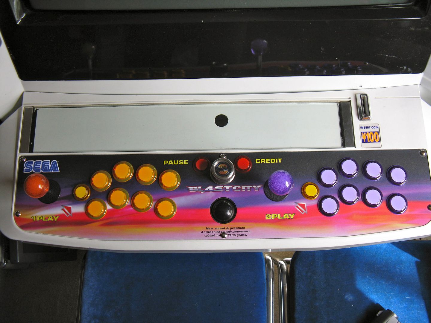

1. player 3 and 4 will only have 4 buttons
Good, cause I dont think there are many 4player games with more then 4buttons.
2. I'm thinking players 1 and 2 should only have 6 slightly offset pushbuttons,
I dont think this is a good option, IMOP.  Ive tried alternate button layouts such as
the so called Ergo "curved' layouts.  In play, I ended up mashing the side edges of
buttons instead of the center.. which resulted in extreme annoyance.  Try a test
panel and play against someone whos excellent at a 6button fighter for an hour, and
see if you have issues or not... before committing to that to a full CP.
3. Thinking of not adding any extra buttons for the trackball.
Good. But just remember, that you should leave at minimal, about 1ft diameter circle
around the ball.  Buttons are ok, but if you put a joystick too close, players will often
smash their hands into it when rolling the ball furiously in gameplay.  This usually
means offsetting the player 1 & 2s symmetry on the CP. It may not look as nice
visually, but you will be far better off playability wise.
4.  Last but not least, I could minimize admin buttons to Esc, pause, 1-4
player start with a shift button that would allow these 4 to become the coin buttons
too.  etc..
Admin buttons are a convenience. But they do add cost, and may not look as nice.
Its really up to you. They usually are at the very top of the cp, so they dont really get
in the way.  You could do something like a pop-up panel, or slide out keyboard.
Any other suggestions/thoughts?

My new panel. Frankenpanel? Yea or Nay? I did my best to not make it look frankenpanel but space was very limited. I spaced the art so it wasnt cluttered up but kept the original feel.
If you can explain the 8 buttons per player, it may help your case against it being a frankenpanel..
My guess is that he does consoles as well.

Not too bad, the 1p button and 2p button are in a weird place, and is that 1 1/2 inch trackball functional?

Yes my cab runs a full frontend with about a dozen or so emulators. And the p1 and p2 buttons went where i could only go with them. Yes my 1-1/2" trackball is fully functional. I have a thread in project announcements with plently more pics.

8 buttons is definitely for console play.
In a lot of console fighting games the 2 extra buttons, be they LT+RT, or L1+L2 or whatever are useful for navigating menus and doing other administrative functions.  If I were setting up a cab for Xbox 360 or PS3 use I'd definitely have them on there somewhere.  Maybe not next to the other six action buttons though.
Those start buttons could cause problems though.  In many fighting games the start button is the taunt button.  You don't want a random taunt coming out mid-match.  Same goes for if you ever decide to consolize and don't want a random pause during the match.
I think I would instead use that pause button there for 1P, and the Credit button for 2P, and then drill another hole next to the 2P button for credits.

Hey NipRing, what's going on with the rectangular area at the top of your panel? Next to the 100 Yen sticker? What's that do?

That's looks about as non-frankenpanelish as you can get yet still play a nice selection of games.
I'd say Nay.
and it looks great to boot!
Thats where a move strip would go.
