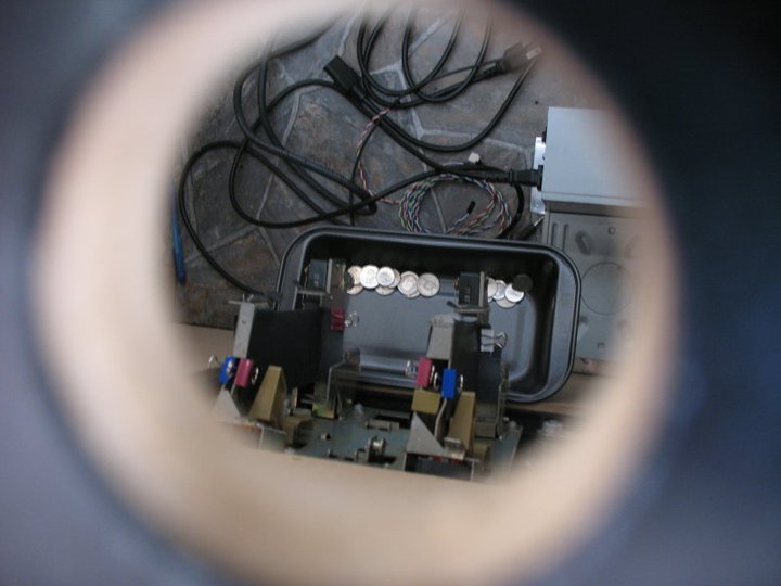

   So I am planning on wiring the coin reject buttons to insert a credit. And I just figured I might as well make the coin door work for the sake of authenticity. I came up with various plans involving welding, gorilla glue etc etc and I make a prototype with construction paper. And it works perfectly! So why redo it, when if in the future it breaks it will cost me 3 minutes and a trip to the dollar store? I folded some paper over to steer the coin down to the coin microswitch and put some butterfly clips on it. Ta da!
I'm going to wire the coin switches in parallel so that either one will trigger a credit. And same thing with my pinball flippers and the 7th button on my control panel... that way if some jerk standing next to the machine mashing the pinball flipper it won't be an issue for most games.

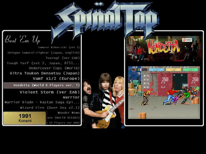

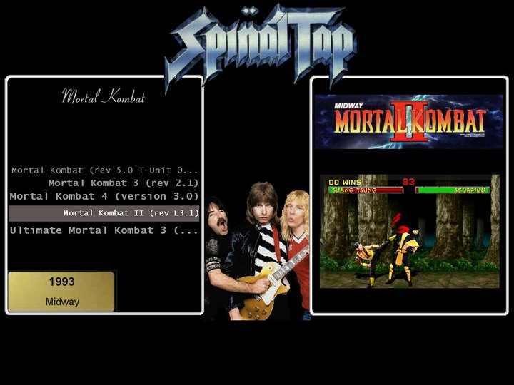

And finally what I did today was made a new menu. Screenshot with marquee above on the left, game lists on the right, game info on the bottom left. I've got nearly all the info stuff I need - except controls.ini and mameinfo.dat. I have them but not for my version [137] and I can't seem to find them. It'll all come in due time though. All that's left to do it make something to go right down in the middle of the menu - I was thinking a little explosion with a knob on 11.
I also made my own rendition of the marquee and sent it along with instructions to my graphic design friend. Hopefully it will come back good.
