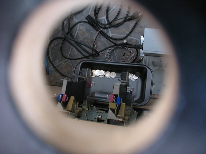

   I have no patience whatsoever. It's been just over a week since I ordered from GGG and I can't wait any longer! Around 4am this morning I was tossing and turning and dreaming of the arcade machine. So here's a little story of my coin door.
   I used to have a Marvel Vs Capcom machine. It asplode for various reasons, mainly I was beating some guy up and he grabbed a mic stand and threw it through the screen and ran away. Anyway, I sold all the parts from it and kept the coin door. A few years ago I stripped down all the stuff that it didn't need to make it smaller and to make it lighter, and also to make it less pointy out the back side. I cannot explain away why I wanted to do this, for it no longer makes sense to me. I made a perfectly functional coin door not work.
   So I am planning on wiring the coin reject buttons to insert a credit. And I just figured I might as well make the coin door work for the sake of authenticity. I came up with various plans involving welding, gorilla glue etc etc and I make a prototype with construction paper. And it works perfectly! So why redo it, when if in the future it breaks it will cost me 3 minutes and a trip to the dollar store? I folded some paper over to steer the coin down to the coin microswitch and put some butterfly clips on it. Ta da!
I'm going to wire the coin switches in parallel so that either one will trigger a credit. And same thing with my pinball flippers and the 7th button on my control panel... that way if some jerk standing next to the machine mashing the pinball flipper it won't be an issue for most games.

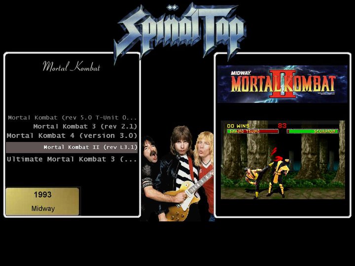

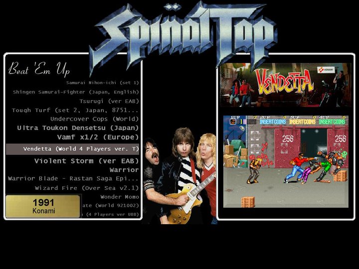

And finally what I did today was made a new menu. Screenshot with marquee above on the left, game lists on the right, game info on the bottom left. I've got nearly all the info stuff I need - except controls.ini and mameinfo.dat. I have them but not for my version [137] and I can't seem to find them. It'll all come in due time though. All that's left to do it make something to go right down in the middle of the menu - I was thinking a little explosion with a knob on 11.
I also made my own rendition of the marquee and sent it along with instructions to my graphic design friend. Hopefully it will come back good.

It's been a while, and I have done very, very little to this machine. But a friend came to visit the other day and he came bearing gifts. He was cleaning out his mom's shed and came across something so awesome that he knew I just had to have it.
After several consultations where I asked people where it would best fit, I decided front and centre.
The brass fits really nicely in with my theme. Of course. I may get some brass bolts and bolt it to the machine though because I've heard screws don't hold well in MDF. Better safe than sorry.
Unfortunately for me the reasons I have not been working on this as much as I'd like is because I am out of work and only making a little bit right now from my home-based business. Right in the middle of a big project my old studio computer bit the bullet and I needed to buy something new right away to get it done, so at least the little money I have been making went to a good cause. My new 'puter is smokin fast. As soon as I start bringing in the monies I'll be getting back on board with this build. It's epic and my friends are always disappointed when they ask if it's done yet and the answer is no.

Cap catcher?
It's funny you mention that. I have an idea for basically a cookie sheet with a lip on it that goes under the machine, and when the bottle cap drops it lands in the lip and goes under the cab. Then I can just pull the cookie sheet out and pour it in the trash at the end of the night.
Time and time again I have considering modding a mech to take bottle caps, and one day I might try it if I get another coin door. That would be really cool.
