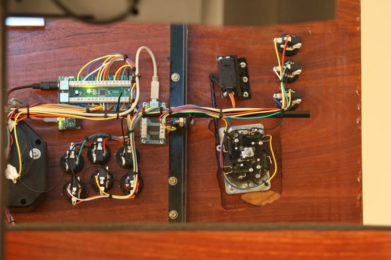

I thought about this today, to implement on my new cab. I figured it couldn't be too hard to do. From the software side, it's easy to execute a script before entering the game to check what should be the correct setting. From the hardware side I think it should be simple too, but would like to see what others think.
I didn't investigate much and I've been away from building anything hardware related for some time. Thoughts:
1. I was thinking a  standard servo should do OK to turn the 4way/8way plate 90°. And on the other hand, I see that using the joystick hardly produces any force upon the plate, even if it's loose (not locked by screws) it won't turn when used. So it shouldn't be a problem for any servo to keep the plate in place.
2. I need to find the way to use the servo with the computer easily. Maybe an IPAC with the led outputs and some electronics should do. I still have to investigate.
What do you think?, I'd like to hear ideas.

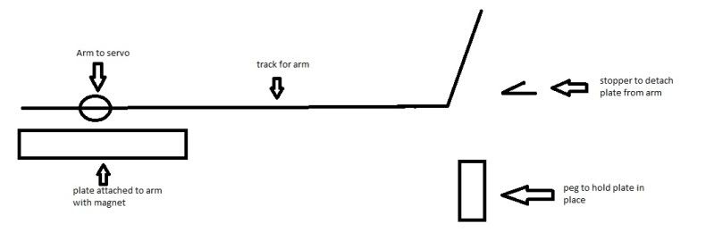

If you're using a motor to spin the plate one way or the other and it has stops in each direction, it probably wouldn't hurt anything for the motor to just pulse toward the direction that it's already in.  Kinda sloppy, but you really wouldn't have to do anything on the software side except for setting up the LEDwiz.
I wouldn't sell it to someone else, but I'd use it.
A small throw actuator would probably be the most reliable.   Mounted between the joysticks, it could rotate both restrictor plates.

The mag-stick plus is switchable from above the panel using a fairly simple mech so maybe you can borrow from it's design to modify another stick?

For anyone interested I just finished a prototype for my idea with servos and works very well, I'm very happy with the result.
From the software side I used either xset command or ledcontrol on Linux, both work good to turn on and off the scroll lock key. That I use it to drive a relay via a transistor, so that it consumes 5mA. The relay switches between two different resistance paths for the 555 circuit to send the different pulse sizes, which correspond to two different servo positions and thus, the 4/8way positions on the joystick.
It really works very well, and I like the servo corrects the position if it moves for any reason. I'll have to test it further and put it into stress now.

^^  show us, show us!!!
ranma
  • Posts: 80
  • Last login:October 05, 2014, 08:44:01 pm
Re: Anyone made a auto 4way/8way switching joystick?
« Reply #19 on: August 16, 2010, 09:49:38 pm »
Ok, just remember it's a quick prototype...  ;)
jimmy2x2x
  • Posts: 1215
« Reply #20 on: August 16, 2010, 09:55:19 pm »
Very nice!
  • Posts: 6173
« Reply #21 on: August 16, 2010, 10:40:10 pm »
 :o  That looks promising!
I hope it passes the stress-test.   :applaud:

That's much simpler than I thought you were going to build.  Simplicity is good!

Very nice!  When you wrote servo, all I could envision was those big servo motors on one of my vinyl cutters :)
I see that these gizmos are pretty common out there for RC / robotics apps and even come with a handful of actuators to play with.  I have a nice switchable stick build that might get one of these bolted on to see how well it can handle it.  I'm a little concerned about the torque and longevity, but it's definitely worth a try (now that I understand what these are)  There's also the "what if" scenario of something getting stuck.  They don't give up until they are in position, and I'm not sure what happens if they are physically prevented from getting there for a length of time.  Maybe that's what the gear rebuild kits are for :).

Couldn't it be made into an enclosed unit, with some kind of cap - maybe with screw terminals on the outside for the microswitch connectors?
That's actually the same concern I have, and I'm not sure what's the response. The good thing is that you really cannot force the plate to turn (and thus, do any force to the servo) using the joystick, the only way to block it is to keep it with force into a corner of the plate while the servo tries to turn the plate. In any case, this kind of servo costs 7USD on my country, and I think the price is half that or so in the US, not much to worry about.
If you work something similar, please let us know your experience.
An upgrade I made to the circuit is I took the relay out and used the transistor "switch" to enable directly the second resistance path for the alternate position.

ranma
  • Posts: 80
« Reply #31 on: August 17, 2010, 01:07:41 pm »
I guess I'm a little confused why you need complicated software to control this.  Seems like you could just set the position to 4- or 8- way and leave the signal on.  I'm thinking the limit switch would then turn off the servo for you, kinda like those "useless toys" that are on youtube.
A servo doesn't rotate continuously when you apply a signal (although they could be modified to do so), they go to a predetermined position according to the input signal. The good thing about a servo is that it's very precise, even with cheap ones, and on the other hand, it will correct it's position as long as you apply an input signal. This means that if any external force makes them move, they will go back to the same predetermined position.
As for the software, it's not complicated at all, I use the scroll lock connector of the keyboard encoder to send a signal to my circuit, led off is 8way position for the servo and led on is 4way position. And some additional scripting to check what the game needs before launching the game.

Speaking of cheap 5 buck servo.... any info on the servo used on the joystick in this particular thread.  I am looking for a servo just like that for a homebrewing related project, but alot of what I find are well over 5 bucks.
ranma
  • Posts: 80
« Reply #49 on: September 08, 2010, 12:20:13 pm »
One of these:
http://www.dealextreme.com/details.dx/sku.12859
You should be able to get one of those in any RC hobby shop I guess.

« Reply #57 on: September 10, 2010, 01:19:03 am »
ok i thought of a much more complicated but more interesting way. The idea would be to have the servo arm follow a track that would deposit the plate in place then detach the arm (thereby eliminating the stress from a moving plate). The idea is roughly outlined below (only one side of the track is illustrated but it would obviously be mirrored on the other side).
The arm would rotate around the track with the plate attached via a magnet. When it reaches the area where the plate should be there is a stopper which detaches the plate from the arm. The plate falls onto a peg which fits into a hole on the plate and holds it in place. On the way back the arm would come over the plate and pick it back up with the magnet and travel to the other position where a similar thing would happen. It is fairly complicated and would be difficult for someone at home to build but it was what i thought about in the shower and that is what i came up with.

Sorry to revive an old thread, but I just completed a new cabinet and was checking to see if anyone else had done the auto 4/8way joystick.
I'm using Ultimarc Mag-stick plus joysticks, and a Pololu 6-channel servo controller. When the game is selected in the FE, a small batch file runs that will automatically tell the servos to move to the 4 or 8-way position and then run mame. Works a treat- I'm really happy with the result

Well, I don't have a build video... but will see if I can describe it.
Servos and servo controller came from www.robotgear.com.au but any local hobby/robotics store should have this stuff.
I used these servos http://www.robotgear.com.au/Product.aspx/Details/421
And the Pololu 6-channel micro maestro servo controller http://www.robotgear.com.au/Product.aspx/Details/403
I fell in love with the servo controllers, they are very flexible and quite small.
This shot has the I-Pac keyboard encoder, one Pac-Drive LED controller and the servo controller. The servo controller is the really small board under the keyboard encoder.
The joysticks I used are Ultimarc Mag-Stick Plus 4/8-way switchable. The white lever on the site is part of the locking plate. There's a small lump on the joystick housing that helps keep the locking plate in the correct position - I removed it using a dremel so the servo has an easier time moving the locking plate. I could probably have left it there, the servo is surprisingly strong.
It's really just a matter of getting everything mounted and connected, and that will vary according to your control panel. Most of the stuff was just found about in the shed - the push-rods that connect the servo to the joystick for example are simply steel rod that has had a flat section ground into each end. They are connected to the joysticks with very small nuts and bolts that came off an old broken helicopter (model). The servo controller itself runs off USB power, but it needs an external 6V supply to power the servos. I'm running my servos off 5V, as that's what I had available.
The servo controller contains a small amount of flash RAM, and it comes with software and a simple programming language. With a servo, you simply tell it where you want it to "be" and it will rotate to that position and stay there. Any attempts to move it will be met with resistance, depending on how strong the servo is. The position will vary according to each build. You can use the software that comes with the servo controller to play with it until you find the right value.
You can use the software and move the slider, the servo will move in real time. Basically I wrote the following script in the above software and saved it to the servo controller. The script gets called whenever I want the servos to move.

I'm no coding guru, so all this does is set up some simple logic - If I call the script with the value "8" (or no value) then it will tell both servos to move to position 4105. If the script is called with any other value, the servos will move to position 7373. (The scripting language uses RPN-like notation, which is why it might look a little odd) These values were found by experimentation.
The batch file (I'm using Windows XP) looks like this and I call it "runmame.bat":
Code: [Select]
@echo off
d:
cd d:\mame
findstr /b /r "%1$" game-stick-mapping.txt > result.txt
for /f %%A in ("result.txt") do if %%~zA NEQ 0 goto four
echo 8-way
usccmd --sub 0,8
goto end
:four
echo 4-way
usccmd --sub 0,4
:end
mame "%1"
Again, I take the easy way out. I have made a hacked version of controls.xml and it simply contains the rom names of roms that are 2 or 4-way games. I did this as my XML parsing skills are non-existant, but I can write a simple batch file :)
Basically, the batch file searches for the ROM name in the file "game-stick-mapping.txt". The result is written to a temporary file. If the file size is 0 then obviously the ROM name wasn't found so the assumption is made that the game is 8-way. It then calls the servo controller and passes the parameter "8" (or "4", if the ROM was found) and then finally calls mame. The file I use is here (but all credit should go to the creators of controls.xml, any mistakes are likely to be from me) http://pastebin.com/download.php?i=twbzDgSf
The batch file is therefore called like you would mame:
runmame.bat 1942.zip
I use Hyperspin as the front-end. Hyperspin won't run batch files, so I came across a utility called "Bat-to-exe-converter" here http://www.f2ko.de/programs.php?lang=en&pid=b2e
You can feed it a batch file (like the one above) and it will "convert/compile" it into an exe. Hyperspin then accepts this exe instead of mame.exe. (although I don't pass any other parameters to mame.exe - I have it all set up in mame.ini. If you pass parameters through you might need to adjust the batch file)
I'm sure someone with a little coding knowledge could write up something that properly parses controls.xml and calls the servo controller directly. I thought about trying - I used to do a bit of C coding, but that was over 10 years ago... so it's a bit beyond me at the moment.
« Last Edit: January 02, 2011, 05:57:35 pm by terrahwk »
