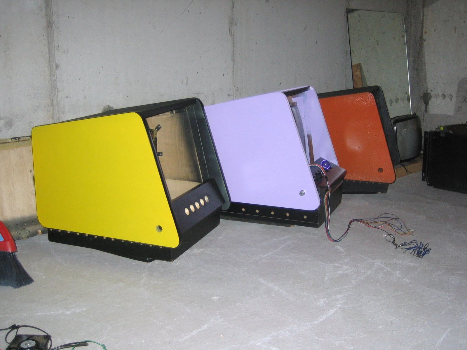

The CNC process has begun. I have learned quite a bit about drawing the parts and operating the equipment. We started around 3:30 by mounting the board and starting a dry run where I found out I had the speed set a little to fast and my drawing needed to be rotated 90 degree. So, after fixing those issues it was about 5:30 we did another dry run and had to move the board and remount it. We then crossed our fingers and turned the router on. Everything went perfect! I didn't have a chance to take any pictures of the process (I will do that tomorrow) because I was very busy holding the shop-vac. We then cleaned up the shop and called it a night (by then it was 7:30). I am going back tomorrow to cut out a few more pieces, hopefully all of them.
The following are a few photos of the back panel.
1. Back panel outside - The holes are for power, fan, reset button, and vents at the top.
2. Back panel inside - Pocket cut for the fan.
3. Back panel outside - Primed and ready for sanding.

That was fast! Yesterday, (3:30-10:30) I completed all of the pieces, everything has been cut with the CNC router, the edges have been slot cut for t-molding, and everything has been lightly sanded by hand. I have attached a few photos of the machine and the results.
Tonight, I will be priming and sanding the pieces. I hope to start putting everything together over the weekend.
1. CNC Router
2. Cutting out the front piece with pocket and holes for the speaker.
3. Front of the control panel.
4. Back of the control panel with pocket for the joystick.
5. Front of the front piece with holes for the speaker.
6. Back of the front piece with pocket and holes for the speaker.

I have three bartop's I'm working on. Sadly I broke one of the monitors so I now need to purchase a 15" LCD.
Was it easy to de-case your monitor ?
Mike,
It was very easy to de-case the monitor. The plastic bezel was removed by running a small flat head screwdriver around the outer edge to unlatch the plastic tabs.
mike boss

Not to take away from your thread, but I ended up breaking the neck of one of my monitors.
I figure a 15" LCD @ $40 used is better (and easier to find) then a 13" arcade monitor.
I'm thinking every little fraction of an inch will help, hence the reason for de-casing.
Again I think you !
(  my trio : http://3.bp.blogspot.com/_QAVXNwPpzL8/S7i8ZkRKhvI/AAAAAAAAEAw/FRnGUolW8FU/s1600/Putting+It+Together+%287%29.JPG  )
