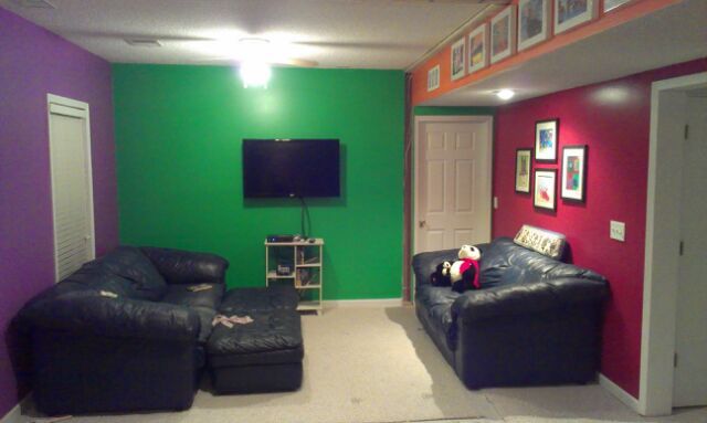

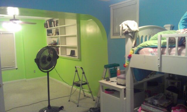

We moved into the house about 8 years ago and the basement was already finished.  It was an excellent deal.  Only 2 problems:
1.) instead of a hung ceiling, it's drywall with popcorn on it.   :angry: :angry:  So, I can't get to any of the mechanicals.
2.) it was chopped up into a sizable rec-room and 3 tiny other rooms.  :banghead:

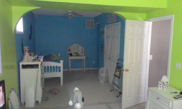

So, since my teen has been living in one of those tiny rooms (her room was 10x10), and my office was just a place where she chilled and LOLed and OMGed on facebook, we decided to combine the rooms by having the wall and closet removed and having an arch put in.  Since it was load bearing and I didn't want to pull a permit and don't have the equpment for a load bearing basement wall, we subbed it out.  It turned out really nice!
Here it is finished.  Pretty much in decorator mode now.  I'll let the chix handle that.
Reverse view back into the bedroom part:

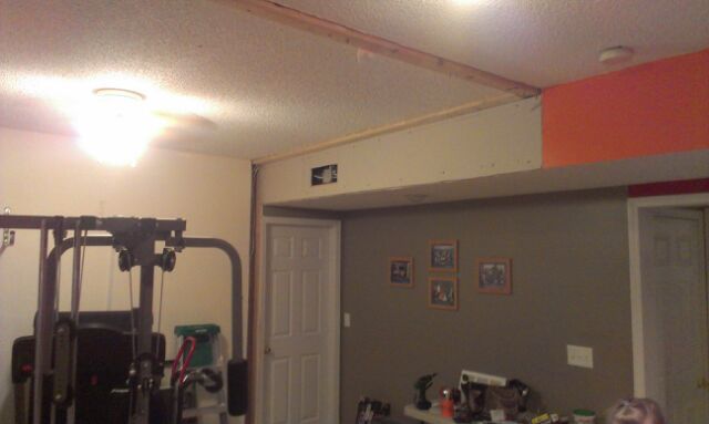

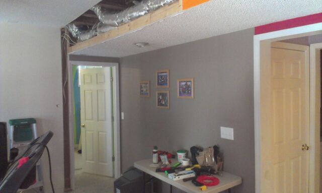

So....during these discussions....I mean debates, the executive branch (wife) was up to entertaining taking out a worthless 9x9 room that we'd had our treadmill and gym in and including that extra 130 sq. feet (including hallway) into the rec-room and building and arcade/billiard basement with a little TV area for the kids.  Having it included in the other construction was carefully considered, but being DIY king of the neighborhood, I decided I'd save the extra $1000 in labor and just DIY.  So, first was demo days.  IN 2 days, I managed to get the walls out of the way (these were deemed non-load bearing by a certified dude, so...)
This orange wall was the easiest, since it only had one outlet facing out.  It was also the wall that you saw from the rec-room area:
This wall was a bit more tricky since it had a circuit that powered the fan/light/outlets in the room in a ring circuit.  I also found out that this circuit powered a small room under the stairs with a couple of small florescents and an outlet:
Looking out from the old office/bedroom, you can see all the drywall out:
End of demo-day 2:
The area that is exposed will be a TV room area with a 42" LCD on the wall, the Wii and the Gamecube.  There'll also be some shelving (I might do built-ins) for the kids crap.  The carpet will be ripped up and I'll be doing 12"x12" black and white tile just in that old room's footprint to optically break it up from the rest of the rec-room.  Then, we can move all the unused baby toys and broken crap to a dumpster and start working on saving for a pool table, pinball and move the arcade in there.  MINE!  MINE!MINE!MINE!MINE!MINE!MINE!MINE!
Now, I had to relocated the romex runs that fed power to the fan/light and the rest of the circuit.  So, I fished new romex over to the single gang box that had the 3 way switch in it for the hall's can-light, connected all of them in a metal dual gang box for code spec and placed it all up inside the newly exposed mechanical throughway in the ceiling:
The metal box is facing out with a cover on it.  When I re-drywall the mechanical throughway, I'm going to put a large return vent there so I can just pop it off and get to the box.  Also notice the closest switch on the wall no longer has 1 switch, it has 3.  :afro:
All circuits have been tested and everything is working perfectly.

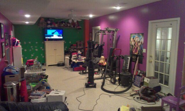

Thanks!  Yeah, demo blows donuts.  I don't like the mess and I have to get a 10 yard dumpster now...probably around 200 bux.
So, here's what I'm moving.  Basically, all those wire shelves will be gone, the TV and credenza will be thrown out and a pool table will go in this space.  These leather couches (under the crap on the left and right wall) will be moved down to the demo'ed area and "frame" the TV room.  I'm going to put the arcade in the right corner.
Got out the C-L Smoothes (Coors Lights) and got to work on the drywall tonight after a 9 hour day finishing up the wiring and cleaning up.  First, I noticed that the bed of the mechanical through way was sagging where they had to start a new 2x4, so I pulled up the joint with some 1" metal strapping.  Then, I started working on drywall.  The 2 pieces that I'm using were in the dumpster from the wall delete that the sub did.  They were exactly right for the covering of the mechanical through way.  Luckily, I'm a dumpster diver and pulled them out of there a couple of weeks ago.  Perfect fit:
I'm going to put a 14" x 6" return vent cover over that hole so that I meet code and can get to some mechanical stuffl.

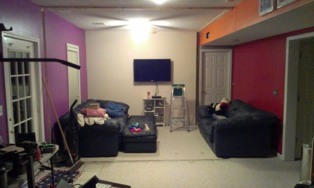

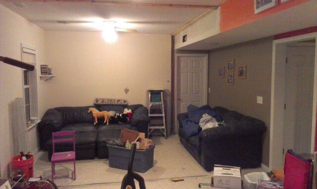

Quick update...lots of work.  Hung the 42" LCD on the wall, spliced in a new direct TV line.  I'm planning on hanging a 21" tube TV on the opposite wall once we get the arcade down there and the pool table.
So, here's how it will look laid out.  I found all the old paint for the walls, too.  We'll be extending the paint scheme down the walls.  It's Disney paint from HD and it's been down here for 5 or 6 years.  I have about a quart of each color.  Hopefully that's enough.
That book case won't stay.  It's temporary until a new solution can be found.  That's the gamecube that still gets a ton of play...

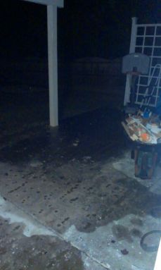

Major accomplishment tonight.  I actually put 5 cubic yards of drywall into some garbage bags and eliminated the trash pile on the back patio.  I couldn't see getting a $300 dumpster so I'm going to put it to the curb.  The drywall mess fit into 15 39 gallon bags that will be brought to the curb tomorrow night.  Hopefully they'll just take it and not ---smurfette---.
Also, while I was breaking drywall into small pieces and putting it in bags, the executive branch started coloring the walls.  We decided to keep the colors that we already had since we kept enough paint to get it done.  She did an awesome job and got it done.  The back wall was supposed to be green, but I failed to fix the hole that was there, so I got some crap for that, otherwise it would be done:
And, the patio is clean-ish!  5 yards of drywall and 2x put into bags and piles of stuff I can burn this weekend:

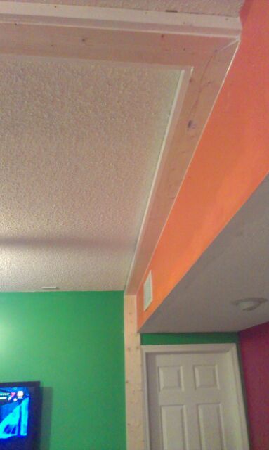

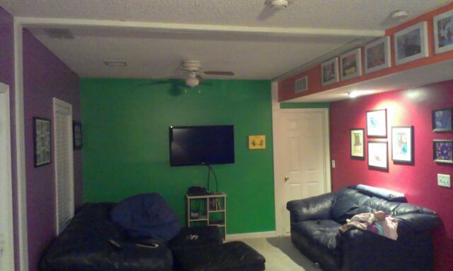

Got some done over the weekend.  We're still not sure what we're doing about carpet.  The carpet mills that have the arcade carpet don't sell to the public and they recommend a industrial certified installer for their carpet, so I'd imagine $$.
Anyway, here's the room almost finished.  On payday, I'll be capping those exposed areas with 1 x clear pine and painting that white.
From here (same view):
