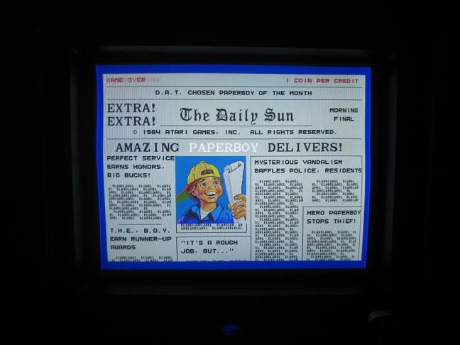

I have a question for those with a WG D9800 (or equal) monitor; what resolution do you run medium res 25hz games at (Paperboy, 720, Championship Sprint etc.)?
AVRes set those games to 512x448 and they flicker like mad. I get a headache after playing for 30 seconds. I really want to play Championship Sprint as it's a really cool game. :)
Finished project: "The Saloon Arcade" - 2 player upright cabinet

Medium Res aka EGA is usually in the neighborhood of 512x384 progressive.  Standard Res aka CGA is either ~320x240 progressive or 640x480 interlaced.  Some games have a resolution vs. refresh tradeoff (higher resolution means lower refresh and more flicker).  Exact resolution used varies by game.
512x448 seems unusually high and a strange pixel aspect ratio (though those are not unheard of with arcade games).  I kinda wonder if perhaps you've chosen a CGA compatible resolution and are software scaling.  That resolution at CGA would be interlaced which might explain the flicker.  If it's progressive EGA compatible timings, it would be at a low framerate, which might also explain the flickering.

Definitely 512x384

I tried 512x384 and it looked awesome, except for one small flaw. I couldn't quite center the image the way I wanted to (I couldn't move the image to the left or right with the OSD functions, only resize it). Are you guys experiencing this as well with your D9800's?

I'm running 512x384 for 720, narc, and paperboy and i'm running 496x384 for virtua fighter.  VF looks great on my monitor, but the other three have the weird hour glass shape that I've complained about in the past.  Even the MK games have it (which I run at 399x253) but its not as bad.  I can't get rid of it by tweaking the controls.  All other resolutions look great which is why I haven't complained too loudly about this.
And yes, I can't seem to center the 512x384 games either.  Do you get the hour glass shape?  I also get pretty bad warping during paperboy as the screen scrolls.  I'm using soft15KHz by the way.

Same happens to me, weird hour glass shape which I can't get rid of with the OSD. The MK games look great though, can't remember having trouble with those.
Also, I haven't played Paperboy alot yet, so don't know about warping. As long as I can play Championship Sprint then I'll be happy. :)

Seems like pincushion should at least help minimize that a little bit.  Does it not help?

It does help but there's always that buldge that won't go away.  And you'll notice in the screenshot I posted, the bottom of the picture is angleing in and the top is angleing out.  Pincushion won't bring them both in.  I have messed extenstively with the controls to try and fix it and I can't really get close.
Have you tried adjusting the "trapezoid" control?  It looks like you could adjust that out using a combination of "trapezoid", "pincushion", and maybe (if it has it) "bottom corner", probably adjusted mostly in that order.  The adjustments interact a little, so you may have to go back and forth for a while.

yeah.  i've messed with it extensively.  perhaps a professional calibrater could do better than me, but even messing with the trapazoid to even up the top and bottom, there's still the bulge in the middle
