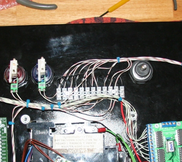

I also worked on getting the LEDs and LEDWiz all wired up.  It was a bit intimidating at first, but once I got into a rythm, it wasn't bad at all.  One of the most time consuming (and important) aspects of the process is determining the placement of the various boards and the direction things should face so that all of the wires reach their respective connections AND it all looks relatively neat and tidy at the end.
Here's what it started out like...
And the finished LED wiring...
That white terminal block at the top connects the "power" wires for all of the LEDs together.  I basically made small jumper wires that go between each terminal so they're all connected as a single circuit, then a 5v power source was connected to the end terminal, providing power for all of the LEDs.  There are other ways to do it, but this seems to be the cleanest method.  Still need to put an inline fuse on the power wire.
What'ya know...  it all worked the first time!

Looks like you wired the track ball to your TT2 spinner is that right?
Yes, though I actually don't have it wired yet, the TT2 spinner controller board does also have the ability to connect to a trackball, therefore the IPAC2 was the only other board I needed.
