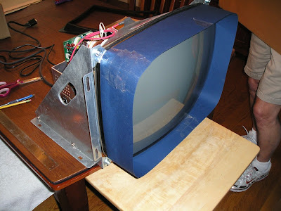

Anyway, next up for this thread is the monitor mount - this was so difficult and I definitely could not have done it without the help of my dad (and mom!). From the start of this project I knew the monitor mount would be tricky because I was going to deviate a bit from the original design. I did not want to put bolts through the side of the cabinet in order to support the monitor.
I don't know why... maybe I just didn't like the thought of poking holes in the side art. The problem with wanting to do this is that the sides are only 9/16" thick which isn't nearly enough material to screw into to support a ~50 lb. monitor so I had to think of a way to get the monitor at the proper angle and supported from the bottom.
Another problem was that the monitor had triangular brackets on each side which supported the monitor in a horizontal position. When placing the monitor vertically in the Donkey Kong cabinet these brackets stuck out the back - this is obviously unacceptable so they had to be removed. Compounding the issue was that these brackets also held the electronics of the monitor in place! See:
The final problem was making a frame for the monitor. After removing the triangular brackets there was no way to actually mount the monitor!

Bear with me on the next few posts - in all the excitement and since my dad was helping me out I didn't take as many pictures as I would have liked but I will do my best to explain exactly what I did.
The first thing I had to do was cut a piece of MDF exactly the width of the inside of the cabinet with a hole in the middle for the monitor to poke through. Getting the dimensions of the hole was difficult because all of the sides are curved and I had to make sure not to remove too much material. I came up with a method that ended up working but took way longer than it should have. If I ever have to do this again I think I could make it pretty quick.
Anyway, I cut some poster board into some long strips and taped them together end to end. Then I wrapped the poster board around the outside of the monitor. This was done in order to trace the shape onto a piece of cardboard. I figured if I could make a hole in some cardboard that would fit exactly around the monitor I'd be able to use it as a pattern to place it in the MDF.
I ended up using a pizza box held up against the front of the monitor/blue poster board and traced the shape. Then I cut out the hole and tried fitting the frame around the monitor. It wasn't perfect on the first try but what this allowed me to do was refine the cutout. After fitting the pizza box around the monitor there were tons of gaps and nothing fit quite right so while the pizza box was in place I covered the gaps with strips of blue painter's tape. Once I was satisfied with the coverage I removed the pizza box (with the tape still in place) and had a template for the shape of the monitor which I traced onto pizza box #2.
Next I cut out the shape I just traced onto pizza box #2 and fit it around the monitor - much better! I ended up having to make a few tweaks with some more blue painter's tape because I was cutting the cardboard freehand but I eventually got a really nice pattern. Then I centered it onto the MDF panel that will hold the monitor and I cut it out (free hand with my router after rough cutting with my jigsaw). It worked!
The next thing I had to do was remove the triangular brackets from the sides of the monitor (remember, the whole point of this exercise is to remove those things because they stick out of the back of the cabinet). Once that was done, the monitor cannot be put down! I quickly positioned the MDF panel I had just cut out around the monitor and located the holes for the bolts in each corner. I drilled out the holes and bolted the monitor in place - success!
These aren't the best pictures of the panel but you get the idea - the pizza box pattern was for placing the monitor in the MDF and then I had to drill a hole in each corner for the bolts - I had to be precise with everything because the bolt holes are so close to the monitor cutout but you can see on the bottom that my freehand skills with the router aren't the best.
Whew! This was the easy part...

Re: javeryh's Donkey Kong + [UPDATE 08.18.09: MORE Monitor Mounting!!!]
« Reply #152 on: August 18, 2009, 11:11:17 am »
More monitor mounting fun!
After getting the monitor into the frame I had to figure out a way to support the frame from the inside of the cabinet at the proper angle and not drill into the side panels. I had my dad slide the MDF panel with the monitor into place (the Donkey Kong cabinet had a mounting bracket for the original monitor still in there so he rested it on there):
Once I thought it was at a good viewing angle we drew a line underneath the panel on both sides which represented the spot where we wanted the panel to sit. All we had to do was build some legs for it. We ended up using some 2x4s to build a frame - imagine a table with 4 legs and cross braces except the table top is set at a sever angle. That's all there was to it but coming up with the design was far easier than actually building it. I don't know why but getting all of the measurements just right really took a long time. This is what we ended up with:
The MDF panel holding the monitor would sit on top of the 2x4 frame - all done! Well, not quite... In our infinite wisdom, we didn't take into consideration the weight of the monitor. We lifted the monitor and slid it in place expecting everything to be perfect (tight fit, eh?):
The problem was since there was nothing actually holding the frame to the cabinet, gravity wanted to force the entire structure, monitor and all, out the back of the cabinet. We felt like idiots for not thinking of this sooner. We were running out of time in the day (a Sunday) and we couldn't leave the exposed monitor in the MDF - we had to figure this out!
After brainstorming for about an hour the solution finally presented itself. I had some spare angle brackets lying around from when I mounted the new base to the bottom of the cabinet. The support pieces we cut for the top of the frame just happened to be long enough to almost touch the plywood where the original mounting bracket was located. We installed a bunch of angle brackets using bolts (not screws) which prevented the frame from tipping backwards and moving at all.  Purists, cover your eyes...
We were so happy this ended up working without seriously modifying the back of the cabinet (which is what most of our ideas centered around).
More later.
« Reply #153 on: August 18, 2009, 11:30:20 am »
Very nice! But I can see how it was really a case of measuring multiple times to ensure a good fit. I love how the monitor set in panel can "just" fit overtop ;)
I have to say it..."angle brackets" are right up there in my books with a good router bit.
Now did you purposely tease us with no shot of the monitor in place!?
« Reply #154 on: August 18, 2009, 12:04:45 pm »
yeah - those angle brackets were a life saver.  It is really really secure.  I think part of the problem was I was working in my living room but all of my tools are out in the detached garage - I must have made 100+ trips back and forth over the course of the weekend to make a cut or go get a drill bit, etc.  It was just way too hot to leave the painted cabinet out there.
I have a couple of pics of the monitor in place which I'll post shortly.   ;D

« Reply #157 on: August 19, 2009, 01:59:19 am »
Good job! But why not glue the frame to the insides of the cab? Or bolt it to the bottom of the cab to save the sides?
  • Posts: 8001
  • Last login:October 08, 2026, 04:08:02 pm
« Reply #158 on: August 19, 2009, 09:46:09 am »
The monitor is very heavy and I do not trust the glue to hold up over time.  If it was MDF to MDF I'd probably be OK with it but I just didn't want to take the chance.  We thought about bolting the legs in place to the floor using the l-brackets but there would still be a ton of force exerted there.  By placing the screws up front they had to support way less weight.   :cheers:
« Reply #159 on: August 19, 2009, 10:37:45 am »
The monitor is mounted (well, it's actually been mounted for a week and a half but here are some more pics):
There was one more small problem after getting everything ready for the monitor - since we removed those triangular mounting brackets that came with the monitor, the electronics which operate everything were loose and hanging by the connecting wires - not good. This is actually where my mother came in very handy. Every time my father and I lifted the monitor to move it around she had to hold the electronics so there was no tension on any wires - not easy - it was like a game of Twister or something. Thanks mom!
Once the frame was ready, we slid the monitor into its final resting position and stood there holding the electronics. We were tired at this point and I made the executive decision to just screw the panel into the 2x4s with two 3" screws. It worked great. The electronics are at an angle inside of the cabinet but there is no tension in any of the wires:
You can see the screw in the upper corner going right through the metal - there is another on the opposite corner and it is very secure. Here are some more shots from behind showing how the monitor is mounted inside of the cabinet:
I don't know if you can tell but getting the monitor in the cabinet was by far the toughest part of the project. We spent 2 full days getting this thing in place just right. I'm glad that's over!
