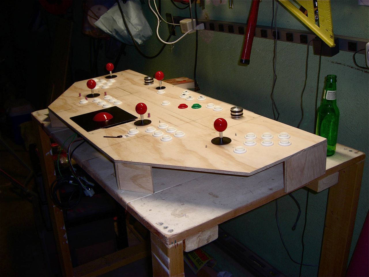

This post is kind a of a big deal. It represents the first real step towards building this crazy thing.

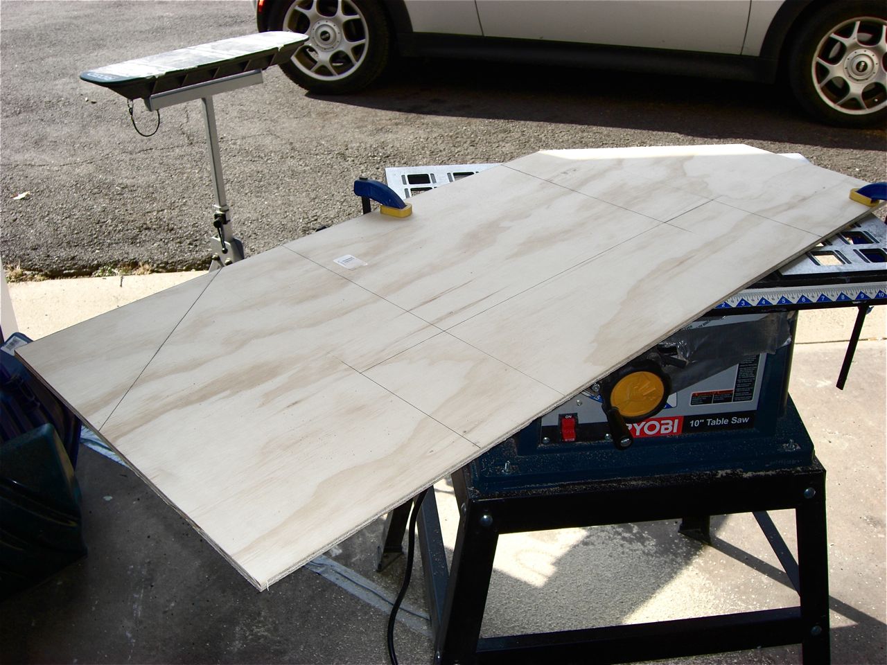

Earlier in the week I brought home some 3/4″ plywood, but realized that it would be too thick and cumbersome for this control panel. I returned it & bought two replacement sheets , one 1/2 inch and the other 1/4 inch. Quarter inch is way too thin for a good solid control panel, but perfect for a test board. I didn’t want to spend a lot of much time cutting and drilling into something that was thicker than it needed to be, especially for just a test.
I used my plans from Illustrator to measure and lay out the marks onto the plywood for where the cuts were going to be.
Doing this test build gives me the opportunity to see what tools I’m going to need. Also to get a feel for the panel— to see where I need to tweak or make any changes.
The trackball needs to be moved over to the left. I originally laid it out so it sat dead-center on the control panel. Aesthetically, I liked the position, even though it slightly overlapped the joystick casing directly to it’s right. I thought I might be able to counter sink one or the other to make it work. Once I cut out the hole and mounted the trackball onto the board, it became apparent that no amount of counter-sinking would make it work, not to mention that quickly spinning the ball to the top-right would probably result in me snagging my hand on the joystick, bending the stick or bruising my hand. Either way, It was too close and the trackball had to be moved to the left.

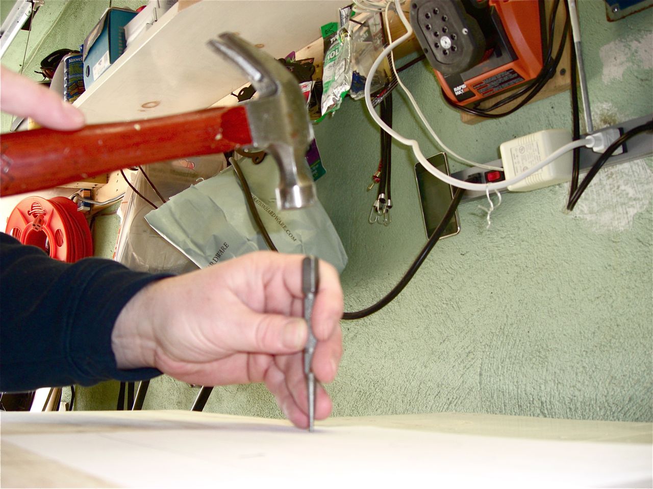

To get the holes in the right place, I printed out my button positions from Illustrator which were drawn at 100%.
I printed those out to several pages and tiled them together. Laying them out on the wood, I was able to use them as a template to mark out the centerpoints.

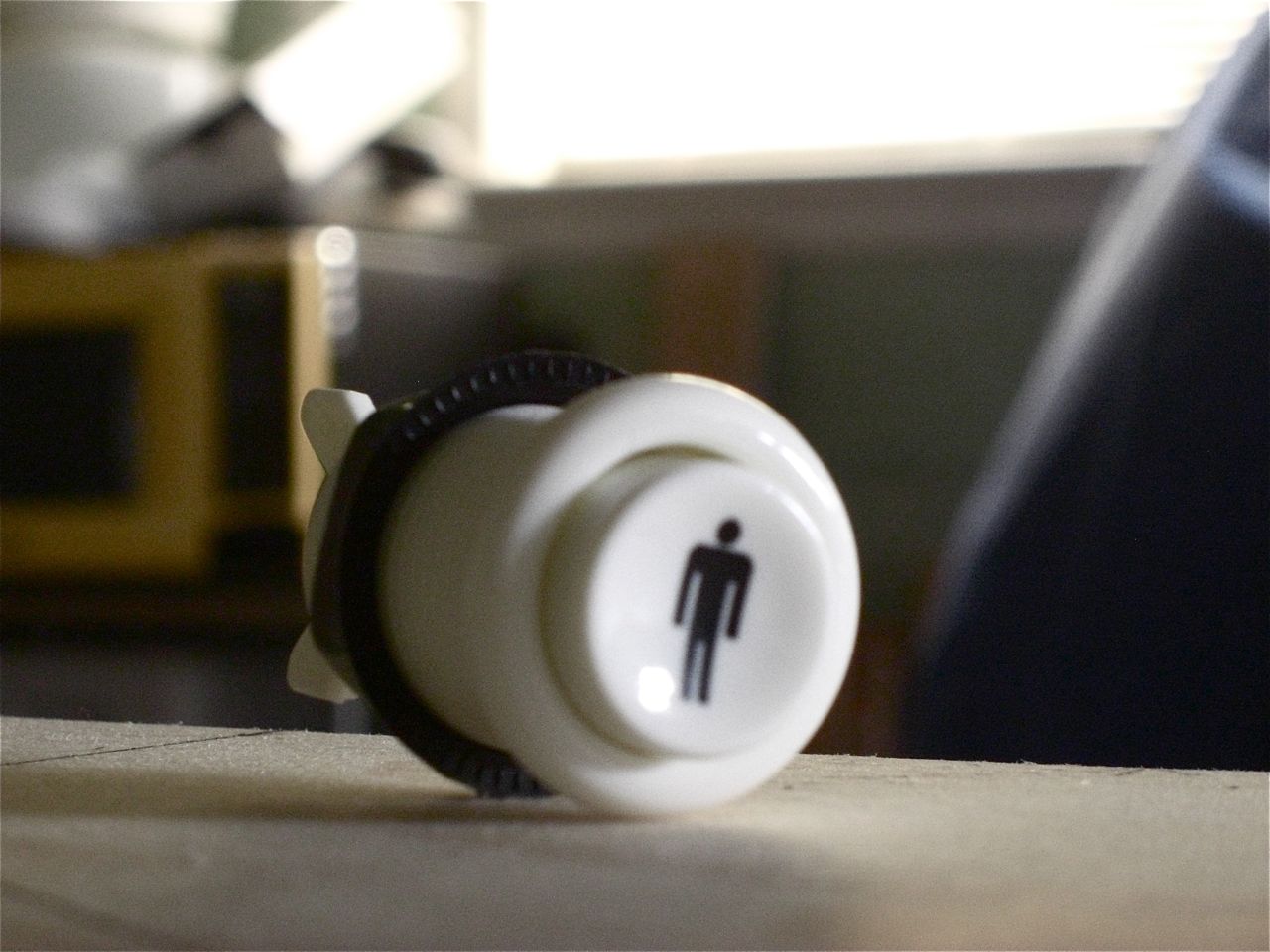

Once the holes were tapped, I drilled. I used two paddle bits, 1 1/8″ for the buttons and spinners, and 1/4″ for the joysticks. The joystick holes seem a bit small, especially for the UltraStiks. They have a much further throw than the MagStickPlus’, so when I do the build using the thicker plywood, I’ll be sure to drill larger holes for them.

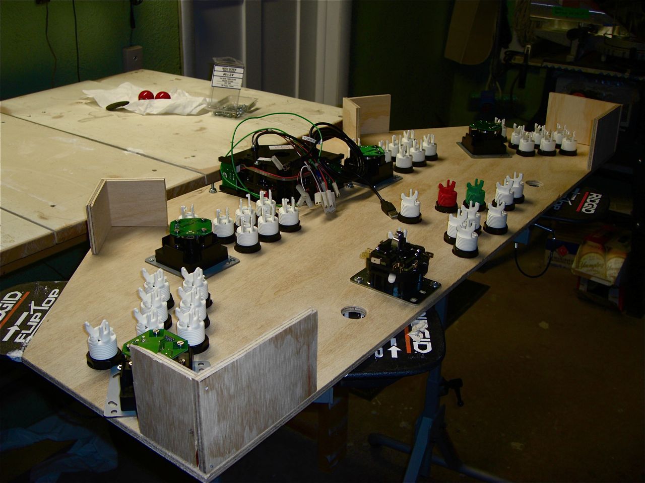

With the prototype panel wired and assembled, I’ve begun testing configuration and layout of the controls. This test run is performed on the iMac running “MAME Library” [url=http://www.randomsequence.com/software/mame-library/]http://www.randomsequence.com/software/mame-library/[/url] and “MAME OS X”  http://mameosx.sourceforge.net/ plugged in through the USB port. With all of the controls wired up, there are a total of 8 USB connectors coming of the top deck. Currently, I only have a 4-port USB dock, so a full test won’t be possible until I can pick up another 4-port at the local electronics store. This test run was performed using the main control deck, player two and three sticks and the trackball.
The main control deck is the top the defender layout. It contains “Ultimarc’s “Mag-Stik Plus” with 10 buttons manually wired to the I-PAC 2 board. The I-PAC was custom encoded using John Keoni Morris’s “MacIPAC.app” http://www.ultimarc.com/download.php#ipacmac The first thing noticed is how high the sticks feel from the deck. The original Defender cabinets have the stick riding closer to the deck which which gave easy access to the reverse button. These sticks screw in from the bottom and the remaining stick just up through the hole. I’ll be glad to play them once they’re sitting deeper on the final 1/2″ plywood rather than this 1/4′ test plywood. I may even toy with adding an additional spacer to sit it even lower. I like the feel of the Ultimarc control. It’s a 4-way/8-way stick with 4 switches that sit horizontal at the bottom of the shaft. They that make a satisfying “click” when they make contact.
This is the first time I found an emulated version of defender to be playable. That includes home console versions as well as MAME where I find extremely difficult to play defender using a keyboard or any of the console controllers. Having an actual deck to play from makes the game fun again. The spacing of the buttons feel great and instinctive and even though the original defender joystick was limited to up an down, the 4/8-way stick does a fine job.
Players one through four all use the Ultimark “UltraStik 360″. Although a bit pricey, these are the easiest to wire up. These controllers come with a harness to allow 7 buttons to be connected directly to the joystick and from the joystick to the computer is just one usb cable. This stick acts like a giant analog controller. I used it to play the fighting game and although it does have quite a long throw, I found it to be quite responsive. This test had Players 2 and 3 connected. I wanted to make sure two people can play comfortably. I did a test run with Mrs. Martoon where, not only did I discovered that her cat-like reflexes are a valuable asset to kicking ---my bottom--- but the controllers also have plenty of space for two people to sit side by side with adequate room to play.
