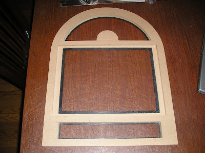

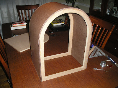

The monitor mount continues!  Here are some more riveting shots after a few more hours of work.  I used my razor to clean up the contact cement and the thin layer of MDF that was left on the Plexiglas after routing around the monitor opening. It is obviously quite time consuming. The contact cement is kind of rubbery and didn't want to come off unless I painstakingly picked at it with the razor.
This barely scratches the surface of what it took to mount the monitor in place - it looks all nice and neat for now but I can assure you it turns into a gigantic mess back there once I start freehanding with the router.    ;D
More later.   :cheers:

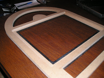

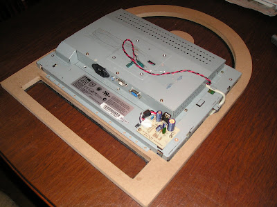

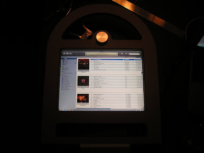

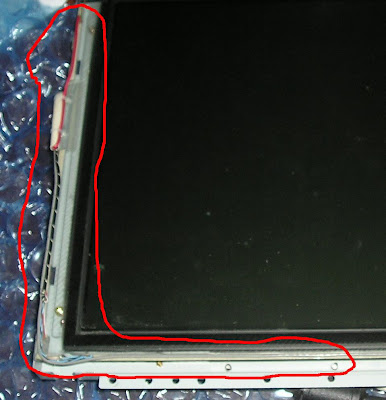

Well, I'm getting there. I removed the MDF around the speaker opening and scraped down to the Plexiglas.  The next thing I did was remove quite a bit of material from the back of the front panel. This was done so the monitor will be able to sit almost flush with the Plexiglas. I say almost because of the 1/8" space needed for the "Transducer Wedge" on the front of the monitor.
This process was really no different than what I have been doing to remove the material behind the Plexiglas. I measured the distance from the edge of the monitor picture to the edge of the glass on all 4 sides (with the monitor on, of course). Then I laid out the lines, set up my router and a straight edge and cut out the rectangle so the glass would sit in the routed area.
Check it out - I am getting tired of photographing this thing!
These close-ups give you an idea of how I am setting the router at different depths to get the screen positioned as close to perfect as I can. I should also note that the cutouts here are not symmetrical. As you can see, I left 1/8" of material for the screen (glass) to rest on because I have to compensate for the "Transducer Wedge" located on the bottom left side of the monitor.
The red area I circled shows the Transducer Wedge - as many of you know, it sticks up approximately 1/8" from the glass. I had to route down to the Plexiglas in this corner in order for the monitor to sit as close to flush as possible. The wedge is against the Plexiglas and the 1/8" of MDF remaining provides support.
Finally, even though at this point the monitor is not completely mounted in place, I couldn't resist placing the screen behind the front panel and putting the volume knob in place for a quick picture.

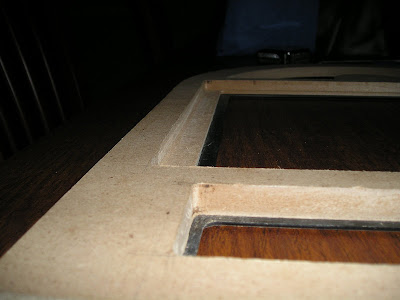

I finally finished polishing the bevel last night and I don't have time right now to do a proper write-up but here is a "before" and "after" comparison to show the results.
I'll probably go over it once more prior to securing the monitor in place just to get it perfect but it is looking pretty freaking sweet!   :cheers:

After countless hours of tedious work I finally finished the monitor mount! I was able to remove the remaining material behind the Plexiglas so the monitor would lie flush (well, offset by 1/8"). It is now ready to be installed!
This was by far the most complicated thing I've ever had to figure out on any project. After I finished routing out the material so the touchscreen glass would fit into the rectangular hole, I traced the irregular shape of the outside of the touchscreen. Then I had to freehand with the router to remove more material (leaving the 1/8" for the glass to sit on). Once that was done I had to roughly figure out where the Transducer Wedge would sit and remove additional material down to the Plexiglas.
Check it out:
The strip of exposed Plexiglas you can see on the side and bottom is where the Transducer Wedge will sit. Here are some rear shots of the monitor mounted into place. I had to remove 1/16" of additional material along the top and bottom for the mounting brackets to sit properly.
Yeah - it's kind of overkill but the more pictures the better I guess. It helps me to see things from all angles. Here is a closeup of the side with the wire sticking out. My wife thought I messed up the cut when I showed her the back panel without the monitor in there!
Here is a good shot so you can see just how thin the monitor is. There should be plenty of room in the jukebox shell for the computer components and adequate airflow/ventilation.
Finally, here are some shots of the screen installed! There is a 1/8" gap between the monitor glass and the Plexiglas which will be filled with some black foam weatherstripping when it comes time to install the monitor permanently.
I'm almost ready to glue the front panel to the shell!   :cheers:

« Reply #151 on: October 06, 2008, 05:38:20 pm »
That front panel is 1/2 MDF, right?
Is there anymore work needed to the shell to make the sides of the monitor fit inside the opening you have?  It would appear that the edges are closer to the sides then the opening would allow.  It looks like Mountain had to trim some of the sides out, was wondering if you planned for that.
"A common mistake that people make when trying to design something completely foolproof was to underestimate the ingenuity of complete fools."
  • Posts: 8001
  • Last login:October 08, 2026, 04:08:02 pm
Re: Someone call the cops! I stole a Jukebox!!
« Reply #152 on: October 06, 2008, 06:09:40 pm »
Yes!  Good eyes.  I have already put the panel in place temporarily and then tried tracing an outline of the extra material that I will have to remove in order for there to be enough room in there for the monitor.  I'm a little nervous that removing this material will somehow disrupt the structural integrity of the shell causing it to not line up perfectly with the front panel.  I will know for sure tonight when I actually make the cuts!   :o
Don't be, the laminated top along with the 3/4" frame will keep it from springing.
  • Posts: 8001
« Reply #156 on: October 06, 2008, 10:36:28 pm »
Well, I did it.  I'll take some pictures tomorrow when there is adequate light.  I just got finished removing the extra material on the shell and I glued the front panel in place.  To give you an idea of how slow I work, I spent about 3 hours doing this tonight.  Whew!
It was tough to line everything up - I think it will end up being OK but I might have to smooth the edges with some sandpaper or something.  I think over time there was a little spring back since I cut the shape of the front panel about 3 months ago(!).  I'm being anal though - you can really only tell if you rub your finger over the edge.  Now I'm worried about the laminate sticking to the edge of the front panel properly.  I have 2 band clamps... I may have to buy one more for the laminate glue up (now I REALLY want the laminate I ordered to come in).
I'm not sure why but my heart is racing right now like I just hope the glue dries OK and everything stays together.  I'm probably crazy... no, I definitely am.   ;D
