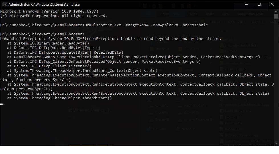

Argon I usually use Teknoparrot for those specific light gun games but I can't get controls to work at all for one game, Point Blank X. So I'm using Demulshooter but 5 is not working to enter coins? 1 is working for start it says coin error. I am also unable to get into any test menus. I did copy the content of Point Blank X to where the .exe is, but I'm confused about your instructions
Edit the newly copied Setting.ini file (located in PBX100-2-NA-MPR0-A63_Data\ subdirectory of the game) to your needs. Available options and values are written in the ini file.
I don't really know how to edit that .ini? It looks like this

Run, DemulShooter.exe -target=es4 -rom=pblankx
run, PBX100-2-NA-MPR0-A63.exe
I tried running Demulshooter.exe as administrator but Demulshooter is still red not green?
Edit 2: Now that I figured out how to disable coins in test menu the game is fully working in Teknoparrot.

Edit: I realize now backspace is test menu and I was able to disable coins, however it seems demulshooter is not hooking because it's red and my wiimote doesn't seem calibrated. I copied all of the files of Demulshooter 16.2 and put them where the .exe is and here is my script
Backspace key was listed in the game wiki page
As for DS not hooking the game,  it can be many things but a demulshooter log would be a good starting point to see if something obviopus is going on
And, as I usually said, trying to get things running directly without using AHK scripts or BAT or frontend is also a good starting point as those scripts/tools can add a layer of possible errors....

Hi!
I recently reinstalled windows11 and now demulshooter dies on me when starting Point Blank X.
Both standalone and TP setup behaves the same way.
Started it before the game and it turns green when the game starts but then the process dies on me.
Do you know when I'm missing?
Running the latest DS and have reinstalled the unity plugin after I deleted the old BepInEx folder.

argonlefou
  • Posts: 1100
  • Last login:August 31, 2026, 01:44:18 pm
This is exactly the kind of error you have if you're running a newer plugin (post v17.0) with an older DemulShooter version (pre v17.0), or a newer DemulShooter with an older plugin.
gstav
  • Posts: 222
  • Last login:June 02, 2026, 02:22:32 pm
    • forum.arcadecontrols.com/index.php/topic,157861.0.html
Thbaks for getting back to me Sir.
I have the newest DS and removed the folder inside the game and reinstalled the plugin.
This is on a new windows but I copied over my old app Data folder from my previous windows in order to sacäve setting in like Spice tools and progress in PC-games and what not. Maybe this is a bad approach and can get you in trouble like this. Don't know if any old DS setting is hidden in there?
I have another go and try reinstalling DS + plugin once again
"One coin to rule em' all"
gstav
  • Posts: 222
Hey argonlefou!
I reinstalled a clean dump and installed the plugin using DS 17.2.0.0 but still have the same issue.
Don't know what to do here. Strange as it worked when released. Could it be something with the newer versions of DemulShooter maybe?
argonlefou
  • Posts: 1100
DS does not have any setting hidden in anny user folder, it's made to be portable with everything in it's own folder. So AppData from another OS is not the problem.
The issue us very clear, DS does not talk with Point Blank X plugin and crash because it can not handle the protocol.
It's very simple...Unity plugin and DS are talking via TCP.
I had to change the TCP frame format for a lot of reasons in DS 17.0, so any couple like Old Plugin+New DS or Old DS+New Plugin will give exactly the same error you have on your screenshot. And that's pretty much the only possible reason to get that message.
Now, as for why you get it....I can't know :/
I just reinstalled the game on an unused Win11 PC and tested with DS 17.2 downloaded from github, and everything is working perfectly
gstav
  • Posts: 222
Thanks for the answer. I guess I could try another PBX game.
Do you tested on standalone or tp Sir?
argonlefou
  • Posts: 1100
Standalone, I only use TP to run linux emulated games
gstav
  • Posts: 222
Thanks again man, I don't know what is wrong with just this game now after mmy reinstalled win10.
Tested 3 different versions, one of them the prior fully working.
Maybe I shoudl try the older DS with its plugin, what version would you reccomend if so Sir? This would be the last thing to try I guess
Edit:
Tried DemulShooter_v14.3 with the Unity plugin from that version to the game.
That boots and hooks with MAMEHooker and DS is still running which is odd.
Both guns still controls the crosshairs though. Must be something on my end just for this title I guess.
Thanks for looking into it though! Cheers

The oldest plugin is not compatible with the current system and will make the game crash
I don't remember which one is the newer one, but the easiest solution is to just unzip last DemulShooter release in a separate folder and start again from here, this will be a clean thing. (Install Unity plugins from here)
You can just copy the config.ini file from your older folder, all users settings are in that file
I was able to make it work, thanks! The correct plugin is PointBlankX_BepInEx_DemulShooter_Plugin, but there was another issue: a fresh folder of demulshooter 17.5 does not contain the DLL, just the ini. I tried to copy the DLL from a backup and it crashed, so I tried 17.2 and it has everything and everything works! When I have a chance I will also try 17.3 and 17.4 to see if those work too.
