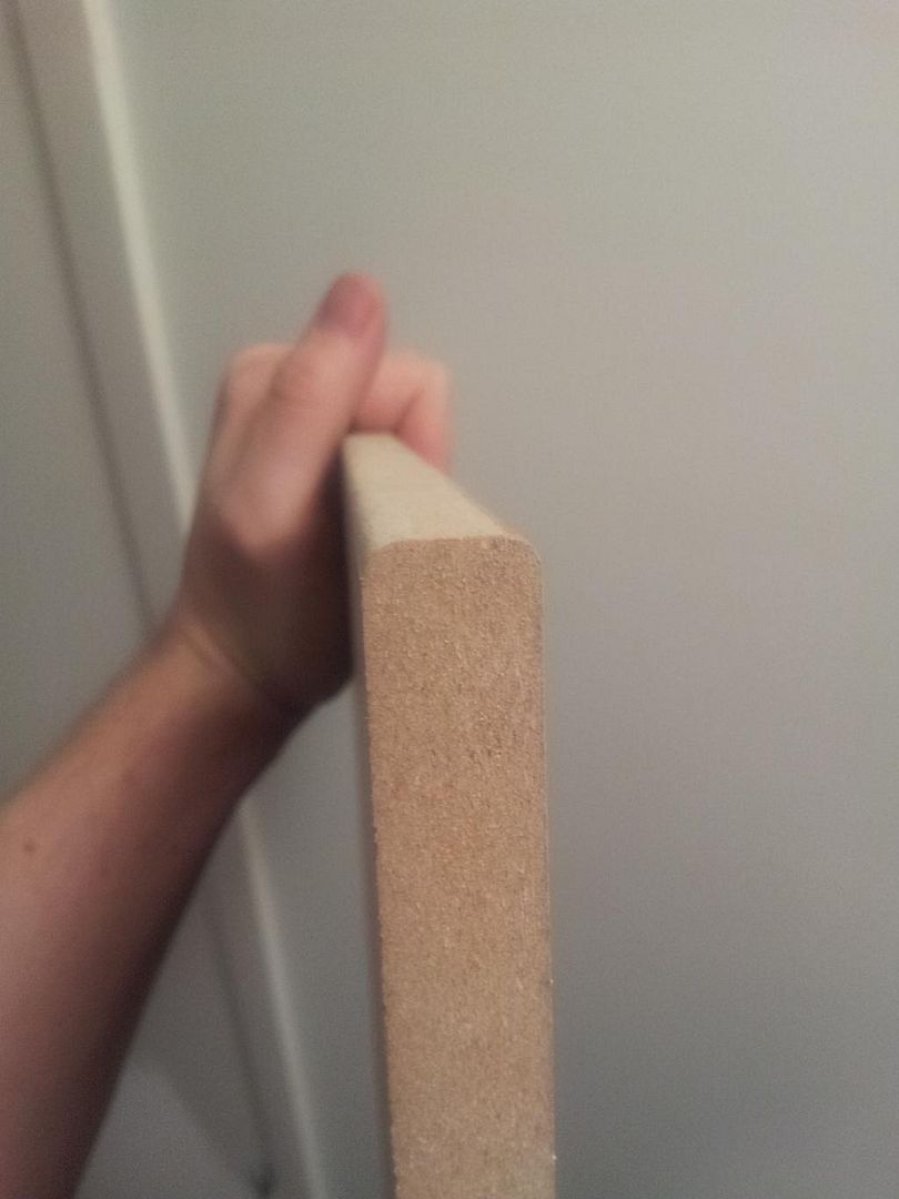

How much of a roundover did you make on the sides?
Memorex
  • Posts: 14
  • Last login:March 05, 2019, 11:23:17 am
  • Building cabinet based on Project Mame
Re: T-moulding on routed edge?
« Reply #4 on: January 27, 2015, 03:56:27 pm »
[/URL][/img]
Stargazing wizards stare into the night,
hurricanes and blizzards, here comes the final fight!
« Reply #5 on: January 27, 2015, 04:07:42 pm »
You actually did a nice job on that, but it's probably too much of a curve for the t-molding.  :cheers:

Shoot..  cabinet is mostly assembled already, held togheter with lots of screws and good ol' glue. Virtualy indestructible I'm afraid  :banghead:
Triming down the rounded part sounds a bit interesting but I fear it will make some of the panels a little to flush with the edges :/ Might work tho'.
