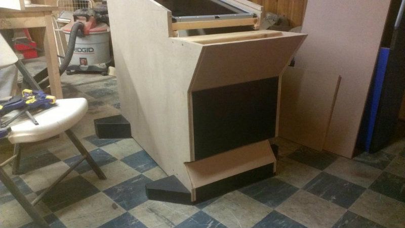

This is the dual-cab I'm in the process of building now with 32"(missing 42" horizontally). And I will finish building it ..not how someone else builds theirs! It will be configured and set up correctly, I might not get my answers here--but I will get my answers! ;D

But remember I am using two monitors; horizontal/vertical. Unless I am missing something autoro rotates both my monitors and I do not want my horizontal monitor rotating. nvidia drivers rotate only one if I want and not the other.
Howard is probably busting on you for the above comment because it sounded like you weren't listening at all when both of us were telling you not to rotate the desktop.
(even though I typed it in all caps!)
I wrote a response busting on you for it, but your next post appeared and it sounded like you were getting it, so I didn't hit the post button.  :P
I get exactly what you are trying to accomplish and it would be easiest to do without rotating the desktop.
MAME UI doesn't do anything extra, it just gives you a user friendly interface to set the options.
All those options are available in the standard MAME build.  You just have to add things to the command line or modify an .ini file.
I'm not familiar enough with Hyperspin to know how to automate the process so you don't have to modify every game individually.
DNA Dan is using Hyperspin with a physically rotating monitor, so he might be able to point you in the right direction as far as having Hyperspin use a different command line for each orientation.  (To force the game to a specific monitor in your case, instead of physically rotating the monitor)
http://forum.arcadecontrols.com/index.php/topic,110471.0.html
I've always liked that Aliens style cabinet and considered building one for the longest time.
Start a thread in the project forum with more pics!
