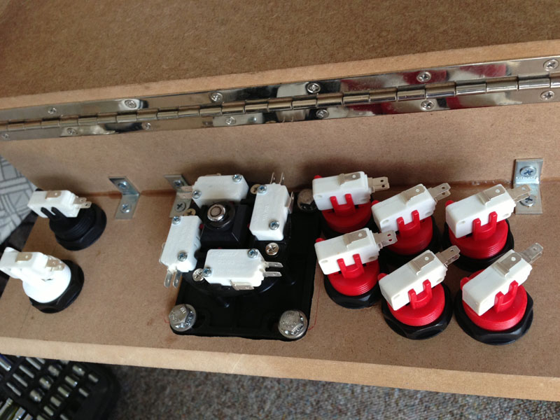

I modified the CP design slightly while we were cutting the pieces so it's a little different than the template would suggest, though not too much different. The top of the CP basically rides parallel to the bottom of the cab now, vs at a slight angle like the template shows.
I haven't moved the support pieces that hold this in to place yet - notice that it's a bit "off" with the back being up slightly higher than it should be. The piano hinge gives it a full range of motion both ways, so rest assured it will be level when I move those pieces.
Kinda hard to tell, but there's about 2 fingers width of clearance below the buttons. The stick has even more because I countersunk it about 1/8" in to the MDF on the bottom of the panel. After I put on my plexi, the buttons should be raised even more.
I was worried about clearance, but it doesn't look like it's going to be an issue, thankfully.

Got the standoffs installed for the joystick and for the two bolts that will hold the CP closed when it's not being serviced. This is my first time  using these and they're pretty slick. Just drill a 5/16ths hole, drop it in, thread a bolt in from the bottom (with a washer on it) and tightening the washer pulls the standoff in to the wood. As you can see, they work pretty well and are a lot flatter than a bolt head:
This is the bottom of the control panel. Button proximity doesn't get much closer than this. Like an idiot I didn't try this layout out on a test piece of material before drilling holes in my finished control panel. It's a tight fit, but everything worked out well (thankfully). Lucked out on this one.
I added two more stand-offs. We'll see what these are for in a second...
The bolts that I got are  LITTLE too tall. I'll probably have to use a couple more washers under each bolt for the joystick in order to back them out a little. I could cut them down, but washers are 10 cents each and it's much easier than cutting.
Here's what the other two stand-offs are for. These guys hold the control panel shut tightly when the cab is in use. When I need/want to service the buttons, I'll just be able to flip the cab on its back, remove these two screws, and the hinged control panel will be accessible.  :) This actually took much less time to pull off than I thought and was one of the things I was worried about.
Now to do something about those stand-offs sticking up. I really want them to be flush to the surface. You'll notice in previous pics that I traced them with a pencil. I ended up popping them out and routering JUST deep enough to where they'd sit flush.
I got as close to perfect as possible, but there was gap, so I filled it with wood filler and I'll be able to sand it off as soon as it dries. My control panel art will cover this up, so I'm not too worried.
This wood filler stuff is messy. I'm not a fan of it. Hopefully it works well.

I installed a power button in the back of the unit. The power plug/cord will also be in the back.
I installed a button up next to the left speaker which will act as the "Exit Game" button for MAME. I know the iPAC comes with a shift function for holding Start 1 and pressing Start 2 to exit the game, but there are two issues with that. #1 on this cab I don't have a Start 2 button. #2 even on my full sized machine I found out the hard way that if you're playing 2P and both players die simultaneously (happens a lot to my friends and I in bullet-Hell shooters) and they both press the buttons simultaneously it can exit the game. Sucks when you're really far in to the games. :(
Anyway, here that is:
