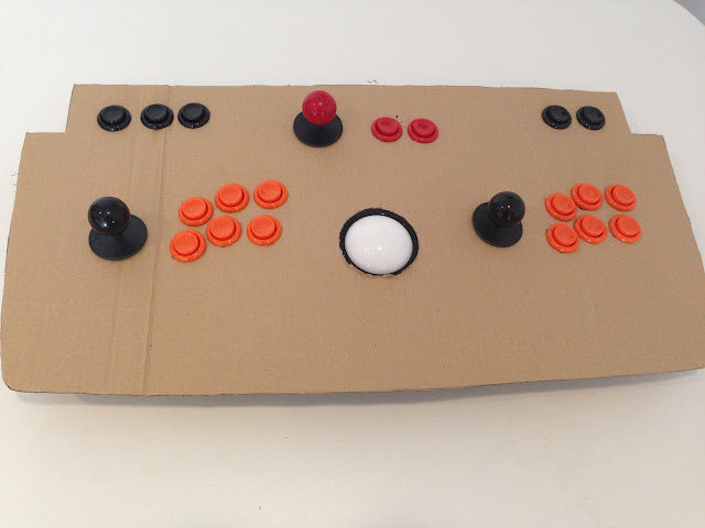

I've been planning an arcade cabinet since before I even conceived of the portable controllers.  I've renewed my efforts and hope to actually get it done this year sometime.  The plans have been ever evolving, but here are my current plans.
The control panel will basically be like two of my controllers on one panel, with a trackball in the middle and a few admin buttons.  It will be a sit-down cab.  Players 3 and 4 can either plug in portable arcade controllers or Playstation controllers.
I'm going to use a 32" LCD TV for the display, which will be on a bracket that let's it rotate quickly for vertical games.  I bought an LG 32LD450, which has only 15ms of input lag in game mode (miles faster than most digital TVs/monitors).  I'll be using an SLG-3000 for scanlines.
