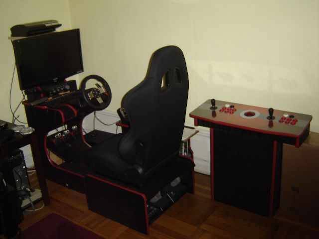

EDIT 06-22-12: Since any further additions/changes will be tiny and cosmetic only, I'm calling this project DONE. Here's some "glamour shots" so you don't have to read the whole thread if you don't want to:
Flight/mech sim mode (with the monitor forward for comfort.)
Behind the monitor: HDMI splitter/selector and spare USB access on left. 5.1 channel amp on the right.
Whew!  :laugh2:  :cheers:

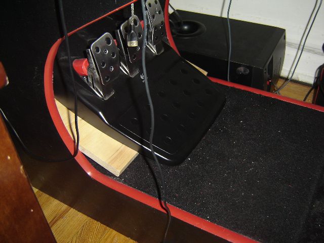

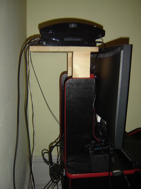

Before we look at the design process, lemme show you how the setup currently looks (04-05-12). I warn you now, it ain't pretty:
You'll notice I've added a couple of Dr. Moreau-esque appendages. One is a shelf for the PS3 to reside on...
This, despite appearance, is quite stable thanks to the combination of pocket screws and wood glue.  I've also added a shelf to angle the pedal base to approximately 10 degrees, and raise it up about an inch in height:
The front edge of the pedals just touches the carpet. This was just me prototyping for what is to come. You'll notice the sort of random wiring that's strewn about. If you haven't read the wall of text above (and I don't blame you! LOL) that's one of the many little nuisances I plan on removing.

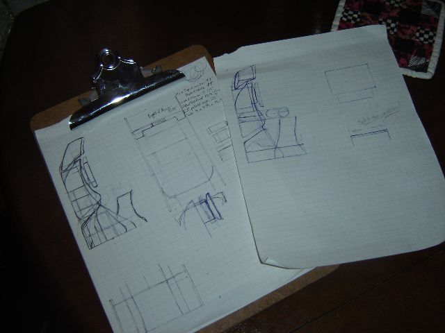

Here's a pic of a couple sketches I did, 1/12 scale (there were more but I can't seem to find them now...)
I knew immediately that I want the cab itself to be no more than 2 feet deep, 2 feet wide (plus or minus), and 5 feet tall (preferrably LESS.) But with the sketches, I wanted to throw out the most ridiculous, limit-pushing things I could think of, so that I could pare back when I got to Sketchup. I also focused on the profile, because I knew with the amount of shifting around I was going to have to do with components there was no point in trying to render them here.  That said, in that right sketch, perhaps you can already see my plan for an articulating arm for the steering wheel...

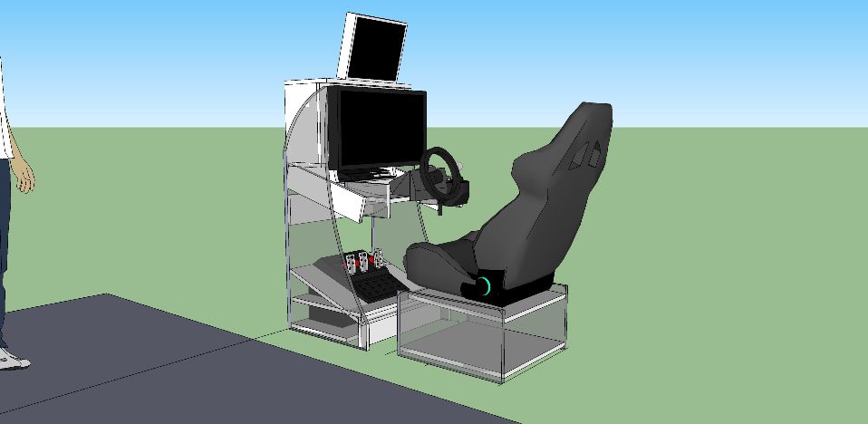

Here's a couple of early Sketchup model pics:
I CANNOT recommend Sketchup enough for people who want to tinker in this hobby. Seriously, an invaluable tool, I've used it for all of my projects and wouldn't have been able to do them without it.  Learn it.  As you'll see, I tend to make my cab sides transparent so that I can look ahead for possible construction challenges.
In these earlier pics, I was still working with the idea of only using "handy panels" from Home Depot.  You'll also see I was tinkering with a second monitor atop the main one... that idea didn't last long...
Here are the two cabs side by side, and another reason to love Sketchup: As well as model pieces, such as the monitor, the pedals, etc., ... I can copy over dimensions and thereby replicate ergonomics easily.  And for those ergonomic issues that didn't work, I can easily change them.
From the back here you can also see I've moved the PC case portion of the cab up behind the monitor, and given it a lot more room.  I plan on using that space for a lot of things.
And here's one more shot, with the cab sides filled in. It wasn't very exciting at this point, and once I realized I wasn't going to use the handy panels, I gave in a little to the original sketches and here's where the design is currently (04-05-12):
So this is a lot more fun. I'm enjoying the marquee area (even though I currently have NO IDEA how I'm going to do it) and I've thrown in some of the black/red scheme to get a feel for it.  The arm mechanism for the g27 wheel is in its' Down position here.
Here's the profile from the other side, with the arm in its' Up position, no black (with all of my gridlines still in place):
I work with rudimentary square/rectangle shapes made partially transparent until I decide on a final profile for the piece. In this case, the "white" that you see is what will be real when cut.  The grid/guidelines on the cab side piece are what I'll use to map out the actual cuts when I get to wood.
This next pic removes a side wall altogether so you can see what's going on inside:

Was fiddling with the Sketchup file this morning, actually. Ended up making a minor change to the internals (not worth showing) - I think I'm going to put the mobo, hard drives, and gpu (if there ever is one) on a removable shelf unit. I've seen it done in other cabs and I think it could be really useful for occasional cleaning/upgrades etc.  If I don't do that, once the PC components are in, it's a REALLY tight fit for me to do anything in there without having to break the whole thing down piece by piece.  This way, I can set it up, run cables, etc., then drop the whole thing in the cab.
Also just ordered the HDMI splitter, along with the PS/2 extension and some smallish (1.5ft.) HDMI cables, from Monoprice rather than Amazon. Linky here.
Actual physical build looks like it will start April 28th. A buddy of mine has graciously given me use his driveway in NJ to do the initial breakdown of the 4x8' sheet stock. Will probably take a few hours at most. The harder part is going to be getting the lumber and getting it to his place for the day... still working on that.  In the meantime, I've still got a saw to buy and saw-boards to make this Thursday.

... and I'm ready to start mapping out the profile. Before that, though, I had to go downtown to HD to get a 1/2" handy panel of MDF to build my saw-board. Once I finally got home with that, I was too damn tired to bother with it, so I started drawing on the profile.
Detail of the marquee area:
Right now I'm hand-drawing the larger curves, but if anyone has a better way to do that PLEASE FEEL FREE to speak up!! I mean, I'll get it the way I want it eventually, but there must be an easier way.
I might get to the saw-board before work today, I might not.  It's supposed to rain this weekend, so there probably won't be much more real progress until next week.

After what felt like an eternity of days that looked like this...
and a watered down workshop:
I finally got a day off, and enough good weather yesterday to do some work that actually makes me feel like this project is rolling again!  :woot
To get everyone up to speed, on Thursday afternoon I was able to finish all the rough/straight cuts with my circ saw.  I was taking a risk weather-wise, but I mananged to get everything done and back inside before we saw any rain.  No pictures of that process, obviously.  For Sunday, my plan had been to just draw out and start cutting detail cuts (the arm pieces, the new control panel base, etc.)
And here's a pic of what *will be* the hole layout of the outer portion of the articulating arm (this will all make sense soon, I promise!)
So I started (and finished) doing those detail cuts, and created their twins using my router and a template bit.  At that point, it was only about noon.  Since I had time, I took a break for a quick sandwich, came back out and cut out the first cabinet side! I'm incredibly pleased with how it turned out!
One very slow and cautious template cut later, and BOTH sides were done:
With both sides finally cut, it dawned on me that I had already finished all the pieces I had that also needed routing for t-molding.  I was feeling pretty gung-ho about the whole thing at this point, and I had the router out already, so I went for it!
After that was done (probably another 2 hours? I HATE t-slot routing... you have to be really careful!) I was exhausted, but I had another realization. Now that the slots were cut, I could assemble the new CP base.  I know it's not really ready for use, but I wanted to see something standing, damnit!   :laugh2:
So I jigged up those pieces with my Kreg Jig:
... and put that thing together!
Cleaning up for the day:
So now I have a pile of scrap, a pile of detailed cut pieces, and a pile of straight panels, plus another pile of panels not pictured!  The control panel base is done and the cabinet sides are just about ready for assembly - gotta drill and install the threaded inserts that will hold the steering wheel arms.  I've got a few more non-curved detail cuts to do, but it's looking like this thing may in fact be up on its' feet on Thursday, weather permitting!   :cheers:

Most of the assembly is done now. Took me three tries to get one of the clamping knobs to line up right on the steering wheel mount, but I got it all together finally.  It's a good thing I got it done on that third try too, I broke my 2 spare threaded inserts in the process.
Going back to P-chan's question; the monitor mount is pretty great. The movement action is very smooth and it doesn't make any sound (at least, not yet.)
Hooked up the PS3 to play some GT5 and I'm very happy with the results. Ergonomically speaking, it's much more comfortable than the old unit.  Looking forward to priming/painting and installing the PC.
