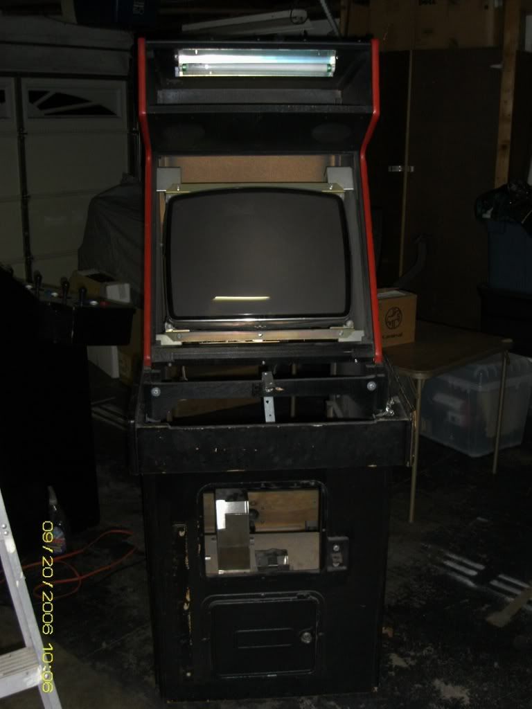

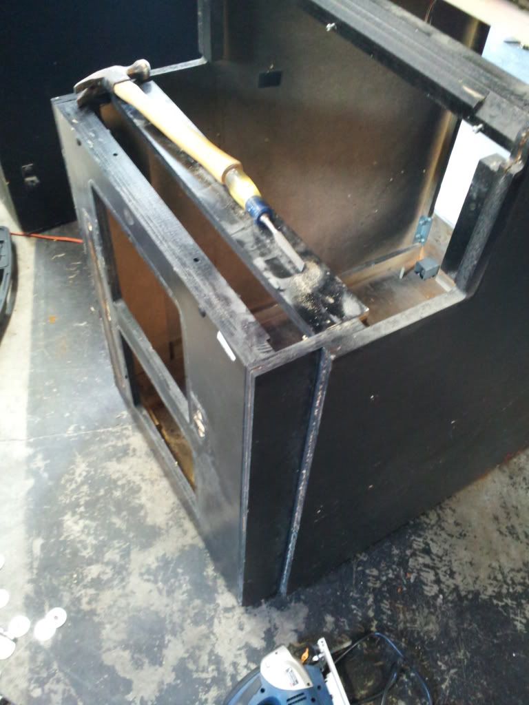

Small bit of background...I've wanted to build a MAME Cabinet for a very long time now.  I'm guessing 5ish years or so.  Situations just never let me get started...space, money, time, etc.  Probably mostly just excuses to not start.  Bought the Project Arcade book some years back, read through most of it once but then put it away.  That desire to be able to play the MAME games on a full cabinet has always been there though...
Flash-forward to last week.  A game store opened up near me (the type for MTG, D&D, Pokemon, etc).  They had a Marvel Vs. Capcom cab in there that was supposedly working, but the PCB board was long gone.  They also had a fully operational 4-player Gauntlet Legends cab in there as well.  They wanted them both gone.  I helped them with some other projects and had expressed interest in picking up the MvC Cab from them to start the Mame project...lo and behold, they gave me the cab for free!  I then went back a few days later and asked how much for the Gauntlet cab as well.  $300 later and now they both sit in my garage.
I'm at a point where I can realistically tackle a project like this.  Gainfully employed, in a house with a garage to work in.  Time on the weekends and evenings.  I'm sure most of you understand just how excited I am to finally start this!
The plan:  Use the MvC Cab as a learning project.  Very little will be done as far as cabinet restoration goes.  This is mainly going to be used to learn how to wire everything up, get the computer running with a real arcade monitor and explore the limits of the monitor itself.  Perhaps a new CP?  Adding a few buttons to the existing?  Spinner for tempest?  Learning the best way to add a keyboard/mouse drawer to an existing cab.  How to add speakers, etc...and finally, learning how to configure a front-end and all the other software needed.
Once the MvC Cab is at a place that I'm happy with it, full restoration mode starts on the Gauntlet Cab.  I'll have the experience of wiring up a cabinet then.  Software issues will be dealt with.  The things I plan to learn on the 2nd one are how to do T-molding, reconfiguring a CP for many types of games, deciding if I should go with an LED/LCD type screen or stick with the 27" in there.
The MvC Cab is a 25" screen.  The Gauntlet is 27".
Here's a shot of the MvC Cab after I gutted everything but the monitor.  I was unsure of how to safely handle an arcade monitor, so I left it completely alone.

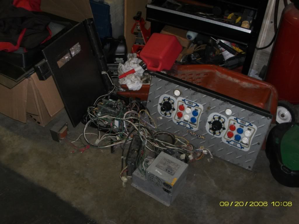

The parts I removed...
Finally, the Gauntlet cab...

As I sit here late at night, some immediate questions pop in my head.  Having answers to these will really help my motivation to spill over, as these are the questions that worry me the most.
Should I use the 25" Arcade Monitor in the cab?  If so, what do I need to get it to work my computer?  This is easily my most troubling question.  I have no idea how to wire up an arcade monitor to be used in a modern computer.
I believe it's a JAMMA cabinet...the wiring that was in the cabinet would help identify this, right?  If it is, is it smarter to go with a J-PAC or just re-wire the whole thing with an I-PAC?
Is the existing CP overlay worth anything?  I don't want to go drilling into it if it's something that somebody else would want.
Are the parts I gutted from the cabinet needed/used in a MAME cabinet?  Are they worth anything, or shall I E-Waste them?
Best front-end?  I've looked at Maximus Arcade, which I liked.  MALA I wasn't impressed with.  GameEx was pretty damn confusing.  I downloaded Hyperspin but haven't installed or tried it out yet.
For this project as a whole (which includes both cabs), money isn't really an object.  I'd love to hear any all ideas or thoughts.  Even the expensive ones, considering if the results are worth it, I'll do it.  But lets face it, this is my first time doing this.  I'm turning to the experts here on this board for some guidance and help...I don't want to end up on the wall of shame :)  The first cab will be a budget cab, but I don't mind spending some money on it to get it running.  The 2nd cab...the skies the limit.

The forums are your friend.  You will find the answer to these questions and many more.  The search function works well.  I will try and answer a few questions for you to get you started.
1)  The easiest way to get a computer hooked up to an arcade monitor is to purchase an arcade vga graphics card from Andy at Ultimarc.  He has detailed instructions on how to hook this up, and may forum users have purchased and used these cards.
2)  At this point, you have gutted the cabinet.  If you are going to be using a computer for the "brains" of the cabinet," an I-PAC is the way to go.
3)  The CP looks like a standard capcom fighter overlay.  I think those are still easy to come by/have reproduced, so I wouldn't worry too much about hanging on to it.  You are taking a non working cabinet and changing it over to mame, and most people in this community are okay with that.  What irks some people around here is when you take a perfectly working cab and mame it.
4)  While some of the stuff might be of use, most likely none of it will be needed in your new mame cab.
5)  Best front end is definitely an opinion question.  In the software forum, you will find a poll, so that will show you what most people use.  I am currently setting up my cab for hyperspin, and you will find a very active community on their website for support.
If you can confirm the monitors work use them.  The only reason not to use a working arcade monitor is to save money really.  I know some people sale the one they get for a few hundred and stick with cheaper tvs.
As for wiring them up, someone else will have to answer.  I am not an expert on that.
Same as above.  One of you jamma kids needs to answer this.
Don’t worry about the CP overlay.  You can trash that artwork.  Personally I would recommend keeping the pushbuttons and joysticks while trashing the wood.  Make your own control panel from scratch.  It is much more satisfying than trying to get something prebuilt to work like you want.

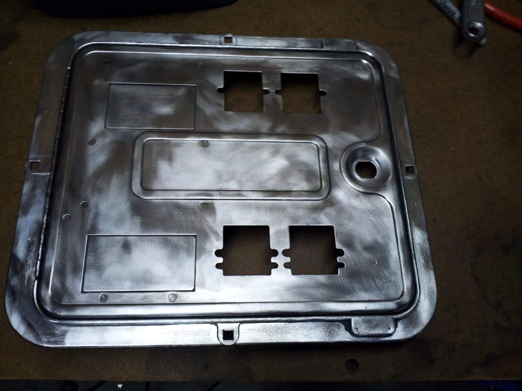

I assume that is the coin door lieing face down.  Definitely reuse that.  Otherwise hang on to the controls if you want to use them now or later.  The rest of it I would say is junk, but you might be able to parse it out to someone looking to restore a jamma.
All I have ever used is mala, but that was when it was brand new compared to the dying mamewah.  What are you looking for out of a front end?  Mala is very customizable, but I guess they all are.  Whatever you learn to use and change is best these days.
Now this sentence I like.  Opens up a lot.  I would definitely recommend RGB led lit buttons powered by ledwiz’s.  I don’t know what is used for lit buttons these days since they don’t seem to sale electric ice buttons anymore.  But the basics are that you can have the LEDwiz read a controller file of the game you select and light the correct buttons to the original game’s colors.  Very cool and really simplifies knowing what buttons to use.
If money is no cost, I would avoid making the first cab budget and the second cab amazing.  Personally I would make the first cab multi-controls and the second cab a more dedicated fighter cab.  Simply put I would utilize ultrastik 360 controls, a spinner, and maybe a dedicated 4-way on cabinet number one.  This would make cabinet 1 your multi-game cab.
Now for your second cab, the gauntlet one, this is your 4-player cab.  I would use some dedicated 8-way sticks which work best for fighters.  I would also put a trackball on this cab since the angle of the monitor would work well for trackball games.
If money is no cost use led buttons on both cabs and light up the controls.  Don’t worry about using one cab for testing.  If you post enough on these boards you can really pin point your control scheme to where you don’t need a test bed cab.

Thanks for the quick replies!  Definitely alleviates a number of my concerns.  After this post I'll be ordering up the basics to at least get everything interfaced...the ArcadeVGA card and I-PAC that Turambar mentioned.
Turambar:  Thanks for the answers to my questions and taking the time.  I'll definitely try to use the search function more.  I understand the frustration of seeing the same questions over and over :)
Green Giant:  Also, thank you for taking the time to answer some questions.  I also want to thank you for the RGB-lit buttons, that sounds awesome!  I'll look into what I need to get those going.  I'll probably use the existing buttons and sticks to get it up and running, then switch over to the LED buttons once the basics are learned.  I also like your idea about using both cabs and making them for different uses.  I was struggling in my head on how I was going to put Visual Pinball and Lightguns on the 4-player cab :)
Yes the thing laying face-down is the coin door.  There's also another door on the front of the cab that allowed access to the quarter container.  I think I'll be removing that completely and putting some vents for airflow down there.
To answer your question regarding what I'm looking for in an FE...I'm looking for an interface that is just as amazing as the cabinet itself.  From the couple of videos I've seen, Hyperspin looks awesome.  Again that's said without ever trying to use it, yet...
I was looking at the Happ Perfect 360 joysticks.  Did a couple google searches for some reviews and they were received very positively, it seemed.  Has something better come out since them?
Edit:  Ah, research is your friend.  Looks like I'll be waiting until tonight to place that order.  I don't know what monitor is in there...don't know if I need the amplifier cable or not.

As Green Giant said, definitely save your coin doors.  With a drill, a wire wheel, and some paint, your old door can look brand new.

So I went and checked on which monitors I have.  The 25" in the 2-player cab I believe is a Wells-Gardner K7000 and the 27" is a Hantarex Polo.  The model # on the sticker for the 25" says WGK7197.  Did some searches, and I'm guessing that means it's from the 7000 series?  Am I correct in my assumptions here?
I'm starting to lean towards putting an LCD screen into the 4-player cabinet, and keeping the 25" in the other to keep it old-school.  Other than pure aesthetics, is there anything that using an LCD screen specifically hinders me?  I know light guns won't work, but I can't see myself putting light guns on a 4-player cab.

Assuming the LCD and the original screen cover the width of the cab, you get more real estate with an arcade monitor simply because it is 4:3.
A plus is that you could trim a foot off the back of that 4-player cab.
If you do go with an LCD, you can probably sale the arcade monitor for a few hundred or donate it to your local poor builder in Houston(I hope you are here).

For example, I've refinished coin doors.  Tried sanding and repainting.  Tried using a paint stripper.  Tried a wire brush and various types of sand paper.  If I had a media blaster I'd try that too.  Then I tried two coats of hammered finish paint, now I'm trying two coast of hammered finish, then a coat or two of black then maybe another coat of hammered.  I want to see what I like so when I tear apart one of my classics I know what I'll end up with.  The test piece still looks hella good in it's own right, just not my first choice.  See?

3. Ripping the existing t-molding out of the cab and measuring it to see how much I'll need to order.
4. Remove both monitors out of the cabs.  These are for sale.  Discharging was done tonight.
5. Label the wiring thats on the existing CP, then removing it.

Progress!
Monitor is out of the cab.  I expected that thing to be a lot heavier than it was...had some help getting it out, though part of the way through he just grabbed the whole thing and held it while I prepped an area to set it down on.  Wasn't too bad at all.  T-molding is removed and measured for re-ordering.  Will figure out how much I need for the CP and that order will be placed.  Need my slot cutter bit as well.
Cabinet is going to be modified.  I really don't like how the front sticks out from the sides.  Pic below of what I mean.  I think I'll be cutting straight along that edge, remove all the pieces from the inside then remake that panel slightly recessed.  That front piece also has two huge holes in it (coin door and quarter collection door), though I only plan on putting the coin door back on.  I think this is a much better plan all around for it.
Speaking of the coin door, got this done with a wire wheel.  Still need to do the inside edges, but that'll take all of 10 minutes.  What is the best way to repaint this?  Rattle-can primer and rattle-can paint?

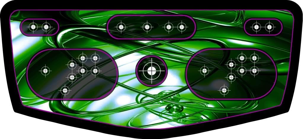

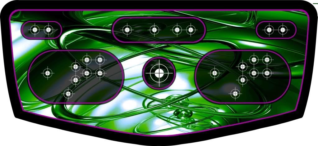

Layout is done!  We've settled on a final design.  Posted below...it's not a big difference from the one above, but the difference is in the details :)

Love the artwork.  I am always a fan of green cabs.  The color is never used enough and always looks great on cabs.
As for trimming the front of your cab, I am assuming you are talking about that random lip that comes out 4 inches or so from the side of the cab.  If that is what you are talking about then I agree to trim it off.  The side of the cab that comes out a foot or so you will want for control panel support and just overall visual appeal.
The coin door looks great.  Much better than my ebay one did after I took a wire brush to it.  Just get a can of rustoleum spray paint for metal.  I prefer the hammered finish but that is your call.  Don't need to prime just put a few coats of that on their and it will be good as new.
As for the control panel design, those circles around player 1/2 do seem rather large.  Have you thought about leveling off the two rows which would bring up the 7th button an inch or so?  Also, will the color be purple?  I think that might be throwing off the picture somewhat.  I would go black, green, or silver for that border color instead of purple.

Yep, that's purple in there.  The idea was to pick complimentary colors so that there isn't a single color overload.  The rest of the cab would also be trimmed in purple (t-molding, etc).  Imagine the button 'rings' being translucent and lit up purple as well, the buttons black.  I've also got an idea for the sides of the cab to also be lit up in purple, involving EL wire and LED's as well.

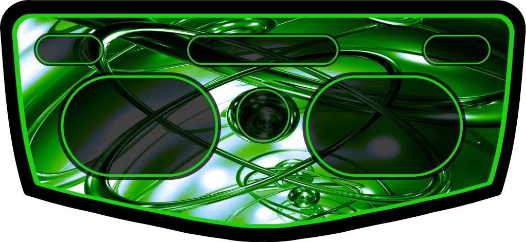

Now with that being said, if the green looks really out of place, it's easily changed.  Here's an earlier version of the layout, but in purple.
The purple here just doesn't seem to have any depth.  I didn't have her play with the purple at all though, so perhaps something can be done with it in Photoshop.  Think that looks better?  I don't have any purple ovals/purple background.  I'll have her throw one together tonight.
Could also go full green.  This one is before the center was retouched to be completely covered by the trackball, so ignore that.  This is just to get an idea of what the green on green looks like.
For the ovals, that 7th button is where its at because of the joystick mounting plate, and where it felt 'natural'.  Moving it up too far causes interference issues between the button getting installed and the joystick.  Perhaps the mounting plate can be grinded down?  Also, I judged that spot by putting my hand down on the other cab I have and seeing where my fingers end up naturally.  I did some measurements and thats how low my thumb sat.  I was really surprised, because in my initial designs we had the thumb button much higher.  Try it out on your own cab...put your pointer finger on a button, the middle and index finger are slighty higher and the thumb sits pretty low.  Please do respond with your own findings...I only used my own hand so far :)
Another option is remove the ovals altogether.

When you put it that way the purple will look cool.
I still think something about the size of those ovals seems to large.  I would still suggest dragging up that thumb button a bit.  For your test fit were you pretending to be smashing a button and not just testing where your fingers lay?  While the 4th button is fun to have for neo geo, I don't recall it being a priority button that you press too often.  Usually it is a grenade or special attack or block.  I suggest taking it 1/4" to the left and 1/2" up.
Worst comes to worst you will have to move the buttons a bit to the right of the joystick.  That should not affect much aside from making the oval wider instead of taller.

I do agree that the ovals are a bit much.  We're going to work on those tonight...maybe only encircle the 6 main buttons in an area.  I'll post
up what we work on tonight for some feedback.
For the thumb, I only did where my fingers set down on the control panel naturally.  I'll take your suggestion in mind and shift it, then print it out and cut a small one from the wood I'll remove from the cabinet.  Not a big deal to do some quick hole drilling and see how it feels.

Green background with purple trim.  Although you might still want to do green t-molding.  I have it on my cab and love the stuff.  If you have purple lit buttons and el-wire, it should make for a nice balance with the green.
Also, for the buttons, what about wrapping just the 7 buttons.  Then put in an 8-way arrow pattern around the joystick.  I don't think it would look bad if the bubble followed the angle with the 7th button.
I have seen many people choose an angled pattern because when they trace their hand out it makes an angle pattern.  The thing everyone forgets is when you are playing your fingers are bent, thus decreasing that angle severely.

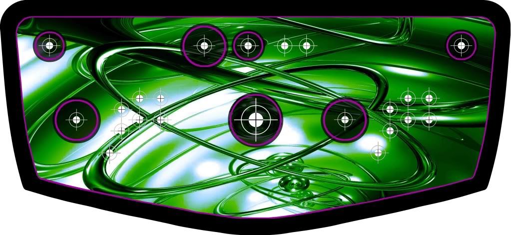

So yeah, those ovals were big.  So trying out this idea...
Picture in your mind, translucent button rings with black buttons.  When the player buttons are lit, they'll be circled in purple LED light.  The top left and top right buttons are the player buttons, which will be lit up in white.  My coin door I'll either use the GGG Novagem CDR for credits, or wire up the ones I have to do it.
The circles around each joystick 'should' line right up with the edge of the joystick bezels.  The spinner and trackball should also be encircled just at their edges as well.  It's a possible idea to route out those circles and put in EL wire.  My only concern is that you can't make a 100% complete circle with it, there's always a break where the ends meet.  Is this true?  I haven't actually used the stuff yet, but it looks that way in the pics I saw on a site that sells the stuff.
Echoing Green Giant on the hammered finish Rustoleum. I did 3 coats on my coin doors, I would recommend doing 5 coats though. These will give you a good idea of how the hammered finish looks...

Neph:  Thanks for taking the time to link those pics!  That looks great!  No primer needed?  Any gloss/satin clearcoat put on after the 5 coats of hammered?
