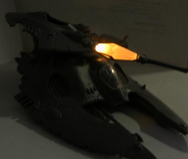

I'm an avid Warhammer 40k player and modeller.  I started installing LED's into some of the vehicles, and one of them had a clear plastic 'crystal' looking thing on its turret.  I wanted the whole thing to light up and glow when the LED's turned on.  When it was clear, you could see right through it and see the LED, looked like crap.  I needed to make it much more opaque.  So I hit it with the Games Workshop clearcoat spray, which they called 'ardcoat.  It worked GREAT.  Frosted the clear plastic right over.  Here's how it came out.
That the effect you're looking for?
EXACTLY!!!!   :cheers:

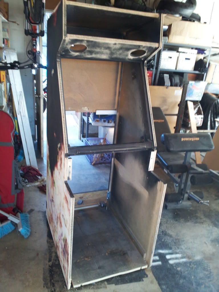

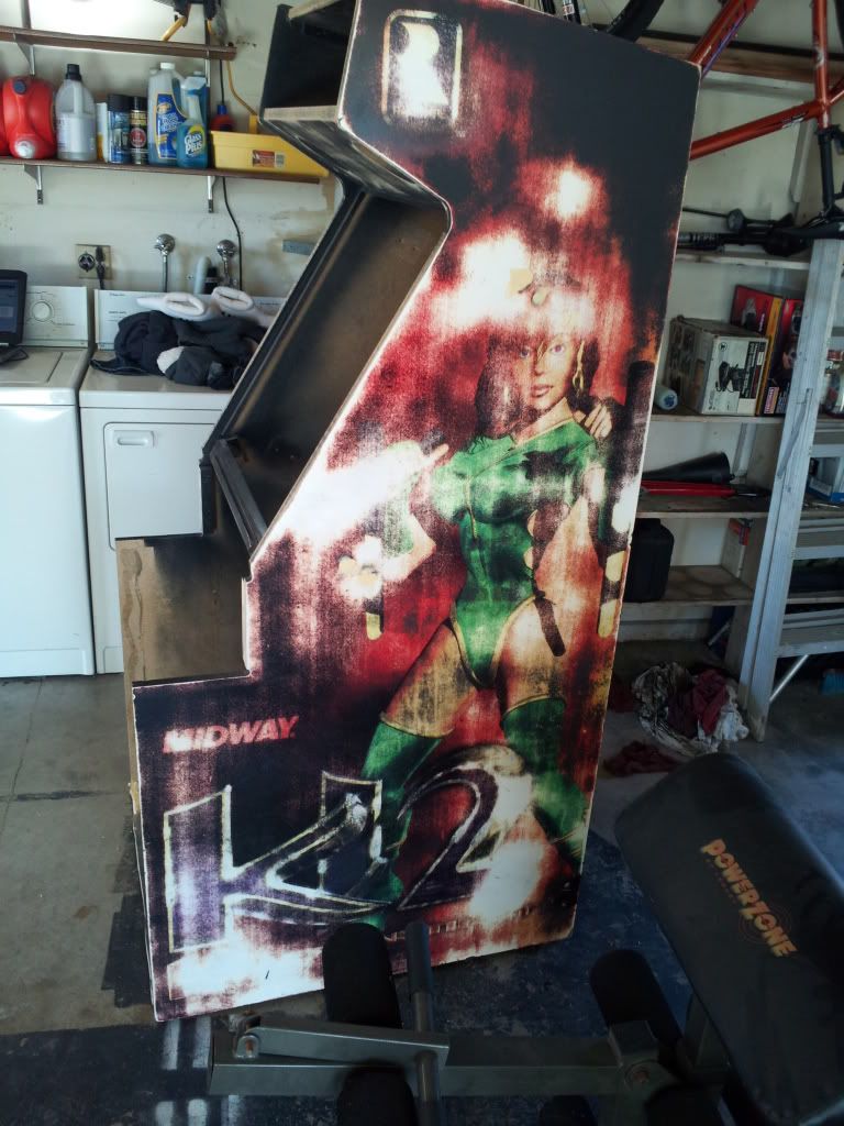

Cabinet work:  The whole thing was sanded down.  I did not expect to find side art hidden underneath the paint!  Look what I found...
Here's the front of the cab now.  The front was cutoff already, and the whole thing completely gutted.

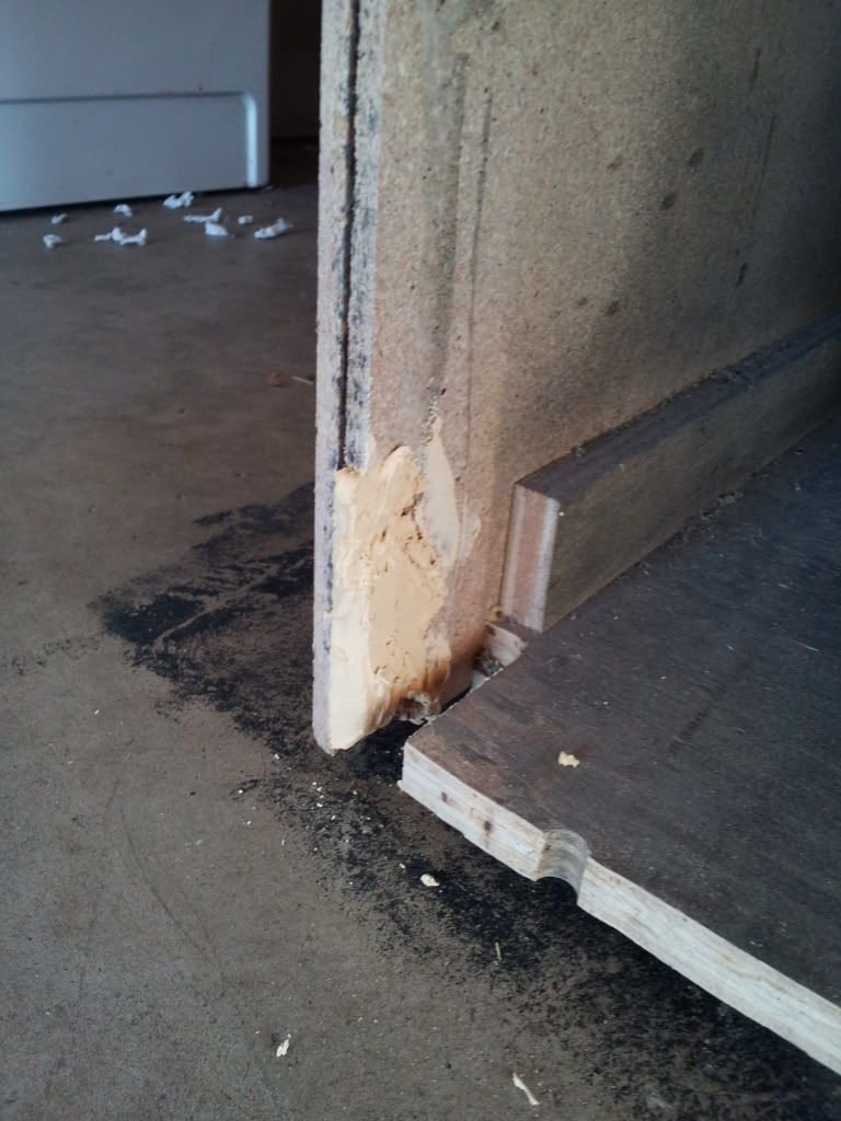

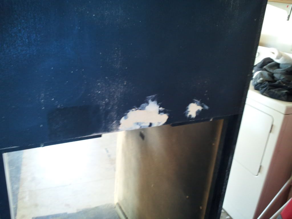

When the front of the cab come off, it decided to take some of the side panel with it.  Trying to do some repair work with wood filler.  I'll be doing this in stages so that I let each coat dry completely before adding more.  Once it's bulked up enough I'll hand-sand it down pray the slot cutter doesn't completely rip it to shreds.
Some more woodfiller work in the back where the lock was.  I also have woodfiller where the bolts were for the monitor bracket.  The bolts that were on the outside of the cab near the bottom of the sides (You can see them in the pic above) have been countersunk into the wood and woodfiller put over them.  Forgot to take before pics, so didn't bother with after pics.

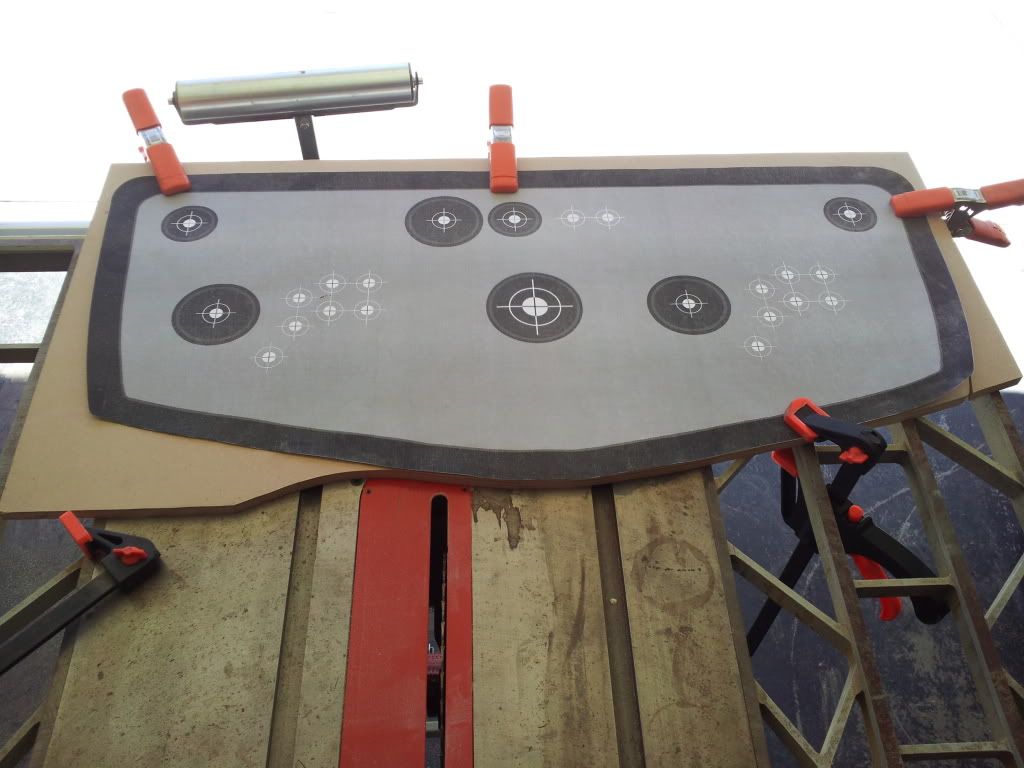

The CP layout was printed out at Kinko's and attached to some MDF.  Here's a pic of of when I started on it.  It's since been fully cut out and the edges sanded to smooth down the imperfections from the jigsaw.
