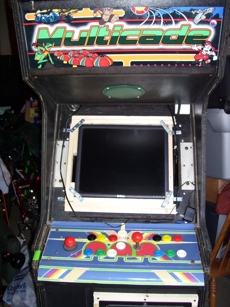

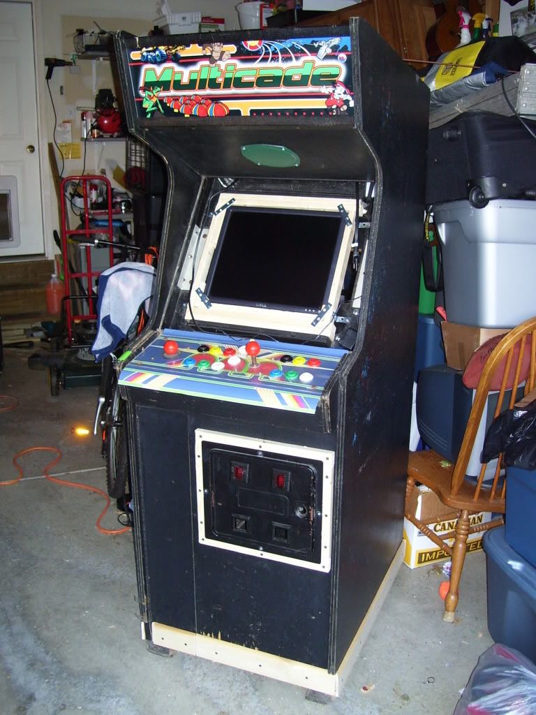

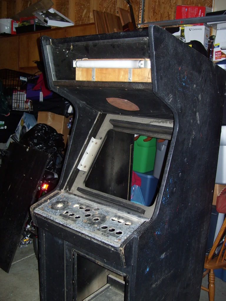

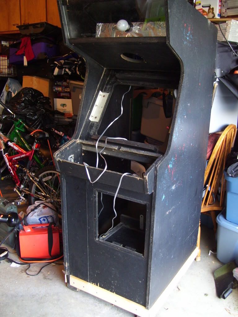

hello everyone , first post here , new to this hobby. my name is randall , 40/m , former police officer , and now employed in the higher learning field ( english was never my strong point in school , and im terrible with spelling, sentence structure, and grammer, i know )  ....im sure i will be asking lots of questions over the time i am here , and looking for answers to some questions, as i have little to no computer experience, and am going for a mame cabinet ....the local guy i got the cabinet from is a member here ( beretta i think he said his board name was)....anyways , where it began was....i was recently at a buddy's house and he had an arcade game in his basement, and it sparked the long time dream ive had to own an arcad game, so i decided to build my own mame arcade cabinet ....i searched craigslist here in ohio, and purchased an empty and well, well used and totally stripped out and empty arcade cabinet from a board member here , ( he said it was a bezerk cabinet- looks like one to me) and have begun the work  ( and there is alot to do )....and since threads like this are useless without pics......
this is how i got it ....
after a few hours work , at this point i was getting all the measurements taken , kind of blueprinting it ,  and planning out whats was gonna go where and how to approach several key items.. the bottom of the cabinet was kinda rough , so i made simple repairs and added some base molding ( should look better once painted im sure)...
- then i found a local arcade re-builder, and made several, several purchases for it ,and then today i spent all day  ( 12 straight hours) working on it ......
the little piece of green t-molding on the left side is the color t-molding i have decided to go with , i purchased 25 feet of it , when i bought my side art , i picked up the flat black paint as well today , along with the adhesive to install my side art once painting is done , for now im still fixing and repairing , and test fitting everything , but this is how it looks right now ....
* what thickness of plexi do most of you all use over your monitors ? the local lowes dosent have much of a selection....also how do most of you with mame set-ups turn off and on your monitors once they are en-cased in plexi?? i have basic skills ,and as able to mount he monitor with little problems ( thanks to grandpa for teaching me basic carpentry)   but cant seem to figure out how im gonna power it on and off...

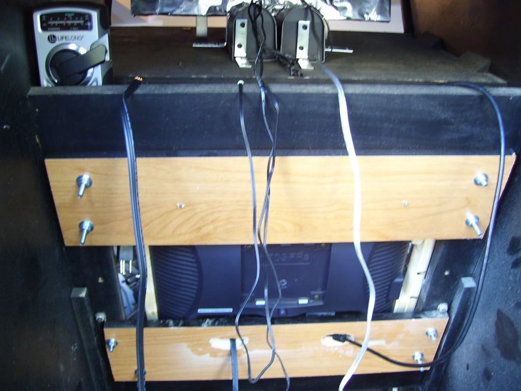

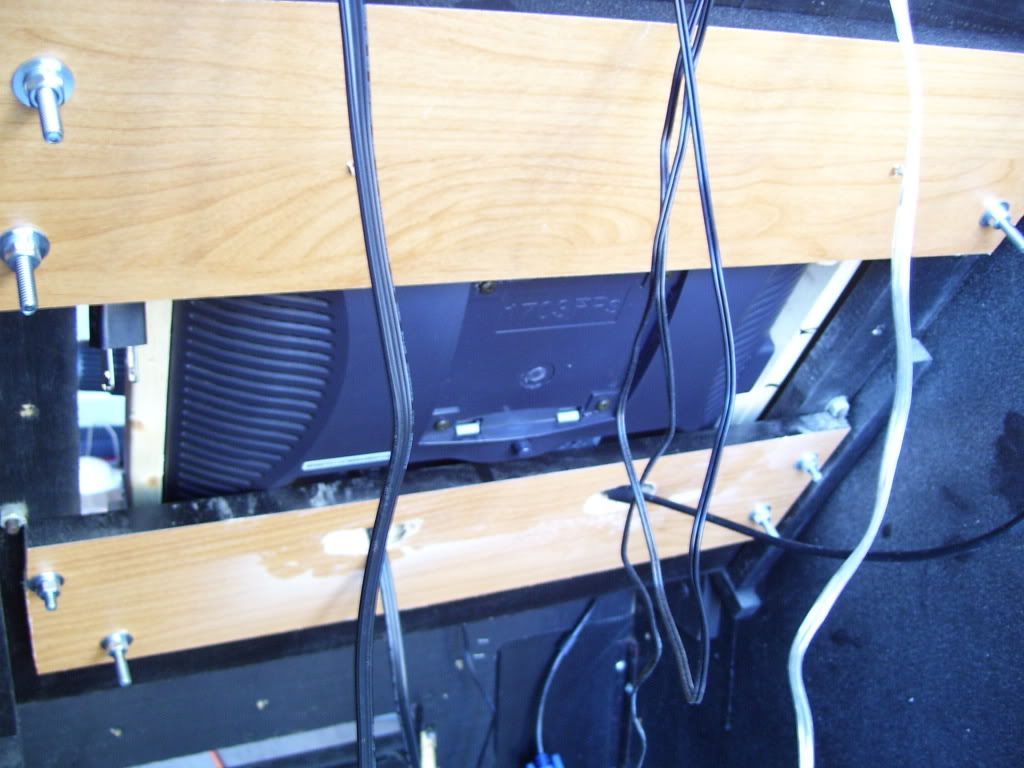

- a shot of the back of the monitor to show how its mounted.....will this be enuff ventilation ? i plan on having 2 fans blowing in and 2 sucking hot air out , and a back pannel with ventilation holes...

Welcome to the forum randall ace, that looks like an interesting project, should keep you busy for a while  :) I can't quite see the top of the monitor in your last photo. What's directly above it? Is there an air gap for the heat to rise to the space behind the marquee light or are you venting out of the back/above the monitor?

here is a pic of that area .....do i need a space above where it mounts? .... i framed it in with 1x2 pieces to hold monitor securely in place ....

Looks good, love the Marquee! how do you find the top row and bottom row being so far apart, if it came like that id be rebuilding the CP.
is that a Radio i see!
cool.

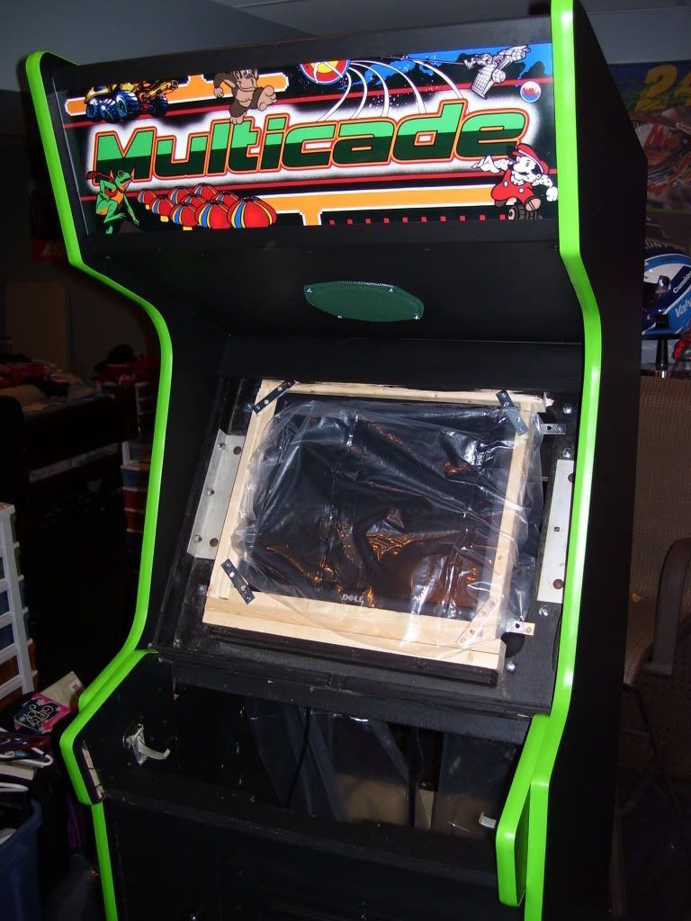

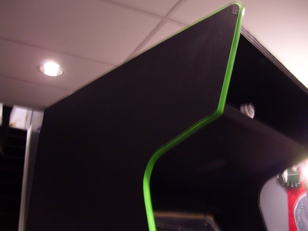

update ...... been a while but work has begun again ... and some plans have changed ... but here are some pics of the progress...
-woodwork has been completed, wiring has been updated , cabinet has been repainted , t-molding added , new control pannel purchased, ect.....

Good work so far!

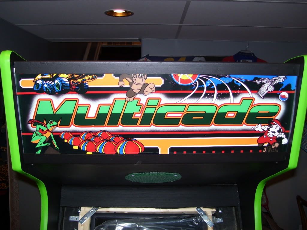

- the green on the speaker grill does not match the t-molding  green ,( too dark )  so i am looking for a paint that more closely matches it
did more work ...so ....more pics ...LOL

That's looking fantastic!  You have done a lovely job there sir.
Artwork and t-molding look great, is that the Galaxian bright green?
Hope you are enjoying putting this baby together.  DaOld Man is right, this is indeed a hungry hungry hobby!
Keep up the good work, cant wait to see it up and running!

That looks like it used to be a Berzerk! I wish I had one of those....
randall ace
  • Posts: 15
  • Last login:February 20, 2011, 05:30:24 pm
Re: my project has begun .....
« Reply #11 on: February 06, 2011, 07:20:59 pm »
Yes it is a former berzerk cabinet.... and the molding is the galaxians bright green, you are correct sir . ....since the coin door is basicly just gonna be there for looks , because all the mechanisms are gone , im trying to figure out a way to light up the coin slots to give the appearance of function ......

Quote from: randall ace
personally I would not change grill color to match t-molding it match to marque  letters color and look nice

Nice job. I'd say just spray the grille black and be done with it. That green tmold really pops!

all the parts are now in , so i assembled and tested them -  the install is not final , it will all look much better when the bezels , ect are in , but its working !
