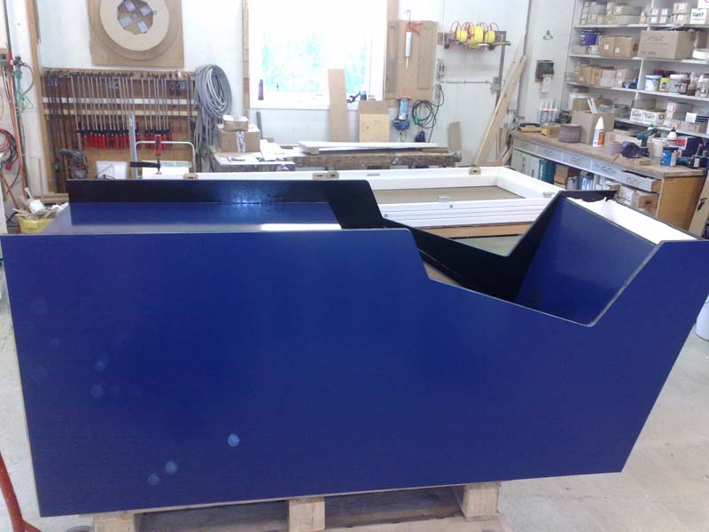

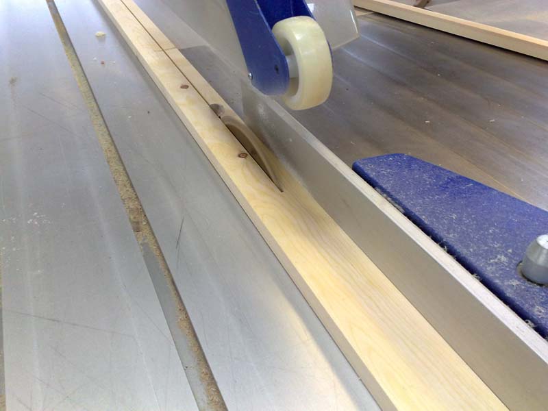

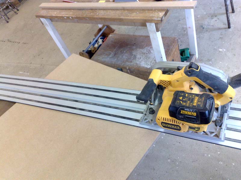

I have been lurking around here for a while now, an finally i got my project under way.... heres how it went down...

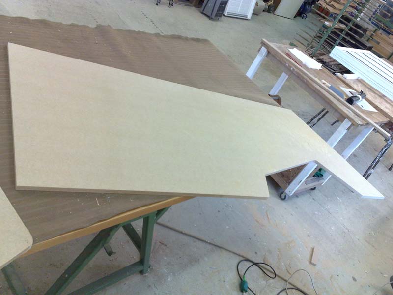

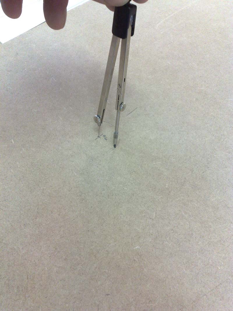

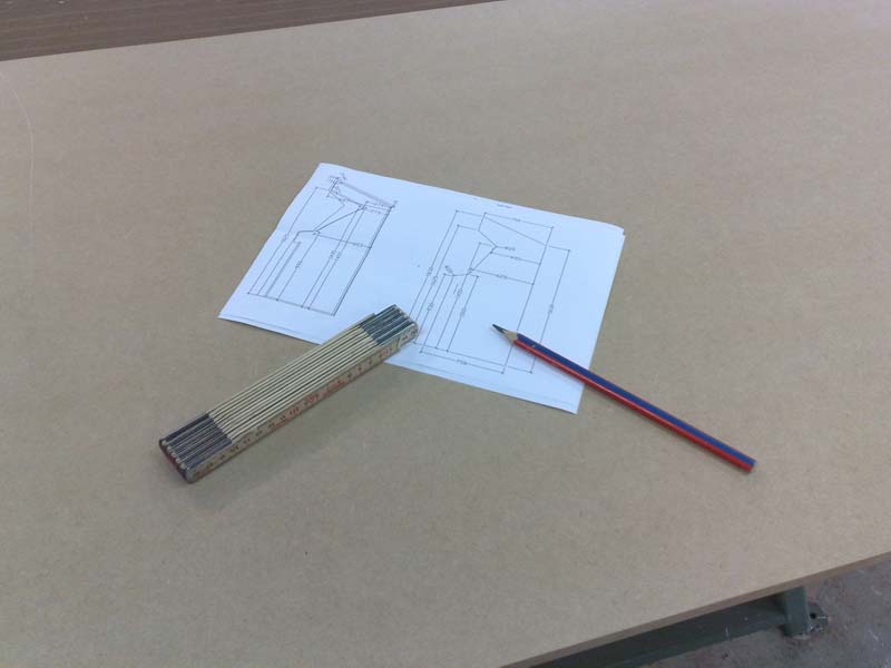

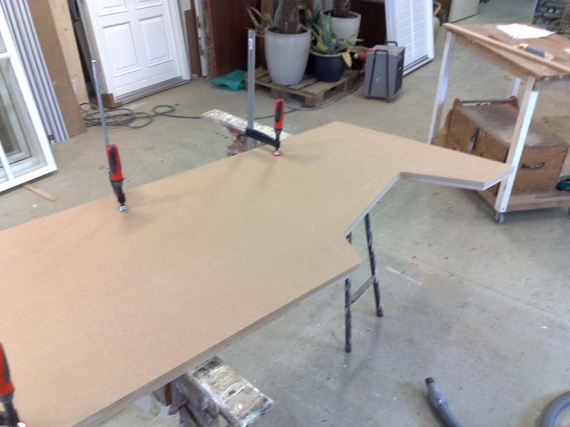

Started to cut 2 pieces of MDF..:
Found the drawing and begun to draw the side of the cab..

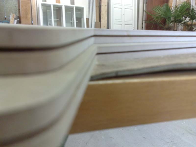

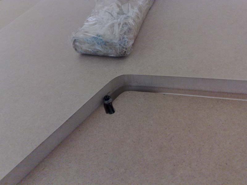

For the curved corners i used a ...Passer, the Danish for it, donīt know the english word...
Cut of the top with a circular saw
And woila! one side finished...

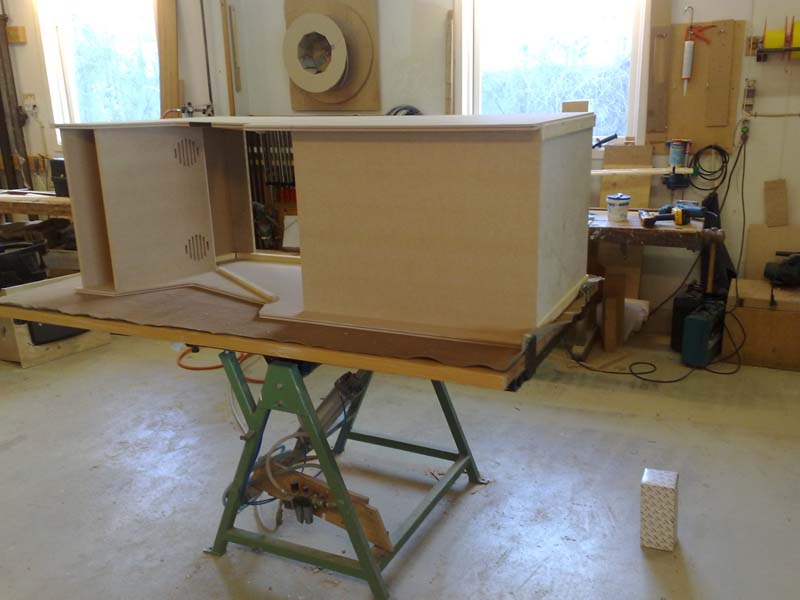

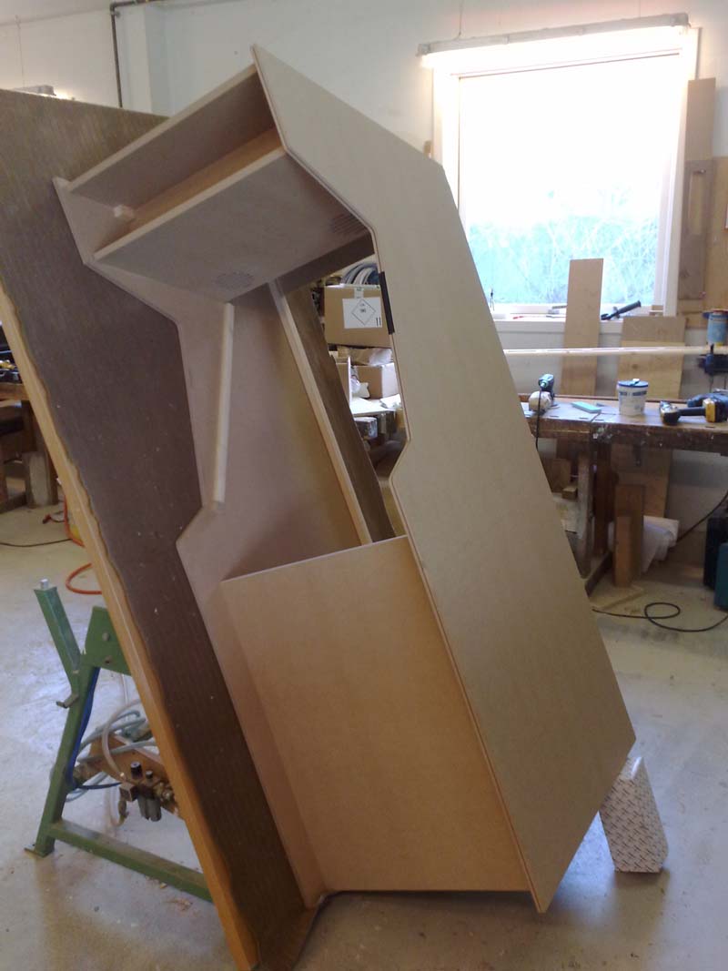

Placed the finished side at the bottom and took the last piece of MDF and placed it on top, and used a router for the cut:
From the bottom
Yes, two finished sides.

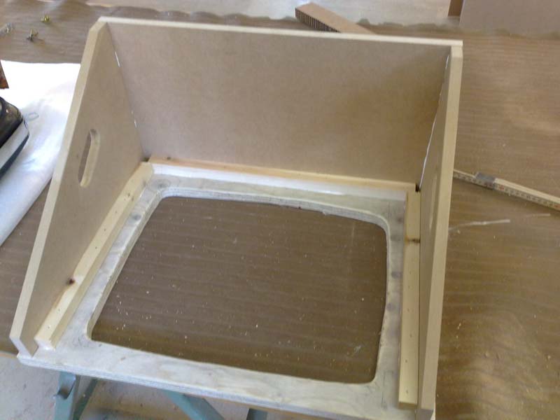

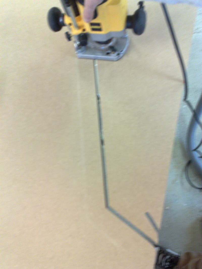

Routed the trench for the T-Mold

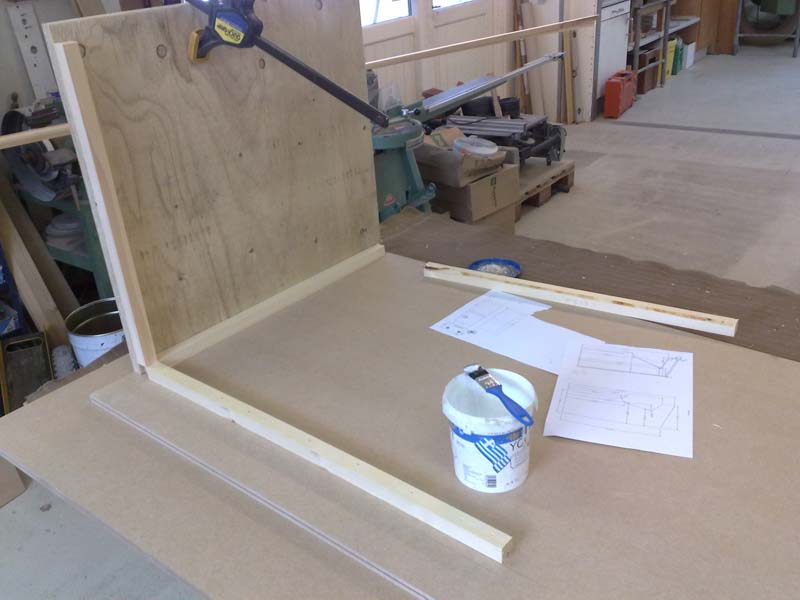

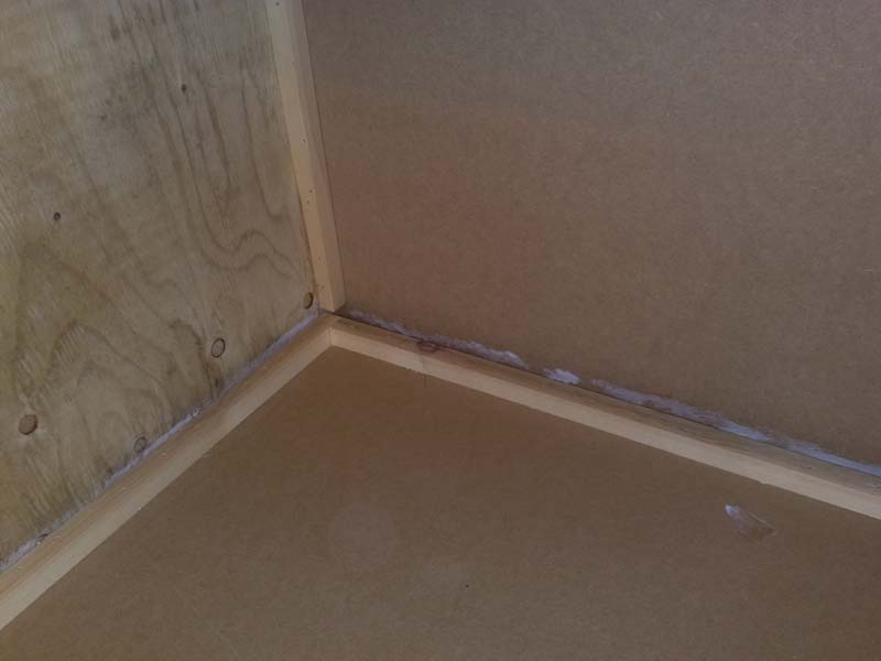

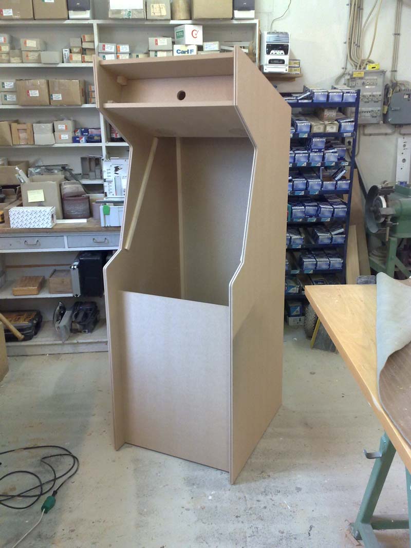

Made some lists for the cab assembly
Assembling, under the lists i used glue for better support, and nailed the whole shabang together from the inside

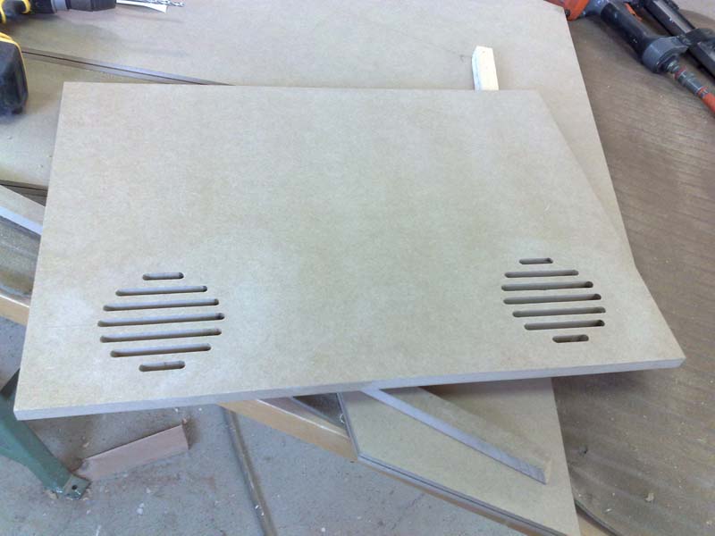

Finished routing the speaker holes..

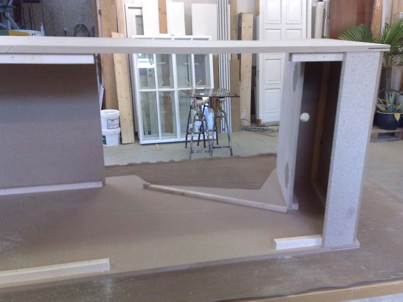

Final assembling
Mounting Bezel supporting lists

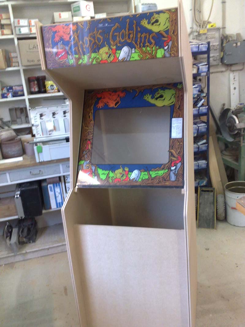

And, finally, finished
And with Marquee and Bezel

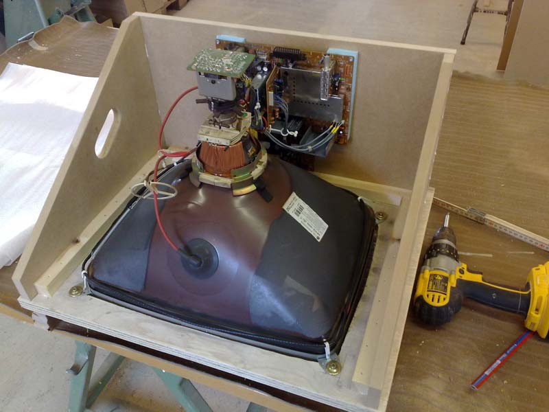

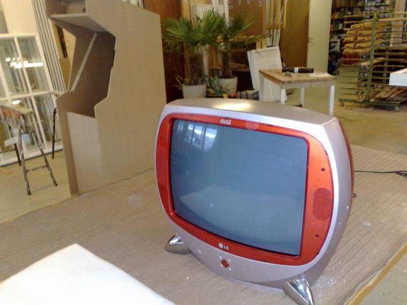

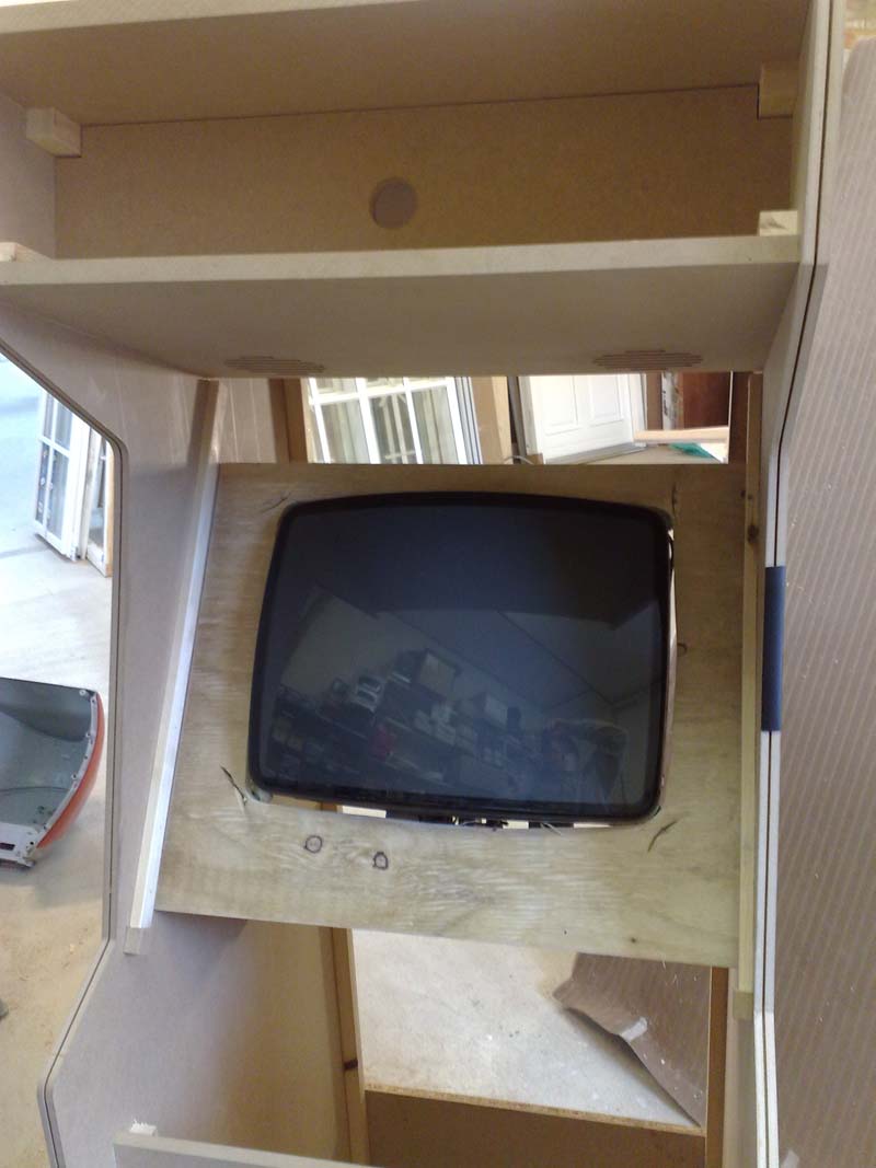

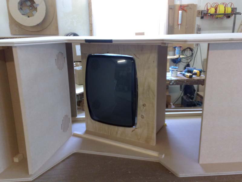

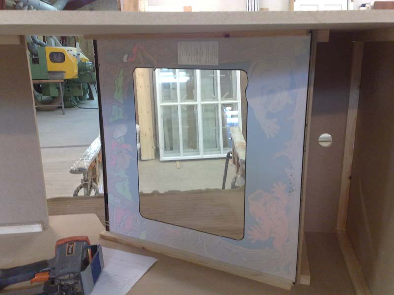

Modded a TV for monitor use..
First was to disassemble the TV. 20"

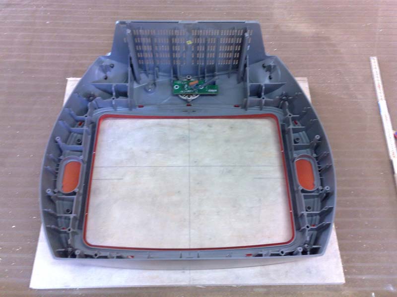

Marked up on a piece of 22mm plywood (for strength!)
Frame assembled

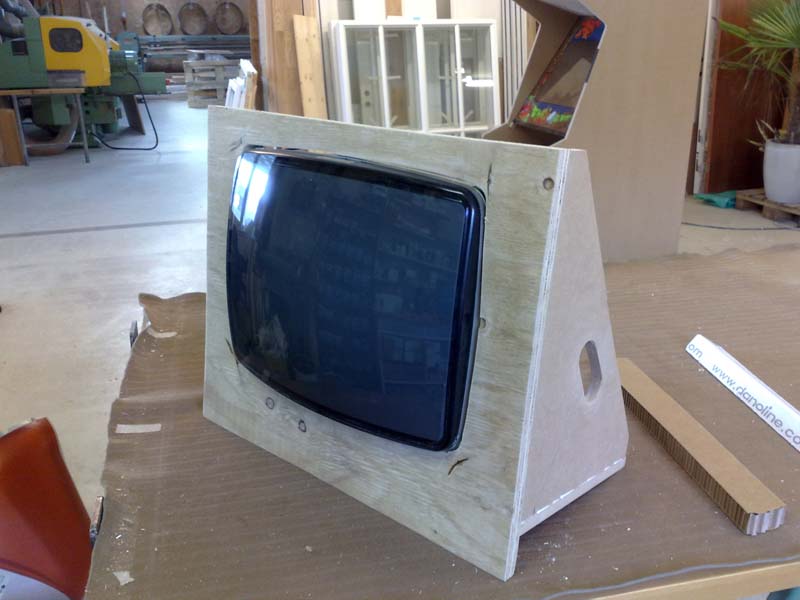

TV installed
Waiting to go in the cab!
Must admit, it very easy to work on a cab when you have a table like this:
Whooops! - to fast with the listīs that holdīs the back door, so had to cut some of it away...
TV markup...
from the other side..
And yes! - Fits like a glove!

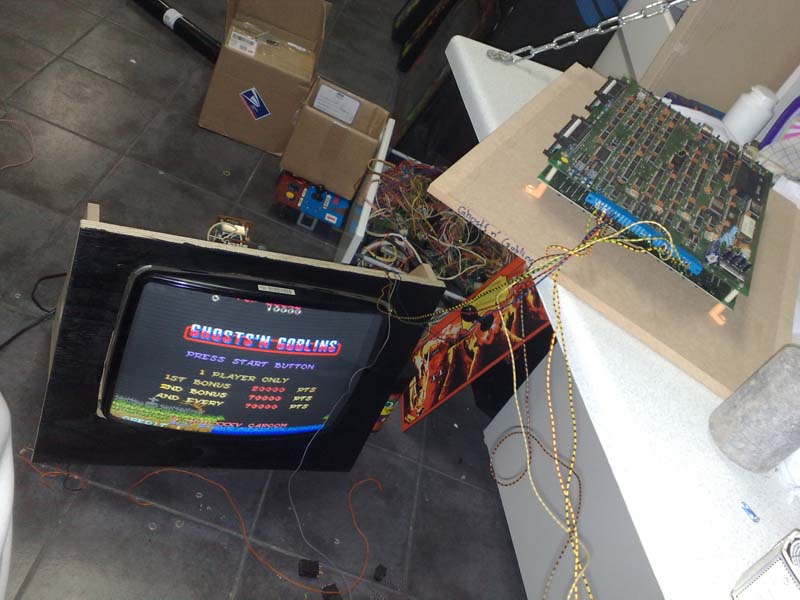

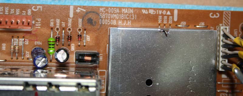

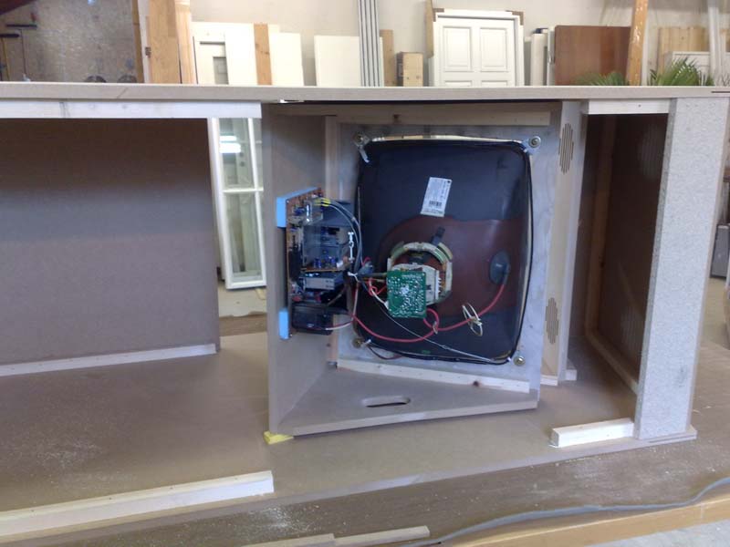

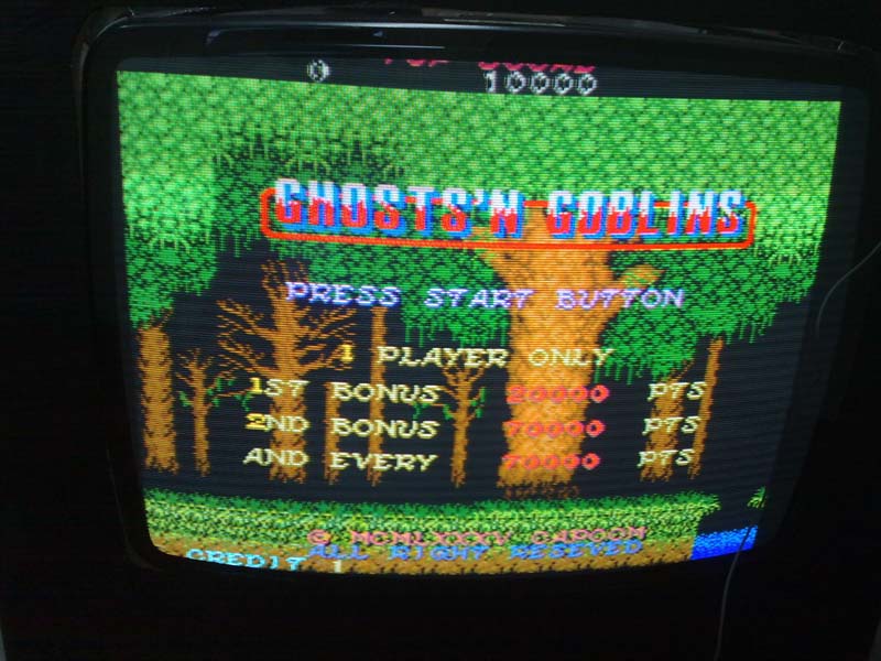

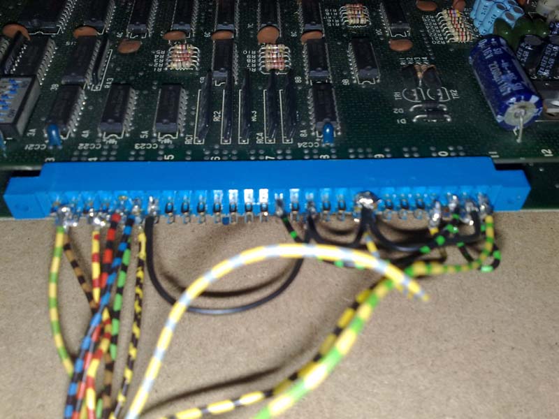

and FINALLY, finished soldering the edge connector, and hooked it up to the PCB.
Also, thereīs some noice on the picture, but i havenīt connected the Video GND yet...
Is there a way to ajust the picture on the screen??
Edge connector...

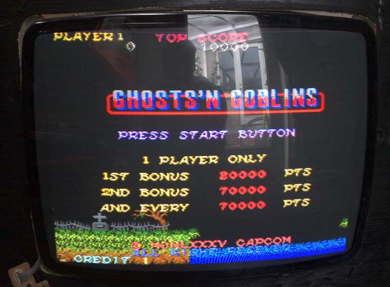

Again, picture of the picture off center.... :'( :'( :'(

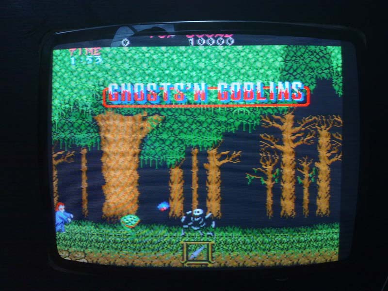

Luckily it was fairly easy for the picture adjustments..
TV Chassis number, which i googled and found the service manual.
the picture on the monitor after the adjustments

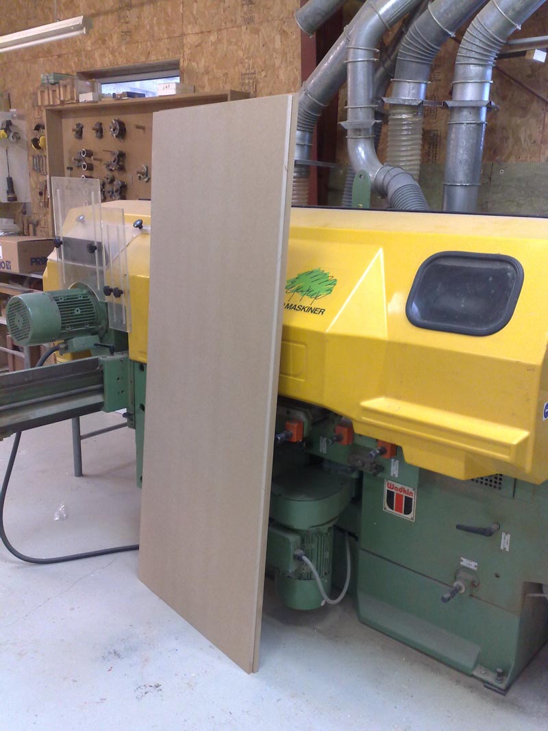

The Millenium Falcon sized yellow monster is somekind of table saw, right?
And then DeWalt router? My good... You have it all.
Oh and the cabb looks killer too.  ;D

the yellow monster is a molding machine LINK and was not used in this build..., and allethe other machines are for free use at my work, so it makes it much easyer!
Please, if any of you know where i can find a CP for this game (populated/unpopulated/in bad condition/in whatever condition) please let me know.. atm, thatīs what holding this from being finished...

The paint was rolled on, and the paint was oil based gloss 40.
The drawing for the cab can be found here

Outstanding finish using a roller  :applaud:
Thanks a million for the drawing!

Got joystick and buttons hooked up yesterday, and it played flawless.
later yesterday i hooked up the speakers, and the sound worked 100%
but now, thereīs no sound, is started to make some scratch noises and then disappearing all together, so now thereīs only a faint "sssssss" in the speakers.... any idea why?? - have i fried a chip? (checked my soldering, and thereīs nothing wrong with it...)
  • Posts: 2021
  • Last login:September 20, 2026, 05:19:14 pm

Have you checked your +5V so it's not too high? What kind of power supply are you using?
Muerto
  • Posts: 103
  • Last login:June 17, 2012, 01:15:51 pm
Re: Ghost n Goblins Scratch build..
« Reply #35 on: March 04, 2010, 09:17:07 am »
Hey.
Checked the +5 and it was 5.32, so adjusted it to 5V:
Power supply:
These are the speakers iīm using, i figured they where ok..??

« Reply #36 on: March 04, 2010, 10:55:35 am »
have you tried to connect them to another audio device to see if the speakers work?
Building my first bartop CAB
Muerto
  • Posts: 103
« Reply #37 on: March 04, 2010, 11:01:55 am »
yes, and they work, when i hooked them up to the GnG pcb yesterday they worked...
  • Posts: 2021
« Reply #38 on: March 04, 2010, 11:05:34 am »
Hopefully, I'm wrong, but I think you might have busted the amp on your PCB. It all depends on how you've hooked those speakers up though.
Here's some examples on how to do it along with an example of how to not do it. The amp wants to get at least 4 ohms apparently.
This is from a Swedish site, so if you can read that there's even more info here: http://cc.arkadtorget.se/speakers.html
Muerto
  • Posts: 103
« Reply #39 on: March 04, 2010, 11:14:13 am »
i hooked them up like the drawing in the middle.. - PARALLEL
i see if i can find the schematics of the PCB, and find that amp...
