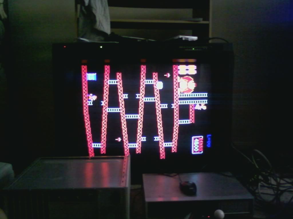

After years of searching last week I was fortunate enough to purchase a Mitsubishi AM-3501R presentation monitor from my local university auction here in Lexington.
Only pic I could find:
For those who are new to these types of monitors they are really really big CRT PC monitors.  They usually have RGB or VGA connections on the back along with myriad of other inputs.  Many of them can sync to 15khz, and that makes them useful for gaming applications.
Basically they are huge arcade monitors that come in a case with all the adjustments conveniently placed on the front and they are digital multisync.

When I got home I connected several systems and a PC and the image was very very good but a too dark for my tastes.  Very very carefully I took off the back of the monitor, discovering in the process there are about six cooling fans mounted in the back, and began to try to recalibrate it.
There were 3 controls.  2 focus controls and one screen control.  I tinkered a bit with the screen control and saw that I could increase the brightness of the screen considerably.  I got out a copy of the T2 DVD which has a THX testing program included and used the contrast, brightness, and color tests til I felt it was adjusted perfectly.  In the end I only had to turn the screen control about 3mm but it made a world of difference.
The focus was already really good, but I figured as long as I had the monitor out I might try to make it a little better.  I only adjusted the top control but I felt it also made a small improvement.  Total time for this "repair" job was about 1 hour.  But it completely restored the image quality.

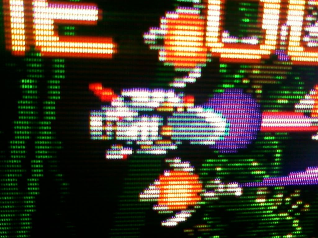

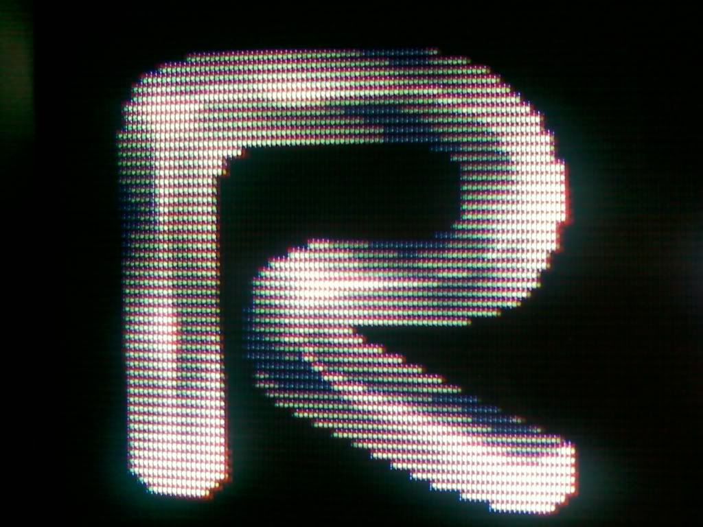

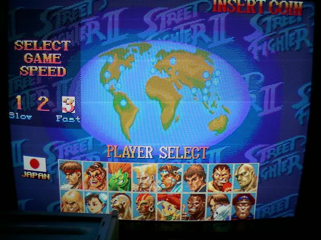

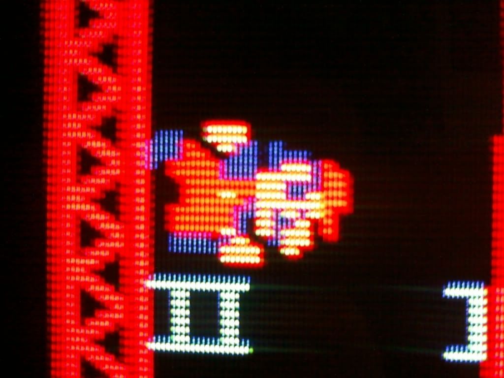

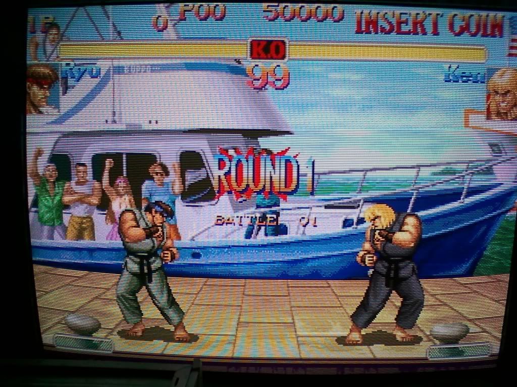

Now, on to performance.  Put simply it's the the best arcade monitor I've ever seen.  Easily as good as anything I've  seen from Betson, Wels Gardner, or Sanwa.  Color and contrast can fill the entire set of contrast bars on test patterns I've used.  The only flaw I've detected is a darkening of the blue color at the very dark levels.  I have never noticed this in game though.
The dot pitch of this monitor is something like .7mm to .8mm.  I haven't been able to find detailed information or a manual so I'm not really sure.  I know the XC series of monitors from Mitsubishi all have .7mm dot pitches and this one is very similar.  Dot pitch is important when it comes to arcade monitors because it determines how sharply detailed the individual pixels of a games artwork will be.  Even if a monitor can display a game in it's native resolution if the dot pitch is too high then the scanlines will be very thick and the game will look very blocky.  A dot pitch of .7mm is pretty much identical to an old arcade monitor.
All the controls for H-size, V-size, H-pos, V-pos, contrast, and brightness are right on the front of the monitor.  Additionally it remembers these settings between resolutions.  I think it can store 5 resolutions.
Setting up MAME was very easy.  I used an Nvidia Geforce FX 5200 in my pc and Soft 15khz.  This monitor has RGBHV connectors in the back so I just used a VGA to RGBHV cable and it worked first try.
I connected two arcade sticks to my computer via USB and I sit about 3 or 4 feet in front of the monitor on the floor and play.  This approximates to playing on a showcase cabinet.  Kind of hurts your back after a little while though.  I was worried when I bought the monitor that sitting that close the image would not be good and the scanlines would be too noticeable.  This has not been my experience.  I think the monitor is just barely small enough to get away with this at 33.5 viewable inches.  On vertical games this works out to about 24" of viewable space which is very nice.
Consoles also look very good.  I play my PS3 on it via the AV/Multi-out setting in 480p.  This required an adapter from Ultimarc though.   I was very surprised to learn that all PS2 and PS1 games can be played in progressive scan via this method.
I highly recommend these monitors to any MAME enthusiast who is looking for a big screen to play on.  They take up about as much floor space as a cab, but they are flat on top so you get some back.  I have a set of pc speakers and a ps3 on top of mine.  This monitor could easily serve as game room tv, multimedia monitor, and MAME set-up at the same time.  Movies and anime looked very good at 640x480.
More pics upcoming.  My digital camera is broken right now but I plan to update with pictures of color bars and games running.

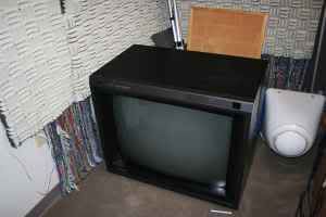

So, nearly a year later and I've finally found some decent pics of this monitor online.  I have also learned a bit more about these kinds of monitors, and thought I would share my views.
Not my own pics, but ones just like mine
For a time I was confused about the image on this monitor compared to my others, and to my TV.  It seemed darker, and duller.
What was wrong was me.  I simply didn't know how to properly calibrate brightness and contrast on a monitor.  On this one it makes a lot more difference than with a standard TV.  I was always setting them too high, and when you do that you get a washed out dull image.  With proper settings the colors look much more natural and vivid.
I had tinkered with the screen control a few times, but I was never letting it warm up properly.  To get the best image quality this monitor needs to be on for at least a couple of hours, probably closer to three.  Then I had to reset all the screen settings to the default, and THEN used a professional video calibration software to set my SCREEN setting on the inside of the monitor.  Since then it has looked fantastic.
One thing that's different about this monitor and others I've seen is that it has a very low color temperature.  It's probably 5000k.  I've been using 6500k for a while now and I vastly prefer it to 9600k.  This monitor might have control somewhere on the inside to adjust this, but I haven't found it.  I can live with it.  I does feel very "arcadey" and make me feel all warm inside :P
I was also getting a dark image on this monitor due to the way I was connecting my consoles to it.  I was using the psx>vga adapter from Ultimarc to connect my PS3 to the monitor.  For some reason this adapter darkens the image when you do that.
So instead of the adapter I bought some phono>BNC adapters like these in the photo:
But I put them on the RGB connectors instead, and connected my ps3 directly to the monitor with no adapter, and set it my PS3 to SCART mode in 480p.  This is sync on green, and compatible with the monitor.  The result was a much brighter and colorful image.  The only downside to this is that for some reason SCART images are off-center and very wide, and even using the H-size control I can't get every bit of the screen to fit.  I can almost get it, probably 90% of the screen or so.  But, I can live with it.  I've tried going back and playing games in interlaced modes on my regular tv and I can't believe how I never noticed the interlacing artifacts as much before.
The geometry and convergence on this tv are excellent for what it is, and better than most arcade monitors I've come across.  However, they are not perfect.  In a focus test the text does become blurry a bit in the corners, but is still readable.  This is completely unnoticable while playing games though.
The blue gun on this monitor is weak, and also accounts for the slightly dim image.  It just can't draw dark blues that well.  This is really only apparent in color tests though.
All in all I'm extremely happy with this monitor.  It's kind of sad though, because this thing has really taken over as my main gaming display, and the cab is in a state of ruin beside it.  It's just too tempting to play on the big display than to fix up the cab and play on a 19" monitor in it.
Also as time has passed by I believe I have become a little bored with MAME, and wish to move on to the next generation of arcade games.  That means 3d games from the mid-90's on.  MAME doesn't do those very well, and consoles do.  When I do finish up the restoration of the cab, it's going to be focused on consoles.  Probably with a 25" VGA monitor, or a 32" LCD.  I need something to play SSFIV on!

And finally I took a few pictures:
Right click the images and view them by themselves for higher resolution.
Sorry for the quality, I used my friends cell phone, and I'm not a good digital photographer.
