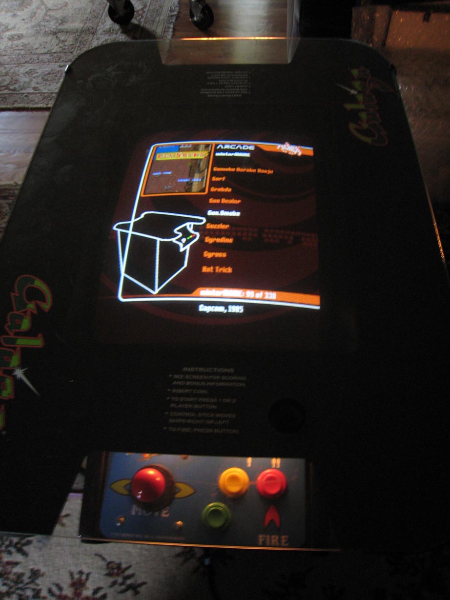

Adding in my resources here for archival purposes.
Midway cocktail (formerly a galaga table), metal CPs.
3 buttons each, U360 sticks, and look like this:
http://www.waste.org/~winkles/winterMAME/pix/winterMALA.jpg

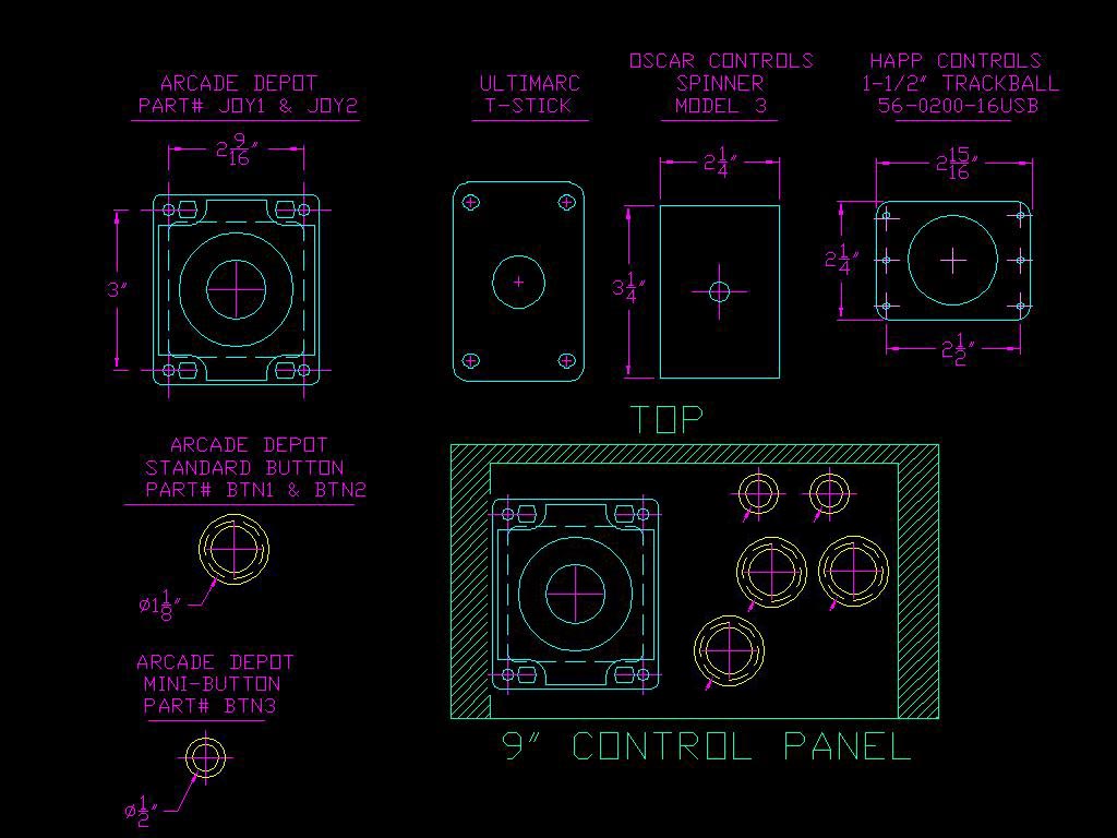

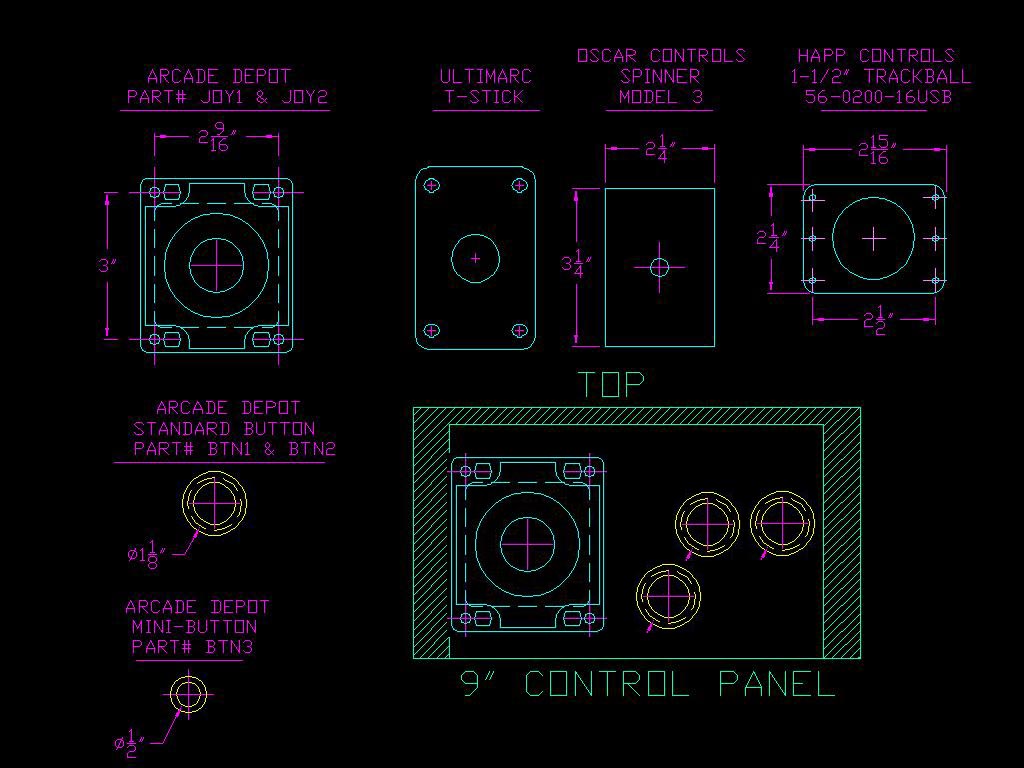

here's the templates to send to arcadeDepot for drilling:
http://www.waste.org/~winkles/winterMAME/pix/winterMAMEP1.jpg
http://www.waste.org/~winkles/winterMAME/pix/winterMAMEP2.jpg

This was all done about 2 years ago, things may have changed since then.
