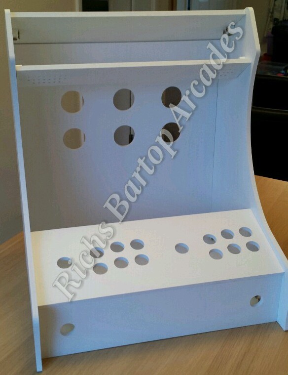

I install one of those mini-amplifiers in between the speakers, just behind the marquee light, so there's no shadow. The volume control faces the rear of the cab, so if you need to change the volume, you open the door and reach in. I'm of the mind, if you're playing an arcade game, there's going to be sound. I may configure an external control for volume in the future, but if I do, it'll either be hidden or a custom request.
