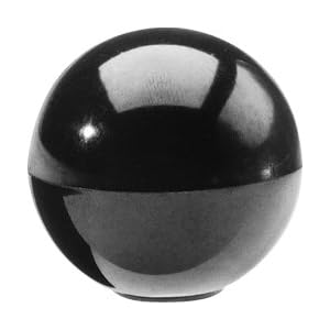

3. Shooter:
I wanted it to look like a normal shooter and use normal shooter springs, but a normal shooter would never work with a mouse since if it was close enough to read, the springs would strike and grind across the mouse -- there wasn’t enough shaft at the end for the mouse sensor to read the desired range of motion.
The answer was to make a longer shaft out of straight and smooth 3/8” round aluminum.  A mouse can read this surface as long as it is in range of the sensor. (More on this in section 5.)
First, cut a 16-18” length, then use a die from a tap and die set to cut 3/8 – 16 threads on the end for a shooter knob.  Some thin cardboard folded around the shaft can prevent vise grips from marring the surface.  Be sure to lubricate as you cut threads.
The parts for the shooter go together in this order:
1. Shooter knob  Check DimcoGray website for other style knobs, if desired. Anything with a 3/8-16 thread will work, metal insert preferred.
2. Flat washer - 25/64 x 5/8 x 16 gauge – Size on these is CRITICAL.  Make sure all four flat washers in the shooter are this size.
3. Barrel spring
4. Flat washer
5. Shooter housing
*6. Front of controller with Shooter housing mounting plate attached to the inside.
(*=Not needed until the shooter assembly is ready for final installation.  See section 5.)
7. Flat washer
8. Inner plunger spring
9. Flat washer
Position the assembly vertically with the knob on the table.  Compress the inner plunger spring about 1/2 inch and mark the shaft.
Drill a small hole at the mark and put a piece of 20 gauge (.035”) Mechanic’s wire through and bend the ends so the wire wraps around the shaft in an “S” shape to stop the spring and washer as shown here.
The final assembly should have around 4 3/4” to 5” of travel. (Full back to full forward)
Ensure that the shaft from the bent wire to the end is smooth with no burrs since it will be sliding against the mouse housing.
