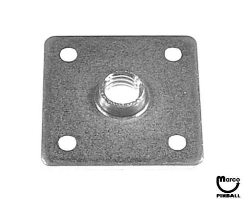

Progressing really nicely.  :applaud: :applaud:  Is there any way to install pinball buttons on the sides of the cabinet?   Looks like supports would block the installation of the buttons.
You could just drill straight through the support. But I am not going for Pinball buttons this time around though.
