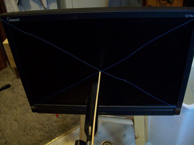

Ok, I have been working on a rig to rotate a LCD monitor using one of DarthPauls actuators. (Thanks DarthPaul!).
The initial test was a complete success.
I am also working on a new version of MRotate that I  plan to use on this rig.
This version will use the 9 pin (or 25 pin if you have a really old computer) com port.
I am calling this version MRotate4.
It will not require any kind of pic chip to get I/O. It will use two pins for outputs to turn on the drive, and two pins for inputs to monitor the limit switches.
The pins are: (on a 9 pin port)
Outputs:
Pin 4 DTR
Pin 7 RTS
Inputs:
Pin 1 DCD
Pin 6 DSR
The comport wont require the special inpout32.dll that the printer port needs, and it shouldnt have the annoying "some pins turn on during boot up".
Im not sure if a usb to serial convertor will work, but Im guessing it will.
I plan to make the drive for the motor very simple too.
The disadvantages of using the comport (without some sort of I/O chip), is the limited number of outputs and inputs.
So some of the features available in other versions wont be available in MRotate4. (Degauss, monitor off, drive enable, stop button, etc)
My question is: How many of you have comports on your mame PC? I know the comport is going the same path as the printer port, but I have seen some fairly new computers with at least one comport.
I have attached a picture of my test rig. It is strapped to a bar stool right now, notice the belt? (I have often wondered why God allowed me to get fat in my old years, now I know why LOL).
I used the same pine 2X4 rig I built for the stepper motor trial, which was a failure. The actuator, however works very well.

Here is a better picture of the rig. I added some labels to help explain what I am doing.

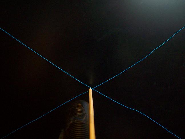

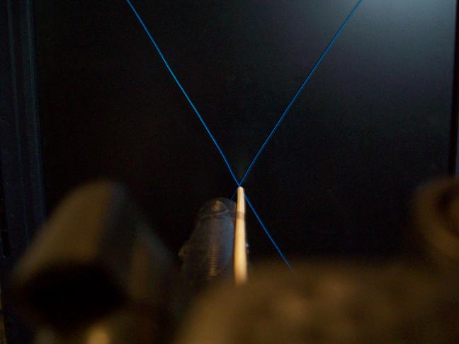

Ok, Ive got a couple of fairly decent (better) videos, shot from the other side of the rig.

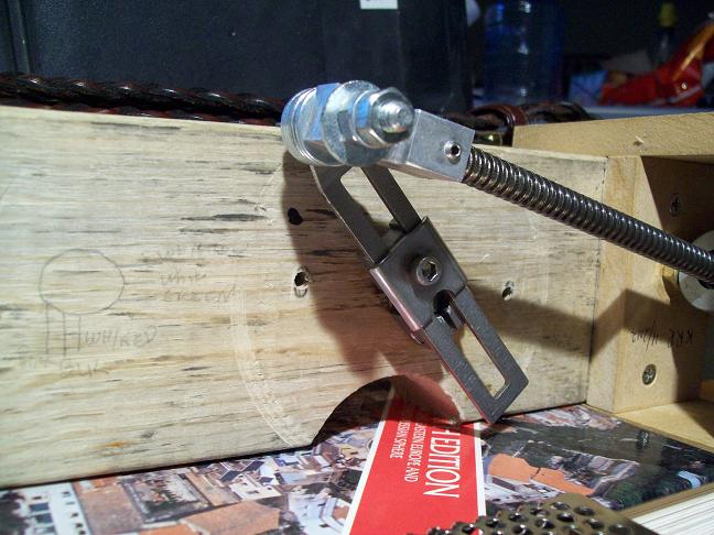

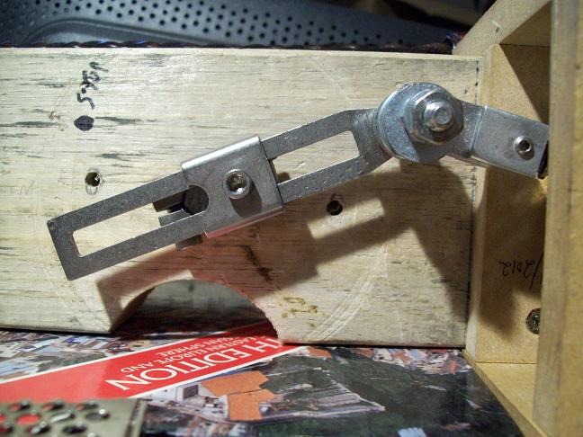

Here is the schematic diagram of my simple drive. (Any suggestions for a name for this drive? (be nice!)).
I found that it is not necessary to use both contacts on the limit switches. I just wired both the terminals on the strip for each switch to just the NC contact of the switch. So I adjusted this drawing to show that, no need to use extra terminals if you dont need them.
Edit: I left out one very important thing on this drawing, and that is a fuse on the power from the power supply.
The fuse can be an auto type fuse, and it should be rated in amps high enough to not blow during normal operation, but low enough to blow if the motor hangs up. With the actuator Im using, I found that while the motor is running it draws around a half amp, and when it stalls it draws right at 5 amps.

Ok, I found a limit switch arm that I figured would work and look better than the hastily thrown together crank I used to test the actuator rig.
I had to drill the hole in the center of the arm to fit the 3/8" shaft.
The arm had a roller on the end, I removed it and bored that hole out to 1/4"
It is adjustable in crank length and rotation angle on shaft.
I am happy with the way it turned out:

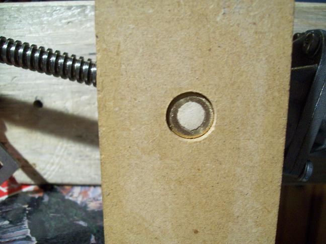

Next I made bearings for the actuator pivot points.
I used brass pipe plugs (3/8"). I drill out a hole in the center for the pivot. (1/4", a little big but as close to pivot diameter that I had). I then filled the plug with wood putty. The putty set up pretty hard. I did this to keep oil from soaking into the wood and to help steady the pivot. Probably  not necessary. Then I drilled out the wood putty (1/4") to the depth of the length of the pivot.
I then bored 1/2" holes in the wood supports and threaded the plugs in. It is a tight fit and I dont think they are going anywhere.
The actuator pivots a lot smoother and stays in line better.
Here is a pic of the backside of the bushing, showing the wood putty filler.
First pic of the new crank was with the monitor in vertical position. here it is in horizontal. (I dont have the mechanical stops or limit switches installed yet, its a bit past horizontal. You can see where I marked the stop for vertical (probably use a 1/4" bolt through the 2X4). There is a hole where I mounted the servo once upon a time. I plan to use this for the horizontal stop bolt.
I make the mechanical stops so the monitor can turn past the level vert and horz positions. This allows me some adjustment room on the switches, and if it hits the mechanical stop I will know because the screen will be crooked.
I then set up the rig to test for proper alignment. I ran small wirewrapping wire between the corners to find center of the screen. I then set up my camera tripod with a wood skewer for a pointer.
This pic shows monitor in vertical and pointer lined up on screen center.
And here it is rotated to horizontal. The screen is about 1/4" off center from vertical position.
Im going to have to live with this. I plan to center the monitor with the cabinet while in horizontal position, so maybe 1/4" to the side while in vertical wont be too noticeable.
And here is how I set up the centering guide. I ran the small wires (can be thread too) between each corner of the screen (not the monitor but the viewable portion of the screen). I scotch taped the wires to the monitor to hold in place. Where the wires intersect should be the center of the screen.
