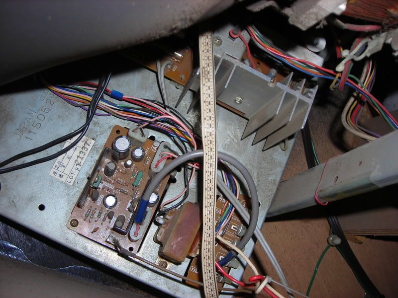

Well I've got a question and I fear the answer but since I intend to fully restore my cab I have to ask.
I recently purchased a Vs Super Mario Bros at an auction. Everything works perfectly... except the sound. The speaker makes a buzzing sound and if you turn it up it makes a screeching sound (I know its the speaker as I've played with the sound and plugged/unplugged it). Soo... thoughts from people who have had similar problems?

The audio amplifier circuit board is mounted on the video monitor. It needs to be recapped. Bob Roberts sells a kit for it.

Kevin Mullins
  • Posts: 4504
    • Me on Myspace
Re: Vs Super Mario Bros
« Reply #5 on: February 20, 2009, 04:04:12 pm »
2) I removed the speaker, turned the sound up, and I can actually hear sound (very low) coming from the game, whats that all about?
am I to assume this is the kit then, Nintendo Audio Board Repair Kit    $5.00   (its under Sanyo)
You are probably hearing bits of sound bleeding from the amplifier circuit especially if have it turned all the way up.
(not sure what else to call it, I'm sure there's a more technical explanation)
Are the sounds more normal to the game sounds?
And yes, that would be the audio board repair kit for the Sanyo 20EZ monitor.

Lecithin
  • Posts: 96
  • Last login:April 04, 2012, 10:15:48 am
« Reply #9 on: February 20, 2009, 08:54:06 pm »
On the rails I get   Japan EZV 1150521
a pic
another
« Last Edit: February 20, 2009, 09:18:19 pm by Lecithin »
Kevin Mullins
  • Posts: 4504
    • Me on Myspace
« Reply #10 on: February 20, 2009, 11:58:29 pm »
Yup, that's a Sanyo 20EZV
The small board with the fat grey cable in your first pic is the audio board.
