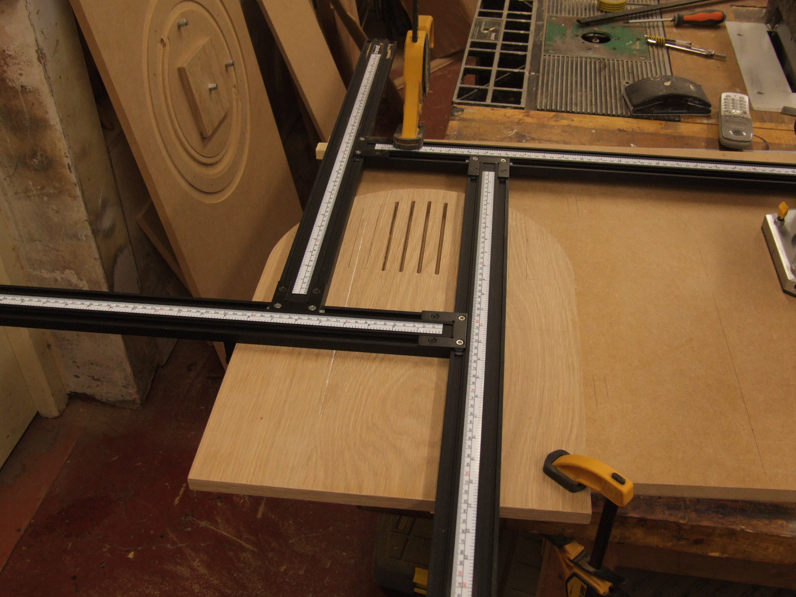

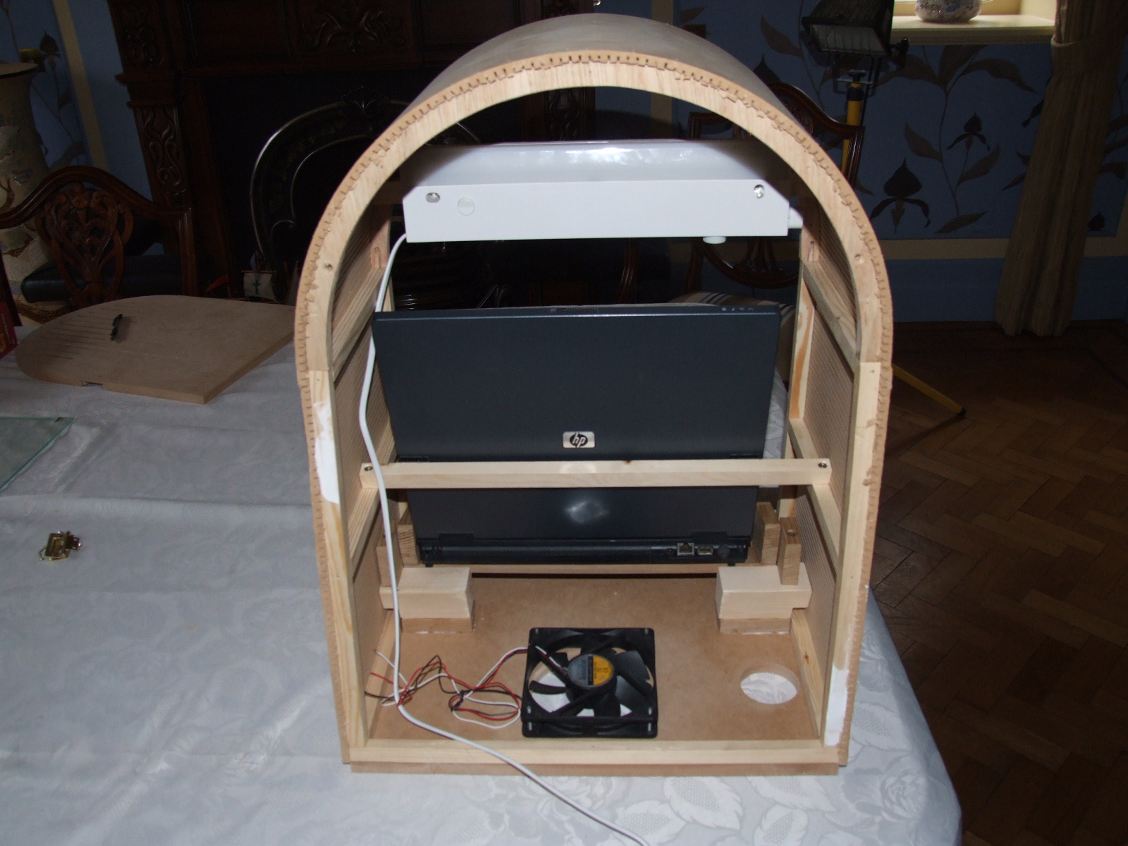

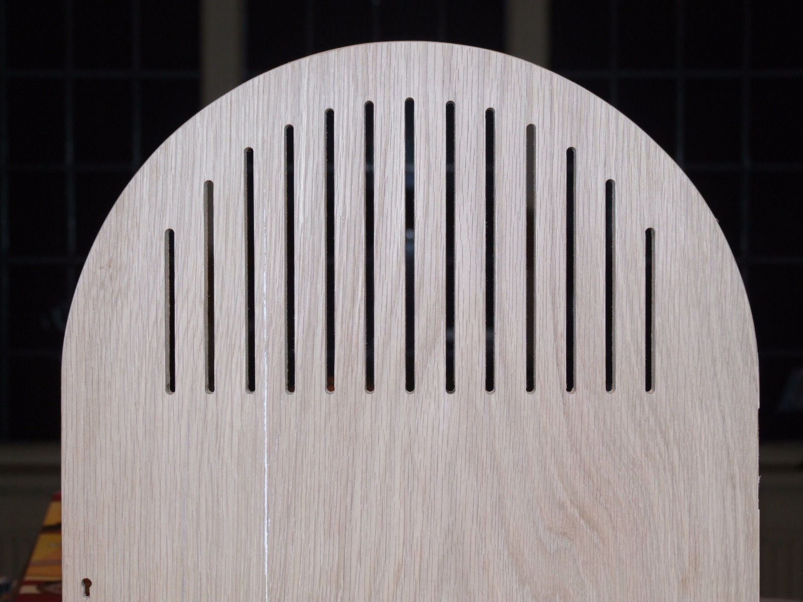

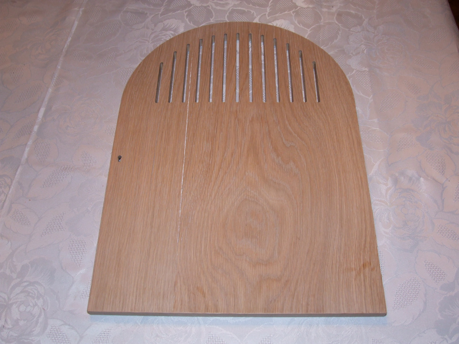

I am becoming increasingly concerned with ventilation, as the trial version of the juke I made got very hot to the point that the laptop I intend to use for the guts would become jittery. It's AMD based and well I know they tend to run hot but this gets very hot.
We decided to route some slots in the back door. I don't know the name for this tool, but basically once set the router fits within the internal space and its north/south travel is restricted to the correct amount by the horizontal rulers. This was after we'd done the first few slots - this took almost a full day as the spacing and length of each slot is absolutely critical to get the look we were after, and it was a one time only deal, obviously:
This picture shows both the finished routing, and you can also see where the veneer shrunk slightly during application. this is quite concerning (the white is filler) but as it's the back door which won't be seen, not the end of the world. We have a new technique for application in mind for the sidewall veneer - more on that to come!
The top line of the routed slots follows a concentric circle on the same centre as the outer shape. Therefore if you measure from the top point of each slot to the tangent of the outer circle, the distance is the same for all slots  -even though it doesn't look like that in the pic!!

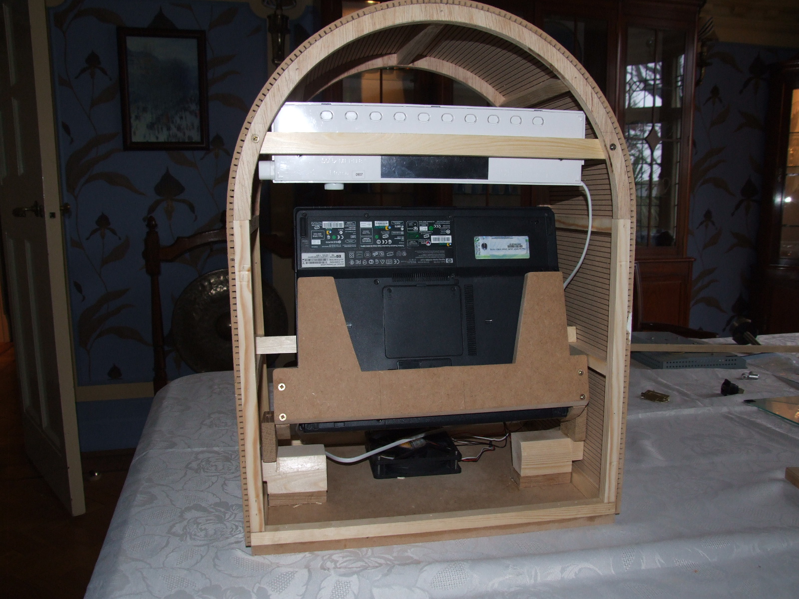

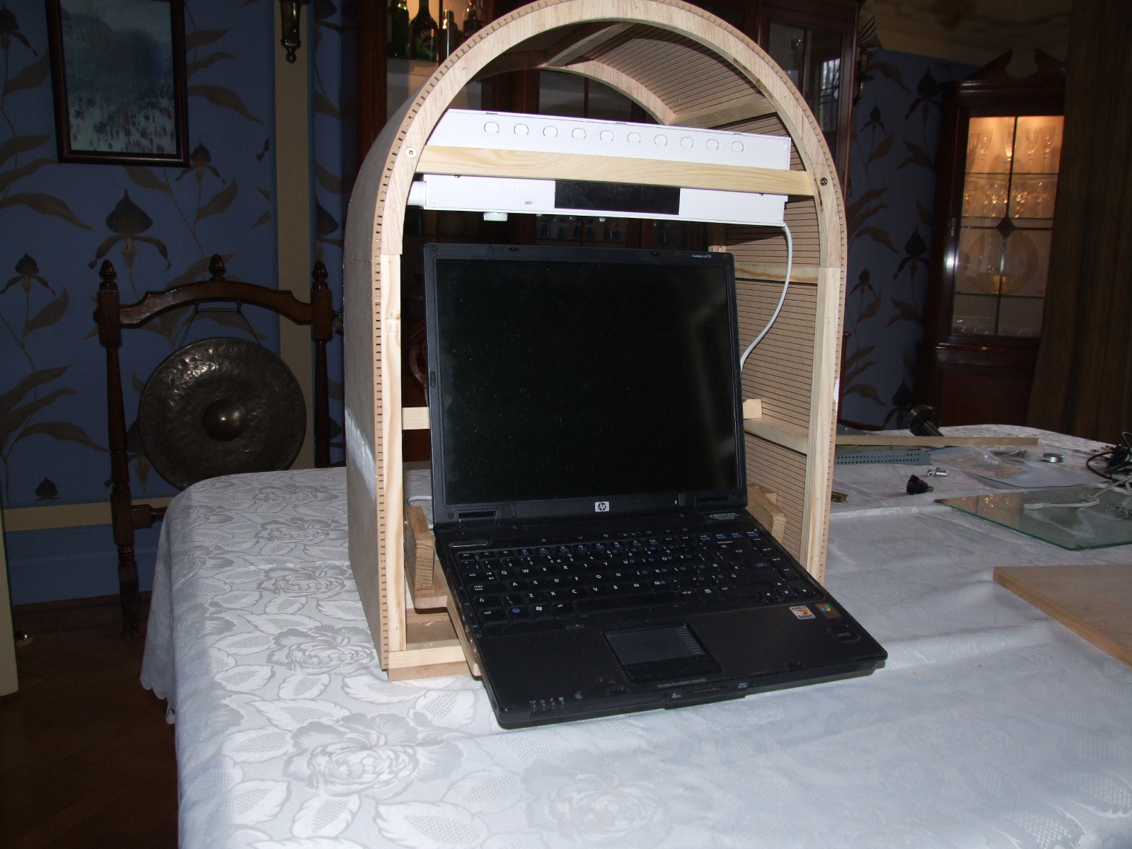

we next started to plan the layout of the laptop and marquee light. We decided that access requirements to the laptop would be few and far between (heh) but we also didn't want to be poking about inside the juke whenever changes were needed.
The first pic shows the front view and you can also see the marquee fluorescent in this pic. I was going to use some really great LED strip for the light, but the one I liked was about £120 per metre... spendy.
This is from the back with the laptop closed. Forgive the Heath-Robinson blocks getting everything to the correct height! If you notice where the laptop hinge is (toward the bottom) you'll see that there are two rounded pieces of MDF. This ensures that the laptop hinges down for acess along the axis of the laptop screen hinge.
The catch that holds the laptop shut is easily accessible, and when you open the laptop the screen stays in place (it's velcroed to the horizontal batten that's visible in the front pic above). The keyboard comes out a comfortable distance for any changes that may be required. Despite the slightly rough look, it works surprisingly well  :cheers:
I should have a few more progress pics later on today. In the pics above, the front bendy MDF edge has only been rough cut - will be flush trimmed later. I said we couldn't flush trim that or the veneer earlier. That was a load of rubbish  :dunno

I dont' have any photos because my ghetto juke has never made it past protype stages, but anyways I put a little PC fan at the very top blowing out which of course heat rises so it blows out the hot air and cooler air is sucked in from little notches near the bottom.
I really like your idea putting in little notches for venting. It just has that finished look opposed to just cutting a hole.
The slots fit quite well with the finish we're looking for imho. What we did realise though is that the position we've put the fan means that the laptop will actually get very little cooling. I am thinking the fan should have been towards the top, sucking warm air out, but we are where we are.
So, we made a little aluminium deflector which will fitover the fan, attached to the laptop support pillars. This will hopefully ensure that at least some airflow reaches the laptop but because it's 4" narrower than the width of the internal cab we still get airflow over the touchscreen. We hope. It's not up to Franco's metalworking but it suits the purpose :) I don't have an installed pic - everything is apart as we're staining - but hopefully my budget description and pics before will help...
As I said, we started staining - the back door prior to lacquering. You can see the join between the two pieces of veneer, but as I said earlier, we have a better idea now of how to apply it on the sides of the unit. Touch wood, that'll be perfect:
We weren't that happy with the dimple on the volume knob. My Dad suggested an aluminium insert, flush with the top surface  of the knob. It's an aluminium spacer, fit into a hole through the knob. The wooden insert is an 8mm diameter piece of oak, hammered into place. ONce it was in, we stained the piece, but the oak 8mm bit rose above the rim of the aluminium. The aluminium is araldited in place, but a few minutes in the vice set the oak insert flush again. It's perfectly smooth and I'm please with how it turned out.

This is probably the last update for a few days or so. Once the veneer had set in place, we flush trimmed it, then sanded it to death as mentioned in the earlier post. These pics look a world better than before we did any of this work. I'm really pleased with it.
We also fit some real oak at the bottom of each side, about 12mm deep, which you can just make out in this pic. we were concerned that if the juke got a knock, the veneer would chip. This will stop that happening.
This was after all the sanding etc, it's not a brilliant pic but it gets the job done:
Before staining the main body, we had to fit the front and back arches:
From the front...
From the back (the two circular cutouts you can see in the frame are for power (at the top) and USB (at the bottom))...
This final pic shows the profile of the front and back arches in relation to the cabinet body. The front and back rise proud by 1mm each, kind of like t-molding...
There's a small chance I'll have some stained pics by end of today, but it is only a small chance...  :)
