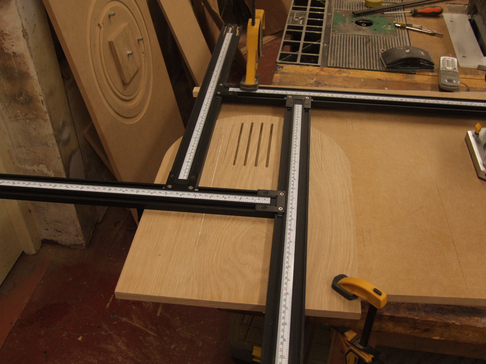

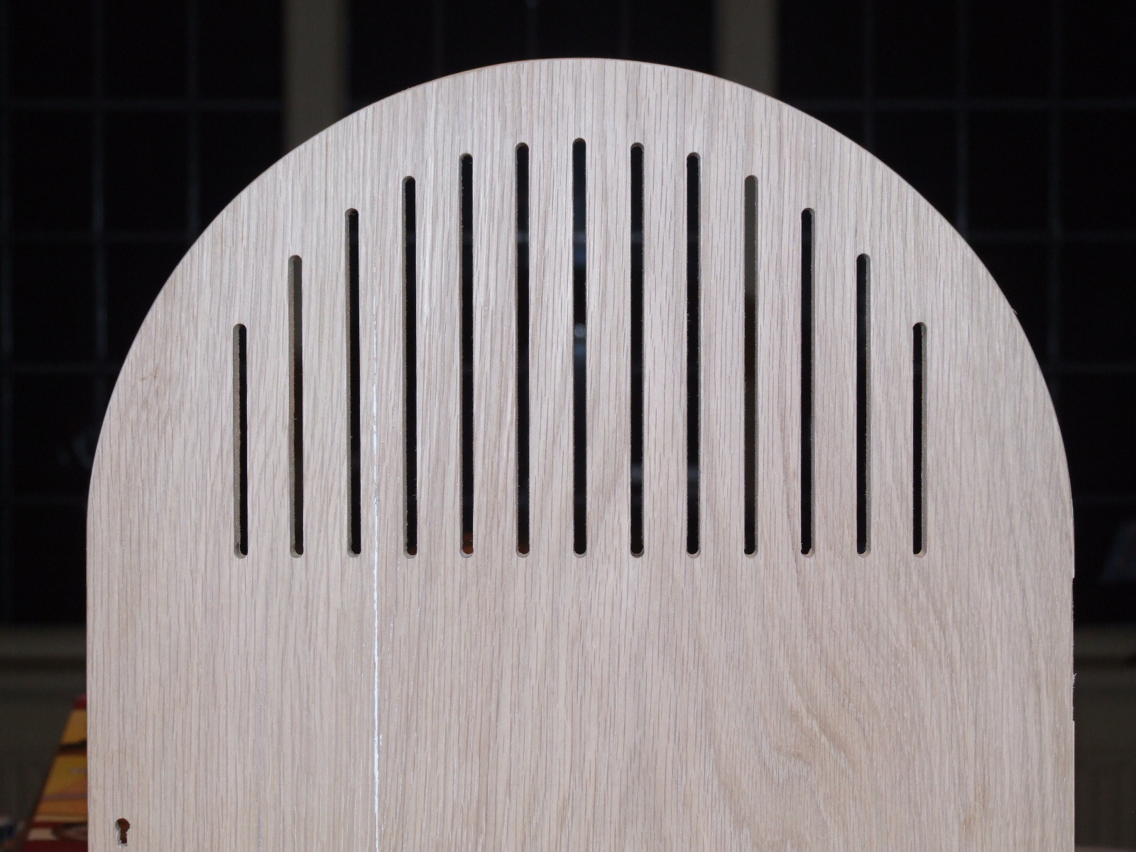

More picture updates...  :cheers:
Pic 1 is showing base in place whilst setting - it would be square without doing this, but by temporarily inserting the base it's guaranteed.
Pic 2 is just a top view (duh)
Pic 3 and 4 show the holes for the sub. The larger hole is for the grill. Basically, the pic with the larger hole on top with the smller hole beneath is where the sub is fixed to, (with the magnet underneath) - then then grill is friction-fit to that
1
Next up is the arched top piece. End of weekend should see this thing really beginning to take shape!

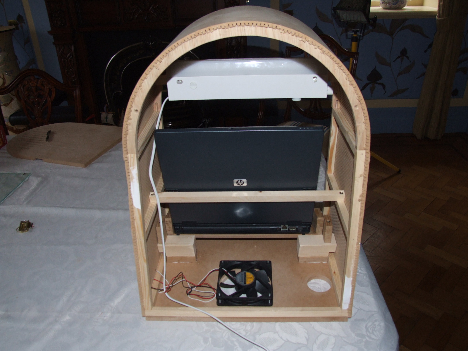

A little progress. We've started to stain the base, which will house the speaker system.
The brass threaded ferrules are for the electronics and the baffle which will separate the woofer part of the base from the mid/tweeter components.

Anyway, we ordered a compass attachment for the router and that arrived yesterday which meant we could start work on the arches. The spindle supplied by the compass manufacturer had about 2mm play in it when attached so we made a new one from a little bit of aluminium and a block of MDF
This was centred onto another slab of MDF so that we could route the arches from the square section of oak (4 pieces, mitred) and deliberately score the MDF beneath with the router. This will help in setting up the router accurately for the inner pieces in the future. It also served as a base for a home made compass which we used to draw out the circles onto the square section:
The we attached the router. We noticed that the router was dipping under its own weight, so stuffed a small piece of MDF underneath to keep it level
And the finished piece:
Afterwards, half the finished circle was clamped to the workbench and the two semicircles separated by snapping the wood at the mitre joins. Went perfectly! And we didn't lose any material due to the width of the bandsaw blade... but
 :angry: Whilst routing the chamfer on the external edge, the router slipped and we're left with a hole on the front, about the size of a 5p piece. We're going to try and patch it (we can match the grain) but ig it looks crap, time to make a new one (or use it for the back arch). Problem with using it for the back is that we rebated already for the glass, so the door won't fit - we'd have to make it fit into the rebate and it would still be proud a couple mm. Anyway, at least we have two options.
More later!

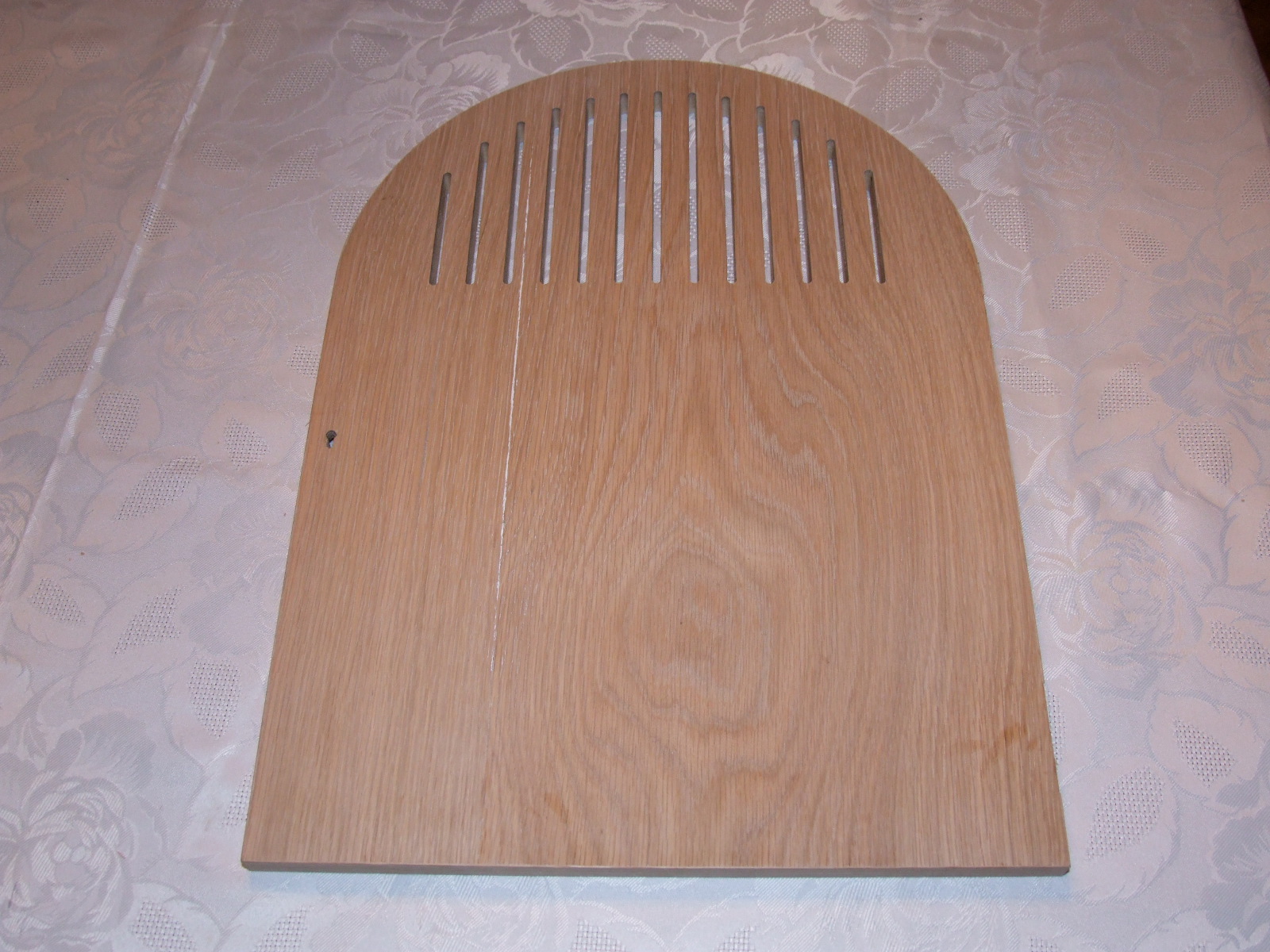

We also started work on the back door, since the arches were complete.
First, we made two strips of oak to attach to the body of the bck door, which is made out of MDF. the reason for this is to give the hinges and lock mech something subtantial to be fit into:
Once this had set, the arch shape was cut out, prior to the routing of the hinges and the lock:
Once the arch was done, a rebate for the lock mechanism was fitted:
Once this was done, the veneer could be applied. It shrinks like a asdfghjj when heat is applied, which is going to cause all kinds of headaches when it comes to the time to veneer the arch sides as we'll have only point contact from the heat source. It's iron on veneer:
the door itself will also be veneered on the edges as when it's open, the MDF sticks out like a sore thumb!
More tomorrow!!  :cheers:

There's a little more progress to post too:
I am becoming increasingly concerned with ventilation, as the trial version of the juke I made got very hot to the point that the laptop I intend to use for the guts would become jittery. It's AMD based and well I know they tend to run hot but this gets very hot.
We decided to route some slots in the back door. I don't know the name for this tool, but basically once set the router fits within the internal space and its north/south travel is restricted to the correct amount by the horizontal rulers. This was after we'd done the first few slots - this took almost a full day as the spacing and length of each slot is absolutely critical to get the look we were after, and it was a one time only deal, obviously:
This picture shows both the finished routing, and you can also see where the veneer shrunk slightly during application. this is quite concerning (the white is filler) but as it's the back door which won't be seen, not the end of the world. We have a new technique for application in mind for the sidewall veneer - more on that to come!
The top line of the routed slots follows a concentric circle on the same centre as the outer shape. Therefore if you measure from the top point of each slot to the tangent of the outer circle, the distance is the same for all slots  -even though it doesn't look like that in the pic!!

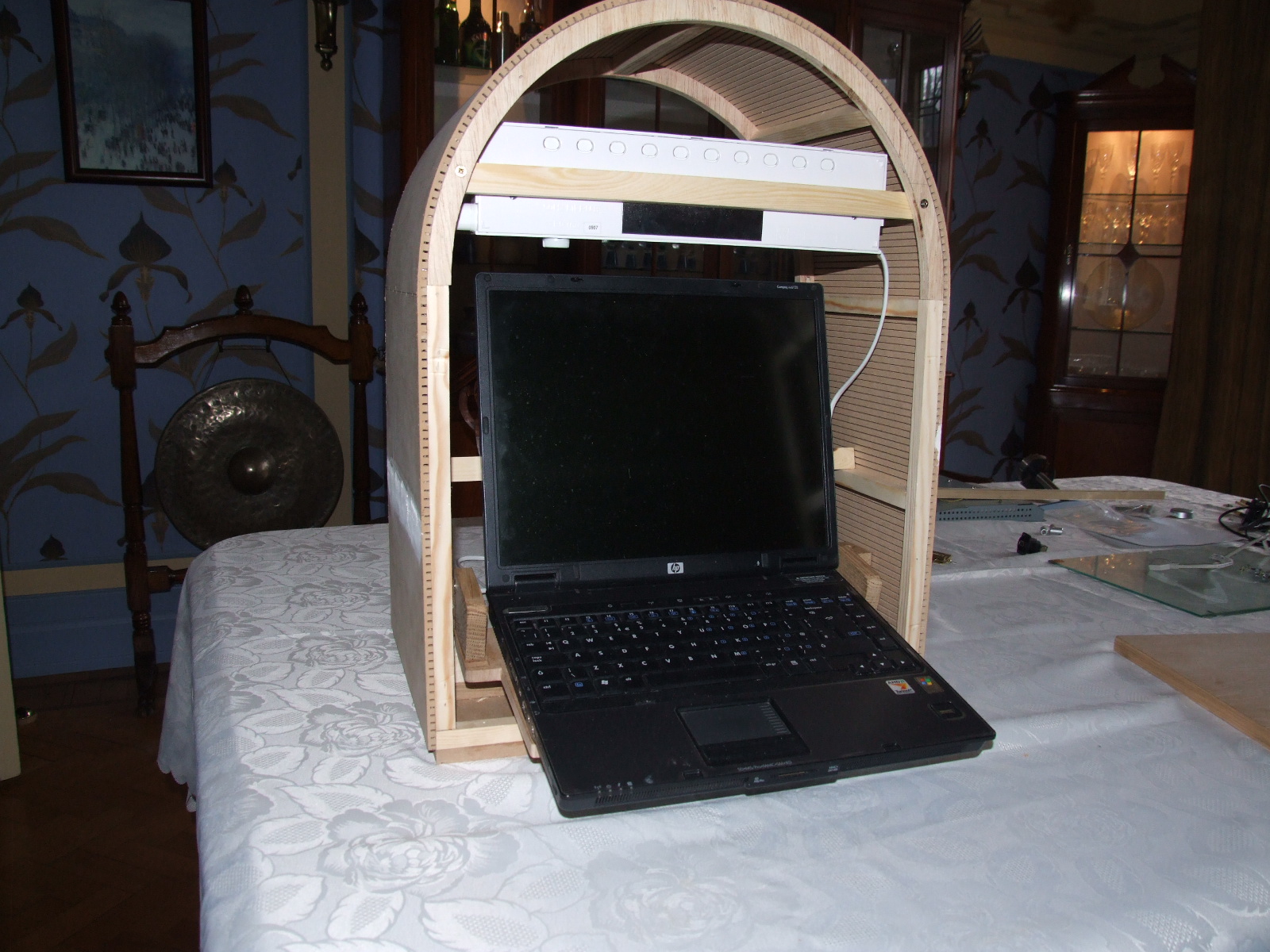

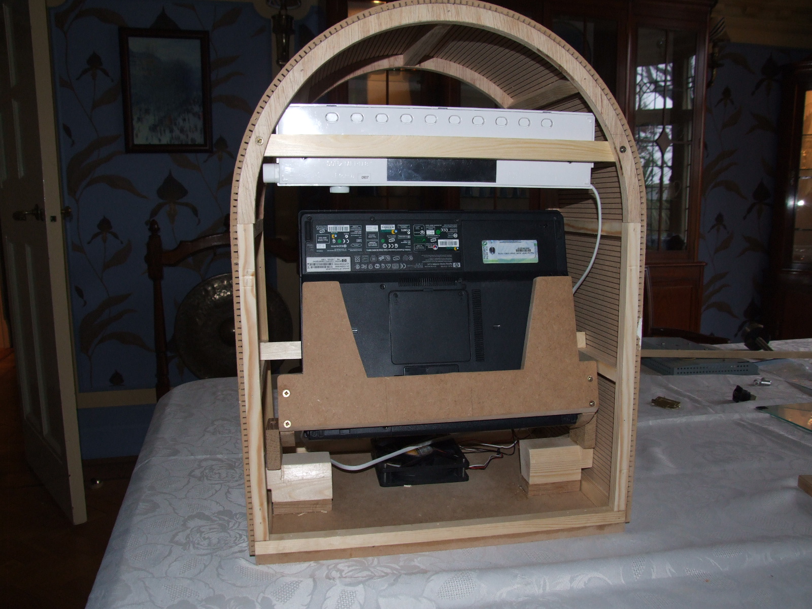

we next started to plan the layout of the laptop and marquee light. We decided that access requirements to the laptop would be few and far between (heh) but we also didn't want to be poking about inside the juke whenever changes were needed.
The first pic shows the front view and you can also see the marquee fluorescent in this pic. I was going to use some really great LED strip for the light, but the one I liked was about £120 per metre... spendy.
This is from the back with the laptop closed. Forgive the Heath-Robinson blocks getting everything to the correct height! If you notice where the laptop hinge is (toward the bottom) you'll see that there are two rounded pieces of MDF. This ensures that the laptop hinges down for acess along the axis of the laptop screen hinge.
The catch that holds the laptop shut is easily accessible, and when you open the laptop the screen stays in place (it's velcroed to the horizontal batten that's visible in the front pic above). The keyboard comes out a comfortable distance for any changes that may be required. Despite the slightly rough look, it works surprisingly well  :cheers:
I should have a few more progress pics later on today. In the pics above, the front bendy MDF edge has only been rough cut - will be flush trimmed later. I said we couldn't flush trim that or the veneer earlier. That was a load of rubbish  :dunno
Cheers for all the feedback!

Re: Just Another Mountain JukeBox Copy ;) Back Door 'n Guts! **14 Nov 08**
« Reply #65 on: November 14, 2008, 07:22:25 pm »
I dont' have any photos because my ghetto juke has never made it past protype stages, but anyways I put a little PC fan at the very top blowing out which of course heat rises so it blows out the hot air and cooler air is sucked in from little notches near the bottom.
I really like your idea putting in little notches for venting. It just has that finished look opposed to just cutting a hole.

The slots fit quite well with the finish we're looking for imho. What we did realise though is that the position we've put the fan means that the laptop will actually get very little cooling. I am thinking the fan should have been towards the top, sucking warm air out, but we are where we are.
So, we made a little aluminium deflector which will fitover the fan, attached to the laptop support pillars. This will hopefully ensure that at least some airflow reaches the laptop but because it's 4" narrower than the width of the internal cab we still get airflow over the touchscreen. We hope. It's not up to Franco's metalworking but it suits the purpose :) I don't have an installed pic - everything is apart as we're staining - but hopefully my budget description and pics before will help...
As I said, we started staining - the back door prior to lacquering. You can see the join between the two pieces of veneer, but as I said earlier, we have a better idea now of how to apply it on the sides of the unit. Touch wood, that'll be perfect:

We made another small misjudgement - with the positioning of the laptop and the sides of the case, it wasn't possible to hinge down the keyboard without the VGA output lead to the touch screen catching. So we decased the original blue plug and using good old electricians tape, wrapped the guts of the plug. This reduced the overall size by just enough to clear the Juke body, which you can just make out in this picture:
Then it was simply a case of installing the rest of the guts. Mainly the marquee light, glass retainers and artwork.
And with the laptop opened:
