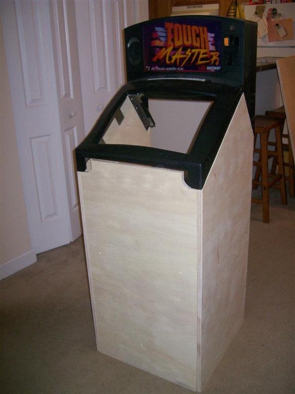

So I have been wanting to upgrade my jukebox that I built a little over 2 years ago. I was trying to decide if I was going to build one from scratch, or convert something. When I found a stand up Midway Touchmaster 7000 with a broken monitor for a very good price - I jumped on it.
I squirreled it away, and I've built quite a few projects waiting to work on this. Well, now's the time. For those of you who don't know what a stand up Midway touchmaster cabinet looks like, here it is:

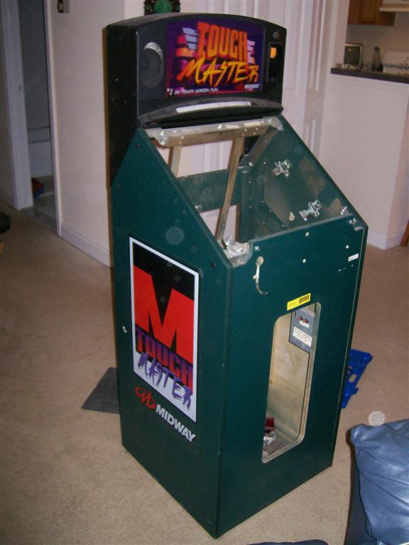

This isn't my cabinet, but I failed to take a picture of it before I stated working on it.
Here is the first pic of my cabinet:
The plan is to drop in a new 19" monitor in the bottom and install a 12" LCD in the top section. I'm going to reuse the bezel and all the metal components. I'm going to cut new wood sides  with 3/4" Sandeply and use black laminate for the finish.

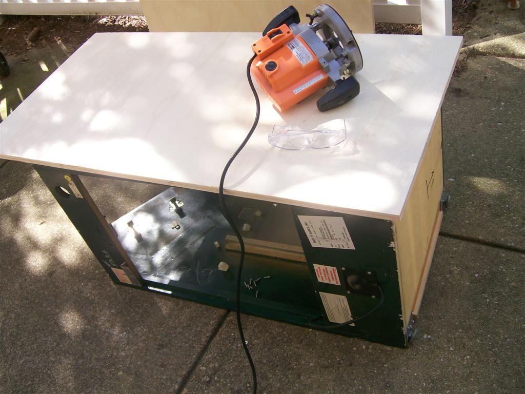

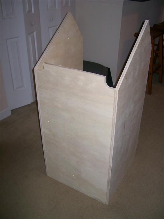

I started on it this weekend and was able to get the wood components cut and started laminating. I used a flush trim bit to cut out new sides.
And here it is put together:
Test fitting the marquee and bezel:
Laminated front:
The cool thing about using this cabinet as a template is all the decision work, such as the height of the screen, angle of the monitor, etc, is already done. I was also able to re-use the touchscreen overlay off the old monitor - which was a good find since those overlay's can be expensive.
I'm going to use Freebox since it rocks.

« Reply #1 on: September 21, 2008, 07:56:14 pm »
Curious, why not just laminate over the existing sides instead of making new ones?
-HarumaN
  • Posts: 7929
  • Last login:January 20, 2026, 06:46:20 pm
Re: LeapinLew: Jukebox 2.0 using Freebox
« Reply #2 on: September 21, 2008, 08:19:26 pm »
I wanted a different middle section. The current section has a big cut out for a coin slot and I wanted the round subwoofer holes. This block is held together with glue, blocks and staples. I haven't really come up with a good non-destructive way to disassemble a cabinet built this way.
Also, I'm building mine 3/4" taller so I can place some neon lights underneath.
IG-88
  • Posts: 2042
  • Posts: 48,764
« Reply #3 on: September 21, 2008, 08:32:56 pm »
Ah...I see. I should've looked closer. Fine job by the way.

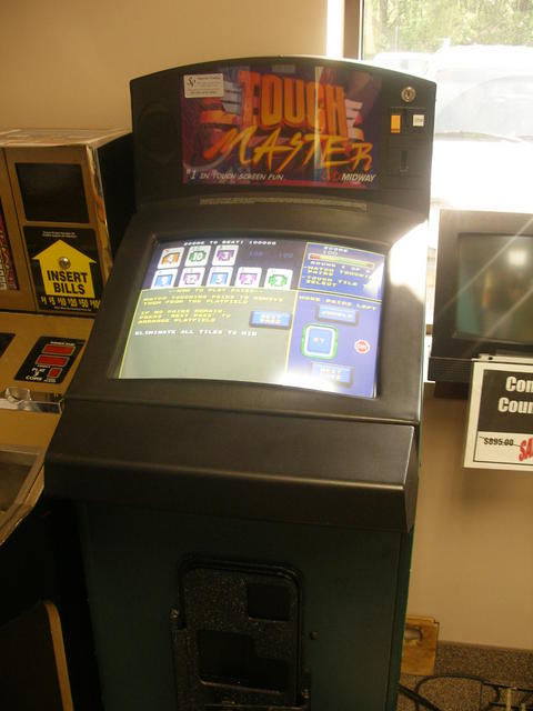

Looks to be another great project, Lew.
But I'm glad you attached that photo.  I thought this was the Touchmaster:

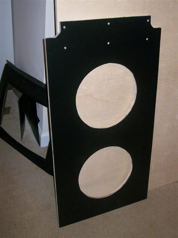

Been slow moving on this one as I had to finish another project. I'm back on the jukebox and made some progress.
Here it is all rebuilt.
In the background, you can see my last jukebox that I'm replacing with this one.
It's built pretty solid. Glued and screwed, baby!
I mounted the T-molding, speaker grills, and test fitted everything:
This is an inside view of the speaker grills.
I'm using these black metal speaker grills on the inside and I have some large chrome ones to mount on the outside. I'm using 12" speaker grills and 10" Neon rings mounted inside the holes.

« Reply #16 on: October 05, 2008, 03:58:33 am »
What speakers are you going to put in?
2 one-foot woofers are not going to give great sound. They only deal with 20-180Hz or so, which is a very small bit of the audio spectrum.
You better put some midranges and tweeters top-left and top-right for some stereo image, and maybe a 1 foot one at the bottom centre as a sub-woofer.
  • Posts: 7929
« Reply #17 on: October 05, 2008, 09:52:56 am »
The subwoofer holes are just for looks. I'm using Logitech Z-2300's.
