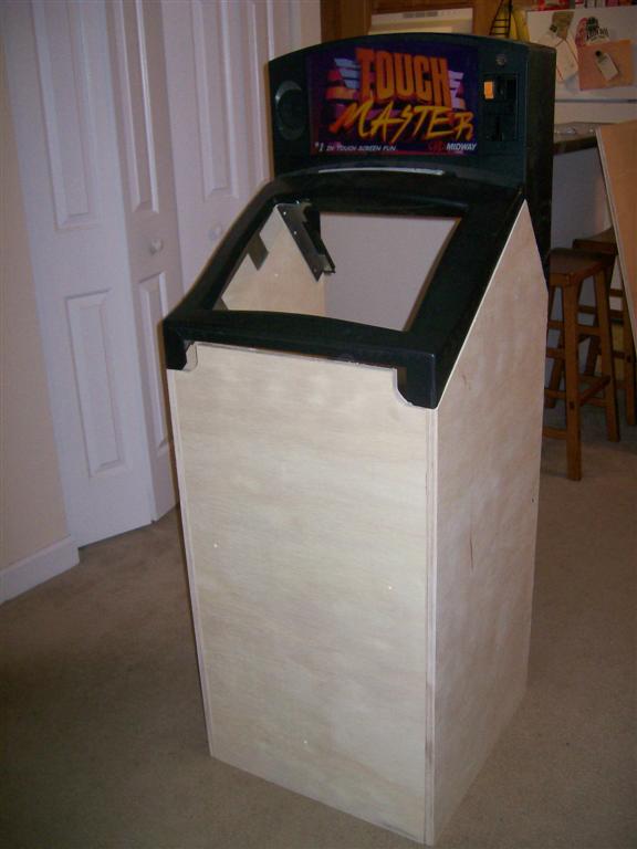

So I have been wanting to upgrade my jukebox that I built a little over 2 years ago. I was trying to decide if I was going to build one from scratch, or convert something. When I found a stand up Midway Touchmaster 7000 with a broken monitor for a very good price - I jumped on it.
I squirreled it away, and I've built quite a few projects waiting to work on this. Well, now's the time. For those of you who don't know what a stand up Midway touchmaster cabinet looks like, here it is:
This isn't my cabinet, but I failed to take a picture of it before I stated working on it.
Here is the first pic of my cabinet:
The plan is to drop in a new 19" monitor in the bottom and install a 12" LCD in the top section. I'm going to reuse the bezel and all the metal components. I'm going to cut new wood sides  with 3/4" Sandeply and use black laminate for the finish.
I started on it this weekend and was able to get the wood components cut and started laminating. I used a flush trim bit to cut out new sides.
And here it is put together:
Test fitting the marquee and bezel:
Laminated front:
The cool thing about using this cabinet as a template is all the decision work, such as the height of the screen, angle of the monitor, etc, is already done. I was also able to re-use the touchscreen overlay off the old monitor - which was a good find since those overlay's can be expensive.
I'm going to use Freebox since it rocks.
Looks to be another great project, Lew.
But I'm glad you attached that photo.  I thought this was the Touchmaster:
