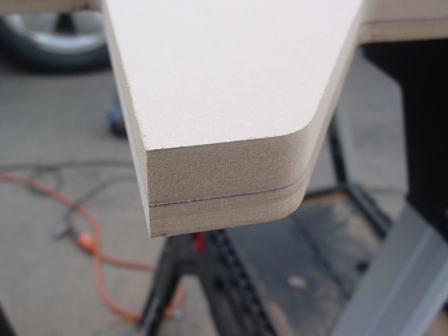

Time for some pictures. Last weekend I purchase the MDF and created a template out of 1/2" material. After it was all smoothed out I traced it onto the 3/4" material.

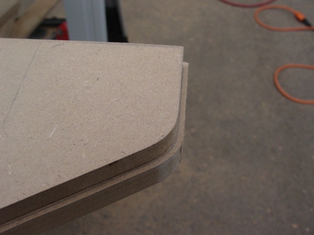

I did a rough cut around the mark and screwed the template to the 3/4" material.
After using the router with my flush cutting bit.

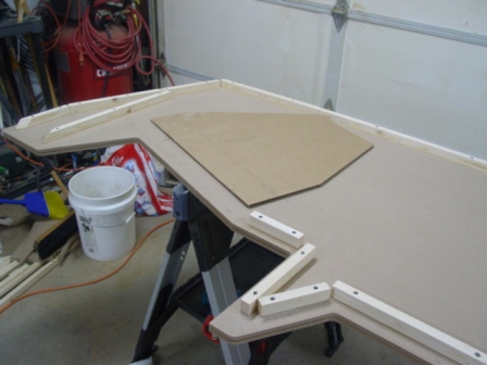

All done with the slats installed.
Another shot showing the cardboard template I made of my monitor.
On my last machine the slats behind the marquee created a shadow on the marquee and drove me nuts everytime I looked at it.
I beveled them to solve that problem.
Nothing quite like the look of a fresh router cut!

I use 3/4" x 1" pine. You will need to measure the distance from the edge of your router base to the edge of the cutting blade. I always do a test run before I committ to cutting the piece.
Draw it all out before hand. I like to used brad nails to secure the wood guides, making sure they are short enough to pull out easily. The tiny holes patch easily enough, so it works for me.
