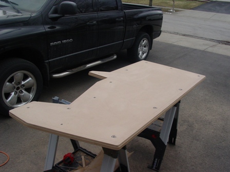

Time for some pictures. Last weekend I purchase the MDF and created a template out of 1/2" material. After it was all smoothed out I traced it onto the 3/4" material.
I did a rough cut around the mark and screwed the template to the 3/4" material.

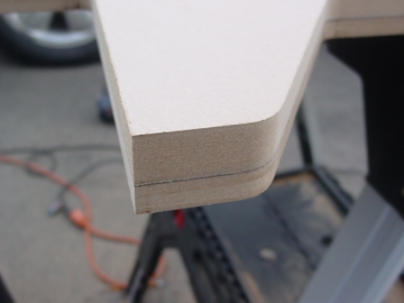

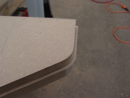

After using the router with my flush cutting bit.

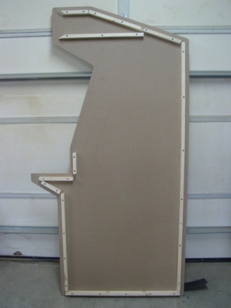

All done with the slats installed.

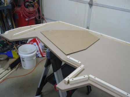

Another shot showing the cardboard template I made of my monitor.

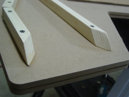

On my last machine the slats behind the marquee created a shadow on the marquee and drove me nuts everytime I looked at it.
I beveled them to solve that problem.
