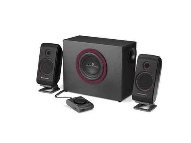

A little disappointing but at least I wont run into technical issues I'm not familiar with.

Thats what I ended up doing J8Son.  I still have the original speaker in the cab because my cab stays hooked up to the arcade cart of Super Street Fighter 2 X most of the time, but I have a set of altec lansing 2.1 speakers I got for like 25 bucks on clearance when CompUsa was liquidating.  Theres plenty of room to mount them in my cabinet as well, Yours might be large enough to keep both.
That's funny you mention that as I had planned to use this set of Altec Lansing 2.1 speakers:
http://www.newegg.com/Product/Product.aspx?Item=N82E16836113016&Tpk=Altec%2bLansing
But, I have heard that people have interface issues when used with a computer monitor. Do you find any interference issues with the arcade monitor?
