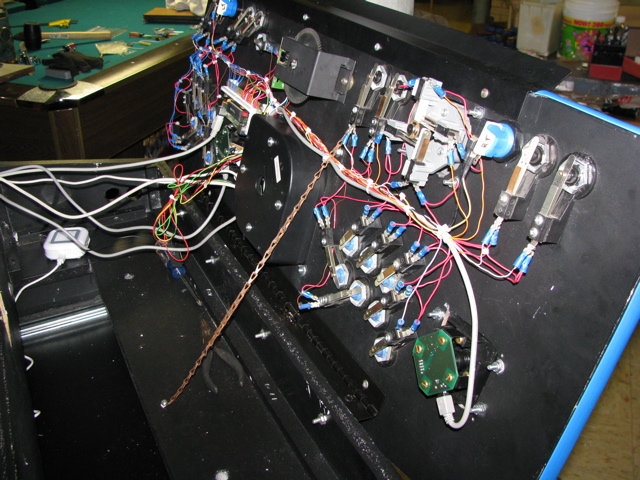

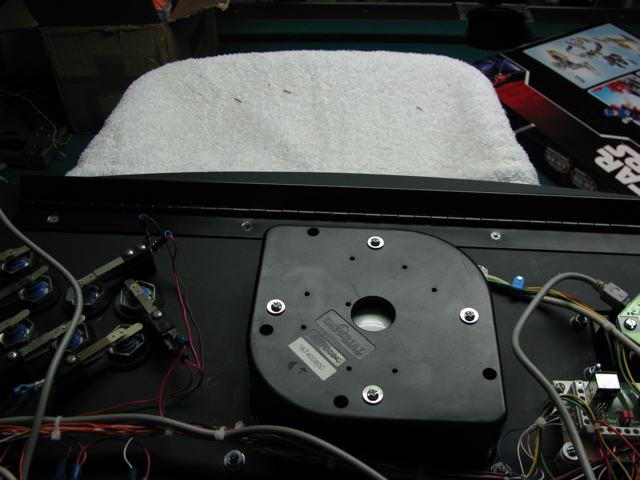

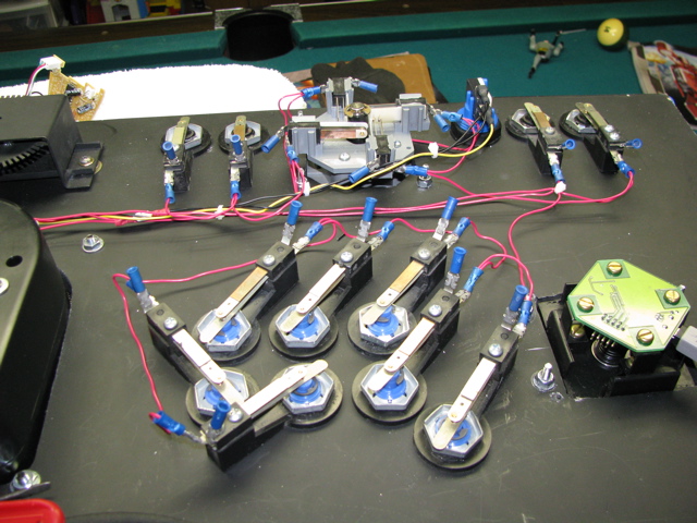

I started to work on my cp last night, I tried to put some up some pic's up, but byoac was down last night.
Anyway here's what I finished
I installed my back panel access door that was damaged and fixed up with bondo from earlier in the thread
Installed all 3 joysticks 2 u360's and a dedicated wico 4 way with NOS grommet, washers, and leafs.
I top mounted everything, all joysticks and hardware are flush and turned out really nice, I'm very satisfied with the way that it worked out. The only thing about a top mounting is the PITA potential if any changes are made.
Installed TB
Installed art and plexi ( I took a black sharpie and ran it around the edge of my artwork just to eliminate the white from where it was cut)
Installed my Oscar vortex spinner,
Started to install my buttons and leaf switches
I feel like a kid, I can't wait to try everything out!
I should have all my innards wired and powered this weekend, hopefully I get to install the monitor as well. Sparky the electrician is coming over to give me a hand on Saturday.
I'll post more pictures later tonight

« Reply #62 on: December 25, 2007, 10:43:22 pm »
keyboard drawer installed
old joytop for handle
I tightened and positioned everything under the cp Next comes the wiring
I am planning on working on the cab as much as I can tomorrow so, I should make good progress.
Getting really close now

Veeeery cool. The joystick balltop is one fancy little detail! Just would like to ask (not criticise), is there a particular reason why you put the hinges of the keyboard drawer front on top of the drawer instead of underneath (so that it would swing below the drawer)?
gatordad
  • Trade Count: (+11)
  • Posts: 828
  • Last login:February 03, 2026, 09:07:22 pm
Re: Mike's Arcade Machine Emulator (Knievel inspired)
« Reply #64 on: December 26, 2007, 10:43:29 pm »
Thanks, I put it on top so when the drawer front folds down it can be used as a wrist rest. I looked at my desk upstairs and copied what it had.

« Reply #68 on: January 01, 2008, 11:10:09 am »
Well there was a Christmas Miracle at my house. The monitor is alive!
It turns out that when I was installing the electronics board for the monitor I knocked one of the components loose from its solder point. I had no idea that it happened, and it was just luck that the loose component was found.
The board made a quick trip to Grandpa's house for a fix-up re solder, after it was re-installed the monitor buzzed the neck glowed and I breathed a sigh of relief.
Here is some updated pic's
I wired the cp and divided everything into 4 ground groups 2 from each side.
I started with by wiring all of the grounds
Then I tried to be as neat as possible with routing the rest of the wires, not as pretty as some I've seen, but not bad for a first attempt.
Just above the trackball you can see the piano hinge that was recycled from the original cab.
After fitting the cp onto the box I did my best chisel job to make a smidge more room for my spinner
Last shot I took of the cp, I installed a chain to prevent the top from opening to far.
