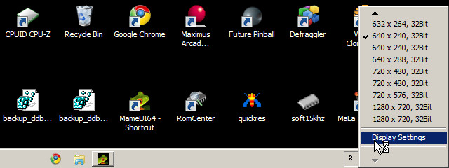

On my final cab PC I'm using Soft15Khz on an HD4350, but I'm have some resolution issues.
My monitor is a WG K7400. I have tested this monitor with Soft15Khz on another PC using some older generation Radeon and worked fine, removing non-working resolutions and adding everything I expected. However on this new system I'm missing 640x480, and have several higher resolutions the monitor cannot support (eg: 1280x720, 720x480). The other low resolution modes like 320x240, 640x288 work fine.
What am I doing wrong? What's the recommended way of remedying this?
Thanks for the awesome tool.
Edit: picture of end of resolution list:
« Last Edit: September 16, 2010, 09:53:40 am by cotmm68030 »
