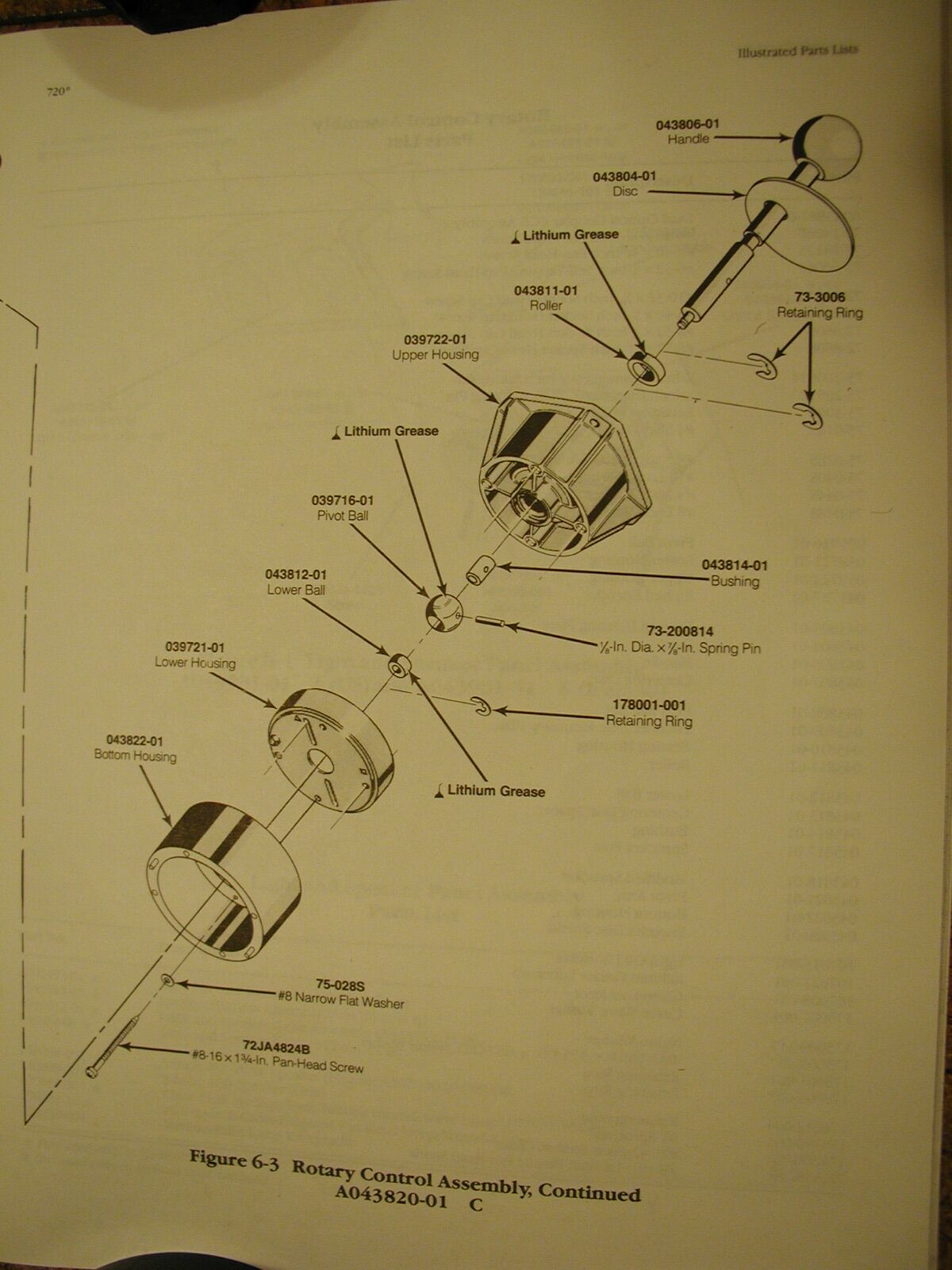

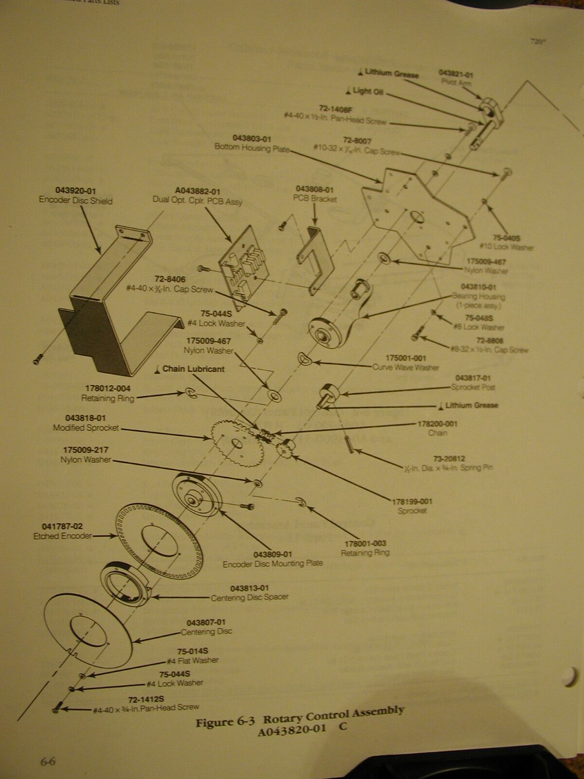

DK,  regarding the 720 controller.  The project is alive, albeit slow-going. I have two minor concerns and one major concern with the project which is holding me up for the time being.
The two minor concerns:
- I'm having trouble locating a source for the chain used in the controller.  This is only a matter of continued searching.
- I don't have the lower mechanical half of a 720 controller to size up for reproducing (encoder wheel, centering disc, centering disc spacer, encoder disc shield and the pcb bracket).  I have a possible source for these components, however.  I just need to take the time to find out if I can get them from this possible source.  If not, I need to either purchase a complete controller or find someone willing to share their spare long enough for me to draw up the parts.
The Major concern:
- I absolutely cannot find the opto devices used in the encoder board.  This means I would have to completely redesign the entire board.  This means that I need a 720 machine to randomly test prototypes on.  Reproducing this part isn't impossible.  Not even close, just going to be a lot of work.  If anyone wants to team up with me on this project to create a new encoder board, I can source the parts and provide the funding for PCB manf. and final assembly.
As for the remainder of the 720 controller, I've got almost all of the components manufactured.  So, yeah, this project is still alive and close to completion.  Just a matter of getting over the above listed hurdles.  No biggie, it just pushes back the completion date.

Okay, I admit I had a little piss an vinegar in me, earlier.  The aforementioned company that does yokes refabs original equipment.  $200 is VERY reasonable.
720: I'm curious to see how it was connected inside an all; anyone know of an pictures of this?  Still, a crank - similar to a hand-cranked drill - would be optimal.  I don't know why they came up with that funky tilted stick, cos it's weird on the wrist.
Wait.  After .69, Mame doesn't recognise an optical device properly; it flips one way or the other, instantly, and stops; it has to be an AD stick, or mapped accordingly for digital sticks.  There was something nagging at me at first mention of this control in the thread.

« Reply #26 on: January 09, 2007, 01:09:36 am »
That's awesome news on the 720.  If it's possible, you might make the pivot balls, especially the upper one, the first part you produce on that.  I believe the upper ball is used on most (all?) other Atari logo-top joys, including Gauntlet, Xybots (twist-to-turn), and the Road Runner and I, Robot Hall-Effect sticks.
They also are made of a soft nylon compound, and they wear out.  Most Atari logo-top joys out there play like crap these cays, because they are desperately in need of new pivot balls.  Last time I saw NOS Ataro logo-tops on ebay, they went for serious bank, and the premium price was because of this.  You could probably sell quite a few of those, and help restore a lot of Atari games in the process.
If you haven't got a line on an NOS pivot ball already, I have ONE.  Holler if you want to borrow it for casting.

« Reply #28 on: January 09, 2007, 01:30:47 pm »
I totally agree.  Seems to me the pivot ball was designed to wear down (vs the black joystick case wearing down).  With all five of my atari sticks I have that use it (shifter (hi/low), cyberball (2, 8way), roadrunner (hall effect), 720), I have exactly one pivot ball not in bad shape.  It's still NOS, actually, since I don't want it used until I have more backups.  :angel:  Until now, it's been :banghead:
To paraphrase kemmit, "If [you need] I have ONE [NOS pivot ball].  Holler if you want to borrow it for casting."   (If you need any other parts except for a working 720 sensor board :cry:, I can help, too.)
Another issue caused by all the worn pivot balls is the shape of the joystick cases out there.  If the pivot ball gets badly worn (rough), the case also wears down.  Especially after the ball get so worn the metal pin holding the ball sticks out. :o  Two of my five joystick case tops are like this, and I'll need to replace them when I replace the pivot balls, or I won't be able to tell that there's a new ball in there.  Luckily, the case top part is also common between all these joysticks, so if you make a few extras of this part too, you might find a nice niche market for them (although not nearly as big as the pivot ball).
Good luck!

Maxim, thanks for the pic of the SPO joystick.  I can tell from that pic alone that the repro would not only be possible, but it would also be very easy to do.  It would super easy to release as a retrofit kit, as well.
As for the 720 controller, I'm going to run off a few hundred spares of both the pivot ball and the upper/lower housings.  These parts (well, the upper housing and pivot ball anyway) are used across many different joystick types that Atari made, so I planned on stocking up not only to sell as individual parts but to also supply the additional reproduction projects I've got brewing.  Additionally, I plan to run off spare lower balls, pivot arms, encoder discs and centering discs.  Once I'm done with a few more of these projects, there won't be a lack of parts available any longer.
I'm probably going to go with delrin for the pivot ball, as opposed to nylon 6/12.  I believe the wear properties of delrin exceed those of nylon in a situation like this.  The only concern I have is that the delrin may be too hard which could potentially cause some binding.  Then again, my first impression is that this would be a definite upgrade to the original.  I'll think it over some more before I make my final decision on the subject.  Either way, I *need* a NOS pivot ball as well as NOS upper/lower housing components before I can move any further on those parts.  Speaking of which, I'm tossing around the idea of reproducing the upper and lower housing components out of aluminum and then hard black anodizing them.  I know this will bring up production cost somewhat, but the parts sure would look sweet!  Not to mention the obvious durability gains.  Any comments on the subject?
Unless I hear otherwise sometime soon, I'm going to take you guys up on the NOS parts as well as the complete (or mostly complete) 720 controller.  I'll reciprocate by handing over a few spare repro parts in return.

Ok, I've had some more time to go over the 720 controller today while I've got SW parts taking up the machine time.
I was just thinking about the optical board and realized that I could use two or three *dead* boards for my purposes.  One to strip clean to create new negatives, one for parts placement and a third for backup.  If anyone has one or more dead 720 optical boards they'd like to hand over, I would be willing to send a working replacement as soon as I get them fabricated.  However, it could take days, weeks or months (read: no completion date set yet) before I send out the repro optical boards.
Also, I'm ready to accept a whole controller (to use as a build model) and any NOS components that can be spared due to the fact that my samples are either missing or too worn.  I'll return any parts that are loaned to me.  I'll swap out a brand new repro unit if I can *keep* a complete NOS or near-NOS unit in return.
Lastly, does anyone have a whole 720 machine (local to Huntington Beach, CA) that they'd like to sell to me?  While I'm sure I'll get this right the first time, I would prefer having a machine to fully test form, fit and function before releasing anything.  I'd like to get a nice minty machine, but anything will do as long as it's functional.
That's about it for the 720 controller for right now.  Contact me directly on Arcade controls or at the email address listed in my profile.

Heads up.
The optical devices (used on the 720 dual optical coupler board) arrived this morning via FedEx Priority Sat. Delivery.  I grabbed up enough to supply the 720 project for many years.  I've done some initial testing and determined that the parts conform with regard to form and fit.  I'm going to spot check the parts on Monday in my test rig to ensure that they function as expected.  I've already sent the PCB's off to fab, so they'll be in my hands in a week or two.  I figure that if all goes as planned, I'll be able to make the optical boards individually available before the remainder of the controller.  So, if you've been looking for a replacement dual optical coupler board for 720, the wait is almost over.
