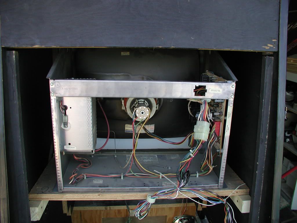

Anyway, it is hacked into what looks like a megatouch gambling cabinet.  The wiring manual inside says Cocktail Asteroids.  Is this the cocktail version????  I hope so.  I'd rather put it in a cocktial.  I will have to research this some more.
The wiring is hacked.  There's electrical tape all over the wiring.  I did find were the test switch and volume control is located.
If this is the cocktail version I will put it in a cocktial cabinet, which means I could rewire :)
I'm uploading a few pics right now, uneditted, IE not rotated.

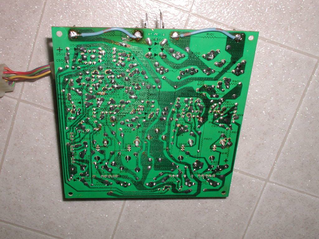

I uploaded the pcb and numbers on the pcb.  See the finger board in the bottom left of the pcb, I wonder what that is for...
Paladin
  • Posts: 541
  • Mmmm llamaburgers!
Re: my asteroids
« Reply #3 on: June 18, 2005, 03:33:20 pm »
I believe the 'fingerboard' is for attaching a harness to a device that is used to test the PCB.

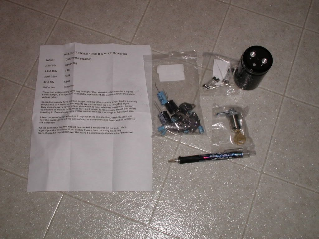

Whether that be the case or not I think I will get a cap/tansistor kit and a new big blue.  To be on the safe side.  And slo blo fuses...  Bob carries all of that I believe.
  • Posts: 38204
Re: my asteroids
« Reply #23 on: June 20, 2005, 10:46:43 am »
He does carry all of that, may as well save shipping and do it all.  It's all worthy work, anyway, and just standard refurb stuff to make your machine reliable again.

To me it looks like all the gambling (megatouch) machine cabinets in that small town (where my uncle lives).  Which is what I suspect happened.  I should ask him how he got the cabinet.  My bet is he wnated an asteroids, talked to someone local who had a working board, put it in the first available cabinet, tada.  The red button on the bottom is coin.

Anyway, I found a pic of Big Blue on Bob's site.  So do I have to take the psu casing off then?  Or is it open underneith, I just need to unscrew it form the bottom of the cabinet to get at the nuts for big blue?
RayB
  • I'm not wearing pants! HA!
  • Posts: 11279
  • There's my post
    • RayB.com
Re: my asteroids
« Reply #30 on: June 20, 2005, 12:13:48 pm »
Unscrew the PS unit from the bottom, and then you'll see underneath it's all open. You'll have access to screws that hold the big blue in.

Here's a pic of it in my second bedroom, which is the computer room for my apartment.
http://photobucket.com/albums/v472/SirPoonga/asteroids/?action=view&current=room1.jpg
I'm not going to be suprised with anything that is wrong with this, but it's not going to be because of what I did...unless I solder something wrong.

Got my rebuild kit.
Big blue is now going to become big black!
  • Posts: 38204
Re: my asteroids
« Reply #67 on: July 15, 2005, 09:29:28 pm »
Awesome.  Swap out that old filter cap, don't even test it.  Just take the old one and chuck it in the trash.  Once that is in place, test the power supply outputs under load.  It shouldn't be hard to find on the net what the proper values should be.  The testing will probably be best done on the AR board, not necessarily the power supply itself, though test the inputs to the AR board as well.  If you get acceptable voltages out of the AR under load, you're good to look at the PCB and test from the test points there (+5v, +12v, X, Y, and Z outputs I think).  If the AR doesn't check out, order an AR rebuild kit and do that.  An AR rebuild kit literally is a 15 minute job.

For your enjoyment
http://img.photobucket.com/albums/v472/SirPoonga/asteroids/parts.jpg
Heh I see you got a pen from Bob Roberts also. He sent one with my last order. I think of it as my official pen for any tech work I do. It's like a lucky pen ;)

yeah, I'm going ot be discharging.  But I want to know if I need this circuit still plugged in.  It currently is completely unplugged.  There are 4 connectors on it.  1 for two of the transistors, 1 for the other two, (look at linked pics) that big red one that goes to the HV circuit, and that one hangin between the tube and circuit.
http://img.photobucket.com/albums/v472/SirPoonga/asteroids/chassis.jpg
Look at this pic, it's on the right
http://img.photobucket.com/albums/v472/SirPoonga/asteroids/monitorback.jpg

Re: my asteroids
« Reply #113 on: July 25, 2005, 04:00:01 pm »
Yep, sure looks like that top center part is db100.  Didn't know they came as one integrated part on this monitor.  If you look at the schematic you linked to you can see the 4 diode diamond pattern I have been describing.
Yep, I know a rectifier is 4 diodes.  It turns AC into DC by making the AC current flow one way.
Yeah, I've been digging, can't find what it is suppose to be.  When I get home tonight I am going to take the heat sink off and see if there are markings.  Otherwise I will pick up something that can handle upto 50V to make sure the diodes work???
Bob Robert's website is down too so I can't search his inventory of diodes and rectifiers.
Actually, if you look at the back of the board it has the diamond pattern.
I tested the rectifier while on board, though someone told me I needed to test it offboard.
I tried both continuity and diode tester on my multimeter.  Right, if a diode is working the continuity tester will only work one way, IE if you switch the probes around one way will detect a circuit and the other way won't since diode is one direction control?
http://img.photobucket.com/albums/v472/SirPoonga/asteroids/deflector_board_back.jpg
Doing the two tests all the diodes except the top one read .3 on the diode tester and continuity tester only worked one way.  The top diode continuity worked both ways AND diode tester was 0 for each way.  I would say I have a bad rectifier.
« Last Edit: July 25, 2005, 04:08:14 pm by SirPoonga »

« Reply #114 on: July 25, 2005, 04:08:14 pm »
http://www.vectorlist.org/Vectorlist/2001/04/0066.html
This would seem to say that one of those four diodes is shorted, and everything else I have read says that they can be tested individually, so there has to be a way.

« Reply #117 on: July 25, 2005, 04:17:07 pm »
I see multiple references in RGVAC and Vectorlist that people use as a replacement for the rectifier a 8A 200V unit, and I've seen mention that the actual part was 3A 120V but the high failure rate makes replacing it with a higher capacity rectifier a worthy mod.
Are you sure you aren;t talking about the HV rectifier?  The deflector board only getsneeds to keep 34V from backtracking, while the HV circuit protects 90V
The junction drop (resistance) on a diode is 0.7, not 0.3, so I'd say you are correct.  All four diodes are suspect, one certainly dead and three just about to die.  Replace all four.
SirPoonga
  • Puck'em Up
  • Posts: 8185
  • The Bears Still Suck!
Re: my asteroids
« Reply #120 on: July 25, 2005, 04:22:45 pm »
Could be, obviously double check everything I suggest.
I just did.  Looked at the schematic on page 19 and 20 for the manual.  Only rectifier I see is that one.  Are people alling it the HV rectifier because power from ther eeventually goes to the HV circuit to get changed into 90V.  Actually, the 38V from the rectifier goes directly to the HV circuit.   Hmmm.  Maybe that IS the HV rectifier.
Which would make sense on why the fuses blow if what you said is correct "8A 200V unit, and I've seen mention that the actual part was 3A 120V".   It would fail because more than 3A would come back and blow the diode, cause a feedback through the rectifier matrix, then blow the fuse after going back through the failed bridge.
« Last Edit: July 25, 2005, 04:27:32 pm by SirPoonga »
  • Posts: 38204
Re: my asteroids
« Reply #121 on: July 25, 2005, 04:51:14 pm »
Actually, the rectifier doesn't control how much current goes through it, it just rectifies it from AC to DC.
SirPoonga
  • Puck'em Up
  • Posts: 8185
Re: my asteroids
« Reply #122 on: July 25, 2005, 05:00:52 pm »
I read through the B&W vector monitor faq more thoroughly. (Before I only read about the discharging part, not troubleshooting).
"R100 and R101 serve to limit inrush current to the filters and offer some protection to
DB100 in case of a fault condition"
Sounds like a GOOD idea :)
Page 34:
DB100 | 8A 200V SI Bridge Rectifier | Diode bridge (NTE5313)
Woohoo!
And I tested everything according to how that FAQ says to test.  So it's the rectifier causing the problem.  Now only if Bob Robert's site wasn't timing out...
Right, but the values of a diode indicate at which point it will fail to limit the direction of flow.
I could be wrong, but I don't think upgrading the rectifier would cause the fuse to blow.
Right, I didn't say that :)  I say if the current exceeded 3A the diodes in the rectifier could go bad, hence causing the problem.
I am 100% convinced it is the rectifier.
Though the guides say test for a short on C100 and C101.  Does that mean put a continuity tester to them and see if there is continuity?  Because something had to cause the rectifier to fail...

Well, since I bought the cap kit I will replace al least what is on the deflector board.
I also have the transistors.  Now, I realized I used CPU heat sink compound for the transistors.  Not any CPU heat sink compound, but the good stuff with silver in it.  That might be conductive, I will test.  If so that wouldn't be a good thing for this application.  Might have to go buy the cheap stuff.
Check out appendix B.  Man, most of my questions are answered if I READ the whole thing.  i feel like a newbie now :'(

I ordered replacement resistors for R100 and R101.  Bob Roberts said he's heard of people taking them off (IE not replacing them) but probably better if they were there.
Also getting the rectifier of course and more fuses as I only have 3 left.  If for some reason this doesn't work I won't have enough fuses :)

Ok, so it's been awhile since I looked at this.  Things came up and I forgot all about it for awhile.  I finally got around to discharging the monitor.  I replaced the diode.  My cousin helped me, he fixes equipment for a hospital so he has more experience in electronics than I do.  He's discharged several monitors there.
Anyway, the socket for the diode was horrible.  Corroded, full of sticky crap, burn marks, bad condition.  My cousin suggested we just solder the diode to the wires directly.  We did, went to plug it in, electrical arc between the diode and cage.  Didn't think that the socket was also an insulator.  So now I have to find something that makes a good insulator.
Goo thing is the arc went to the cage (ground) instead of to componants on the circuit.  So I think everything should be alright.

AR = Audio Regulator board, the smaller PCB with the large heatsink
Whould would be this board 9since it says audio on it?  some of those wires are going directly to the monitor?  What does video have to do with audio?
http://smg.photobucket.com/albums/v472/SirPoonga/asteroids/?action=view&current=videoboard.jpg
But you did re-insulate that HV diode and still get the "static" effect when the monitor turns on right?
i'll have to watch the red led again.  however, when the low noise is produces the yellow light comes on.  It the light to the left of the large CAP  at the top right of this pic.  It's the top light of the two next to it.
http://smg.photobucket.com/albums/v472/SirPoonga/asteroids/?action=view&current=chassis.jpg
I forgot to mention, when I did the cap kit I also changed the tin can transistors and the bridge rectifier (which was the real problem).  I also added in the two large ceramic resistors (R100 and R101) that are missing in that picture but are in the schematic.

Yes....that is the A(slash)R board that I'mtalking about.
It acts not only as an regulated audioamplifier but also as a regulated power source.
Two jobs..... one PCB.
The yellow light (small neon lamp) indidcates a voltage spike. It is there to "clamp" or shut-down the spike back to the voltage it should be. But if there is a problem like in your case the voltage will just continue to go up and down.
If you look at your pic showing the "missing" resistors R100 and R101 you can tell on the far right post where there is a nub left from the old resistor. The resistor leads were soldered down through those posts. (if you didn't already guess)
There was a field mod put out about removing these and replacing them with jumper wires. You need to look on the bottom of your deflection PCB and see if this was done. IF so, then your new resistors aren't actually doing anything.
yeah, I took the jumpers off :)

Hmmm, wonder if I should take those resistors back out then...
I put them in because I saw them in the schematic and the spots ont he board.  The jumpers were poorly soldered so it was an obvious conversion.  I figured it wa sa quick hack to save money or something.  I saw the resistors when right to the bridge which was bad.  I figured the resistors protect the bridge and that is why the bridge failed.
