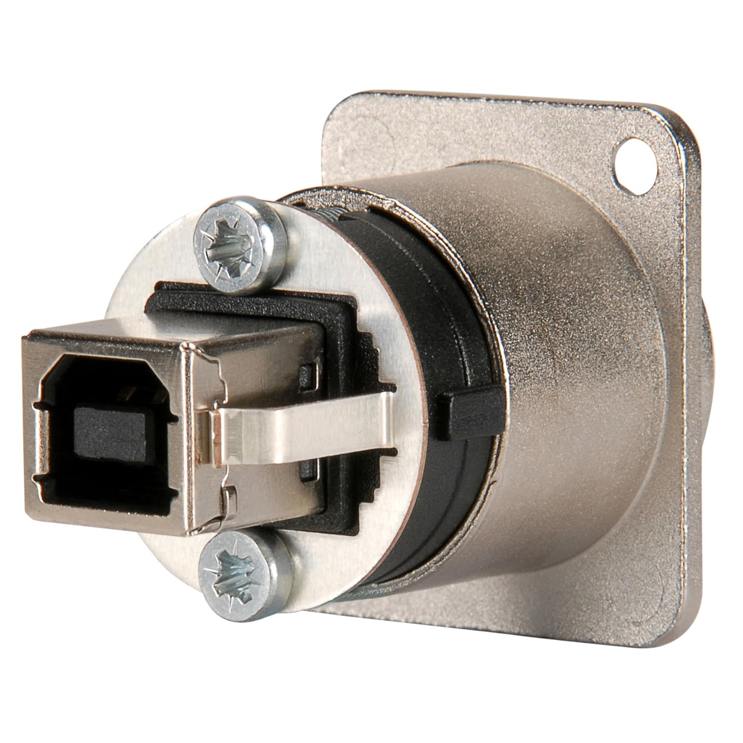

I know players 3 and 4 would only be on occasion, so I want those players to be removable. I know I saw a picture of someone who built a design like that. Can anyone point me in the right direction?
Not sure where to find the photos you're referring to, but Marsupial brought up the idea of using another pedestal (or two?) for P3/P4 in this thread.  Neutrik feedthrus are your friend.
You make the 2nd pedestal like a separate joystick, with its own controller boars, and connect it to a USB port on the first pedestal.
You might want to consider using Neutrik NAUSB-W-B (black) or NAUSB-W (nickel) USB feedthrus if you want to use removable, commonly-available USB A-B cables.
- Pull two screws (2nd photo) and you can reverse the center barrel so the "B" side is on the outside of the 2nd pedestal's enclosure. (3rd photo)
- The second pedestal's USB encoder board plugs into the "A" side of the feedthru on the inside of the 2nd pedestal's enclosure.
If you find a 2P pedestal design that you like, your father-in-law can build either a second identical copy for P3 and P4 or two narrower versions that have the same side profile as the main P1/P2 pedestal.
Either way, the P3/P4 pedestal(s) would have the controls and an encoder that plugs into the main pedestal via USB.

- More electronics (2 encoders, 2 feedthrus, etc.), wood (4 side panels), and work to make two smaller pedestals vs. one larger one.
