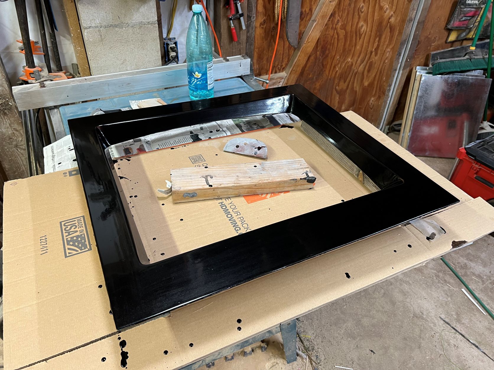

Here is the panel that I made to play Missile Command, Centipede, Marble Madness (2 player even) Crystal Castles, golf games, etc.
This was for the Star Wars cabinet mind you so it has a rather spacey feel of course.

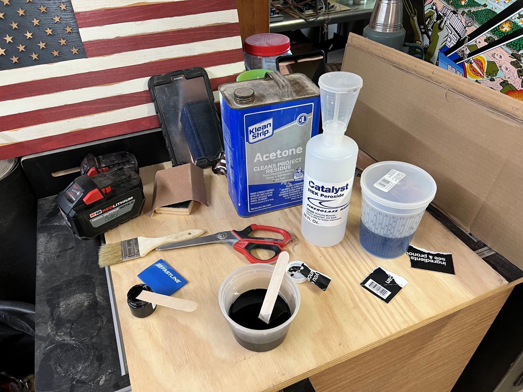

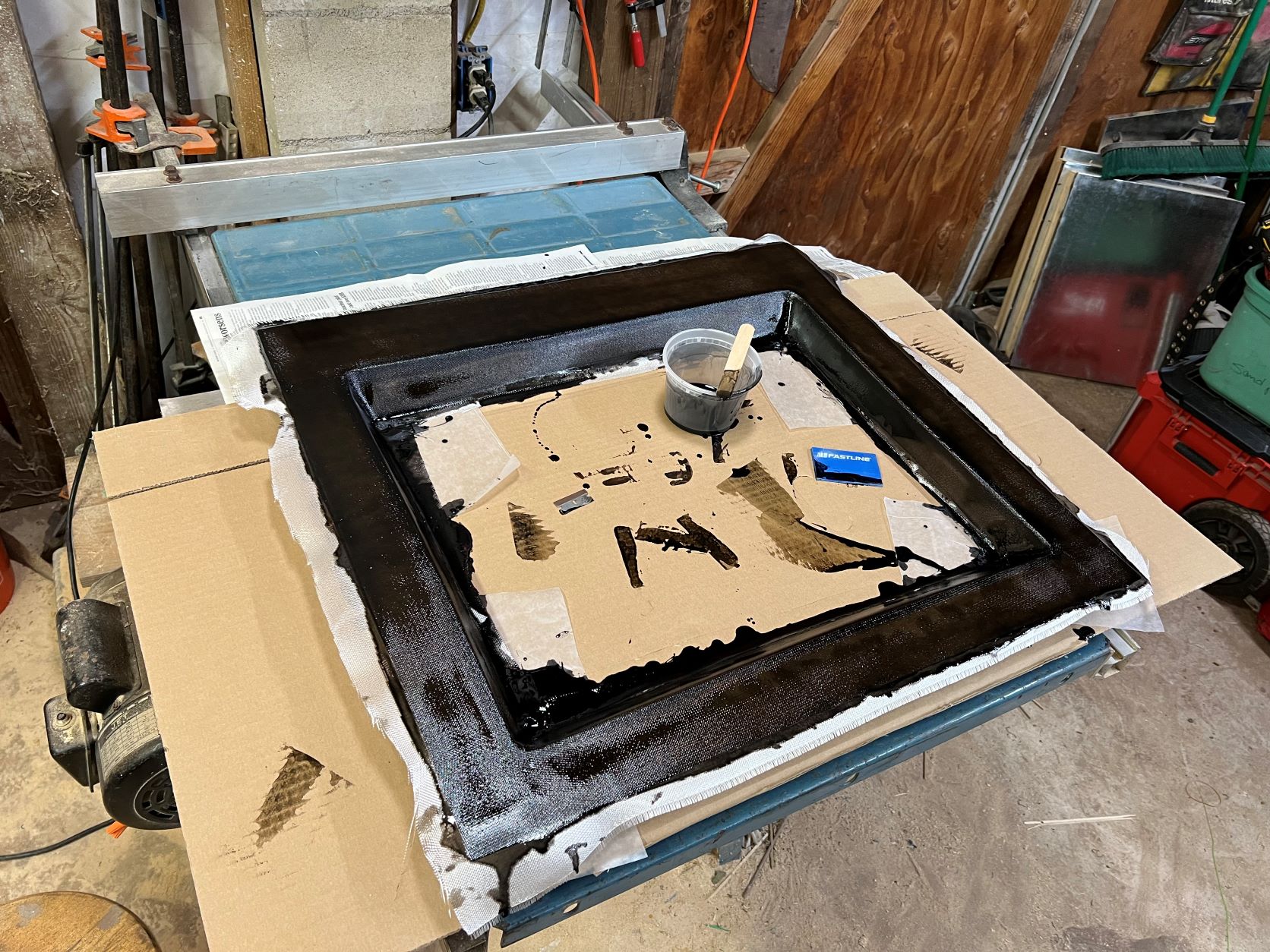

I was experimenting with polyester resin and pigments to see what kind of effects I could get without a lot of drama.
There is bunch of depth added to it by laying down the colors in different layers and putting clear coats in between.
I didn't sand it super flat so the finish has a little wobble to it on purpose just to keep the light moving around on the gloss coat too.
It is also 28" wide and I can trim the angled part off with the table saw and then round over the front edge and blend in new resin to coat the wood I exposed.
Plus it means I can be up and playing a few games pretty quickly!

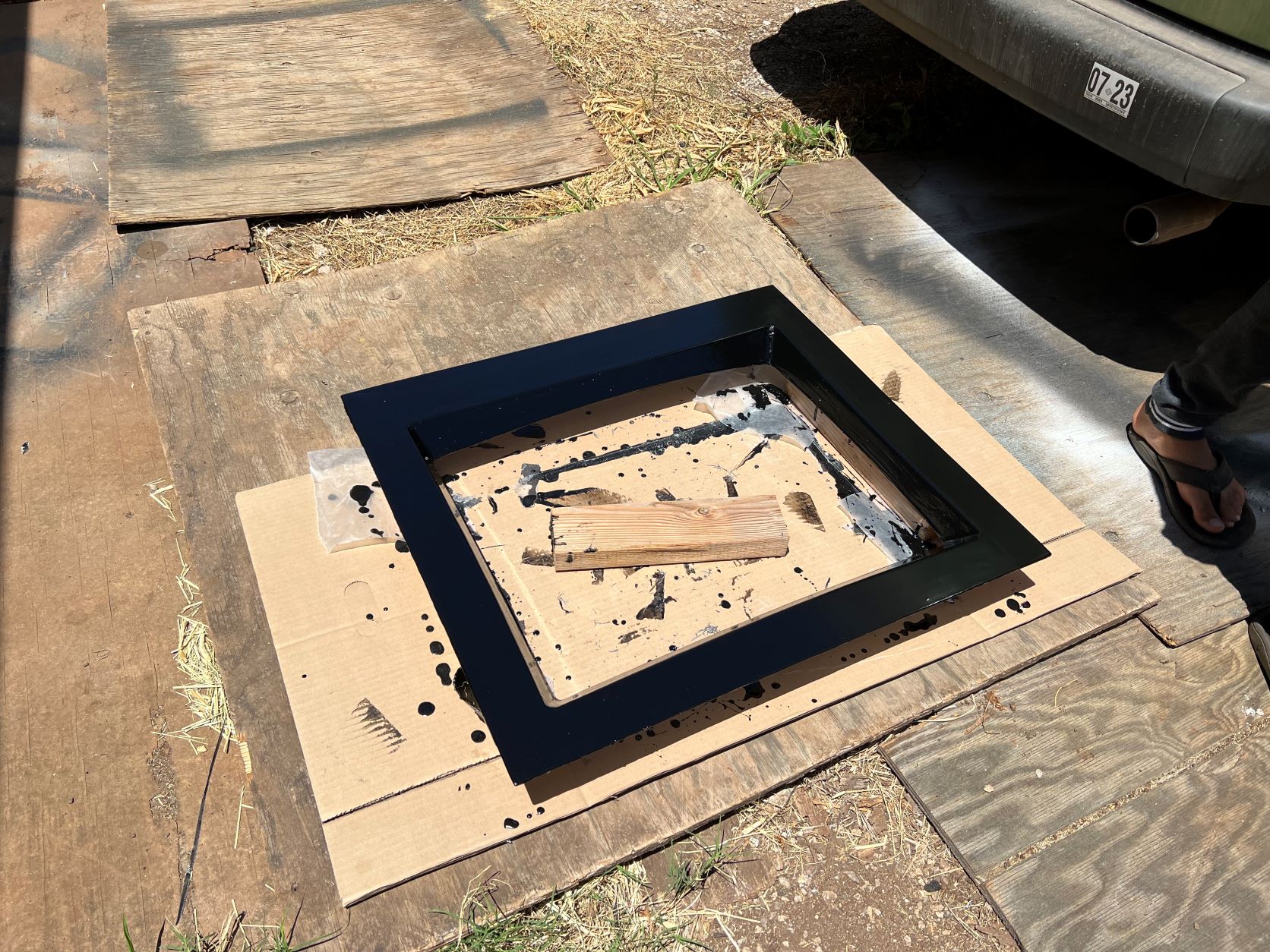

Stole some day-time to get spraying to allow for some dry time.
Looks better already even with just white.
I need to go for a materials run halfway across the island so maybe it will be dry enough to mask and spray the black interior stuff this evening.

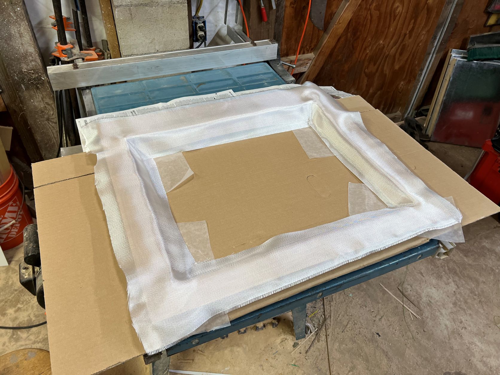

And therefore like all meaningful crap in my life, it must be fiberglassed.
Conveniently, I have another 75 ft or so of 4oz cloth on my glass rack- so trimming a 30" piece is easy.
Cutting that to be a useful shape to accomodate the compound curves of this bezel monstrosity is not so bad for me at this point.
The last time I made one of these I actually used a factory built one as a mold to do this (and it was a huge pain in the ass) so this time I figured I would form my own foundation and go from there.
It is proving to be a hell of a lot easier than the previous path.
This is the paradigm going forward for sure.
Standard lamination activity at this point.
Polyester resin
Black pigment in this case
MEK as our lovely toxic polymerization oxidizing agent
Acetone for the mess I will inevitably make
Squeegee
Mix it hot (like a 2% ratio) and let it rip.
It has been hot, humid and disgusting here for a few days (by our standards) so nothing makes the joyous exothermic reaction of resin going off happen quicker.
I figured that the hard angle sweep of part of the bezel would make for not perfect flatness with my cloth- so that I would need to add a step and put on an un-hardened hot coat of resin before I layed down the final layer.
For anyone who may for some reason give a ---steaming pile of meadow muffin---, when you are playing with polyester resins, if you want the stuff to be easy to continue to add layers to without having to sand it first (and thereby physically opening up the ends of those styrene monomer chains for further resin bonding) you use pure resin- that is, something that doesn't have surfacing agent- i.e. wax- added to it.
I did that here because I wanted to get a nice flat layer on my last (3rd) pour of resin so that I only needed to polish it.
That layed pretty flat but still needed some sanding work (as expected) so I gave it a rub with 120 grit to get it to shape and blew the dust off to add another layer of resin.
I used to think that you needed to give any substrate a wipe/wash with acetone to make sure it was contaminant free for subsequent layers- but this actually creates problems.
Blow off any sanding dust or other crap and press on.
For your final coat of resin you WANT to add wax (which isolates the reaction from atmosphere- and closes the ends of those polyester chains) so that your work can be sanded without gumming the crap out of your sandpaper.
As I wanted this to be black through and through I kept adding pigment to every layer.
The final coat actually came out pretty decent.
I'll let this last layer harden overnight at least so that it will sand nicely with 400 and 800.
I want it to have a flat finish or I would continue sanding at least to 1200 before I hit it with compound and a buffer.
We'll see how it looks by the end of tomorrow.

I got through buffing out the bezel for the Missile Command-ish cabinet.
Flat black is good because it doesn't reflect a bunch of light everywhere and secondarily it does not telegraph transgressions as readily as glossy black does- which seems to amplify any aberrations.
The best part of this is that it has made it so that I can get going on the marquee/speaker panel so I can get the thing completely functional (even if I still don't have any artwork yet) and therfore move it upstairs with it's siblings.
Thus making space to build the next one.
 >:D
No matter what, I still need to pull the kick panel and decide what size hole to cut for the coin door- even if it just winds up a plain door for a little while.
Buying a coin door and getting it shipped to me now appears to be about $200- so it may be a looooong while.
I'll just keep making this ---steaming pile of meadow muffin--- up as I go along and have fun playing it when it is done.
That bezel is a work of art.
Yes, you want it to either soak up any stray photons, or misdirect them.
The best way :D

Plus these panel dimensions aren't original anyway, so i may as well pour some resin on something.
I sorted out the button layout to within reasonable precision to original builds and got plywood cut, routed to round the front edge, and drilled out.
Figured it would be good to begin with a white background so started with some white pigment in 4oz cloth as a base.
Since the game and the original cabinet are really cartoony I wanted to reproduce that vibe and since I have zero skill with character illustration I thought waterfall feel was appropriate.
I really thought I took more pictures of this as I went along but I appear to have deleted anything I had between layer #1 and layer #7.
Not sure if that was the rum or the resin fumes.
Maybe both.
Suffice to say that I layered 2 different blue pigments and some purple and blue tint (along with more white) in seperate layers to get some layering and separation and this result.
A little bit of fun with pulling and swirling a brush around when the resin starts to gel a bit and you can get some very breaking wave-ish kind of shapes.
I redrilled to get through the cloth and resin so I could try to decide what to put in for button colors.
Still not sure if I like the idea of contrast or using white and blue because the tones are the same.
When this has hardened up enough tomorrow I can sand it out and it should be good to polish and wire up.
