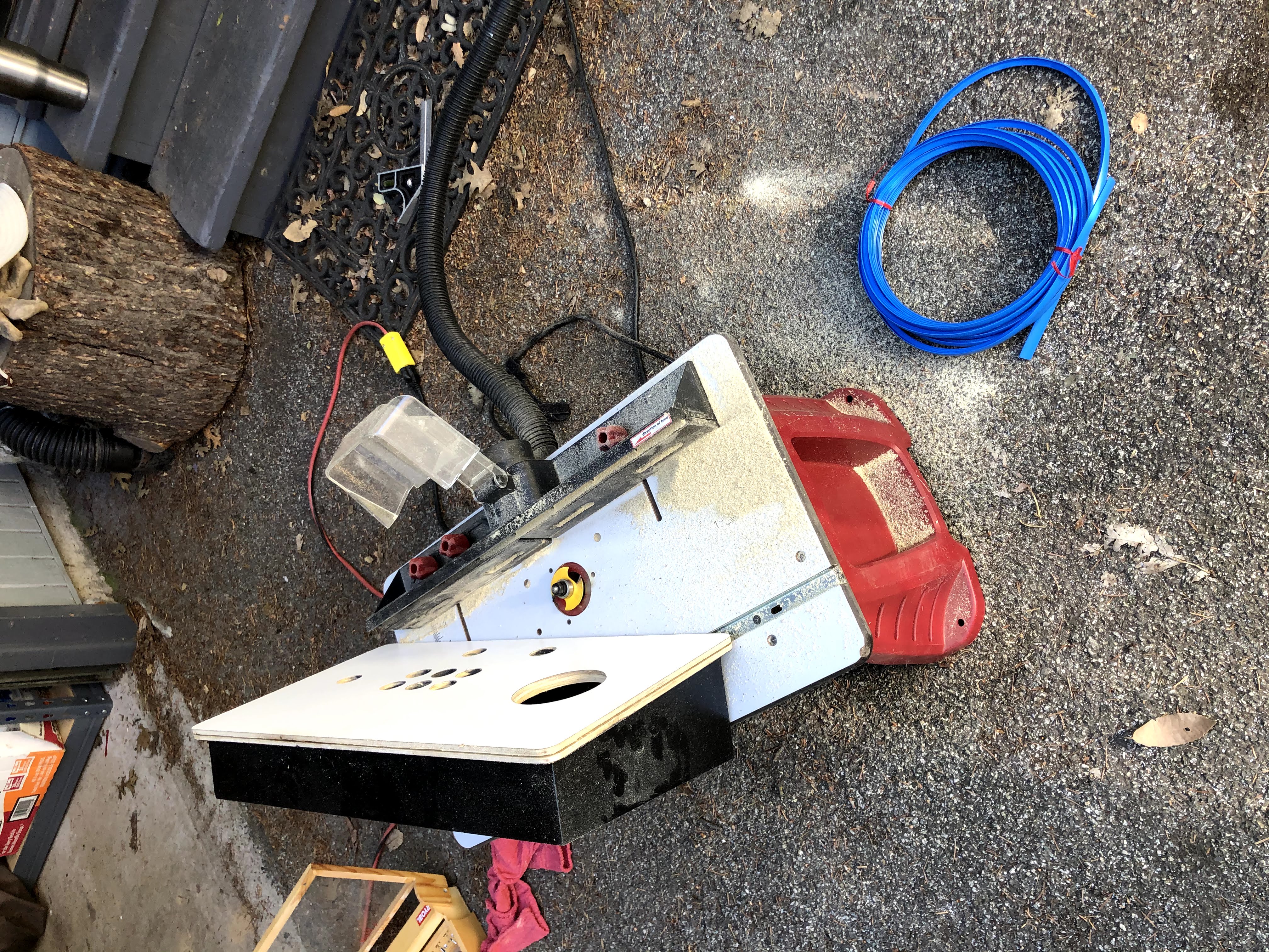

What do you think of that Dewalt cordless router?
I love the small portability of it and it routed like a champ. I've used a variety of other manufacturer's tools like Makita, Ryobi, Black and Decker and I'm always impressed by Dewalt's clever designs. They often just seem more thoughtful. I admit it's a little awkward to use as i'm used to my brother's Craftsman 1/2 inch shank router but I think it's mostly a minor learning curve issue. His is much bigger/heavier with a plunger which is an addon that i don't have yet. His adjustment to raise/lower the router is also different. I had to figure out and get used to using it.
The biggest problem using the router was realizing a router table would really make this easier. but i'm hesitant to get another item that i need to store when i can make due without one. We'll see if i change my mind down the road..

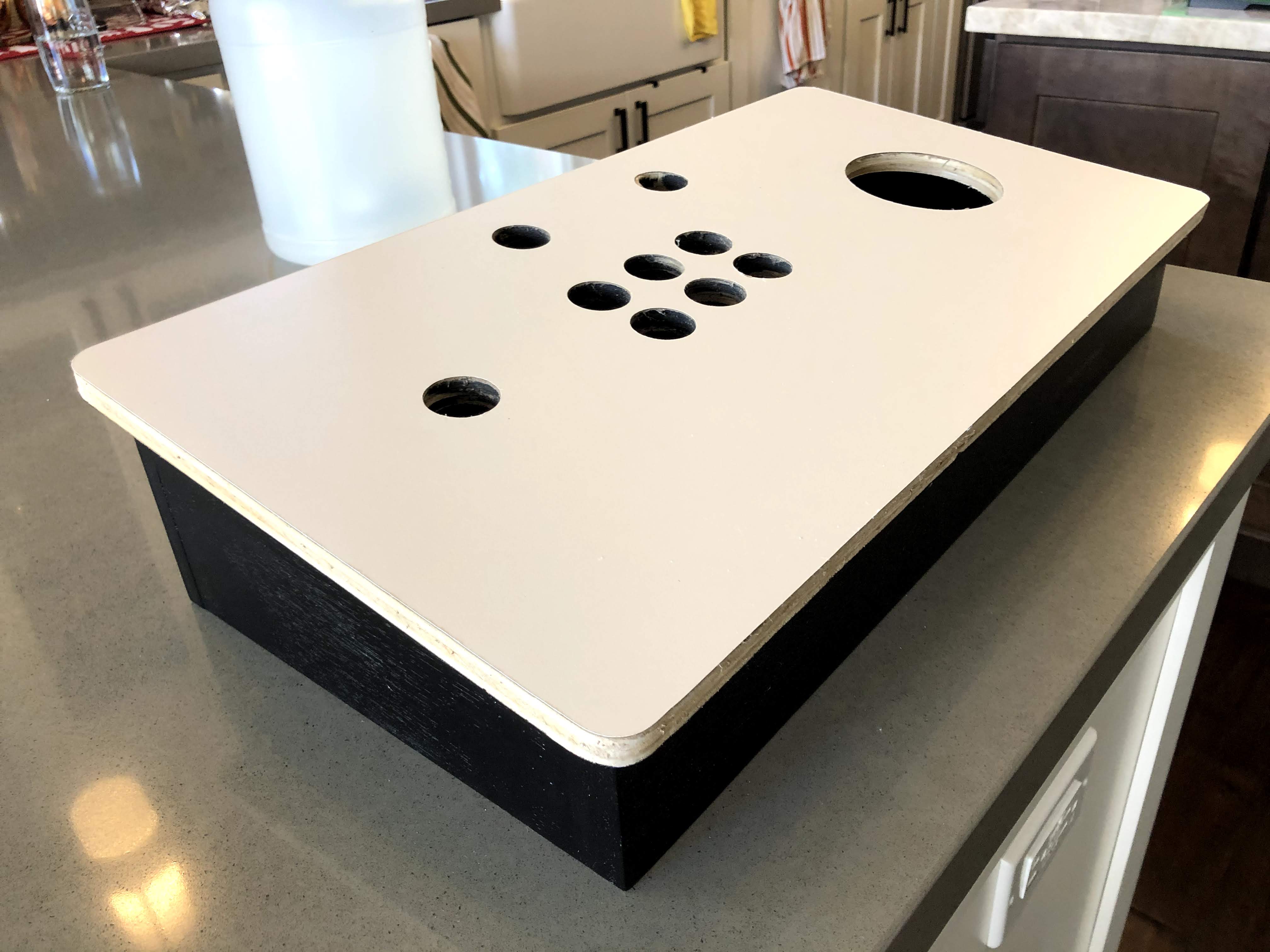

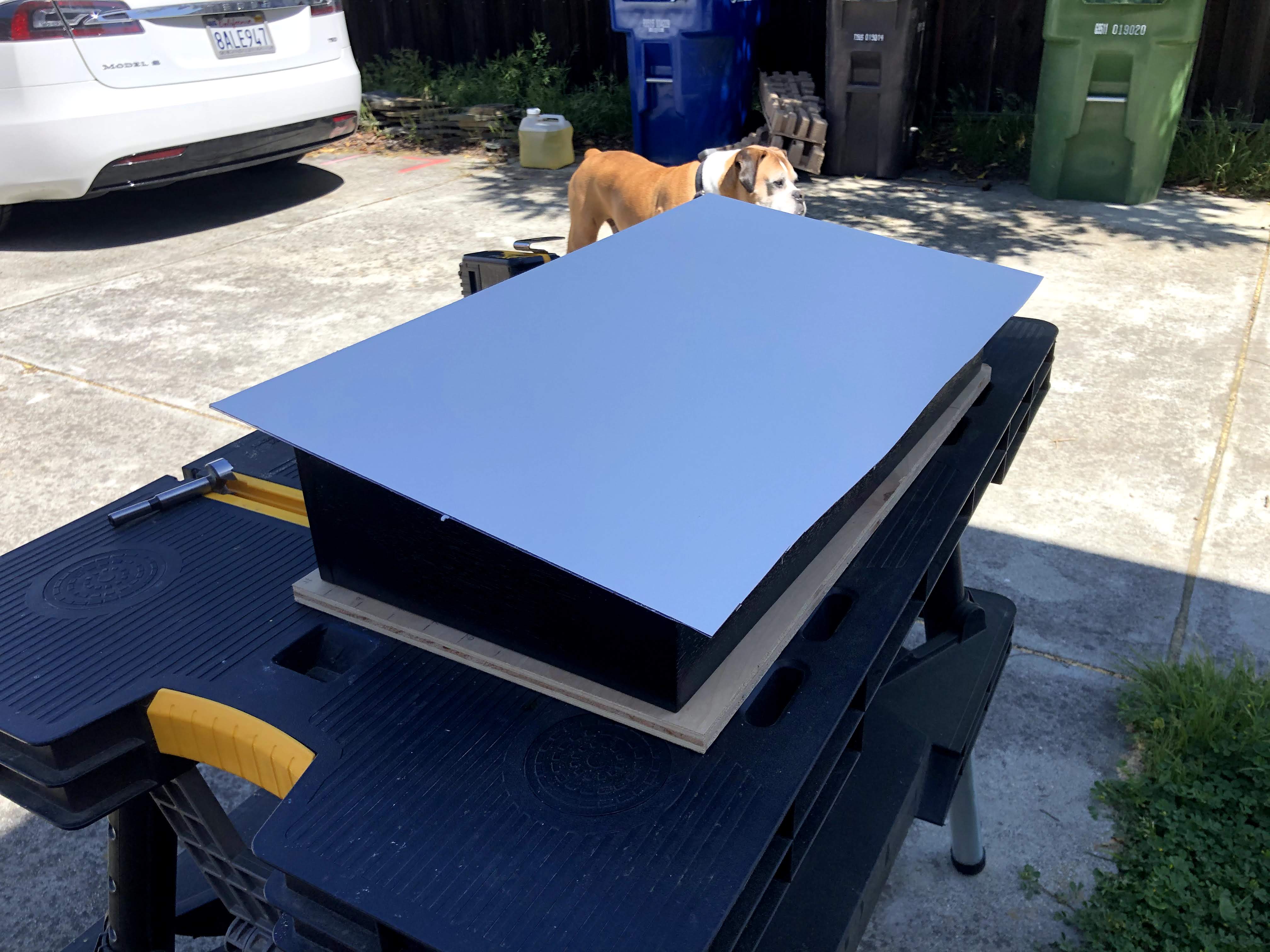

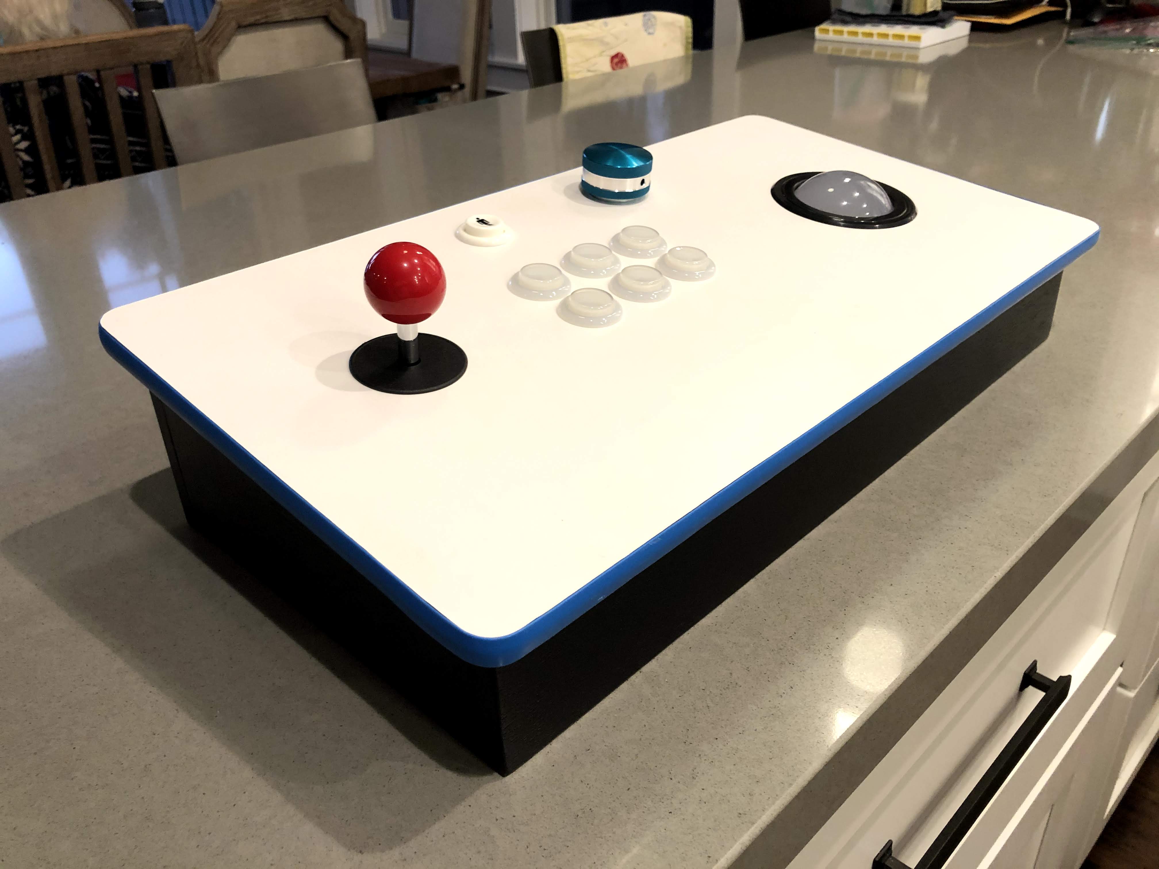

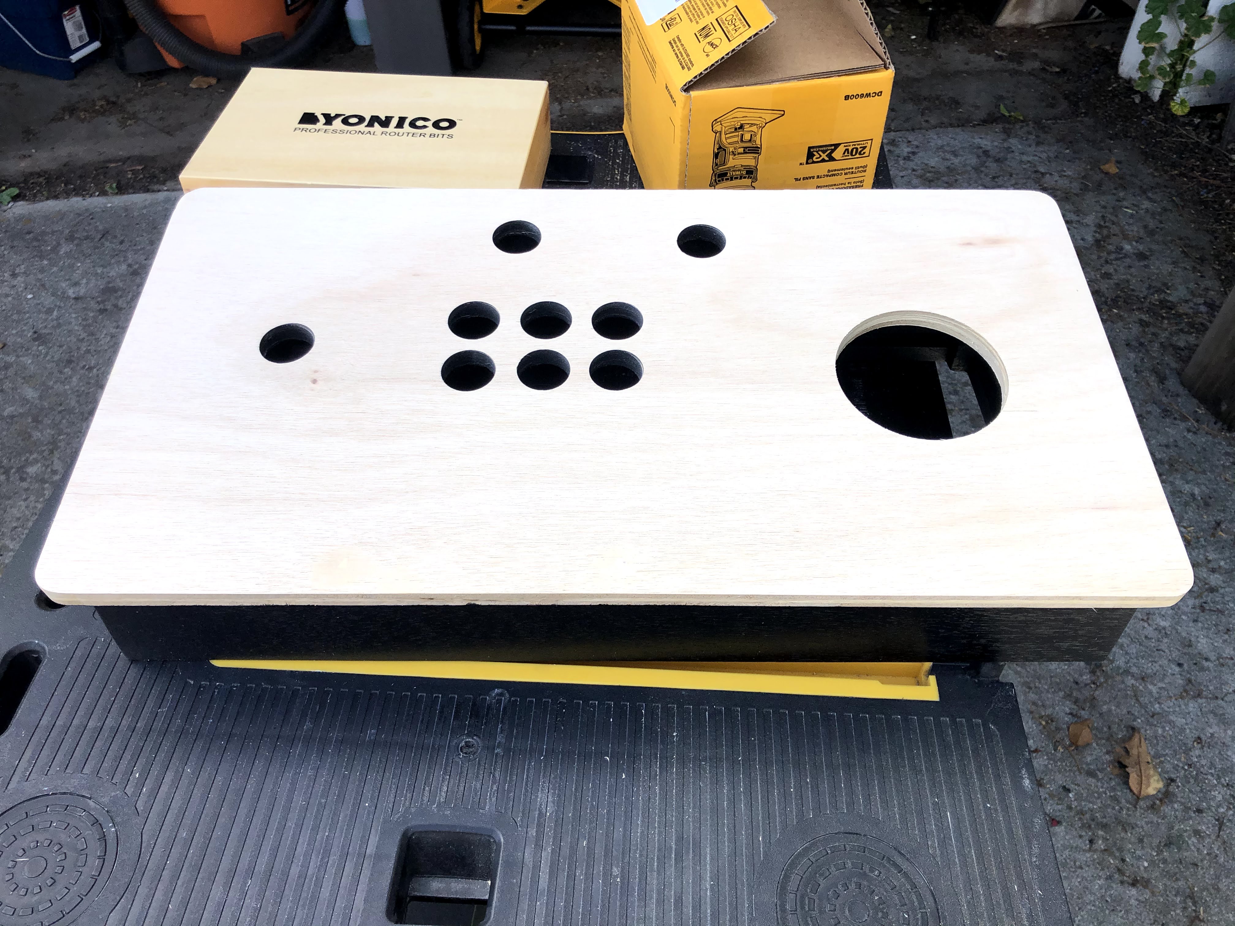

another weekend, some more work done..
sanding/wood filling paint prep work..
the "ledge" that I created to support the piece of 1/4" acrylic that I ordered. I want it to be recessed 1/8" and I had to improvise and build corners that it could screw into after realizing the acrylic's holes needed to be a minimum of 1/2" from the edge.
primer courtesy of a spraypaint can..
black enamel.. I had a heck of a time with these ACE can's of spray paint. *!@#%&!. They were spattering droplets like there was no tomorrow :( . I would've used my friend's automotive sprayer if this was more then just a test project but as it is i figured I could get decent enough results with a spray can. The exterior surfaces actually look pretty good it's mostly the inside that had the droplets. I might try to sand it a bit.
It's good working on a project like this to see what works and what doesn't. In hindsight I should've gone for a smoother painted look by using a wood filler on all the surfaces I was painting. As it stands my pocket holes look smooth while the rest of the wood looks rough. I could've just made it all smooth for a nicer finish. Also I didn't do a great job on my pocket holes. In some cases the screws are protruding which is something I should've paid more attention to ensuring they were recessed.
All in all i'm happy with the progress and so far it's pretty well what I envisioned. It's a really nice size and weight which is one of the things I was after. I'm glad I went with 1/2" plywood. Next up, my laminate layer on top and my t-molding when it comes. Then I can get to installing controls.
I'm still debating on whether to try to shove a computer inside of it like a NUC so that it's completely self contained or to just have it as a CP that I connect to a computer. I don't have a NUC to use so that'd be a lot more expensive. I do have a spare Pi laying around but I wanted to play with Mame and LED blinky and hyperspin.

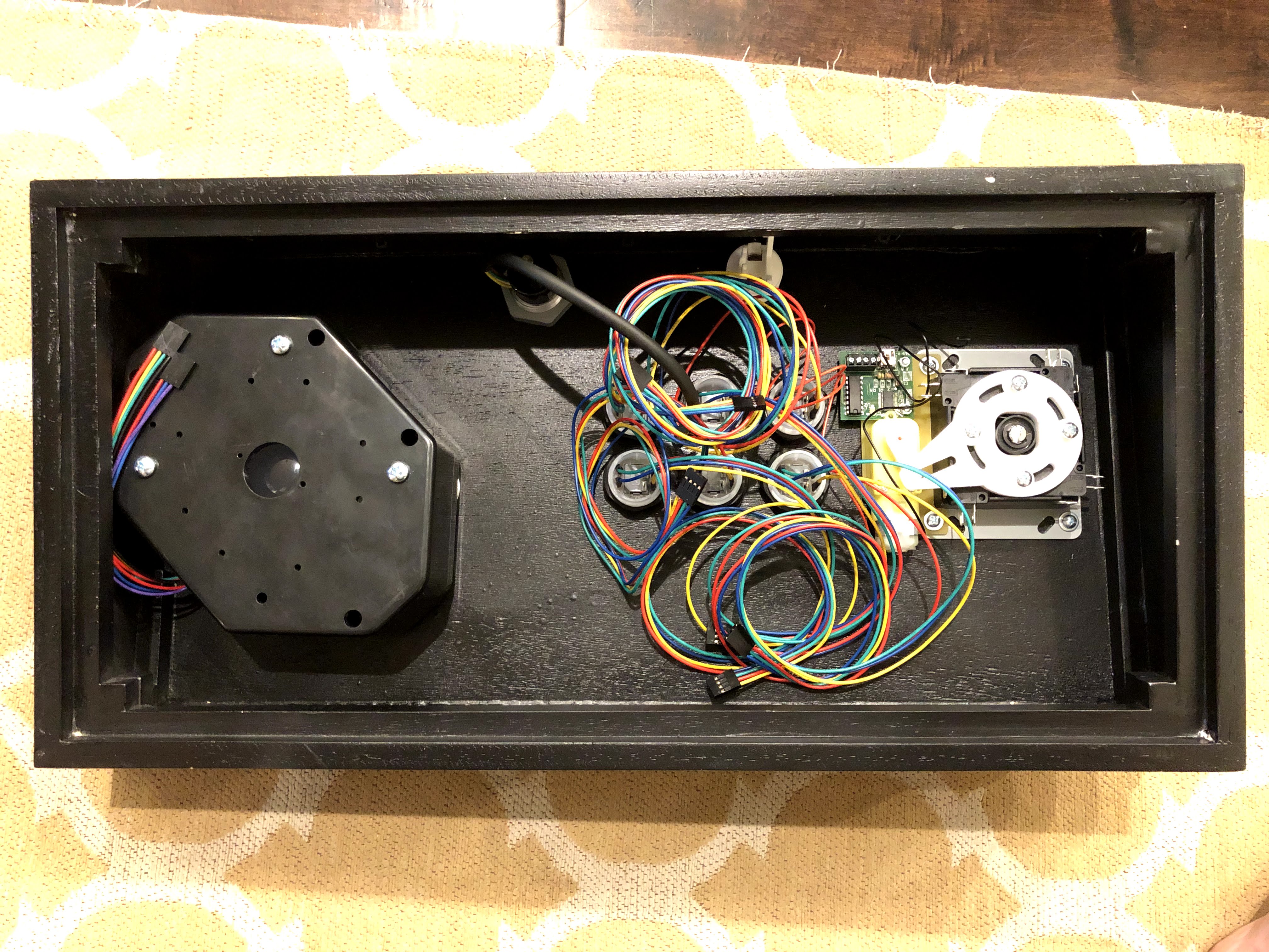

so i'm looking at some of the components that i need to put inside this thing and some questions come to mind..
how do folks mount their IPAC ultimate I/O boards to the inside of their CP? Any suggestions on suitable products for that? I found some short wood screws and rubber washers that might do the trick which i purchased from ACE hardware.
for the servostick (joystick), i was planning on simply mounting it underneath per the previous profile drawing i posted in this thread. It looks like the distance between the top plate of the joystick and the bottom of the ball is 1 3/8". By mounting it underneath on my 1/2" plywood + laminate i figure the distance between the top of the CP and the bottom of the ball on the joystick will be more like 1 3/8" - 1/2" or ~7/8". In other words i'm losing about 1/2" of the space between the CP deck and bottom of the ball. Space that presumably my fingers might need as i work the joystick. Does that seem ok? i.e. losing some of the height of the joystick by mounting it underneath?
Most folks use PCB feet:
You can buy them lots of places but here's one.
]In other words i'm losing about 1/2" of the space between the CP deck and bottom of the ball.
There is a reference for standard stick heights based on the stick being used on SlagCoin.  Look specifically at the section that says "Bulkiness and Mounting Height".  Some sticks were designed with a wood plate in mind, and some were with metal.  Accordingly some were meant to be mounted pretty much at the surface, and some below.  You can route out of the bottom or the top if you are trying to match the recommended height, or you can buy extended shafts to mount it from the bottom if you'd prefer not to route it out.  Keep in mind if you buy extended shafts you are changing the fulcrum point and therefore introducing leverage.  It will feel different, and you will probably want a stiffer spring due to the leverage, unless you like the looser feel.  A LOT of this comes down to personal preference.

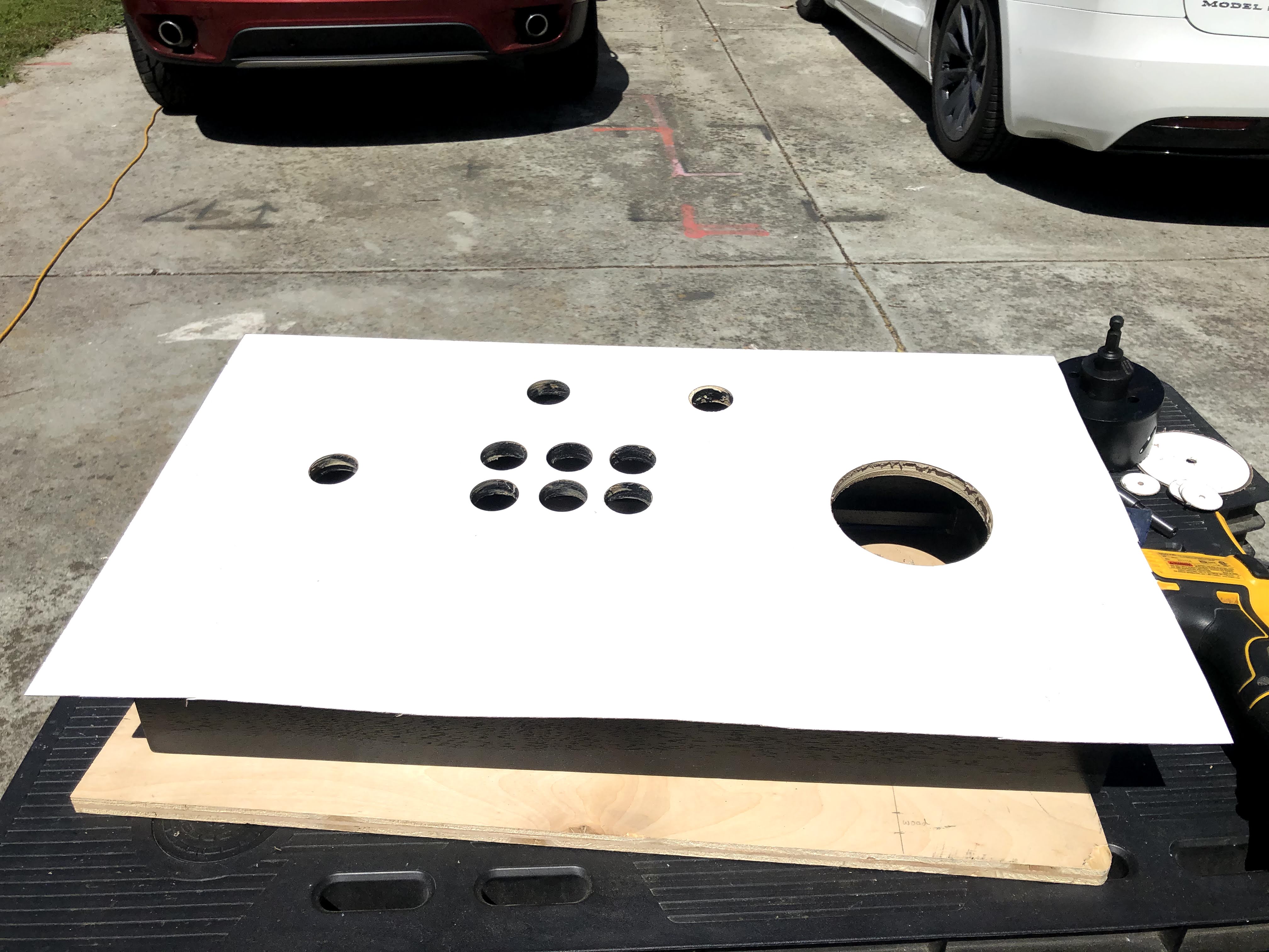

another covid weekend, more progress  ;D
re-sanding the top, cleaning with tack cloth and denatured alcohol, in prep for my piece of laminate..
applying the piece of laminate..
cut holes in laminate.. messed up the spinner one a bit because it was difficult to center with it being so close to the edge board. nothing that anyone will see when it's installed though.
trimmed the laminate with the router
headed over to my brothers to use his router table. cut the slot around the edge. that was kinda fun :) Could be the beer i enjoyed afterwards too. Hammered the blue t-molding in. I'm rather proud of how well it butts up against the edges.
Got home and installed the controls. Looking pretty good! Realized i needed a blue joystick ball so ordered that.
but if course i have a couple of problems.. First, the joystick is currently only held in by 4 x 1/2" wood screws at the bottom. I added some washers so with those and the thickness of the joystick plate they're not going in a full 1/2". But I'm wondering if this is secure enough..? I'm tempted to use the other 4 slots that i seen to add another 4 screws. Thoughts?
But the real problem is my trackball. I can't get one of the bolts in. The other 3 are solid. The alignment of the screw is slightly off. Just enough that i can't get it in. UHG.  :banghead:  So question is, do i remove it, glue in a dowel, redrill, and get that 4th screw in? Or will 3 hold up for such an application? I don't plan to beat on it much frankly so i may be fine. But the OCD part of me that doesn't like leaving things undone makes me want to fix it. I think I answered my own question. I cleverly found some large washers to put between the trackball and the wood to set the height of the trackball such that it was nice and flush given my wood is only 1/2" plywood and you need more like 5/8".
Another problem i realized is that i can't get my spinner weight on as i have the spinner too tight to the frame board. No way can i get the heavier/larger weight on. I do have the smaller one as well which i think i can get on by carving some of the frame board out using my dremel. I'll have to work on that next as well.  ::)
But otherwise it's looking quite good (to my beginner eyes that is).  I got my piece of acrylic and it fits nicely on my "ledge". But i won't be installing any of that until i get the internals sorted out.
The problem with using wood screws in MDF is, to paraphrase Danny Vermin in Johnny Dangerously, that you can tighten them once.  Once!   :lol
If you try to remove and reinstall the screws, the MDF will pulp and strip.   :angry:
Use threaded inserts if you want to keep the top of the control panel smooth or use carriage bolts if you don't mind the heads showing.
http://wiki.arcadecontrols.com/index.php/FAQ#Hardware
Four ways to approach this:
1. Turn the joystick 90 degrees and drill new holes for the inserts.
- Easiest way, assuming you have room.
2. Install threaded inserts for the four currently unused slots on the mounting plate.
- Another easy way, assuming the new slots are far enough away from the old holes.
3. Fill the current screw holes with wood filler or Bondo, let it cure fully, sand it down, drill a clean hole, and install the inserts.
4. If none of those methods work for you, you might be able to use a variation on the "Under mount (support blocks)" mounting method in the FAQ.
- Forget routing a pocket and the support blocks, just use two bars like this.
EDIT: Just realized that you're using plywood, but threaded inserts are still recommended.   :embarassed:

That's a plywood top - no?
It's 3/4"
Just use 3/4" screws and you will be fine..  the thickness of the plate and the washer will keep it from poking through..
  • Posts: 5913
  • Last login:Yesterday at 08:17:13 am
Re: Test Control Panel Design
« Reply #66 on: April 28, 2020, 03:00:09 pm »
Maybe I should have looked at the pictures instead or reading the comment.
Screws in plywood will hold just fine.
Of course carriage bolts all the way through are the best and most arcade accurate. ;)
It's 3/4"
1/2" plywood. Thus, the 1/2" screws.
Careful.  When you get that close in length, it can poke out the other side.  Or it can push the wood you didn’t drill out cause you were scared to drill through.  I’ve done it more than once.
Edit: looking good by the way.  That’s a really good first attempt.

only one photo today.. I wired up the innards yesterday and added the small spinner weight once dremelling some room for it to fit against the rear board. Hopefully I've got all the connections right. I was basically following maverick's arcade videos on youtube. One thing I realized is that I need to rethink how i'm going to connect this to my PC. I have a USB port on order that i plan to put on the backside similar to what Arroyo did on his. That should serve as the USB connection. I didn't realize until now that I also need to run a connection to the power 5V power connector and connecting it to an HDD connector isn't ideal. Somehow i need a wall-plug power supply for this. And more importantly, wire it so that there is a port exposed on the rear of the panel such that once i close it up i can still connect it to an outlet.
Anyone know of a good arrangement for that? somehow connect the ipac board to some kind of port on the rear of the CP such that i can simply plug a wall plug in when i want to use it?
I also need to figure out how to connect the servostick's small board's USB port to the PC. perhaps i need a tiny USB hub inside the CP connecting the ipac to the servostick board and to the port that'll go into the rear. Anyone know of a nice super tiny USB hub or similar?
hmm i just realized i haven't connected the 6 buttons to the IPAC. doh! Off to do that too..

I finally got some of the parts I needed and worked on my connectivity pieces a bit.
I needed a small USB hub to connect the servostick USB port and the IPAC board to the port i was installing on the back of the CP. Found this small one on amazon which seems like it'll work nicely..
I realized that the AC adapter has an indicator right on the back of it showing what is + and what is - on the plug coming off of it. Perfect! I figured I just needed to map this out when wiring the internals. With a little testing with my multimeter to see what wire is connected to what, I soldered it up.
Then I turned to drilling the holes on the back of the CP. I quickly realized the wood was too thick for both my plugs and i'd need to cut a larger hole to recess them a bit. Something I would've liked to have done on the inside of the CP but given there was no room to fit a drill in there, I decided to do it on the outside instead. It doesn't look as nice but in the end it got the job done. With a little black enamel fingernail paint I touched up the mistakes and installed everything.
and here is the internals wired up. You can see the blue USB cables (from amazon) running from the IPAC and servostick to the little USB hub which i tucked inside with some double sided tape. Then the wiring from there to the ports. There wasn't a lot of room so i let my cable lengths large dictate where the ports ended up since i was trying to keep the insides of the box neat.
I then hooked it all up to my PC and ran MAME and it sort of works :D. I got to play digdug  :applaud:. By sort of, the joystick works as does the various buttons, but when i loaded up tempest to try the spinner it wasn't doing anything (maybe i need to map something? seems like it was using the joystick instead). I also haven't tried the trackball but it does move my mouse pointer around albeit in the wrong directions (up and down move it right and left and visa versa. is that normal?).
Lastly the servostick switching between 4way and 8way doesn't work. When i try to click the button to switch it, I get runtime -9 errors :(. Anyone know what that's about? I can post a screenshot if that's helpful.
next up once i make sure the spinner, trackball, and servostick switching all work, i'll put the plexiglass bottom on it and feet for one last photo session. Then i'm thinking i'll play with launchbox, LED blinky, and get some more ROM's.
